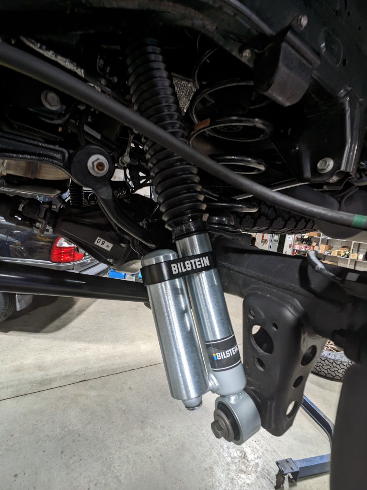

Bilstein 6112/5160 Installed
I just put this setup on my 2016. 30mm coil spacer in the back. 4th perch up front. Stock rear springs. Tires are general grabber ATX’s sized 275/70 r18. I couldn’t be happier 😍

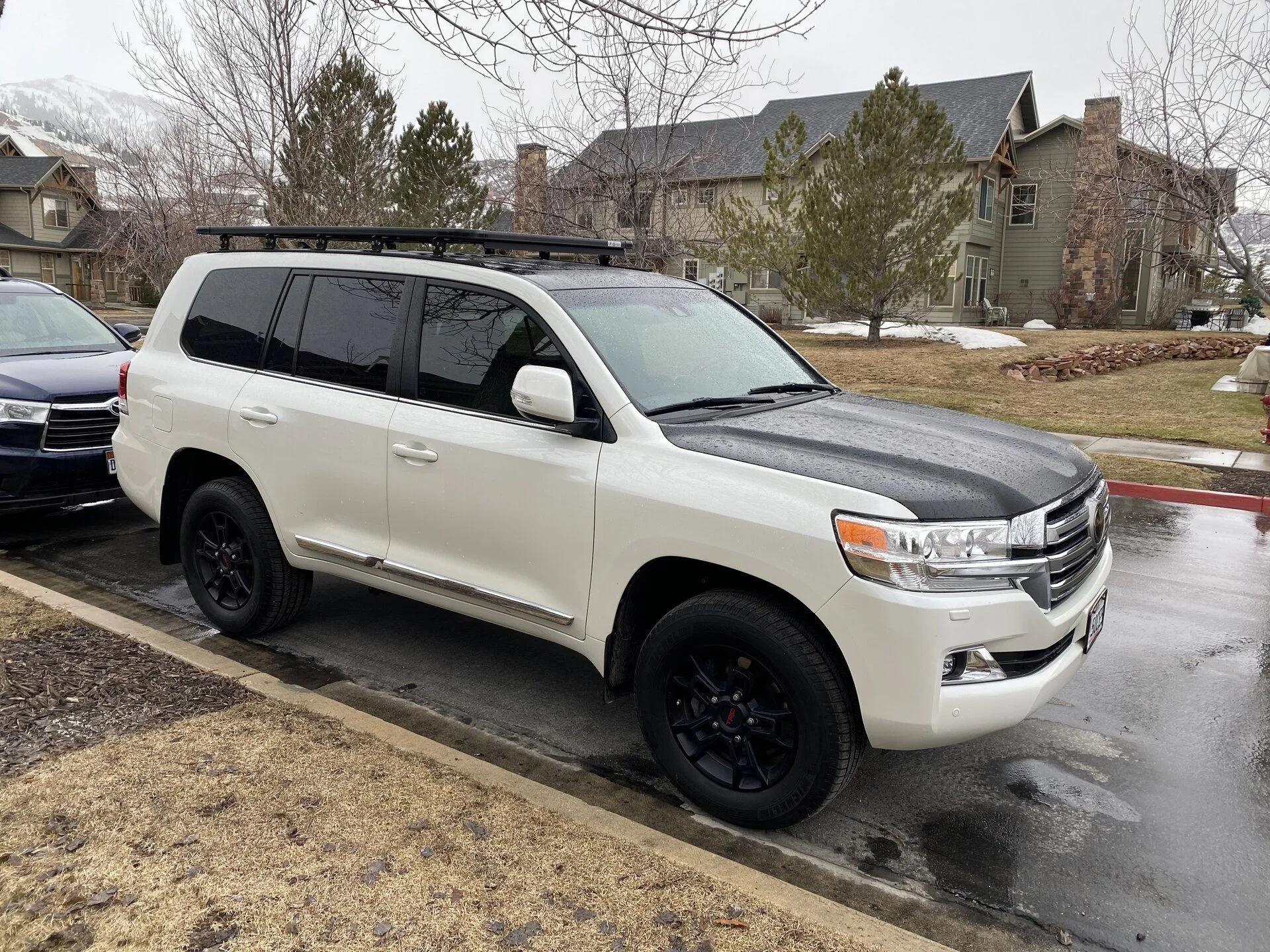

Yes. Since last summer I have had the 6112/5160 combo installed, with Bilstein HD springs on my '18 200 series. Asked the installer to maintain "factory" rake, which was accomplished with 2nd perch. (If I recall correctly, he played with it between 1st and 2nd and settled on second.). At any rate, I love the suspension; significantly more "poised" and damp, with great rebound control and improved travel. Increased the factory height by (only) about 1 inch or so. (Removed 3rd row but added ARB/Outback drawer system, and have a K9 rack - no other weight-altering mods.). Running stock-size Blizzaks on factory wheels (winter) and stock-sized AT tires (soon to be BFG T/A AT KO2s) on TRD BBSes (summer).

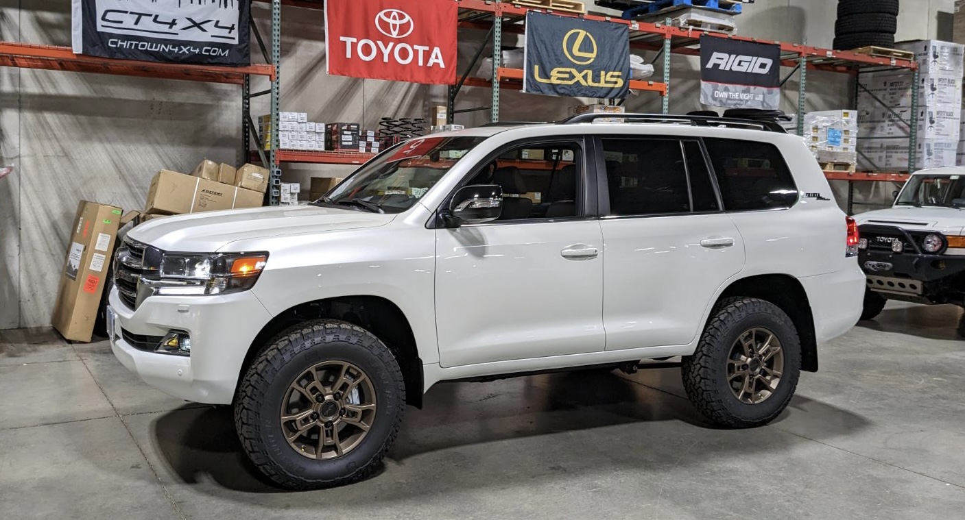

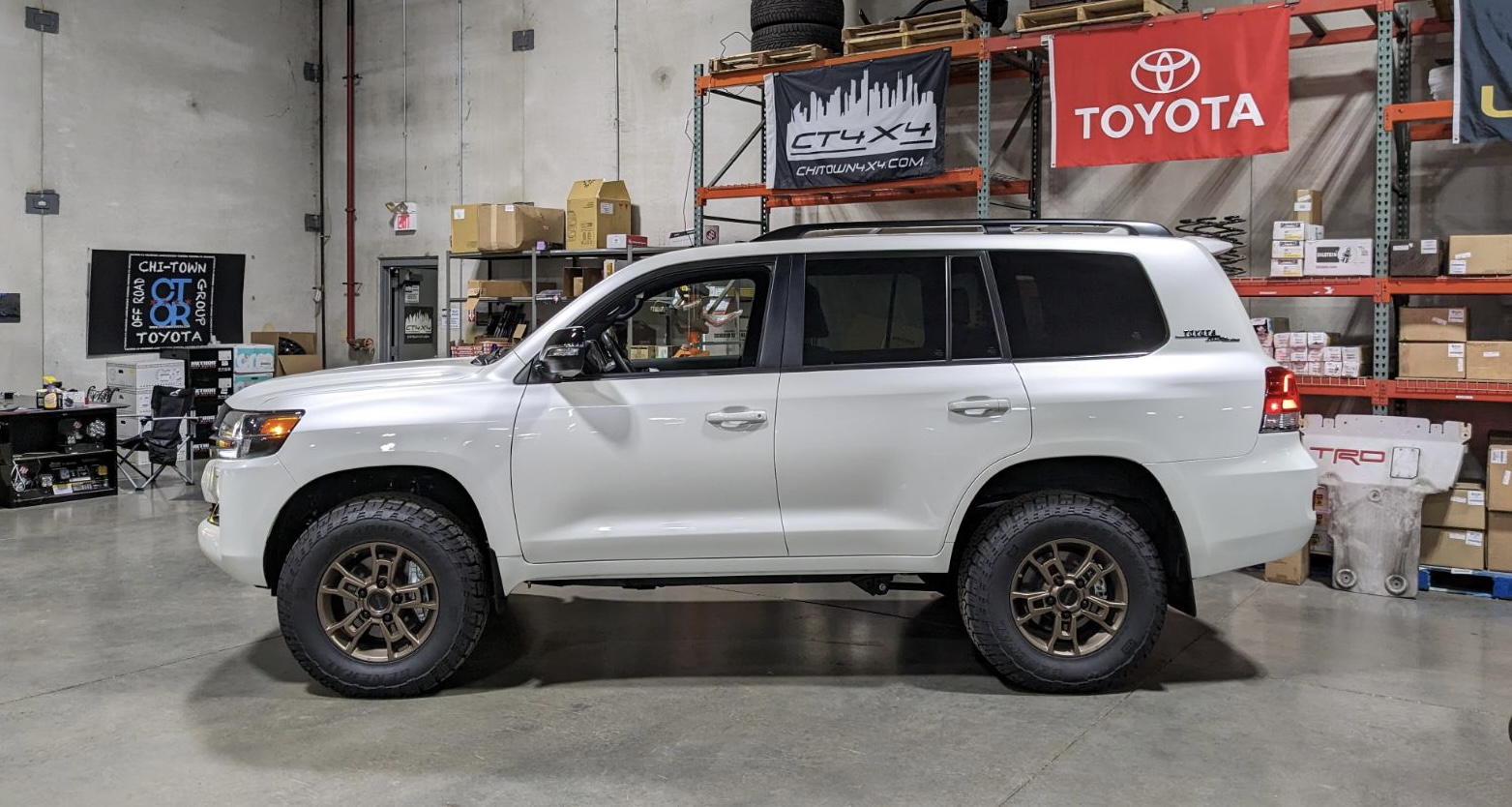

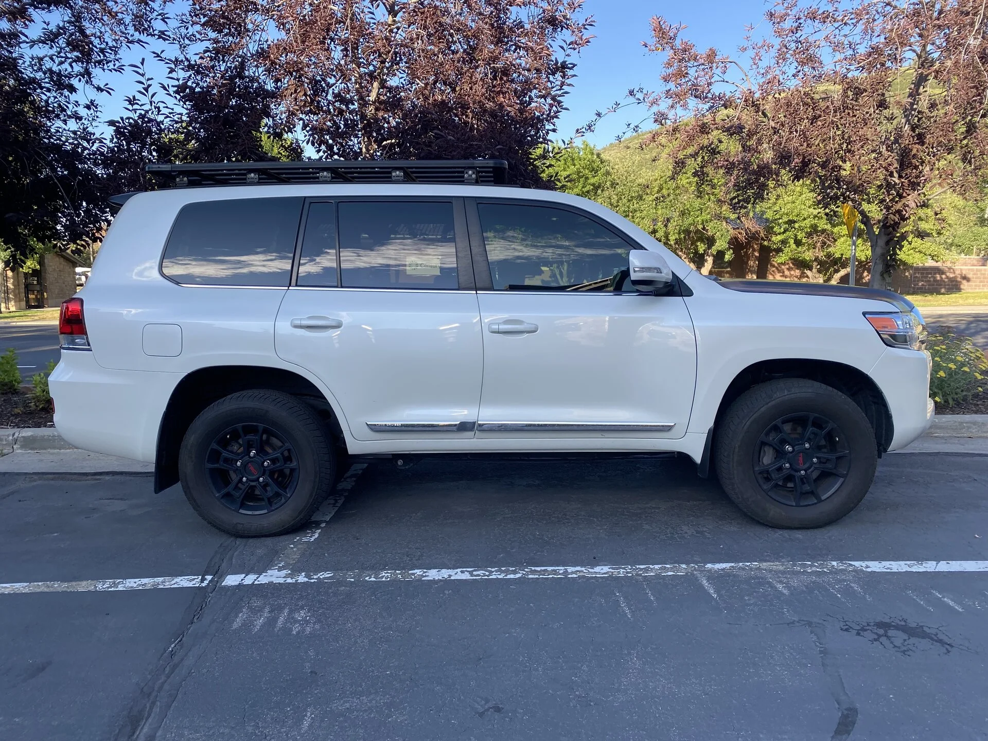

2021 HE no factory 3rd row. 5th perch up front, stock HE springs in rear with a 5mm coil packer. Tires are 275/70 R18 General Grabber A/TX. Ride is fantastic, I was worried that it would be harsh and take away from the factory plush ride, but it has been great. I wish I would have done it sooner.

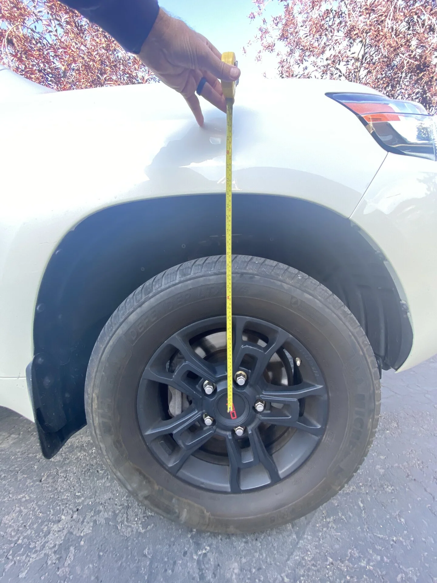

Center of hub to bottom of wheel well measurements.
Stock-
FL- 20" FR- 20"
RL- 22.5" RR- 22.75"
After-
FL- 23" FR- 22.5"
RL- 24" RR- 24"
Ride is definitely smoother with my Rhino front bumper. So a little bit more weight on the nose seems to help

Would you happen to have a side profile pic?
