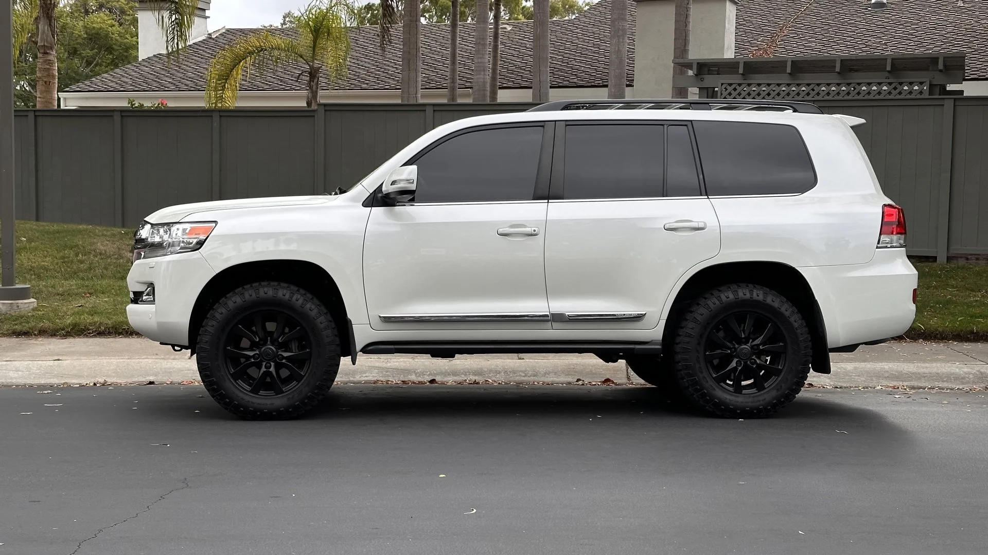

Bilstein 6112/5160 Installed
Very happy with mine. Pleasantly surprised at how much better the rig handles on the road. Basically no more brake dive and it turns in much better and is much flatter in cornering
Very Happy, and knowing that I'll never have to take them out to rebuild is pretty great. If one goes down, I just install a new one

I would agree with many here; definitely an improvement over stock in so many ways. I do think I may have put a tad too much spring in the rear by adding 2721’s. They are absolutely perfect when we load the truck to the gills (packed rear cargo, roof box, trailer/ bike carrier)… however, around town I think they could be considered a bit harsh. Not a knock on the dampers as they are perfect up front and when I have enough weight on the springs in back, it is a really nice ride and I feel I have great control over the machine at speed. I may switch out the rear springs at some point as we have airbags in back but have yet to need them even when towing our Taxa Cricket loaded for camp…
What's springs would you change to? What height is your front set at?
I believe I am on 4th perch upfront. And I don’t recall the OME rate conversions, but would probably revert back to something similar to stock rate or the recommended Bilstein standard for these. When we put on the 2721s we thought we would be towing a trailer close to max payload…. We are much lower than that today and thus maybe a bit heavy on rear spring rate…

I agree with these comments. I have since moved back to stock rear springs with 30mm spacers and the front on 4th perch. This to me has been the sweet spot for stock weight (3rd row) I only have 0.5" rake
Ah ok, I'm planning on going 5th perch and SPC uca with 2721 rears, hoping it will be pretty level. I have removed the 3rd row also though..

5th and 2021 makes sense. I had more rake than I wanted when I had the 2721s on 4th
Correct me if Im wrong, but it sounds like the standard rear coils from this kit has the same feel as stock 175#, and the newly available HD coils 400# are closer to what is offered as "standard" in most other kits ~350#.

I would recommend at least the hd of the kit or at least the 2721. I’ve seen one or two members mentioned with fully loaded gears n passengers the back sag quite a bit. Much lowered than the front.
I didn’t want the back to sag like that so I’m on 5th perch n 2722 back. There will be a rake which I like. It levels out when I’m fully loaded with the family and camping gears.
The ride is stiffer in the back compared to stock.
Anyone switched to Bilstein Heavy Duty rear springs 53-297686 from or to OME 2721 (or Icon progressive spring) and can comment on the differences in height and differences under none/additional load?
I ran icon progressives. It gave me about 2" of lift in the rear. I really liked that setup when my truck was stock. I was on the 5th perch up front. Even with rear bumper and sliders. They still felt ok. But I needed more spring rate anytime I would load up for a trip after getting armor.
