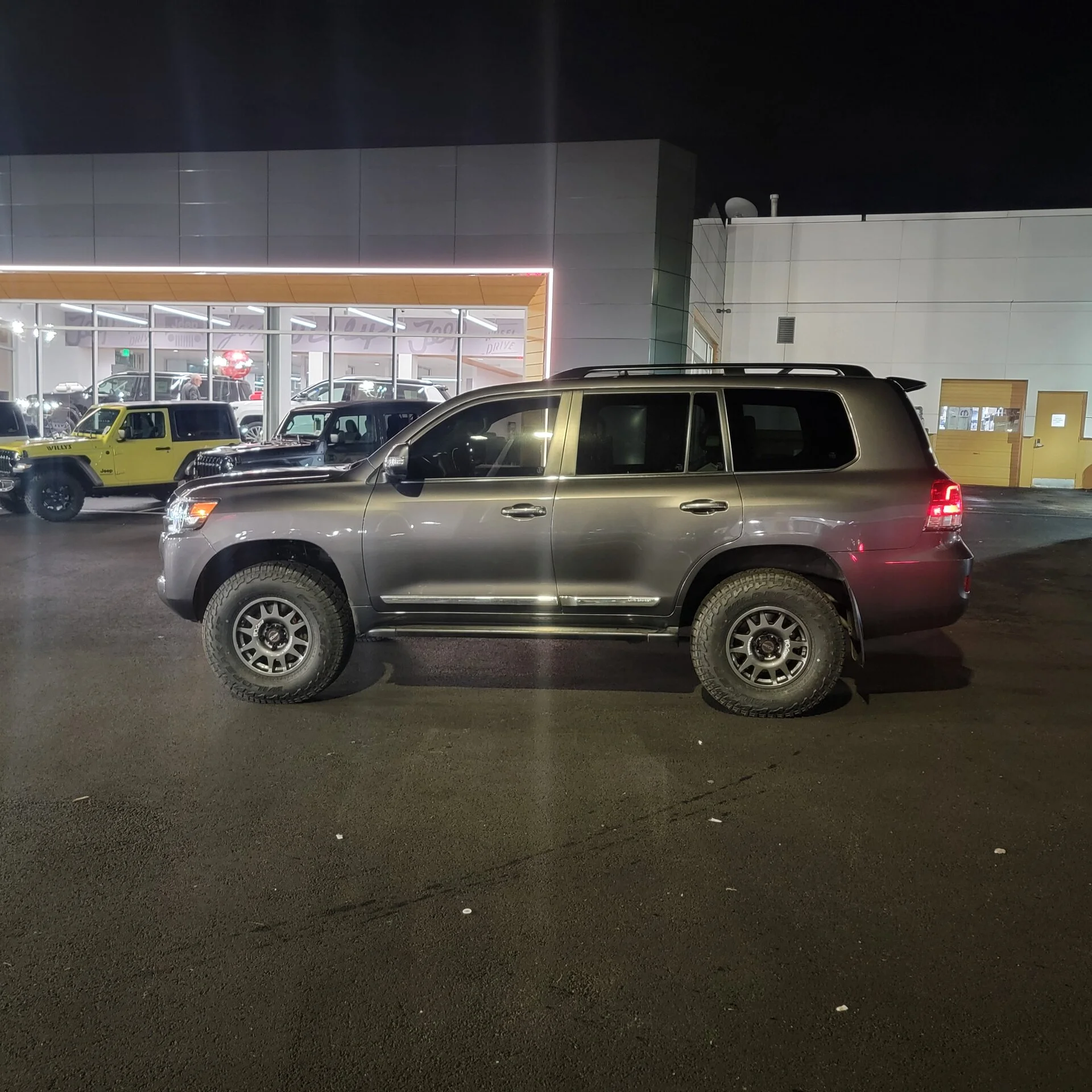

Beautiful truck. I've got a blizzard pearl 16 that I'm getting ready to run this exact setup on. 270/70R18 General Grabbers ATX. How much lift did this setup get you? Which spacer did you use for the rear? Are you getting any rubbing?
Anyone know if this is the heavy duty front springs??
Sorry for the late reply, I never saw this post...

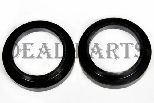

If you go with 275/70-R18 with no wheel spacers, there should not be any rub, I never did even before the lift. When I added 0.75" wheels spacers (purely for looks) then you run into rubbing, I moved the from fender lining forward and trimmed the mud flaps, so don't add wheel spacers ;)
As for the lift I've got about 2.25" up front on 4th perch and 1.5" in the rear compared to stock... the rear spacer however is about 1" (30mm) BUT the Bilstein shocks added 0.5"
The spacers are from eBay...

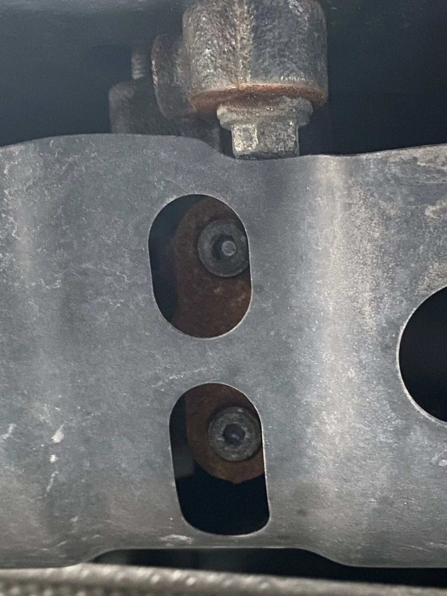

I picked up 2013 with 6112(5th perch)/5160 and Bilstein rear coils . Front driver side is a little higher than rear driver. I'm not at all a fan of a rear dip. I noticed that one of the KDSS bolts doesn't appear to be fully recessed, so I'm going to first get it on the lift next week to reset the KDSS and see if that changes anything. If not, I may drop it down a perch.
I assume the right way to remove and reinstall the snap-ring is to remove the shock completely? I would welcome any tips on this.
You need to compress the spring to move the snap ring to move the perch. So if you think you can get the front end of the truck in the air and sneak a spring compressor in to do that, great! Otherwise, yes, remove it completely.

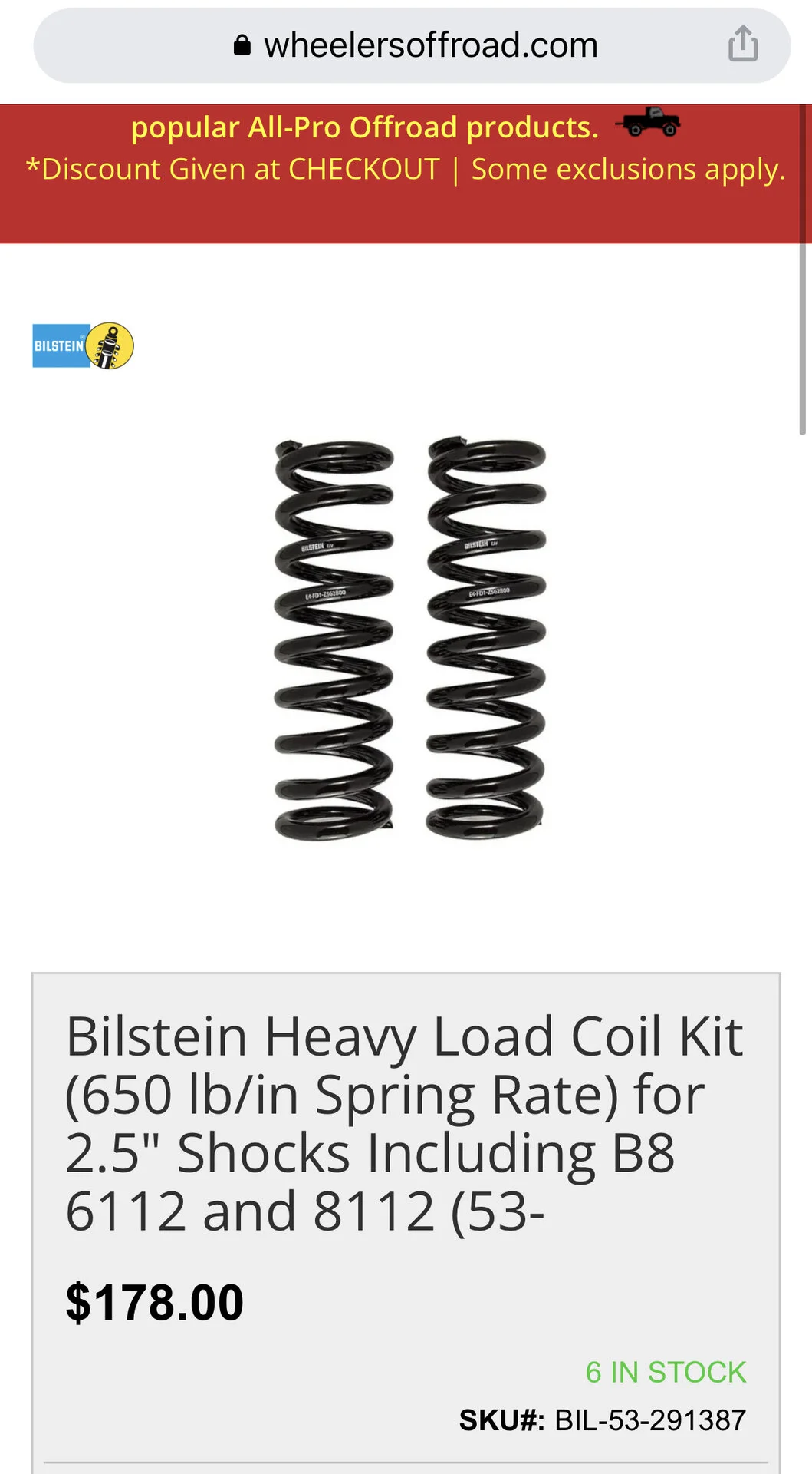

I have no added weight in rear will it be better to use stock spring over bilsteins?
Depends what height setting you go with in the front. Bilstein does make a spring that will lift and is softer now but not sure how much lift it actually gains.
