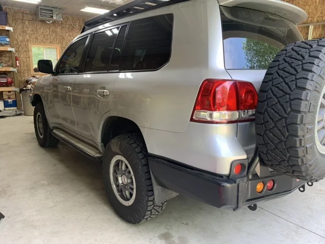

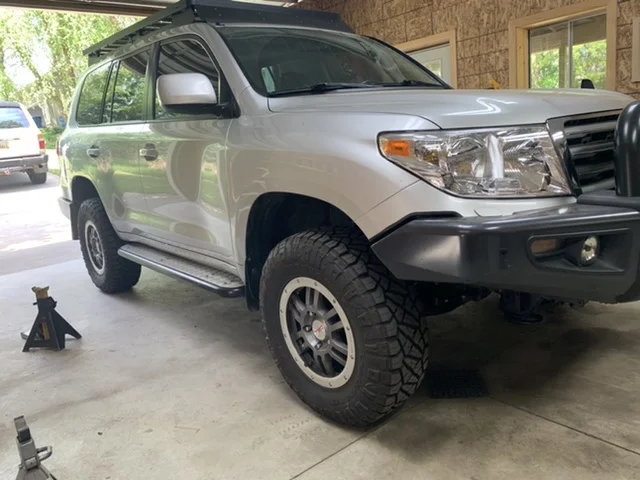

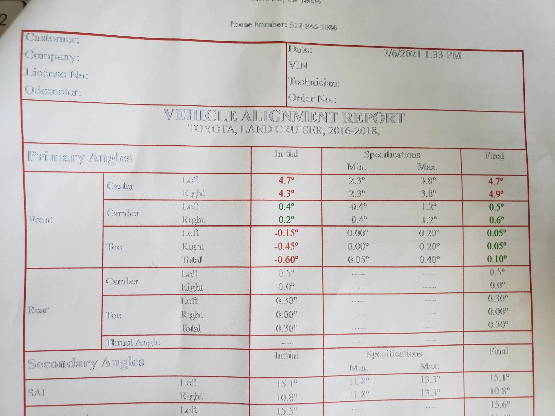

I forgot to post back here after getting the alignment dialed in. Previously, the alignment guy refused to try to bring the caster into the green, claiming that the aftermarket lift would make it impossible. I knew he was wrong, especially since I had installed Total Chaos UCAs just to make sure everything would align well. So a couple months later I ended up doing the calculations myself to bring the caster into the green, adjusted myself at home, then took it back for them to fix anything small (or large?) problems that I might have introduced. I'm happy that my adjustments were good, and they mostly just had to adjust the toe.
One interesting data point from this experience is that the Total Chaos UCAs can span the full range of "green", from 2.3 degree caster, all the way up to well above 3.8 degrees. That means you can adjust the alignment to get wherever caster makes sense for you in that range (e.g., to reduce rubbing in the front vs rear of the wheel well but keeping things in spec).
First picture is from after I first installed the lift back in January, and then the alignment guy actually chose to push the right-caster further out of spec to match the left, rather than bring the left in. Second picture is after I adjusted the caster myself, then took it in so they could fix the toe.

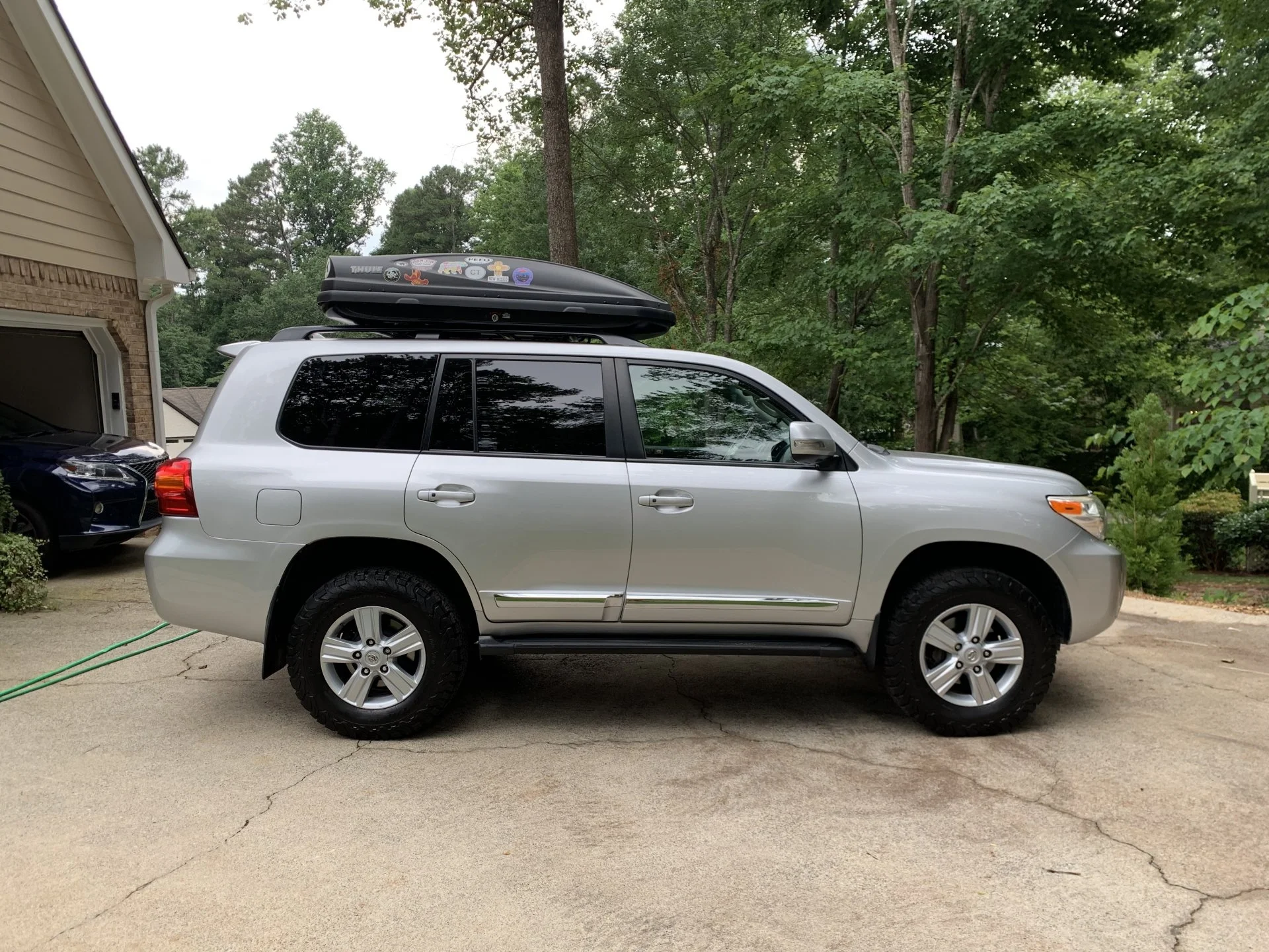

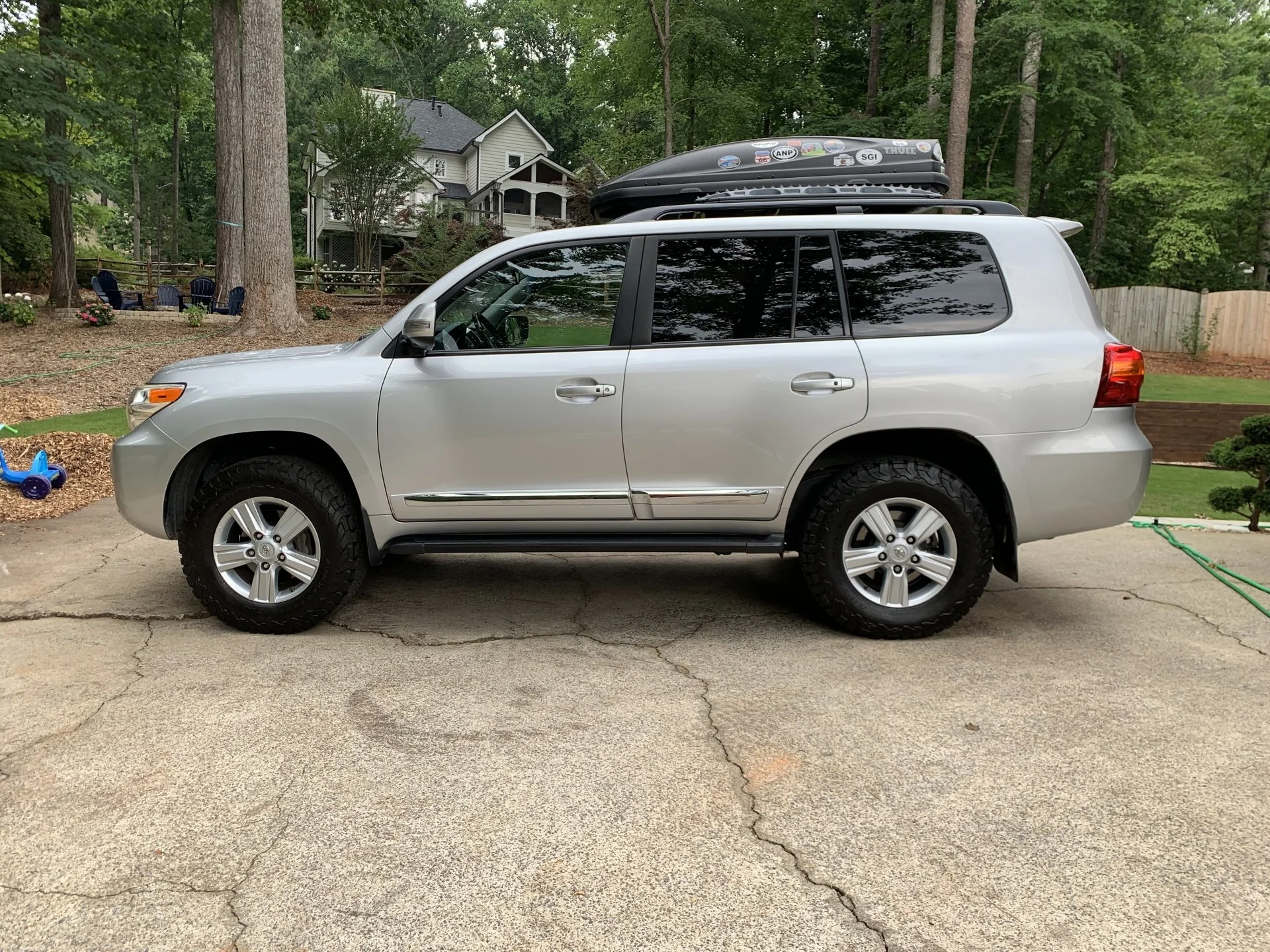

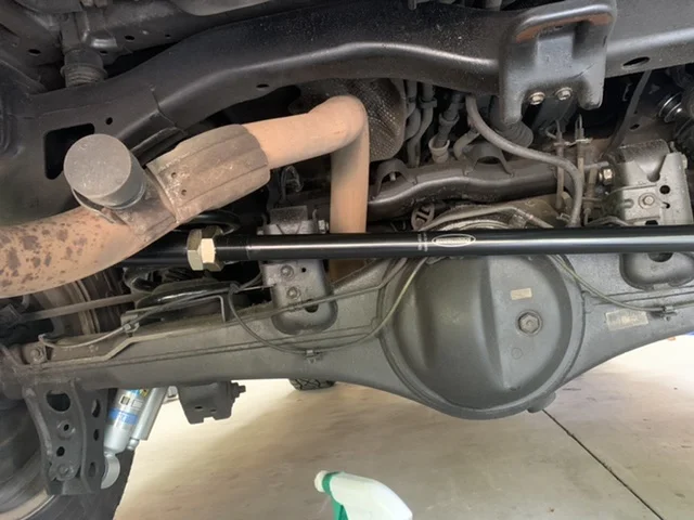

Installed the bilstein set up on the 5th perch plus the Toyota spacers. I'm at 22.5" in the front (after a couple of weeks settling) and 24" in the rear with the OME heavies. Also installed a Dobinson's adjustable panhard to center the rear axle.

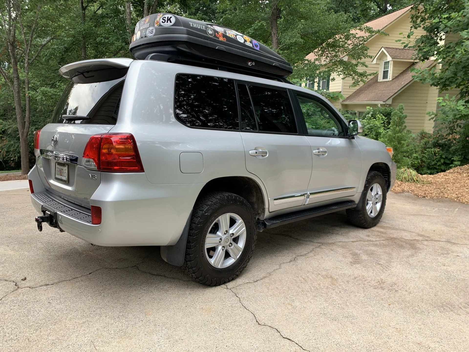

Okay so lift install was completed about a month ago and have put a few hundred miles on since, had the retorted and alignment check done last week. I am really happy with how it turned out. As many have said the sloshy feel is gone and it feels much more planted. Details below:
Front- OME UCAs with Bilstein strut/ spring combo 4th perch. I also replaced the strut bearings with OEM. It is now sitting at roughly 22”.
Rear- Bilstein shocks with OME 2721 springs sitting on new OEM spring buckets, which were trimmed to allow for Firestone bags. We do some towing and so this I expect will help when heavy. Rear is sitting roughly 23”.
A huge thanks to everyone who contributed to this thread!

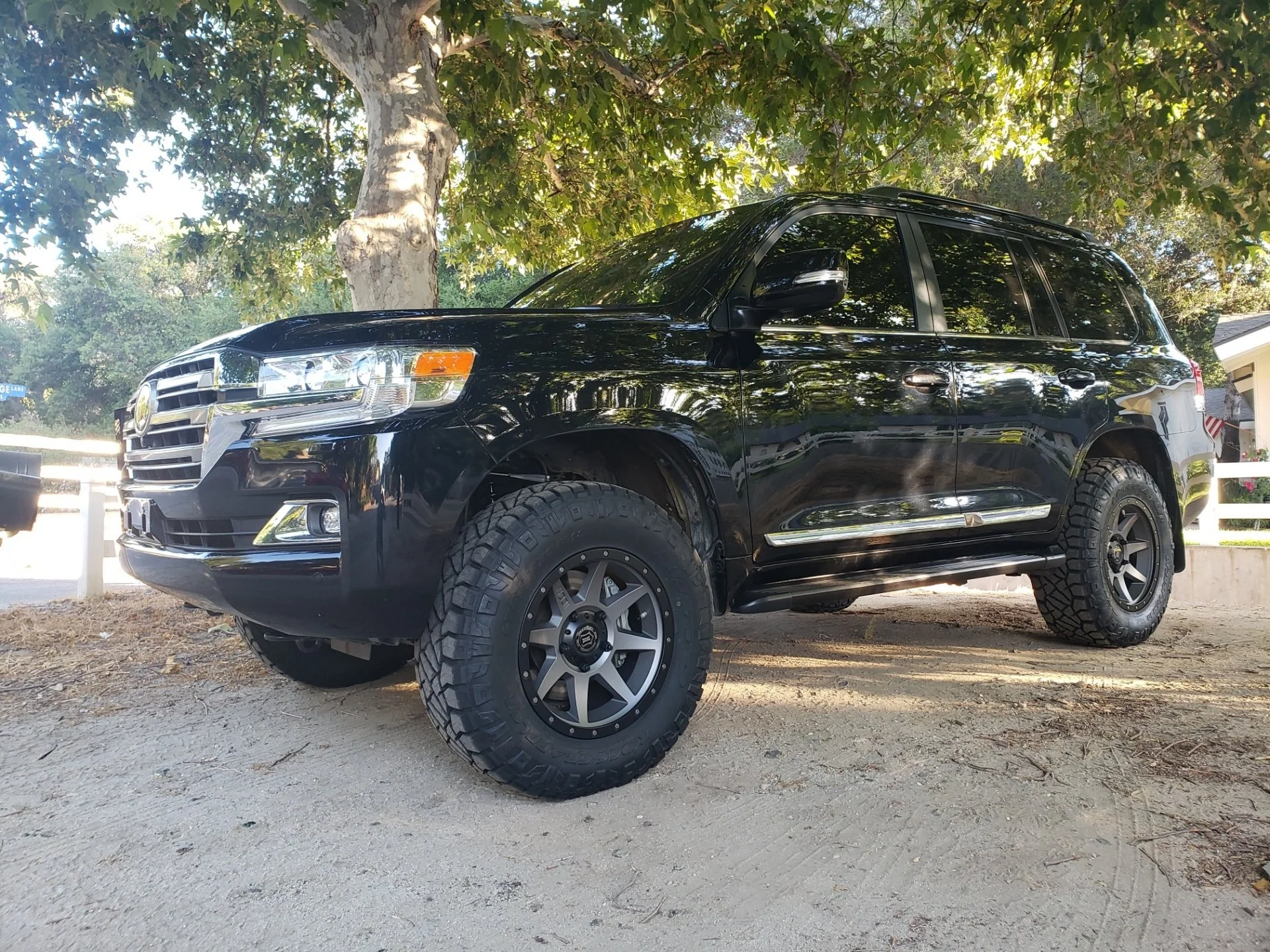

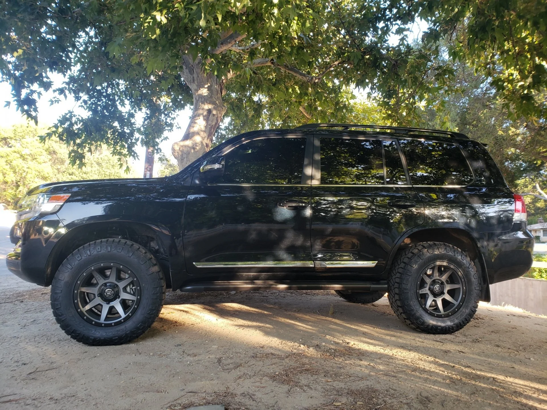

Got mine installed finally, 5th perch setting, love the look and it rides very, very well as expected from my previous Bilstein experiences.
Most likely going to change the tires out however, from 285/70 to 285/65 - it looks good but I won't notice 33" instead of 34"
Thanks @zennisplayer for giving me some guidance along the way.
Now for some protection for the bottom so the cats don't get stolen - lifting these makes that SUPER easy for the thieves.
@777Gage - Are you getting smaller tires because they are rubbing issues? Or more about looks/weight that is driving the change? Looks perfect currently;)
