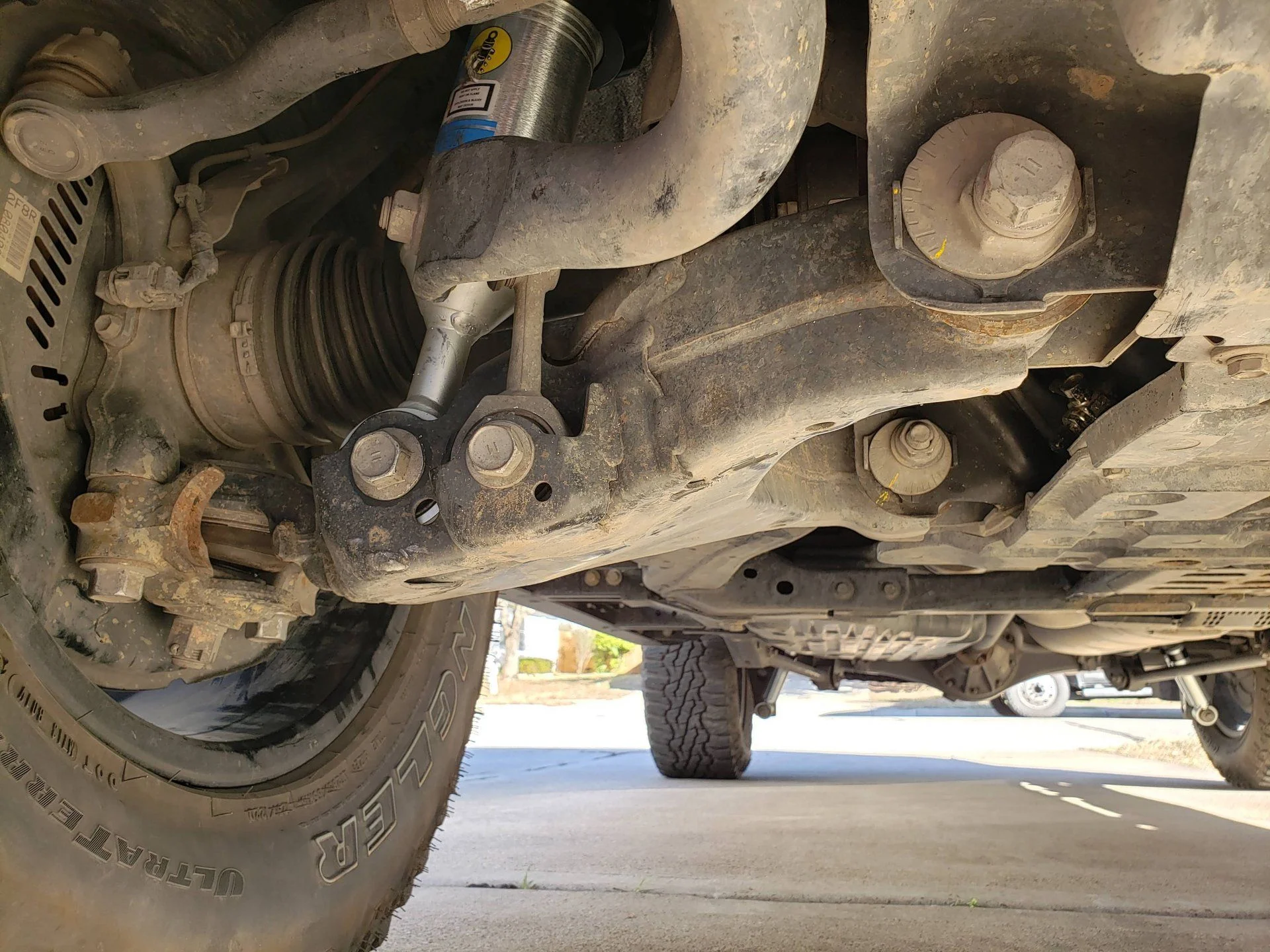

Bilstein 6112/5160 Installed
I'm glad I had marked the cams when I had installed the lift. Because it looks like the tech didn't touch the driver's side cams at all, and if I'm interpreting the cams correctly, the front cam is maxed out in the positive direction, so the tech definitely could have brought it in more negative if he had tried. Passenger side front cam is likewise nearly maxed out in positive direction, could have brought it more negative, but he didn't. Here are pics of the cams where I had marked them (in yellow).
I've done the calculations on how to bring it in based on this: Toyota Land Cruiser: Front wheel alignment - Suspension & Axle - http://www.tlacruiser.com/front_wheel_alignment-527.html and I'm tempted to do that part myself, and then take it in to them to get it aligned a 2nd time (no cost) - all this just to get the caster where it should be.
Passenger side:
Driver side:
Do you have UCAs? If not they may be able to get it better but still not quite in spec.
I’d bet the side they moved isn’t torqued to spec either. The number is quite high and most of these shops go by feel.. well, ours feel very very tight when it’s correct.
I’ve had good luck with Jerry’s alignment shop in pflugerville, and I drive up there from south Austin. Great guys and very cost effective. Just make sure to ask for the printout ahead of time, and to torque the nuts to spec. 207ft-lb.

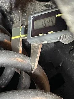

nolamule,
Now I understand. I'll go put a caliper on the 2021 HE 3rd row spring today. With the naked eye the 2021 3 row HE spring looks thicker and shorter than the 2020 2 row HE spring but I'll get a real measurement for you.
Robert

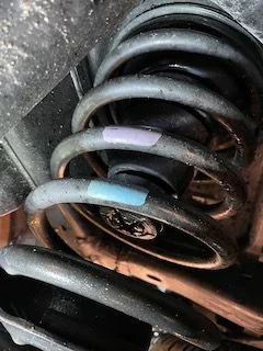

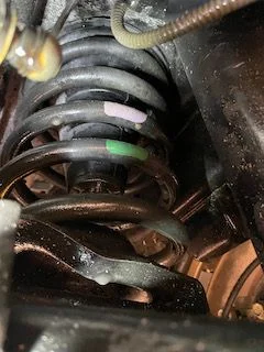

Nolamule, sorry we had a bit of an ice storm and I didn’t get to the lift until today. I took a couple pictures and some measurements. I seem to remember someone had these paint marks on some base springs, Maybe Eric Sarjeant posted a picture? I am terrible at searching this forum. In any case I'm waiting for my Bilstein order and then I'll get whatever measurements I can.
Left Rear
Right Rear
Left Rear
Right Rear
