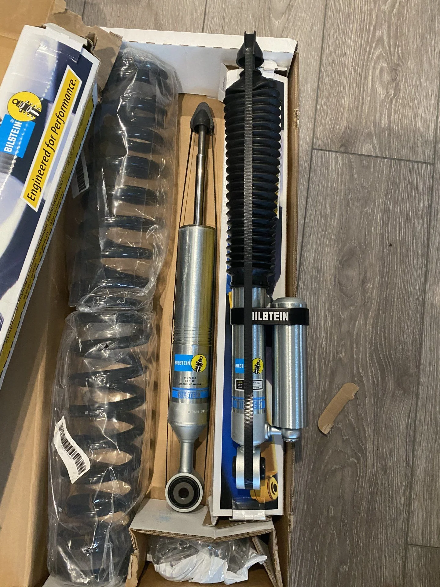

Bilstein 6112/5160 Installed
We stock a great deal of Bilstein for the older applications (4x/5x/6x/7x and some 8x) but I've really never entertained it for the 100/200 as there are plenty of great options out there from OME, Dobinson, Tokico, Icon, King, etc and anything else is just an answer in search of a problem for our customer wants/needs. Happy to revisit of there is demand but to-date we've sold hundreds of suspension kits for the 200 and never had someone ask about Bilstein :D
Maybe it’s because it’s such a new kit (just released last year) that there isn’t as much buzz around it?
It’s here!!

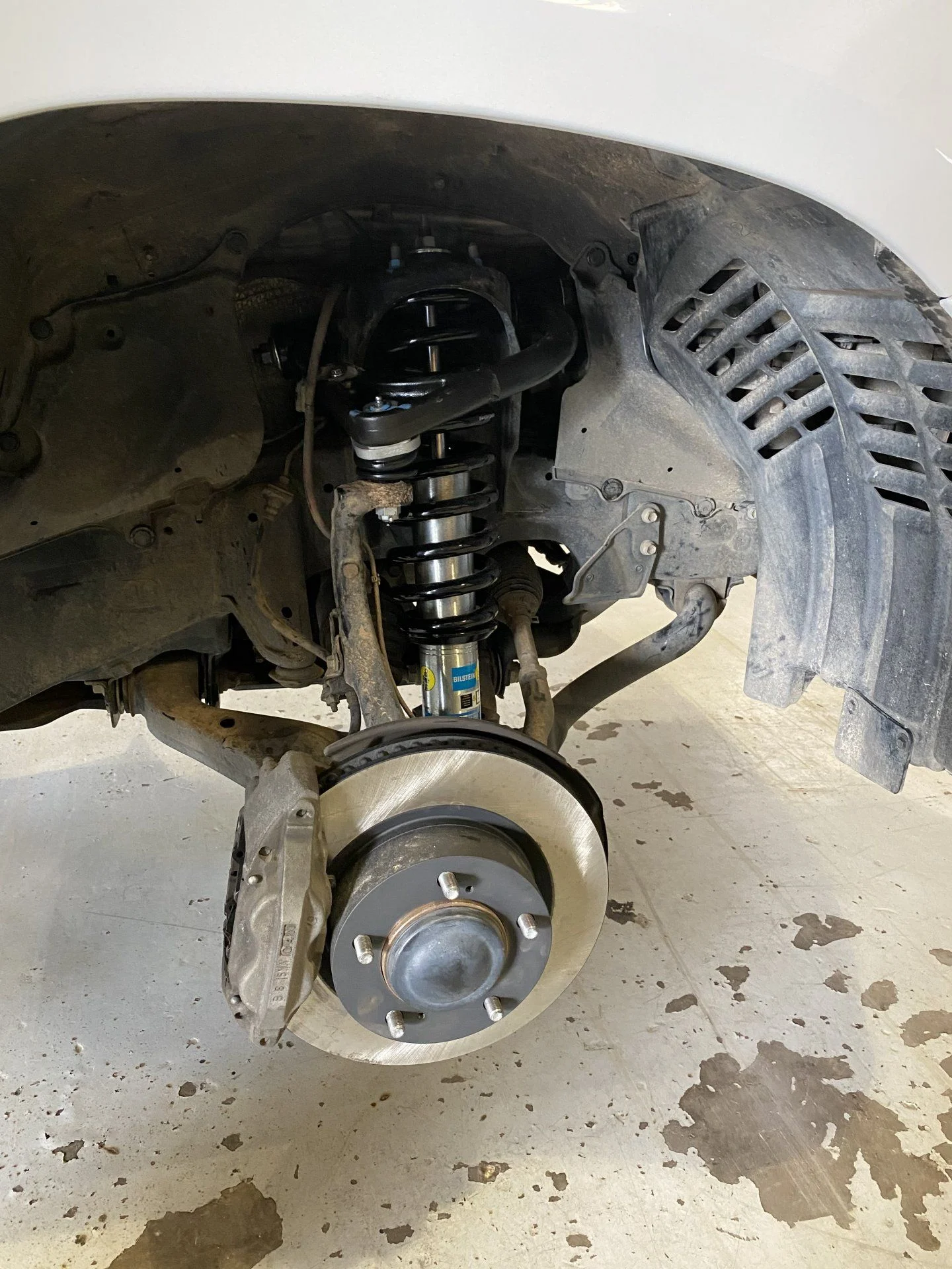

I went with the OME UCA’s. I know that most people aren’t doing UCA’s but I want to go up to the top perch which will get me a 3” lift. I haven’t read about anyone going to 3” let alone 3” without UCA’s.
I usually try to avoid things that aren’t necessary but in this situation, I didn’t want to risk it and because I plan on keeping this rig for a long time, it just made sense. I could justify the additional $560 especially once I saw that the install is not too hard, decided to take the leap.
also, I liked that the OME UCA’s were not excessively adjustable (SPC) and not ones that required regular maintenance like the Total chaos ones.

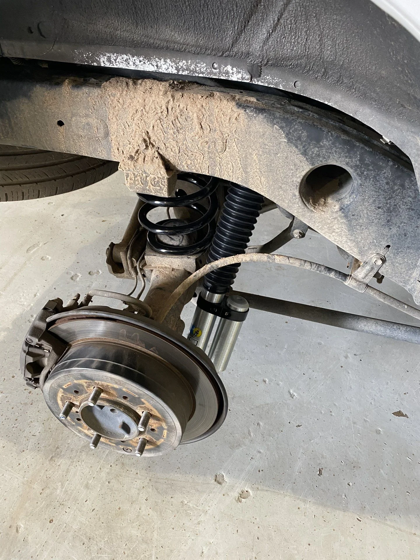

Well I do love DIY as I assume many of us here do too....also, knowing that you've done the work yourself and having some sort of a sense of accomplishment and knowing you've done the work as properly as one can. To be honest, I'd tackle this at home with the tools I already have BUT I figured I wanted to use a lift and use a proper spring compressor. Most shops quote 4-5 hours of labor too and being a former Boeing mechanic, I figured I could knock it out in a similar time frame.
