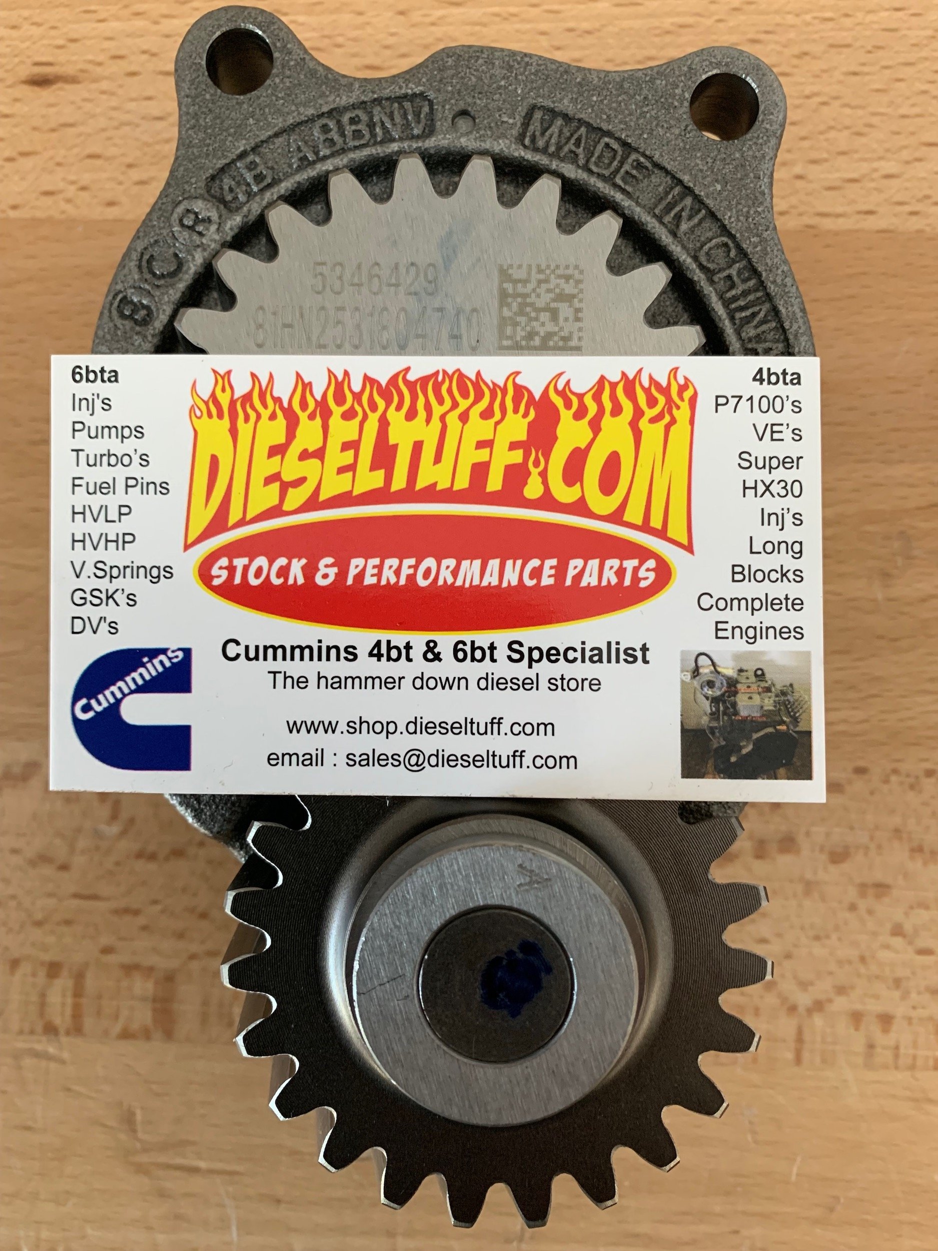

Found this, does anyone know of a better one? Been saying the Cummins forums but nothing definitive. Kinda leery about it made in China, but i guess that's the way of the world now.
Seems like it's best to find a high volume pump for a 6bt
