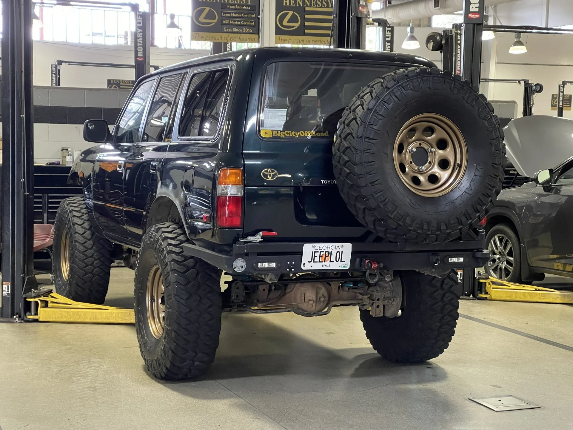

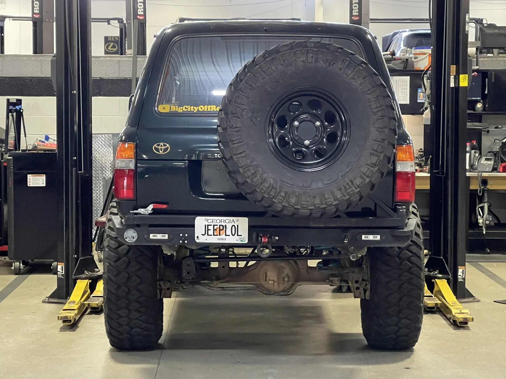

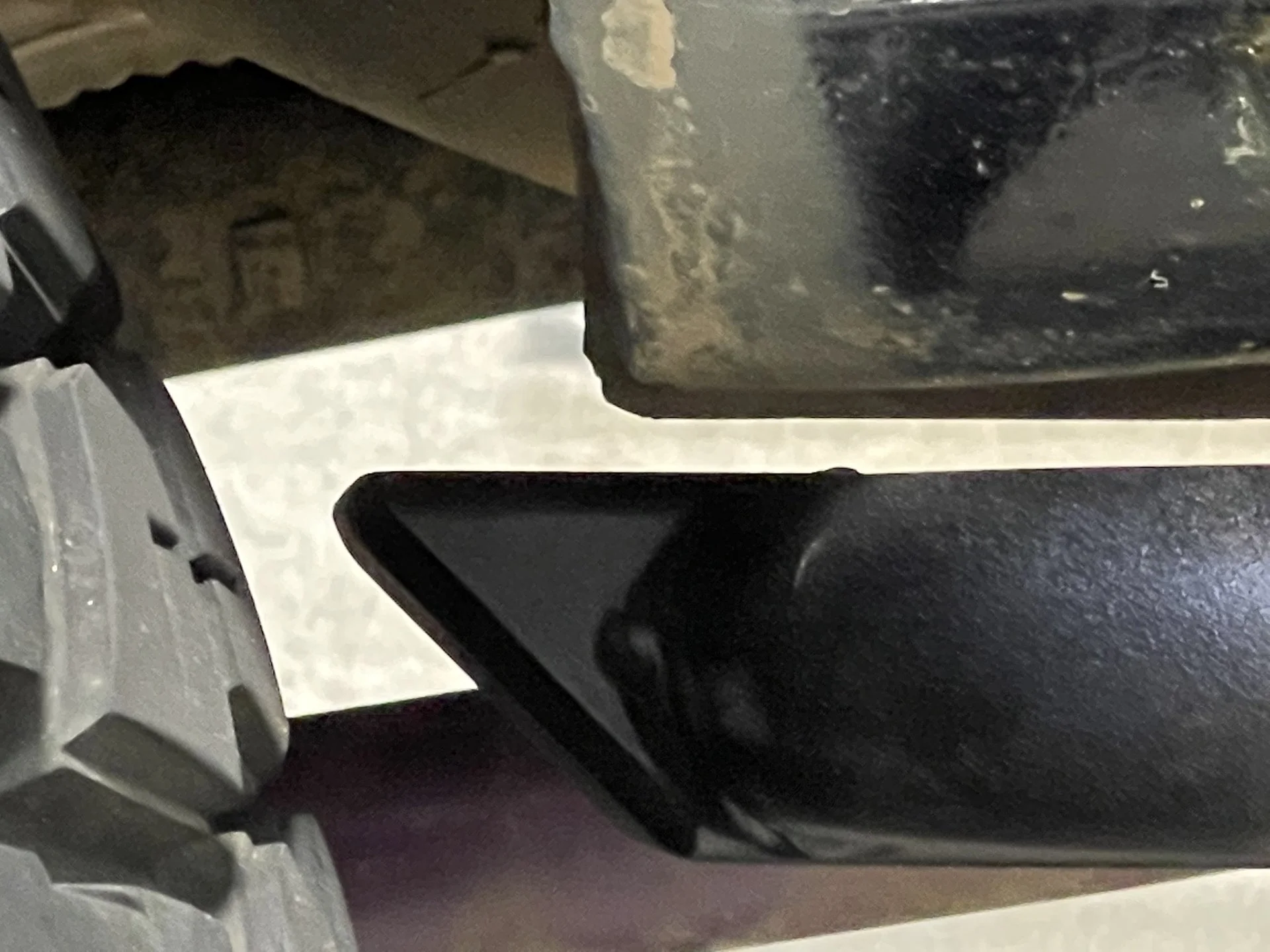

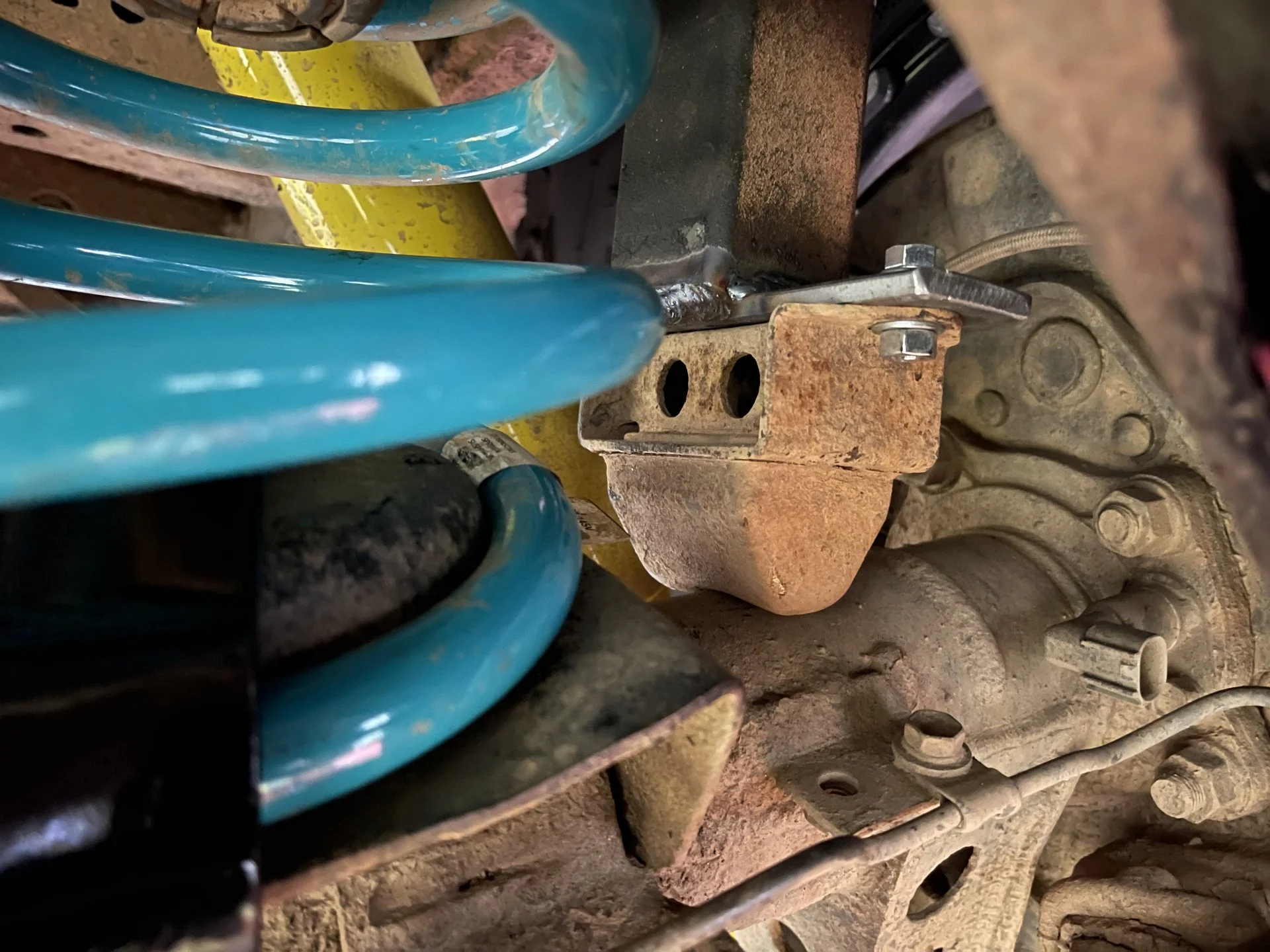

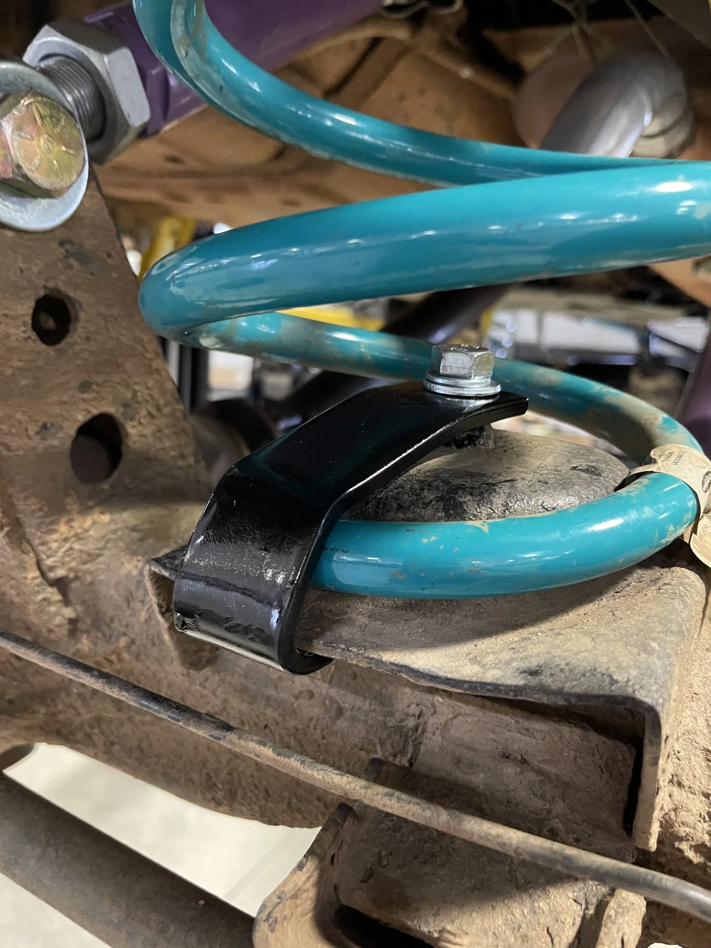

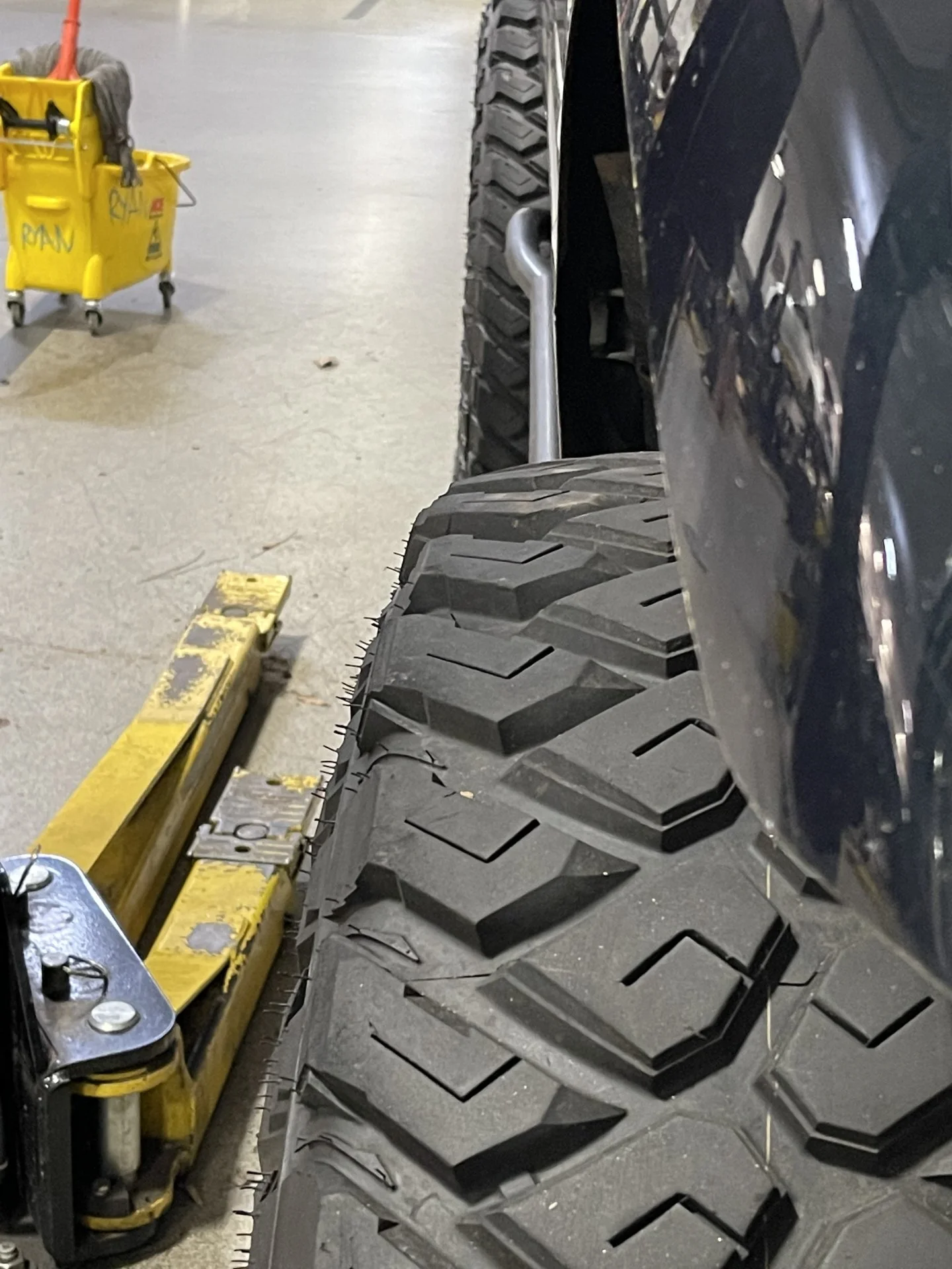

Today i set my rear pinion angle, which i can do because of the arms i built. I had a 6 degree difference between the t-case output and the rear diff. I took 3 degrees out by shortening the uppers and the other 3 by lengthening the lowers. Now i dont have any horrible roaring noise on deceleration..

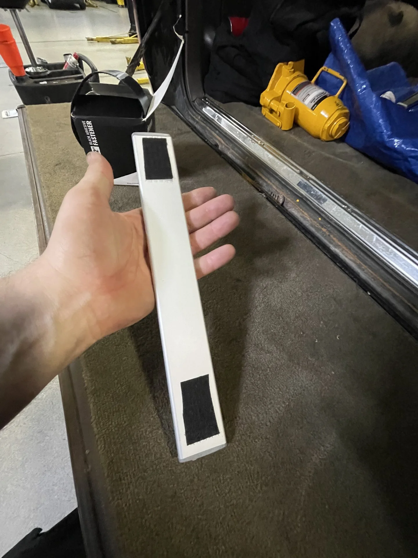

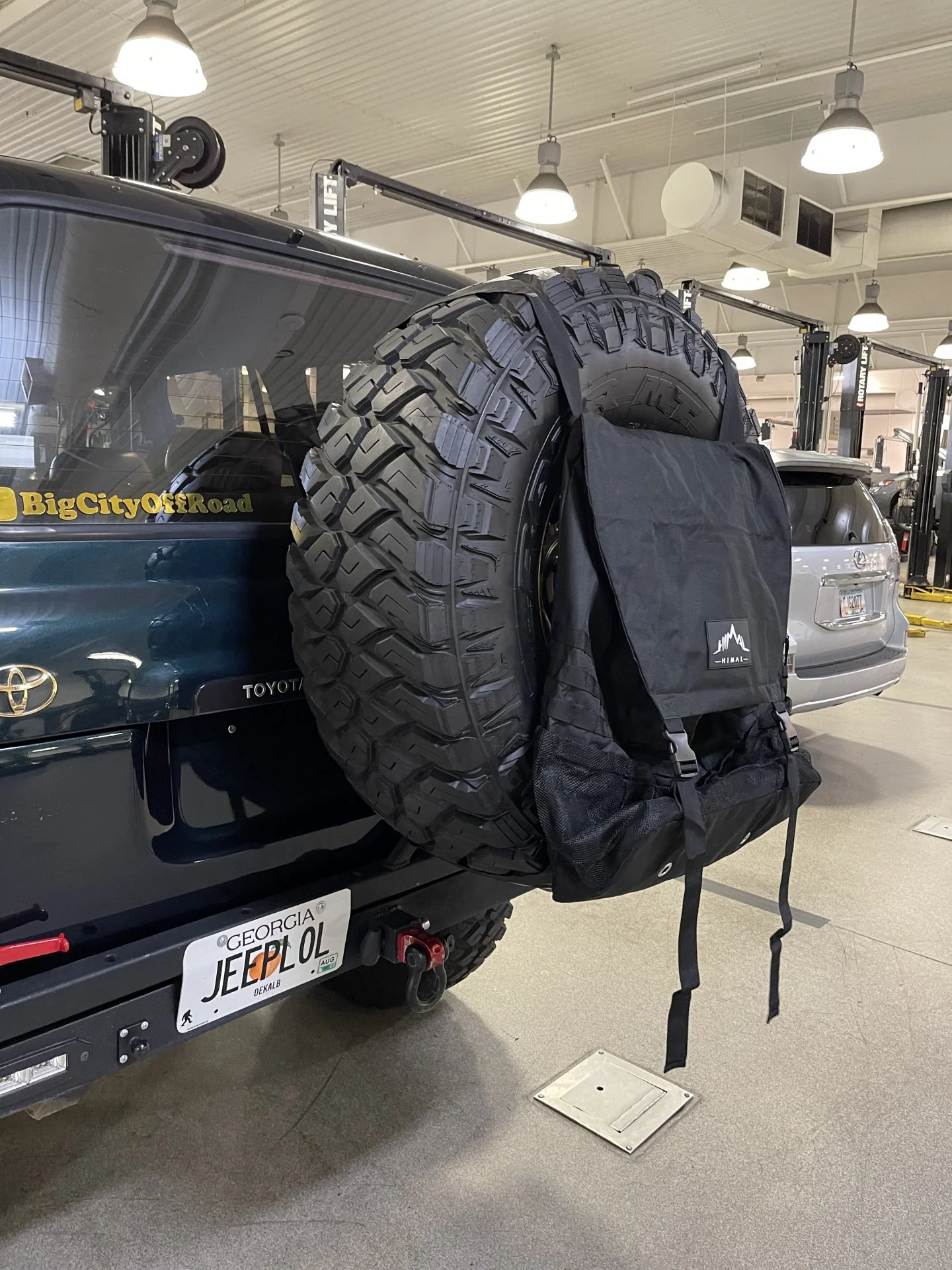

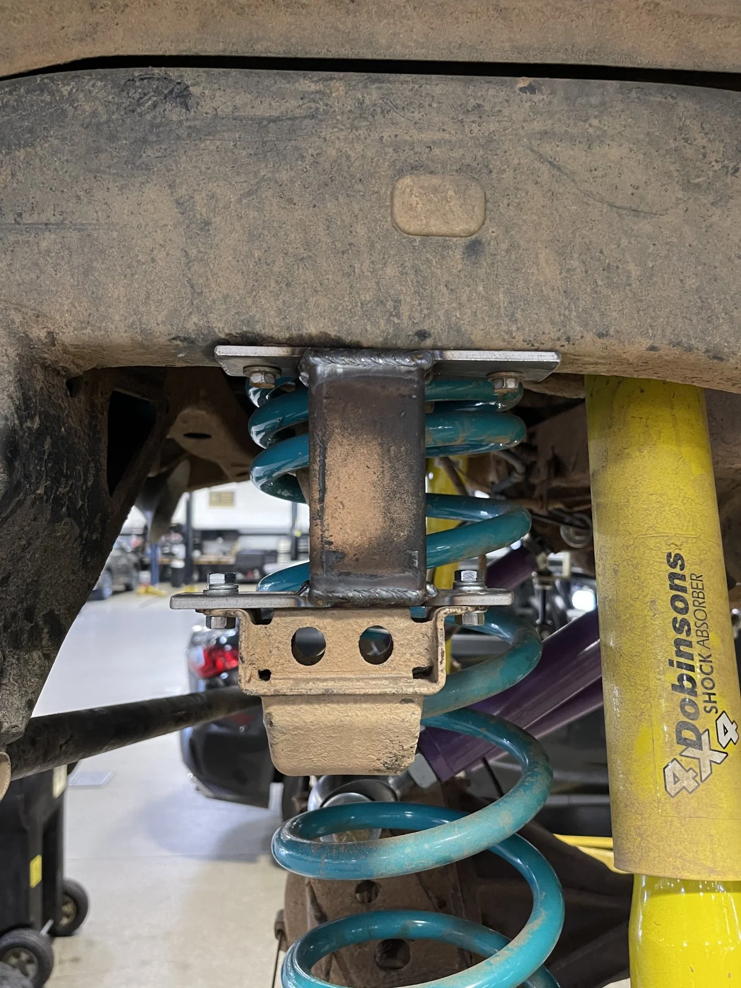

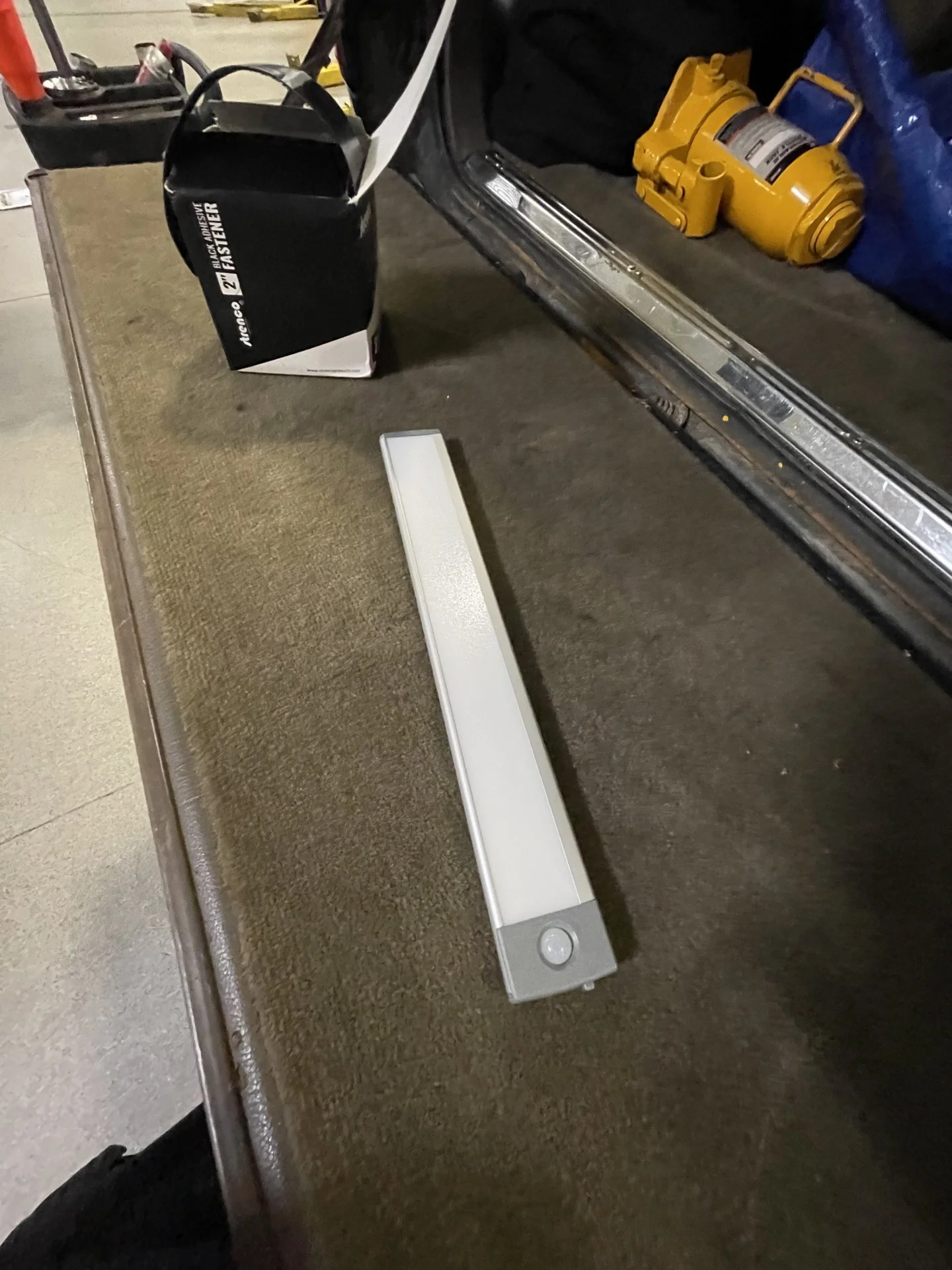

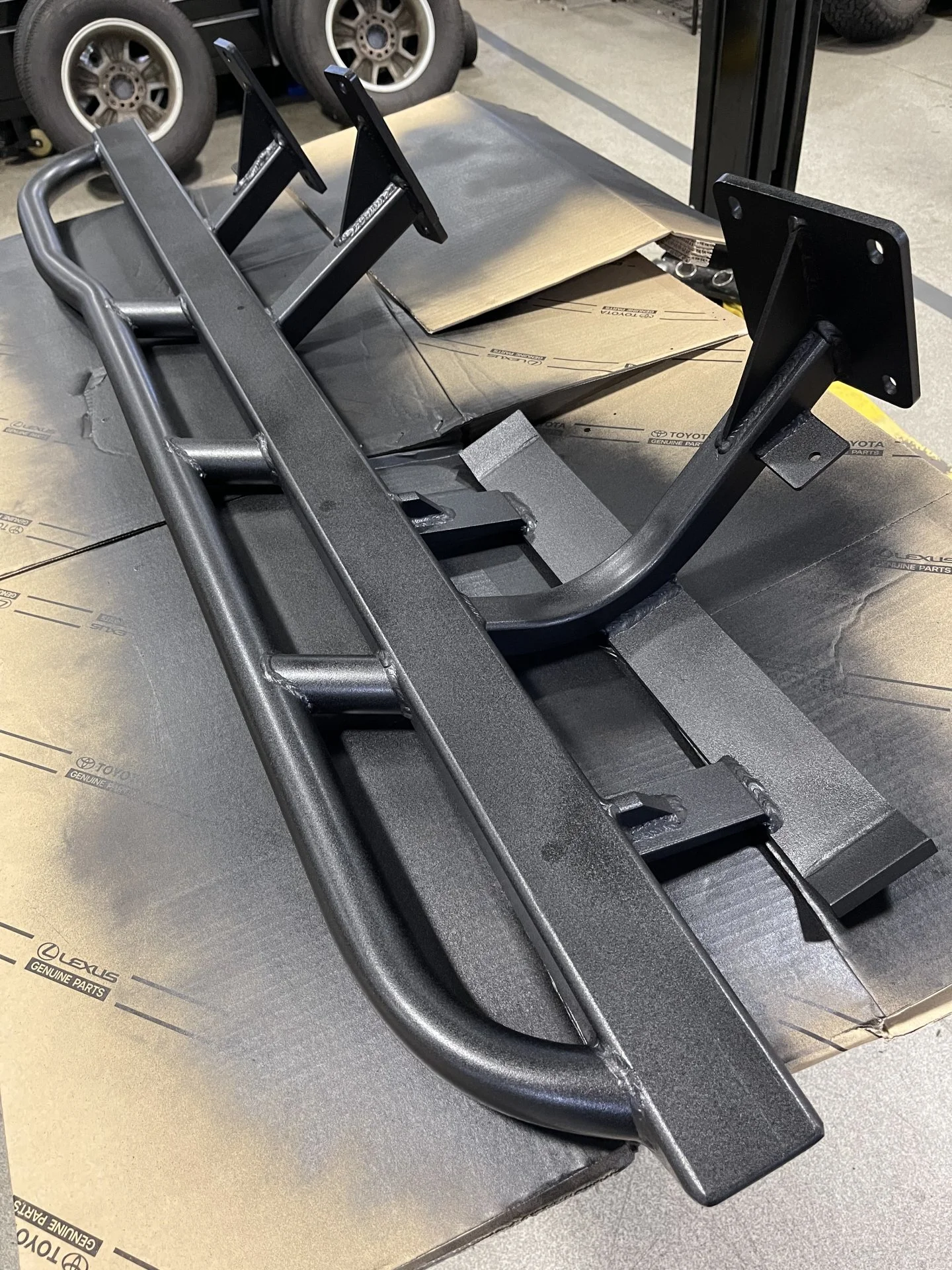

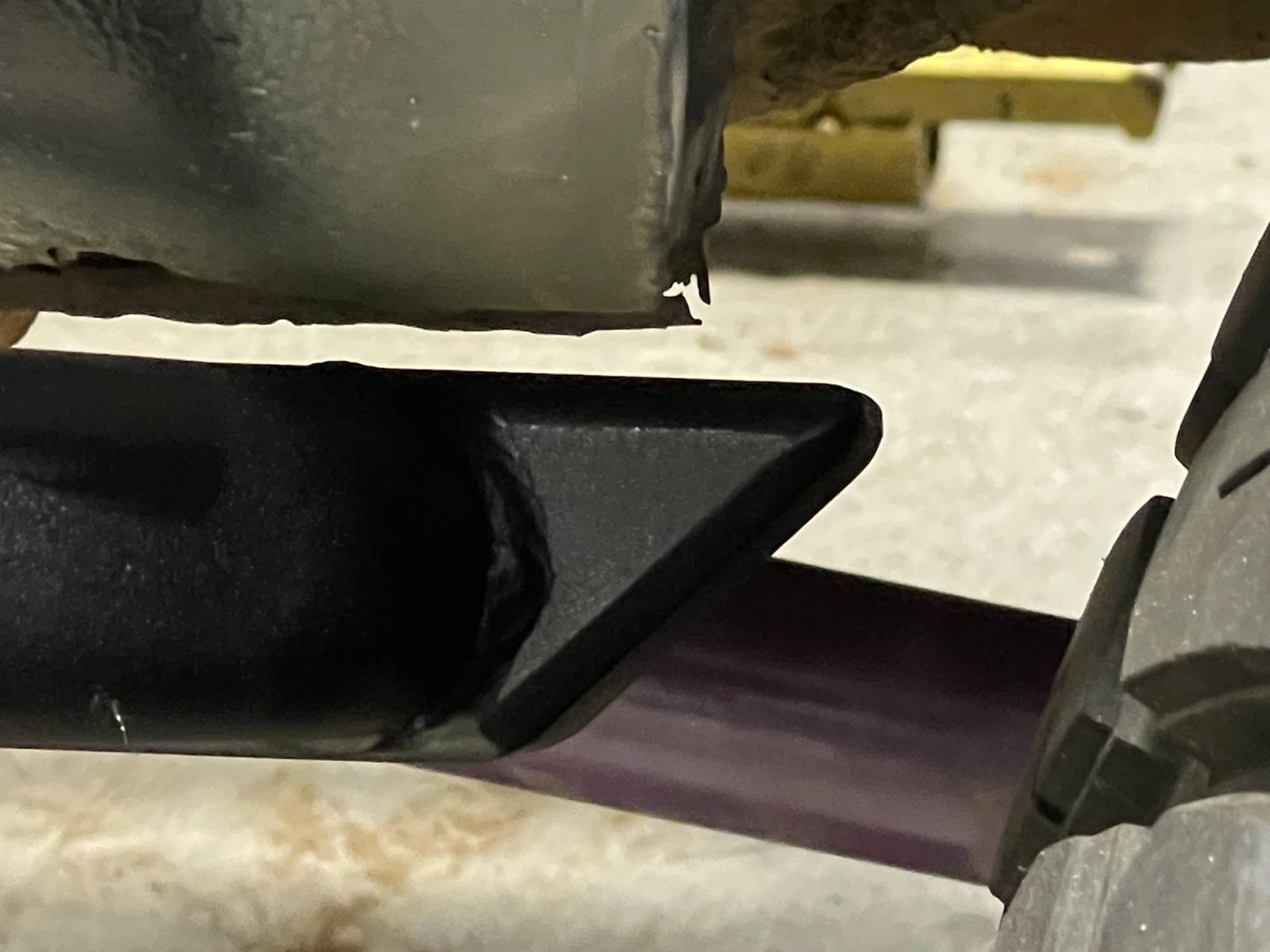

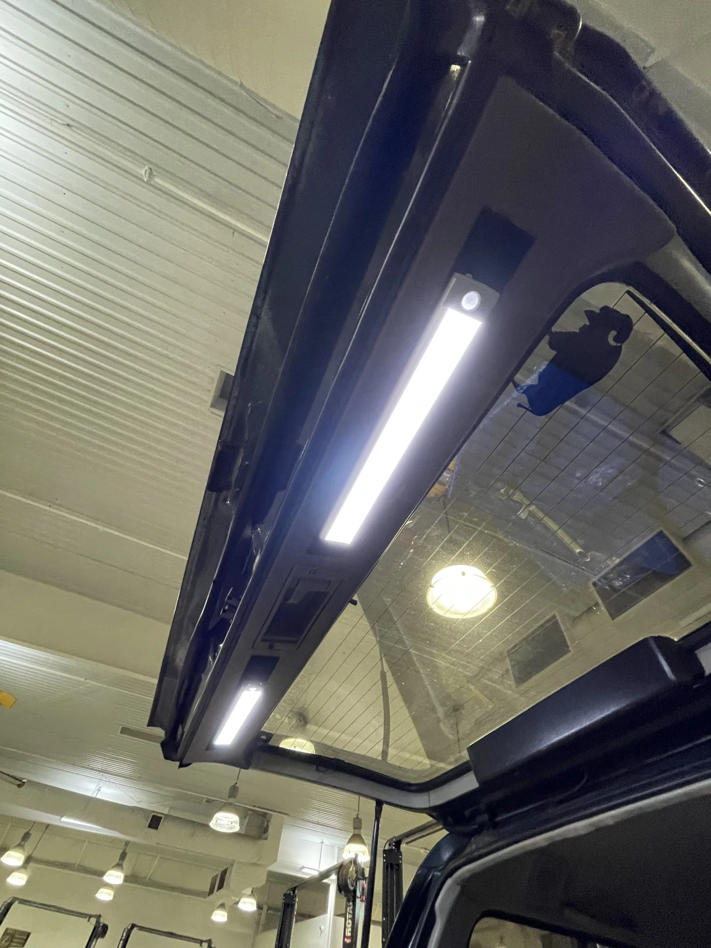

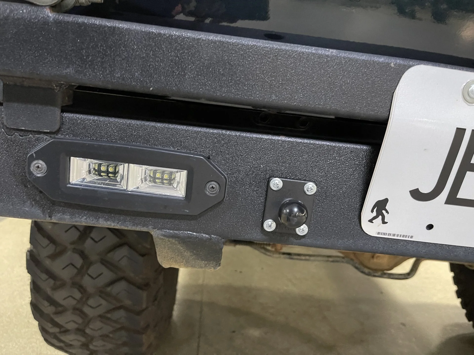

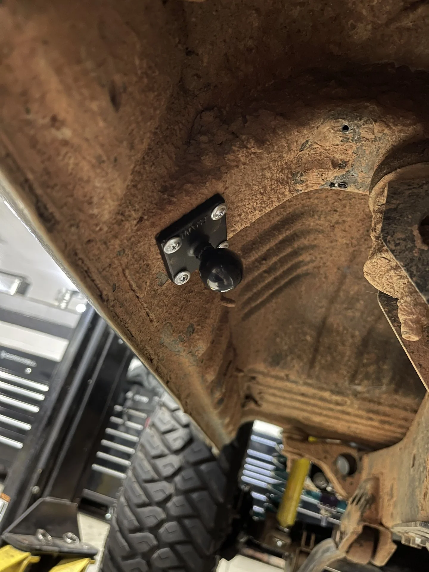

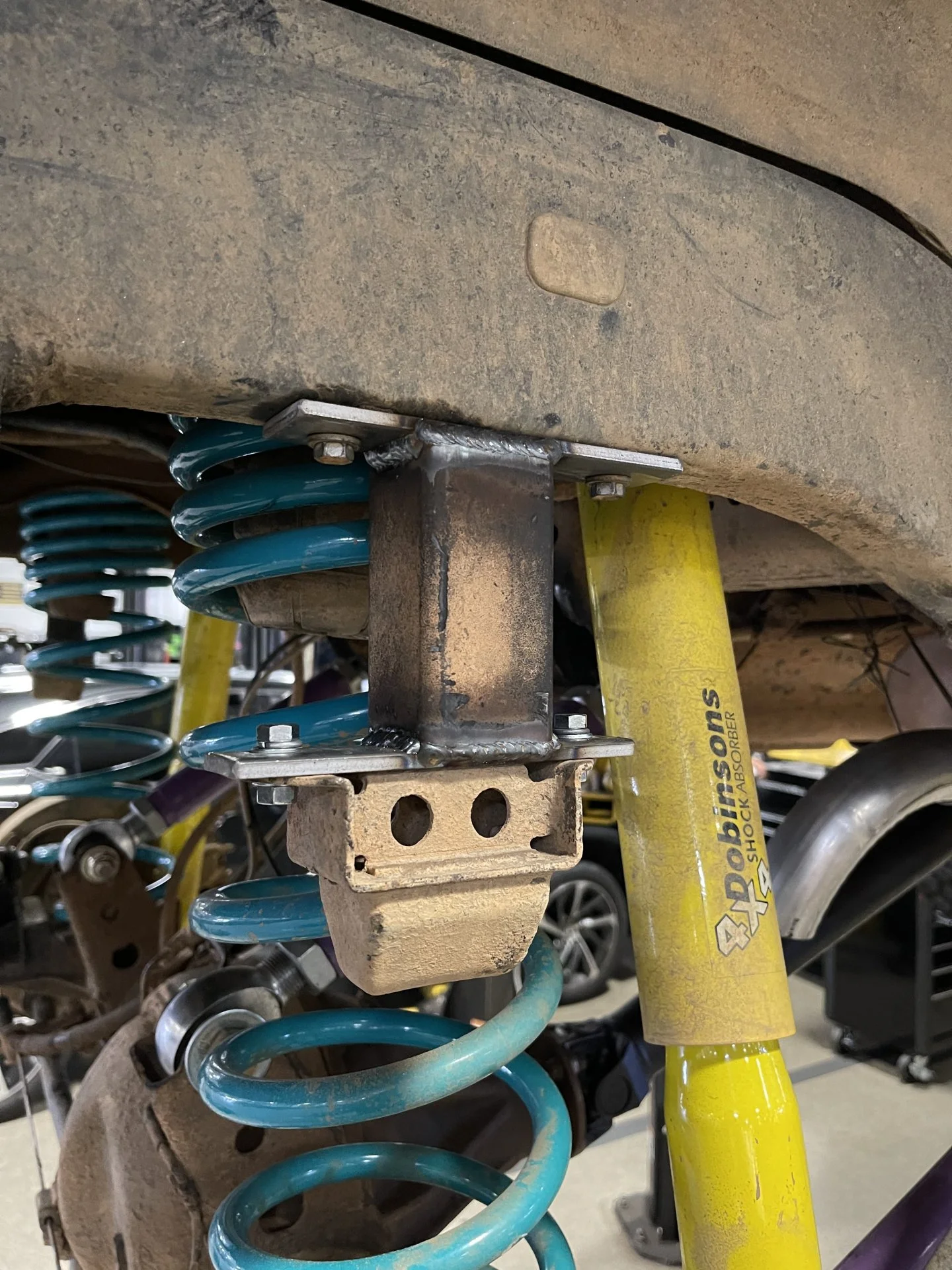

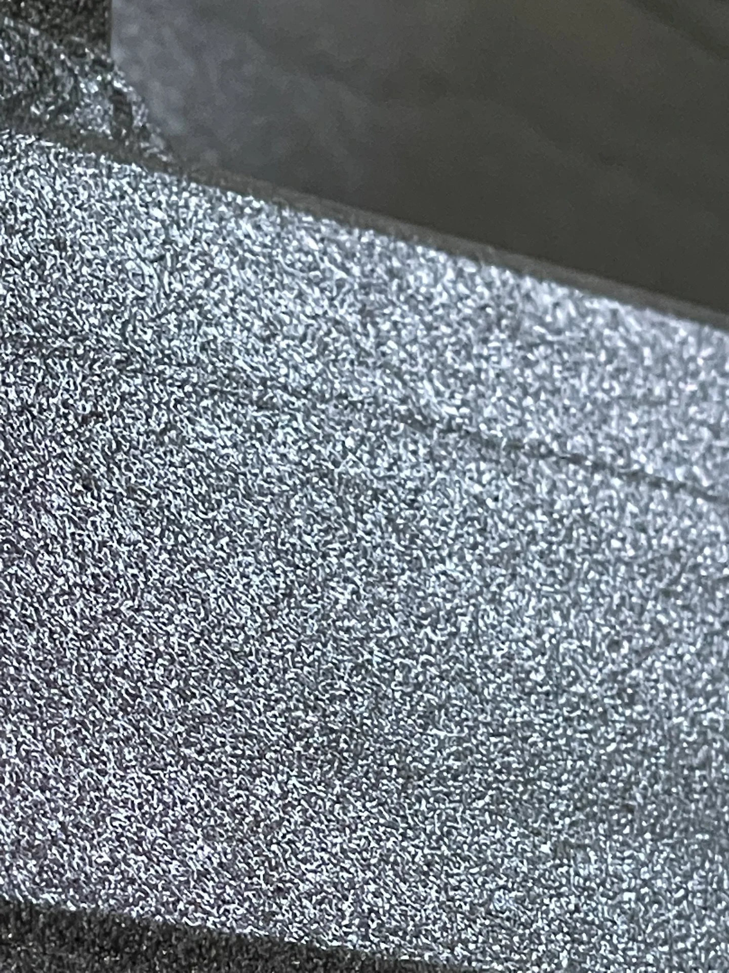

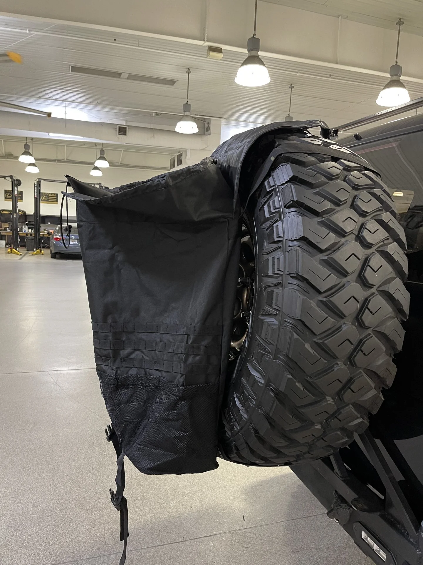

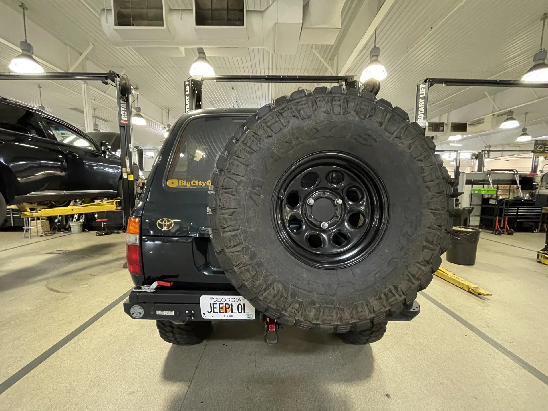

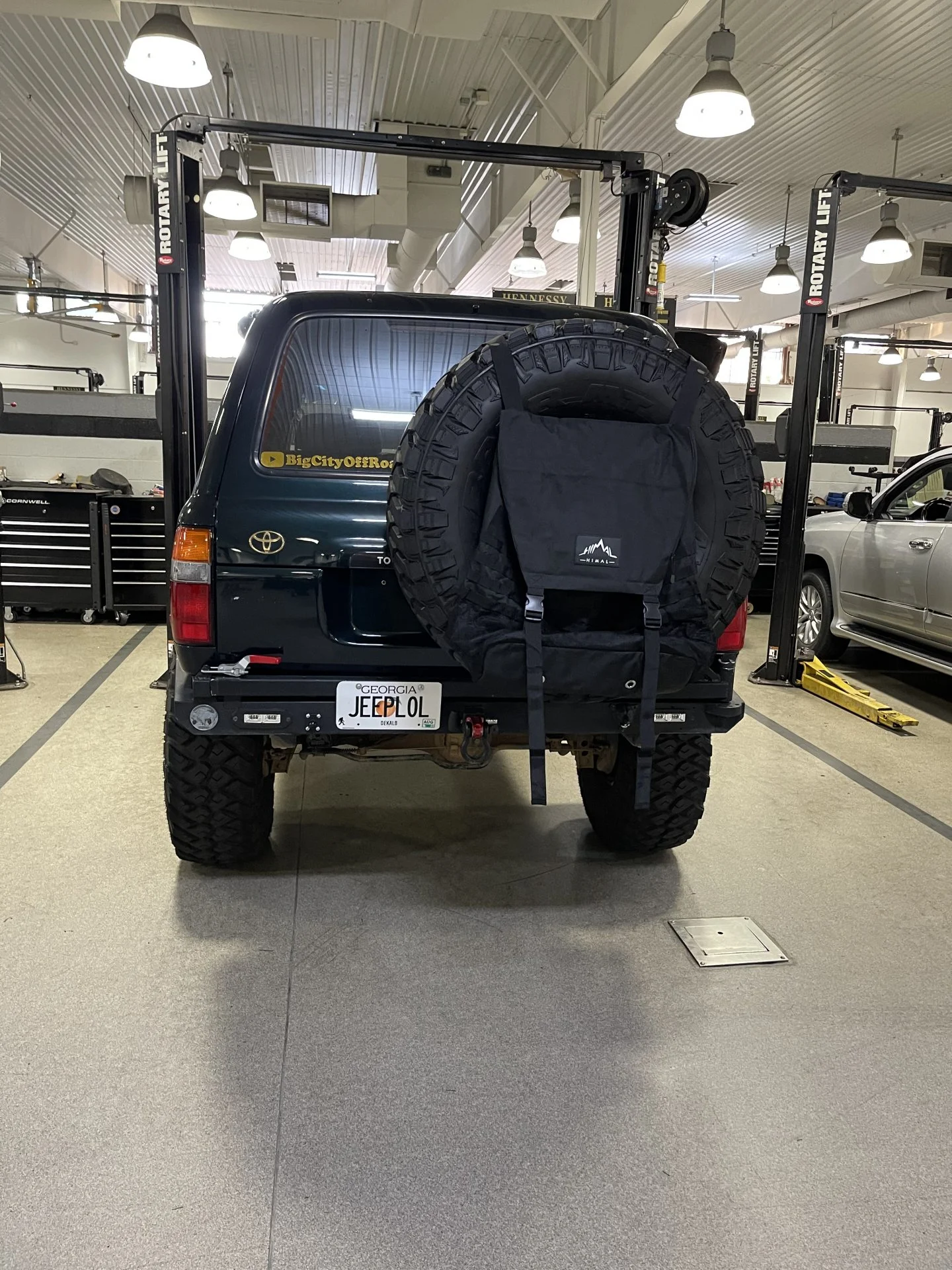

I also added some lights to the hatch for an upcoming camp/wheeling trip. I also made and installed some quickie bump stop extensions to help keep the rear tires out of the body until i can get around to cutting the body again. I added some homemade spring retainers to keep the rear coils from falling out on the trail. I modified and reinstalled my swing arm and tire carrier..
View attachment 2808311View attachment 2808312View attachment 2808313View attachment 2808314View attachment 2808315
Link for the lights?
Here it is fellas

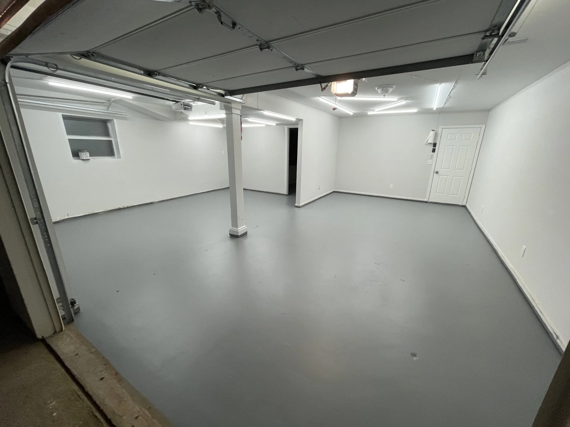

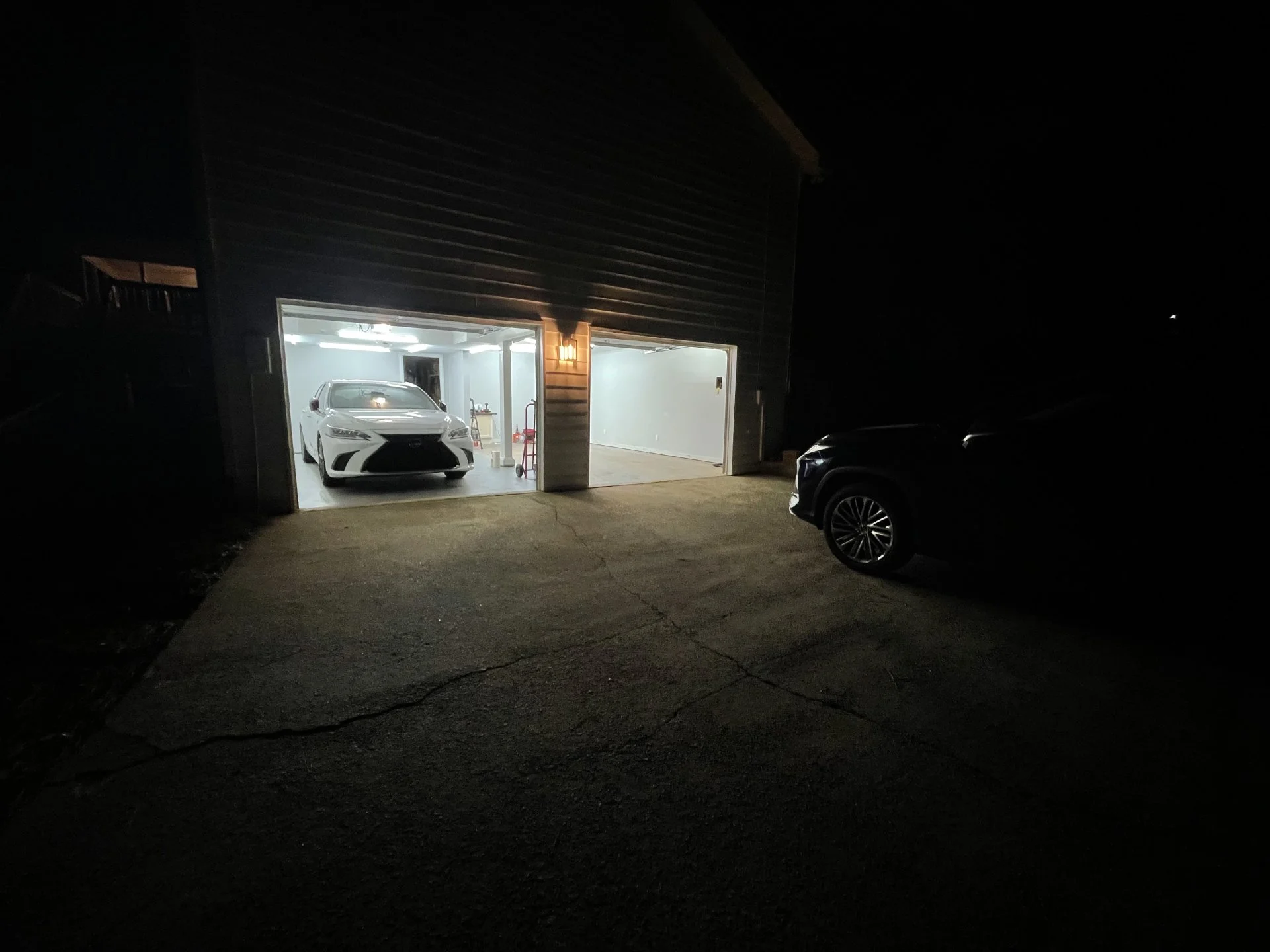

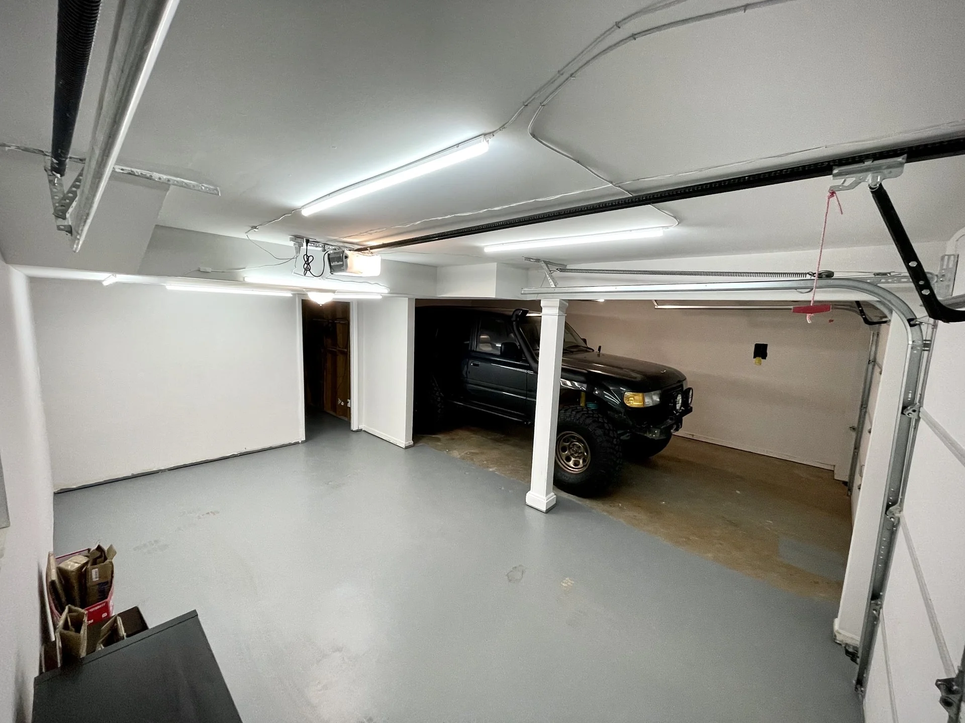

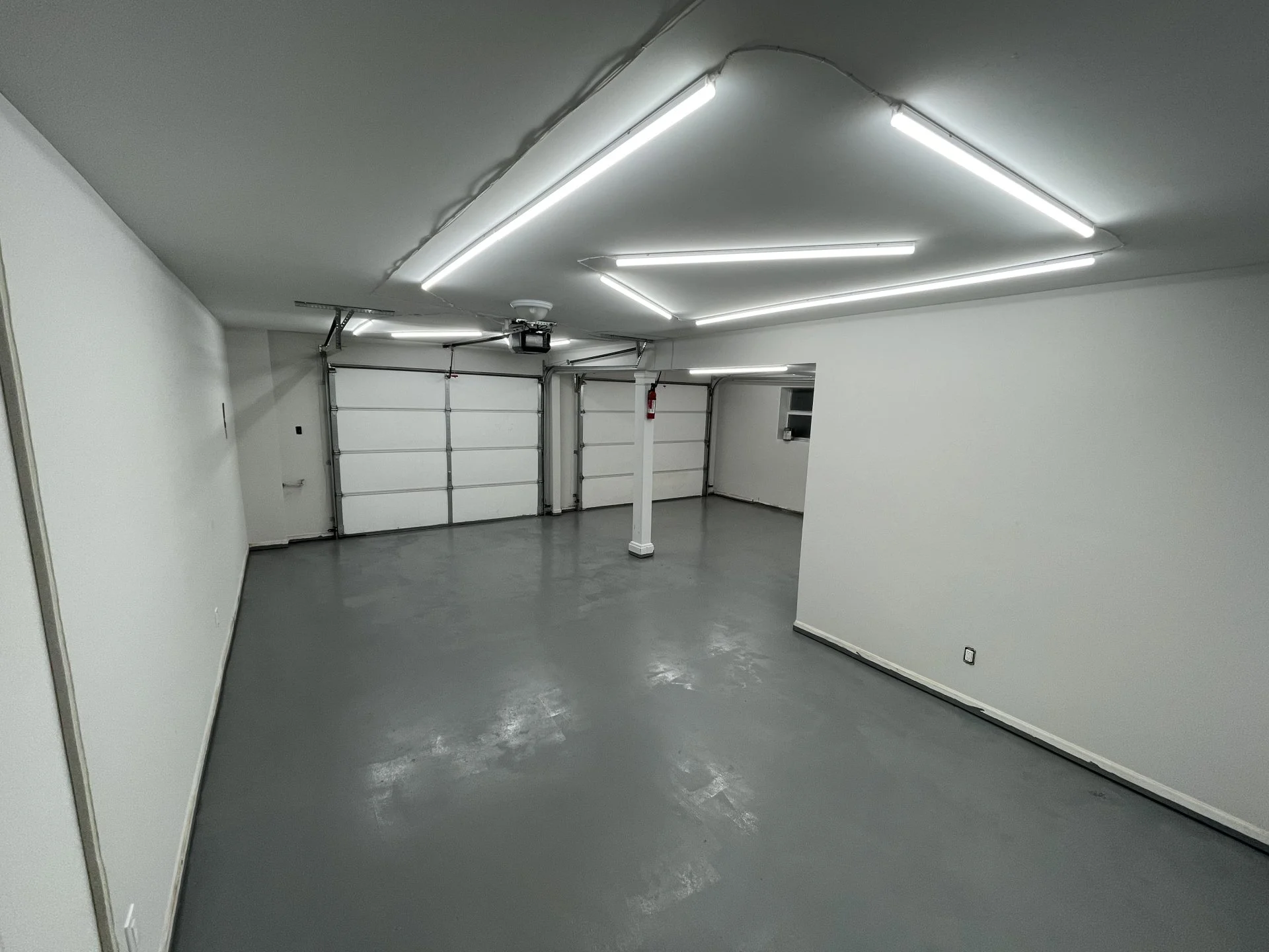

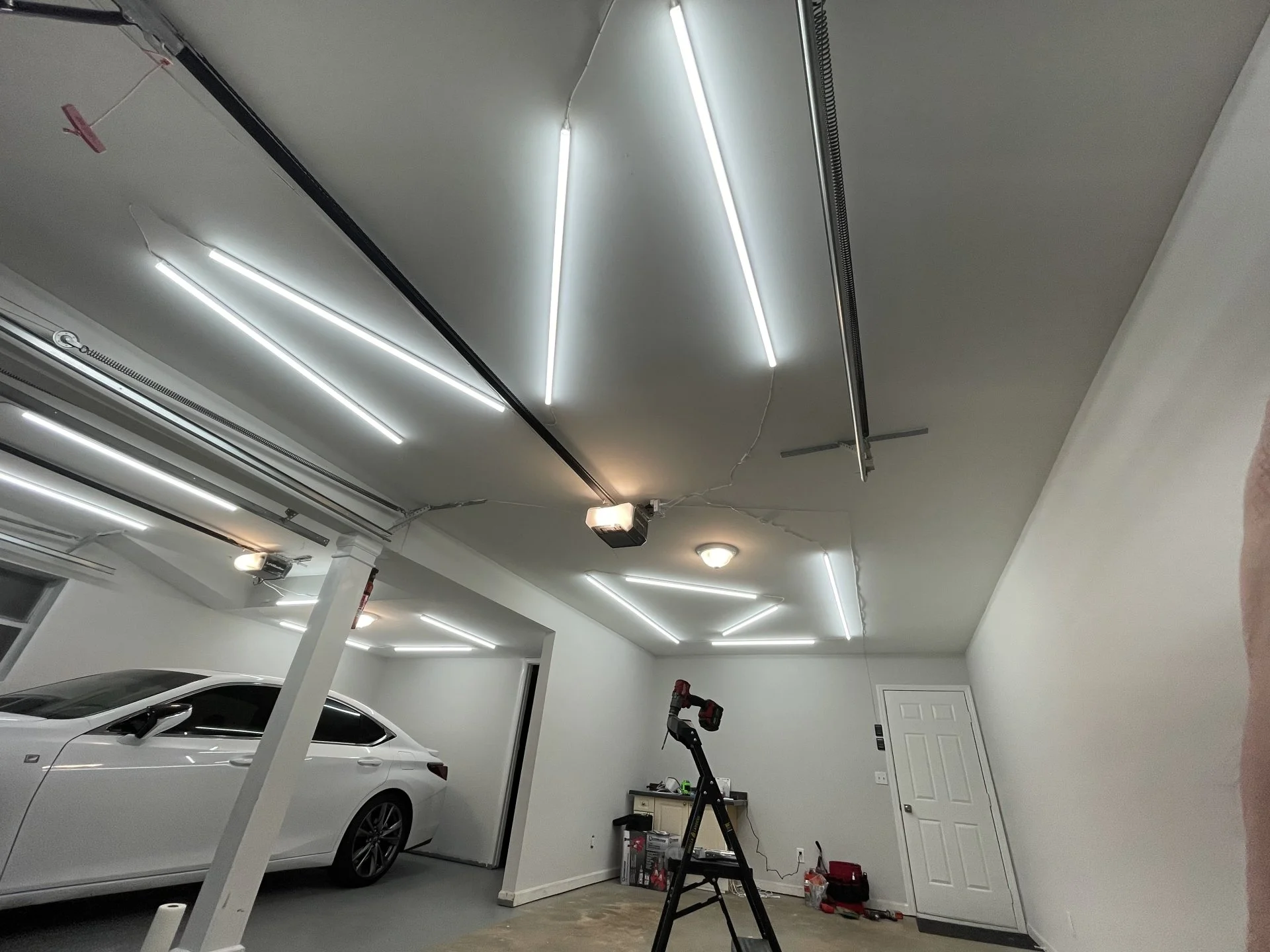

I bought a house.. truck is on the back burner for a bit, but least i have the space to do the big projects now ;)
Ive painted(and now partially ruined) half of the garage, and installed a third of my lighting system.. im excited to make this a little workshop while i build a 40’x60’ shop in the back yard..
That sure qualifies as an expensive mod. Congratulations!
Shop/garage looks good
Now get back at it we miss your posts ;)
