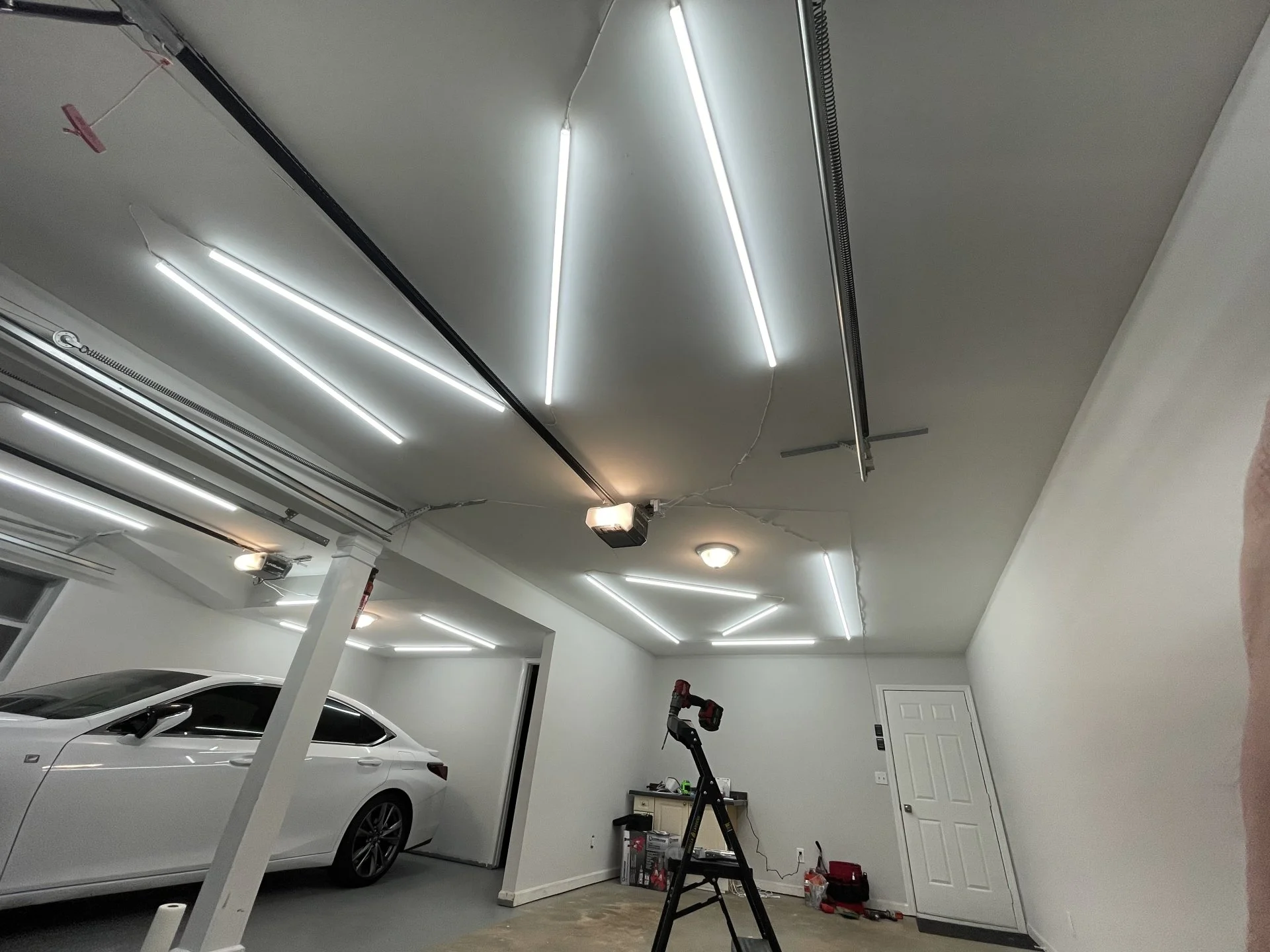

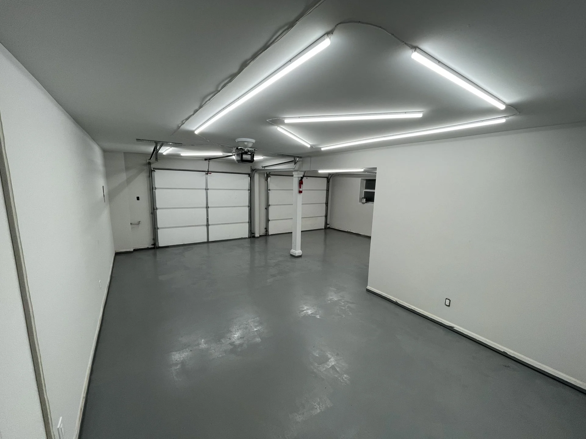

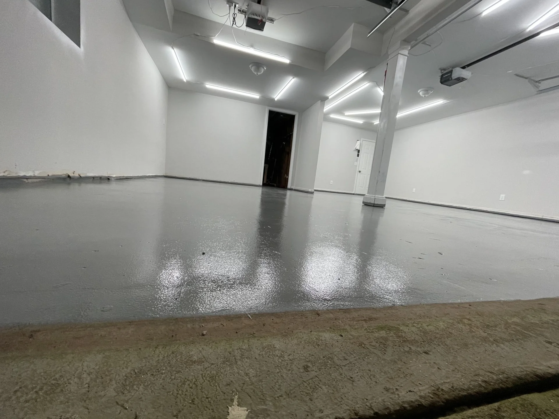

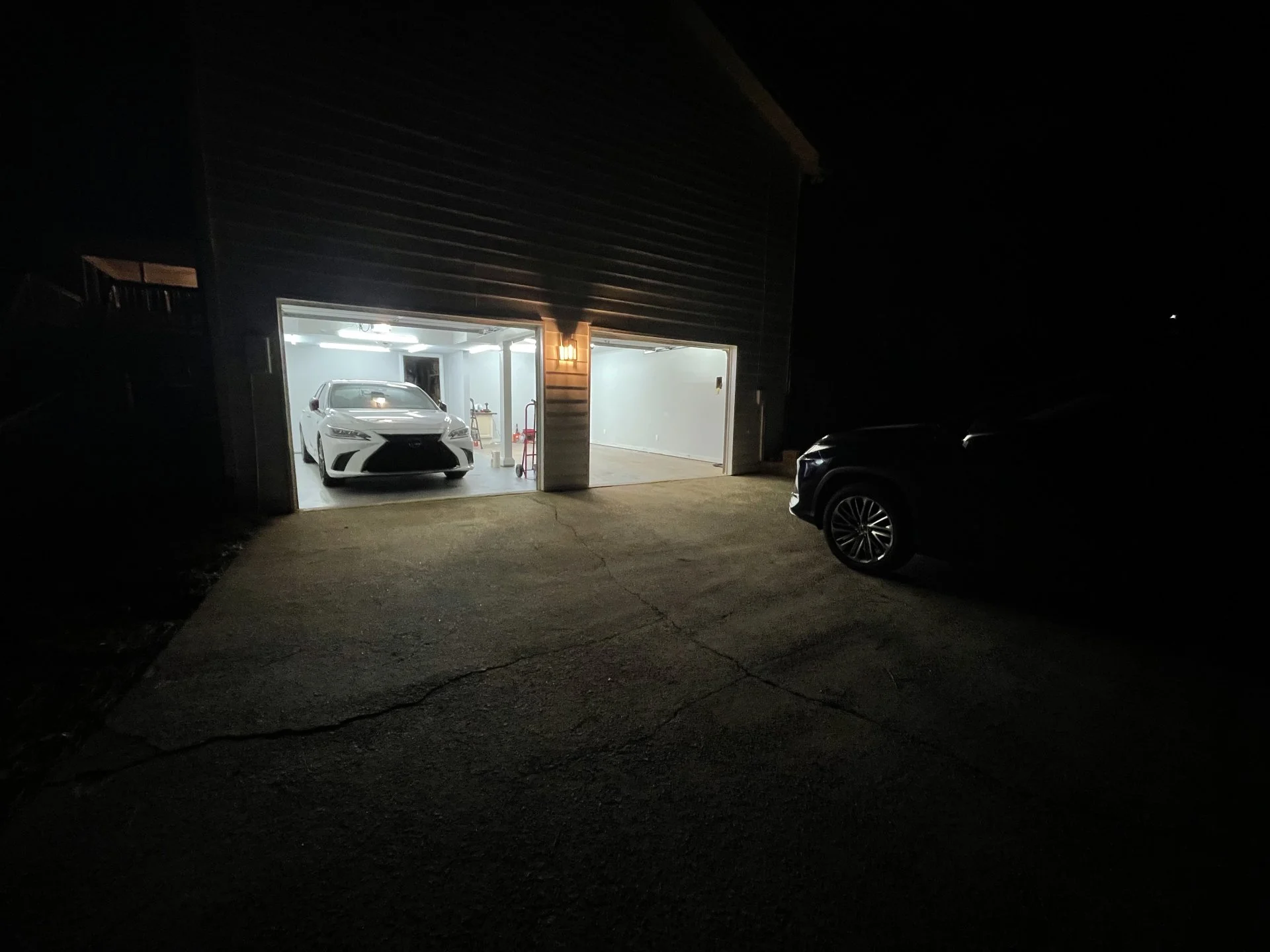

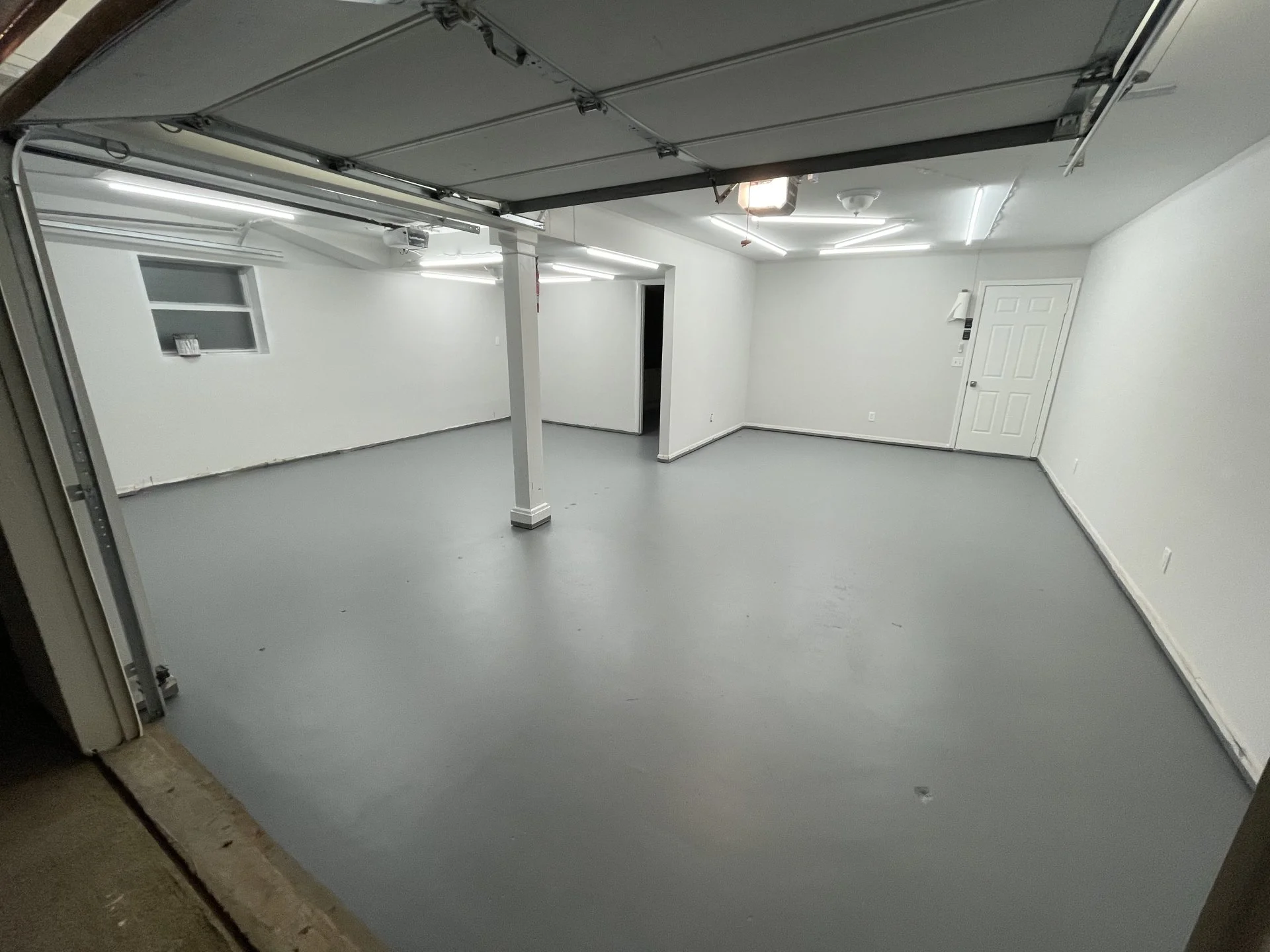

Behr floor paint, slate grey, 3 gallons covered 600sqft 3 times with a bit left over for touch up. I did zero prep other than a good leaf blowing, the paint is pealing under tire every time a car sits on it over night. It was never meant to be perfect forever but i wish i had done much better cleaning and prepping before painting.. time was a huge factor too, but majority of the garage will look nice for a long while. Otherwise theres gonna be a bunch of projects going on in there, it was never going to stay nice anyway..
Eh, wouldn't matter if you prep and etch the floor. It'd still peel from vapor pressure due to moisture under the slab, unless you have plastic under the slab which is almost never installed in a garage.
I'm a big fan of polishing and densifying the slab. Polishing makes the floor super smooth to wipe stuff off and densifier seals the pores without stopping the floor from breathing.
All of that's super helpful now you've painted I'm sure!

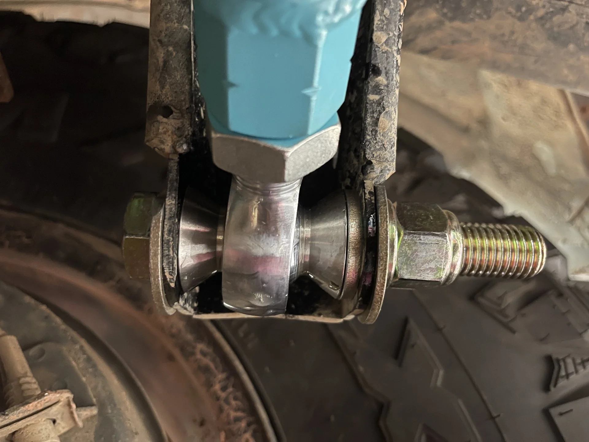

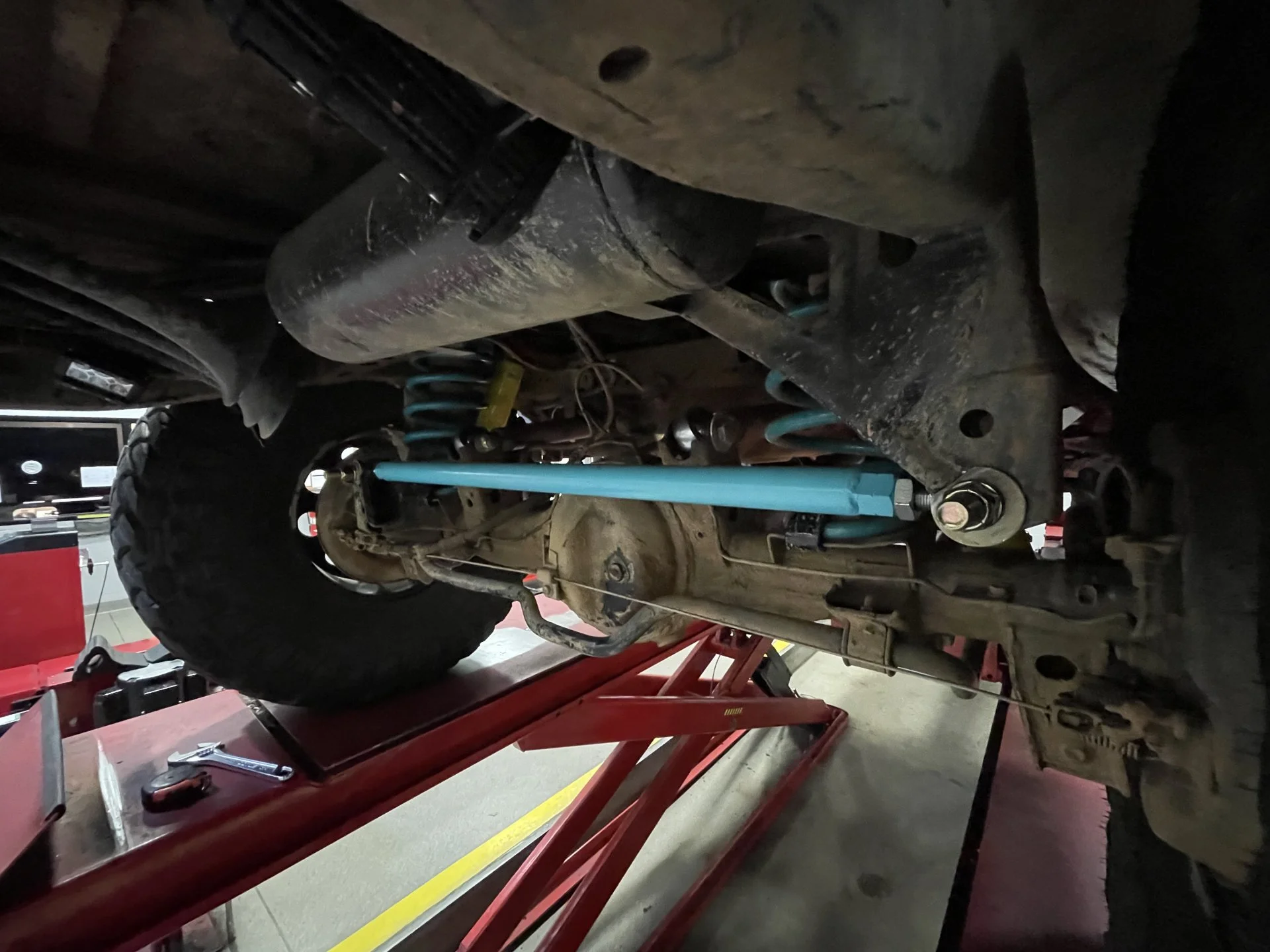

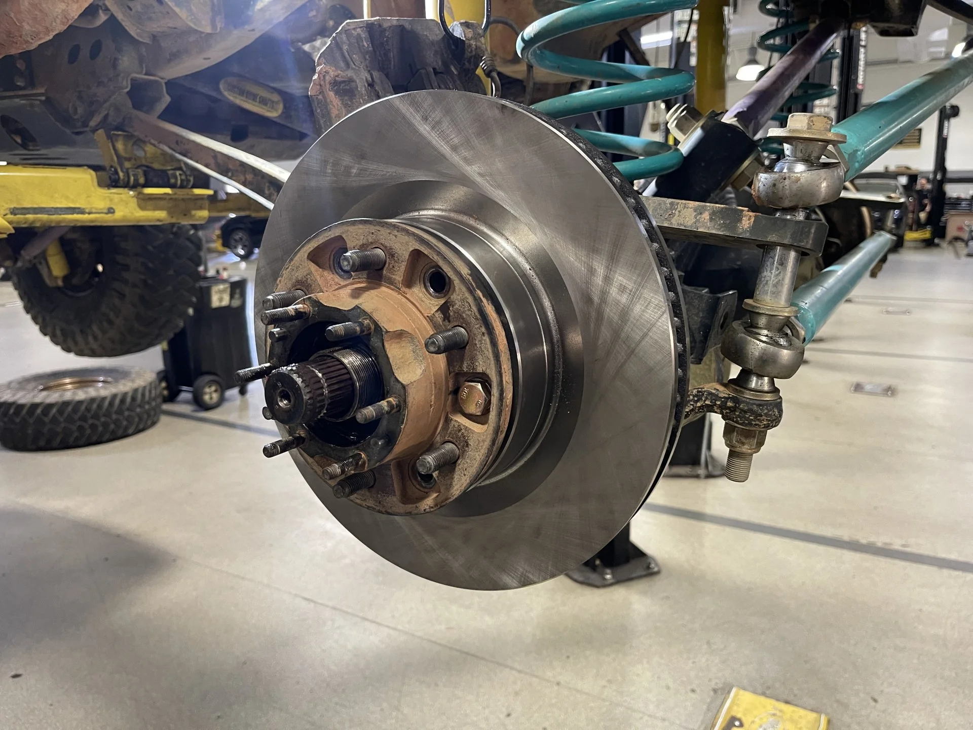

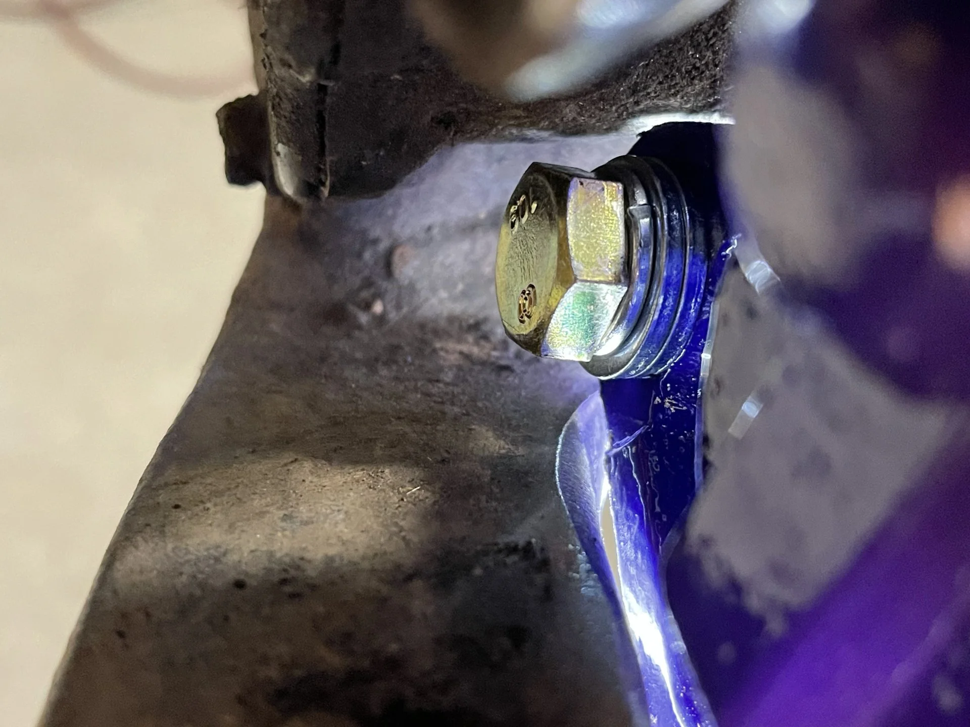

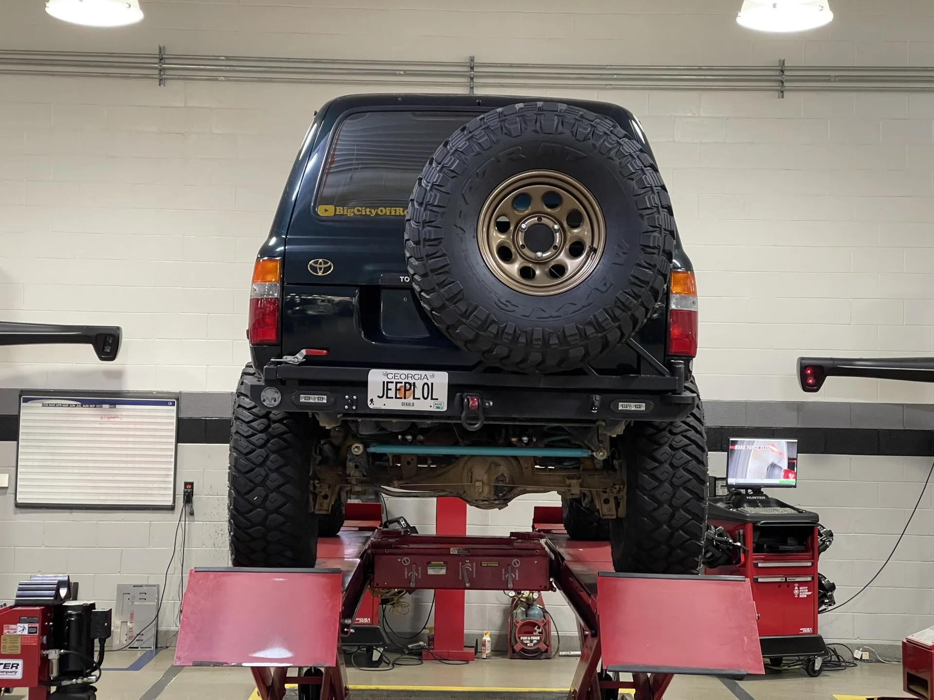

A small update, I got my rear panhard made and installed..
