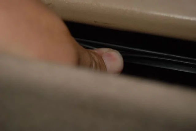

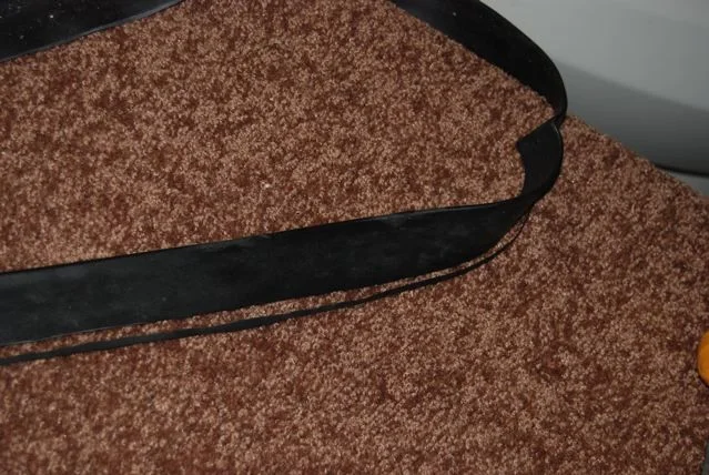

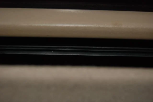

On to the bicycle tire fix: I knew I needed something to thicken the weatherstrip a very small amount, but still retain a certain amount of pliability. Hence the bicycle tube. You will see in the photos below that all I did was cut a 26" tube all the way around about 3/16" wide. This allowed it to be stretched around the sunroof between the glass and existing weatherstripping making the effective weatherstrip about 1/16 thicker all the way around. Also, leaving the cut tube in one piece allows it to stretch around the glass and then it holds itself in place. All this work was done with the glass off and from the underside of the glass. You can roll the weatherstrip away from the glass easily on the underside and that is where the cut tube goes in.
Once the glass was back in and aligned you could visually see from the top that it sealed better and the motion opening and closing was more snug. My wind noise at the doors and sunroof is gone.:clap:
Sorry for the lack of photos with the glass out, I wasn't sure this fix would really work so I slacked off on the photos. So here are a few of the tube cut to size, weatherstrip from inside and a picture of the tube in between the sunroof glass and the existing weatherstrip.

any more pics would help, it sounds like you put the tube rubber around the glass, with the factory seal holding it in place; did you use any adhesive?
No adhesive was necessyary, the pressure from the stretched tube along with the pressure from the existing weatherstrip holds it in place very tight.

Am I correct in stating that the bicycle tube gets stretched around the sunroof glass, then the weather strip is reinstalled over top?
-KK
Yes, the tube get stretched around the glass, but the weatherstrip is actually attached to the glass so you cannot remove it. You are able insert the tube between the glass and weatherstrip by slightly pulling the weatherstrip away from the glass on the underside.
