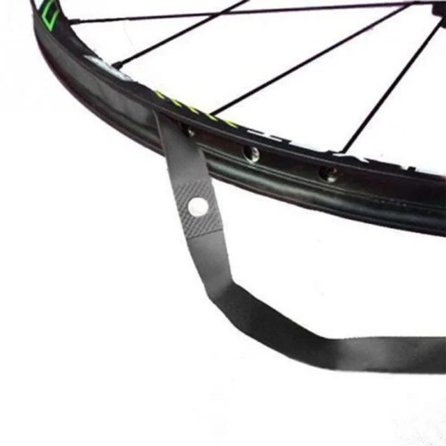

Might a bicycle rim strip work too. Its already precut to a certain width. the only thing is bad i think would be a hole in the rim for valve placement. Theyre made out tube rubber.

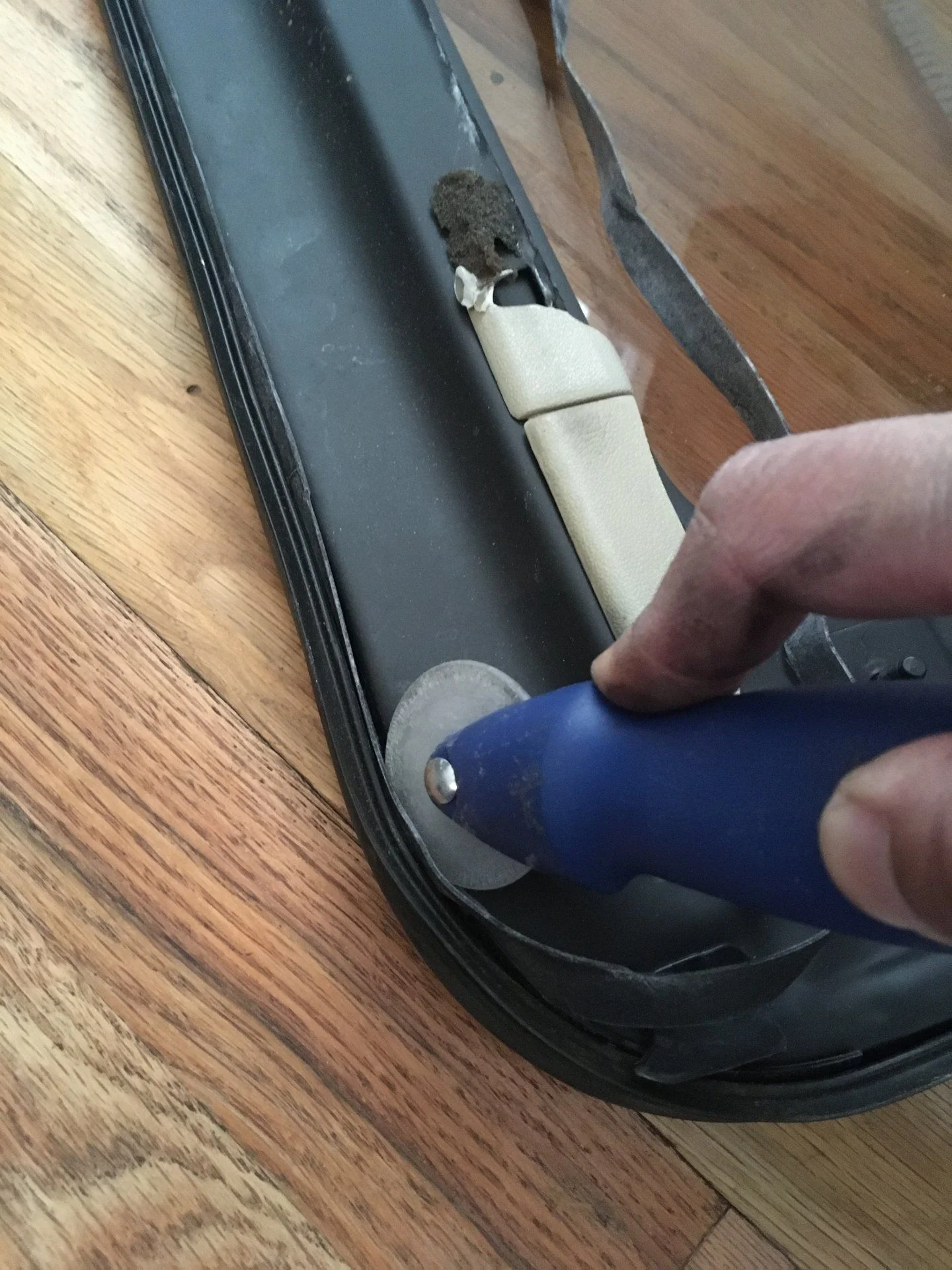

You just slit a strip out of the tube so it's like you have a giant rubber band.
I used a 26AWG wire and fed it into the gasket channel. It worked a little too well and made the sunroof rub tightly against the roof skin. I removed the sunroof and removed the wire in the back edge and reinstalled. Sunroof is tight but operates normally.
I tried the bicycle tube. Yeah, it was a pain to push sticky rubber into the narrow channel. I spent more than an hour o the tube before I gave up and put the wire in there instead.

My wife came up with a great idea to use a Window screen spline tool to push the rubber in the position. Worked great
