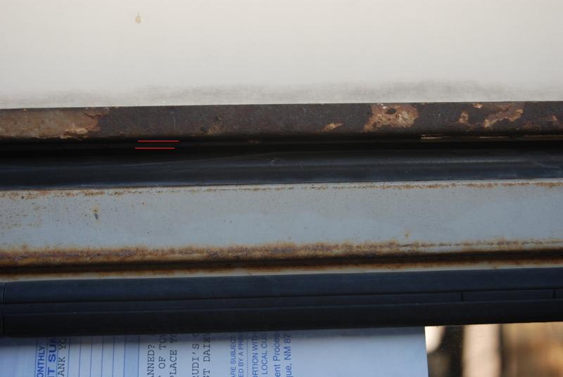

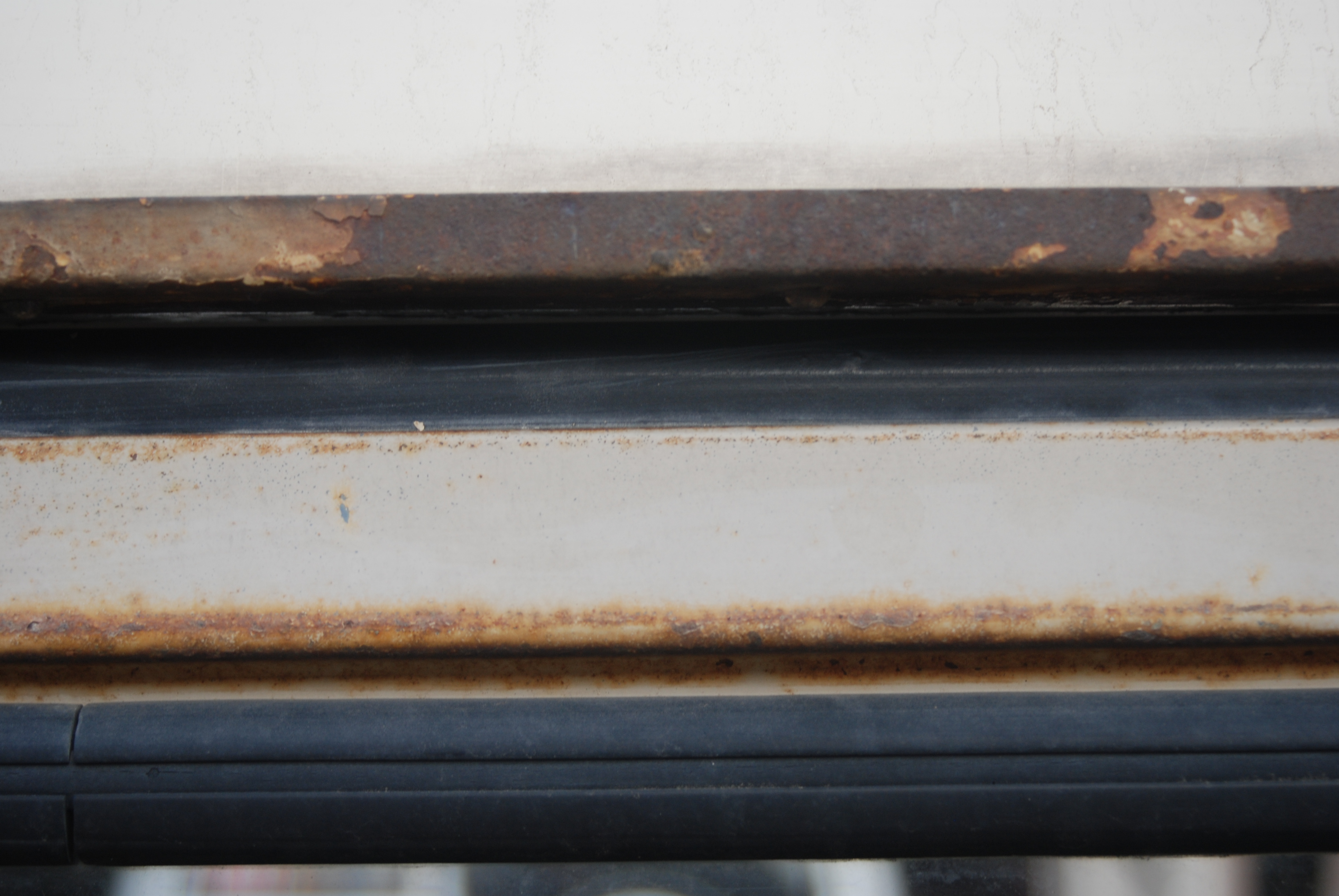

Thanks for posting the pics and installation tips. I think the new seals look great, at least in the center section...
I wasn't able to install mine this weekend. I'll get it done this week. When taking pictures, I'll try to "backlight" the door so the gaps can been seen better.
I took another look at my door with the middle seals installed and noticed that the seals compress a good amount when the door is in the closed position. If we adjust the seal cross section to take care of the gap in the top, we'll have to make sure we don't create problems for the middle seals....

Seems like a simple fix to me. I haven't gotten mine yet to check. Would think if you fed something like a piece of rubber or rope thru the stripping to make it a little taller it seal better or put a piece of weather stripping across the top.:meh:
I was thinking along those lines for a fix to work with the seals as they are. If we get another run of the seals made, I'd like to try to adjust the dimensions to to eliminate the issue. I still haven't had a chance to install mine in my '66 to see if I have the same problem as Wes. Work has been impacting my personal time over the last few weeks. Guess I can't complain, it's good to be working....
