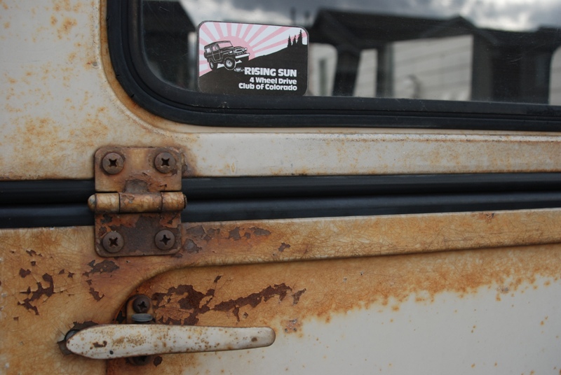

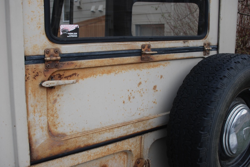

got mine in on the door for a top that i will someday refurb:rolleyes:, but took some pics on an assembled top since it was easy to install, also, so i could see just what it lookslike when it actually seals to the lower half doors;)
for installation, install one end a few inches in and slide it to the outer edge, then push the far side all the way onto the bend edge. this will allow plenty of room to feed the close side on. i did the test fit and the first strip by hand, but, when my thumbs got sore, i grabbed a dull flathead screwdrive and pushed right where the gap is diagonally down and it popped right into place. when you get close to the other end, stop and put the end into place, then slide it down and finish the gap.
definitely looks awesome!!
you can see on the bottom that i ran the w/s a little longer to cover the gap where the hardtop bows out for the track. middle sections look like that would be pointless. i just cut the lower section off of the area that it would stick out on.
you can see what i got out of the old door as far as w/s goes. pretty sad. when the door is opened flat, the weatherstrip forces it to a 'v' shape, so it will have to be latched which will break in the w/s, this tells me the center section will be a good fit. don't have the top assembled, so i can't comment on the top fit.
