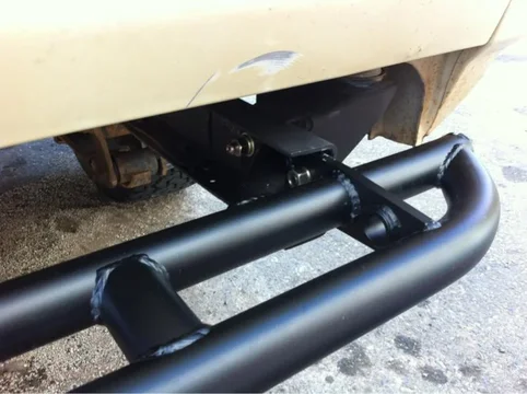

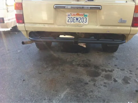

Okay... Been a busy week but here is the main bumper center section and a quick handheld shot of where the corner protection will end up with a 2-3" piece of tube added...
Center section
How it attaches
How corners will look (approx.; obviously over a lil bit more for tailgate to clear! :beer: )
Ya know it looks okay. Are you going to fill the gap above to the bottom of the tailgate? I like the wrap around, looks good. What is the thickness of the bumper tube? I would be tempted to add a diagonal from the inner frame to somewhere along the bumper towards the center for a bit extra rear protection.
But that's just opinion.
looks great!
