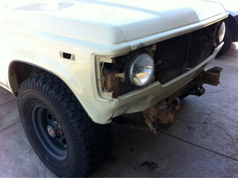

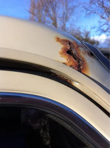

A pillar before
A pillar after

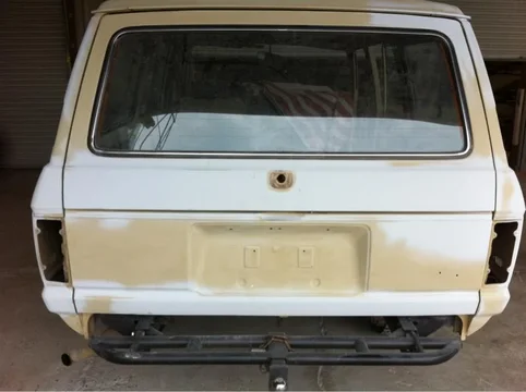

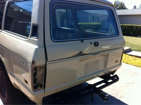

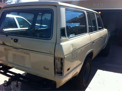

Left rear quarter and hatch before
after

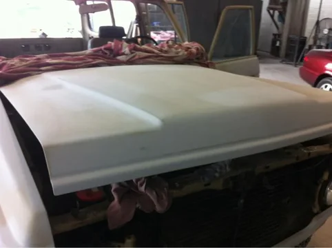

Right front corner and hood before
after

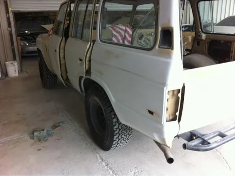

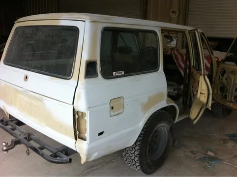

Right rear quarter before
After
RMP&O said:
nice job on the body work and rust repair!
I am stoked about it!! Might be overkill because I plan on actually using and wheeling this thing, but feels great to be starting with /getting something clean and straight.
Props to Mr. Lee (old Vietnamese dude at P&P auto body) in Sac-o-tomatoes, CA for doing the body work!

Trapper50cal said:
No.....it looks like this isn't that guy's first rodeo. Looks pretty good. One can't get up next to it and look across it using shadow to gauge in pictures but it looks like he knows what he's doing...
Yeah, that's what I was thinking too... He's been doing it at this same place for 20 yrs... Really cool old dude, bad to half decent English. Had fun doing the final walk around with him today...
It looked great and only had him take the rest of remaining rubber windshield gasket off along the base of the windshield and seal the entire rain gutter with seam sealer...

One thing I see...
looks like this seam is not perfect... could just be the shadows, but it looks liker a little too much filler in the gap, and needs to be shaved down... again it could just be the shadows in the photo.
Just trying to help.
Big difference from before!!!
Thanks db!! That fender line definitely needed the most help. I think the pic may just be shadow though, or difference in color due to sanding down the filler/primer/etc...
Should see how it looks tomorrow or next day!!

Hey, I hope it isn't too late but I noticed the same thing dbleon did and had a suggestion. Take your rear light down and install it, if it lines up and seats correctly then its good to go - how do I know? I went through this 2 days ago :\
On my passenger side, the lense/gasket was cracked and warped, this was causing rain water to leak into the rear quarter panel on my passenger side - a lot of water. I removed the light/housing and shop vac'd the water out - then I bought 2 (Driver/Passenger) side lights (Housing/gasket/lenses), when they arrived I had trouble seating the passenger housing, thought it was a bad fit knockoff so I tried the driver side, fit like a glove. Went back and started inspecting the passenger side and realized looking close that the truck was smacked in the same place as yours at some point, bondo/painted over - it looks fine w/ out the light, but you can tell when you try to fit it. I got the light in, there is still an 1/8 of an inch or so gap at the top that I am going to fill w/ black sealant to prevent my water leak issue from returning.
Good luck - I would have stayed stock as well.
Thanks Minium. I will take the housings in this week for sure. It actually had a gap with the housing in before (I think someone replaced the housing/lens and left the body work undone... I guess I just figured it would fit right once twy straightened te body, but it makes sense that they would need something to go off of :doh:
