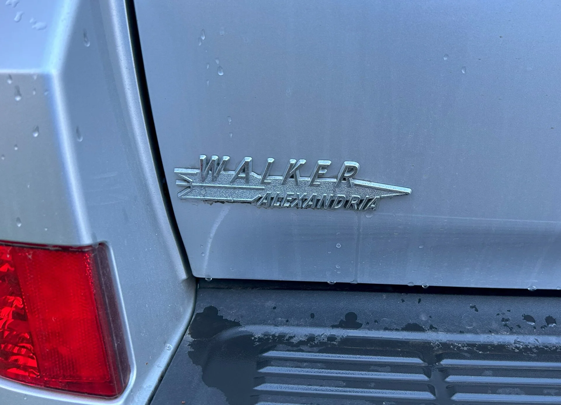

The original car dealer glued his badge emblem onto the back door. See photo below. I have the prying tools but looking for guidance on how to remove the emblem without causing paint damage. Any guidance appreciated. Thank you.
Gently heat with hair dryer or heat gun. Remove. Clean with 3m adhesive remover if needed.
I had trouble getting fishing line to hold up, so invested in an "emblem removal tool" from amazon with the kevlar string.. works really well, and not too expensive.
Also yes to 3M adhesive remover.. the stuff is amazing.
Gently heat with hair dryer or heat gun. Remove with fishing line. Clean with 3m adhesive remover if needed.
You will be amazed at how well this works.
I've heard this is the way, but if you can't get it like @bloc go with his kevlar string tool on amazon.
Regardless of what you do, take your time and be deliberate. If it was me, I'd go slow with the heat and the string. You'll get it eventually.
