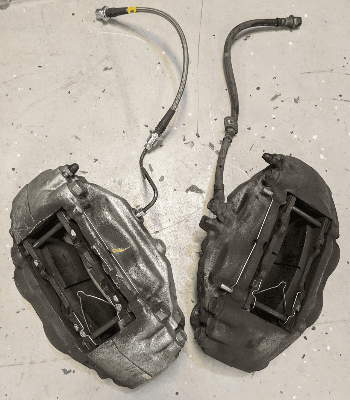

Really? Won’t rotors, calipers, and backing plates cost more than that?
Depends on which route you take but yes, very doable under $500.
Parts:
1) Brake calipers from second gen Tundra or Sequoia. I don't believe their brakes changed at all through even the current 2020 modes, though I haven't verified. Mine were used from a 2014 Tundra with 25k miles. These can be found dirt cheap from many sources. Re-manufactured, car part recyclers, car part retailers, Ebay, etc.
2) Brake rotor from a Tundra or Sequoia. As a previous track enthusiast, my personal preference is OEM. Anything else in the aftermarket is of questionable metallurgy or quality control. Except for the top tier brands which won't be a better value.
- OEM Brake Rotors left/right - 43512-0C020
3) Brake pad of your choice. Or re-use current pads if there's a lot of life left. Or aftermarket, which specified same pad for LC, LX, Tundra, Sequoia. I personally like upgraded street pads like Hawk HPS, Stoptech Street Performance, or TRD.
4) Hard brake line from caliper to suspension bracket
- passenger side: 473160C091
- driver side: 473170C031
5) Brake line from bracket to chassis
- Stoptech stainless brake line kit: 950.44023
- OEM: 90947-A2016
6) DIY line retension bracket (**more info in install below)
7) Brake fluid
8) Optional - Tundra brake shield though I found gentle massaging of the 200-series one to be perfectly viable.
Worthwhile to link to prior art on this install that details how to swap the brake shield which I didn't bother with. Takes this up to a 3-4 banana job.
I'm easily under $400 all said and done, which is dirt cheap for a legitimate brake upgrade. Barely more than a standard full up brake job.
Notes:
- I choose to simplify and streamline the install with minimal parts/effort by not changing the splash shield. As it is thin stamped steel, it's easily bent for the bit more clearance the larger rotor takes
- Tundra flexible line from suspension bracket to chassis is 1.6" longer, which can be expected as the Tundra suspension arms are about 1.5" wider. This works well here for either Tundra suspension swap, or stock, or extended down travel with OEM shock spacer
- The Tundra brake line setup is different (refer to below picture). The stock rubber brake line on the 200-series is a single piece, with a banjo fitting at the caliper, and retention bracket at the suspension upright. The Tundra setup requires a hardline at the caliper using a standard double flare connection. This is mated to the flexible brake line at the suspension bracket. A retention mechanism needs to be devised to secure the different line type. Potentially, there is a Tundra bracket that can be used, but this has not been identified
Tundra setup left, 200-series right
