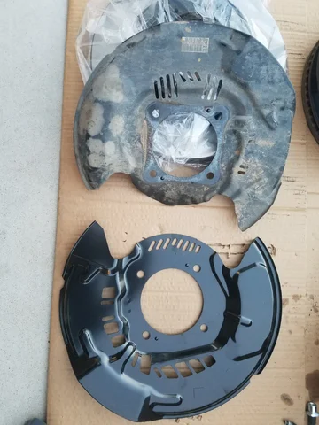

Tundra Dust shield 47703-0c031

Tundra Dust shield 47704-0c031

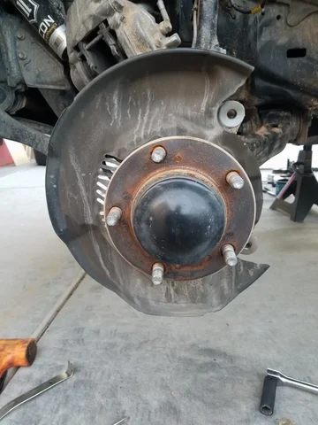

Use prybar/putty knife/ screwdriver to remove hub dust cap. 20170226_180608.webp

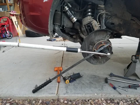

Use 39mm 12Pt socket and big breaker bar to remove axle retaining nut. 20170226_181031.webp

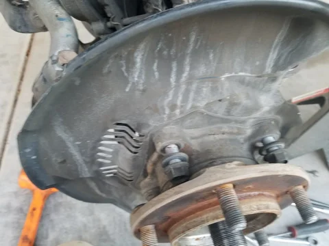

Loosen the 4 17mm bolts that hold the hub bearing to the steering knuckle. I used a wrench and dead blow hammer. 20170226_181503.webp

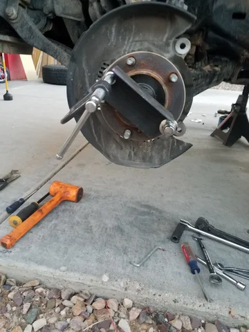

Here’s where I got creative….having installed the tundra suspension, I knew what a pain it was getting the CV shaft out of the hub. My solution, take one lug nut and partially install it. Use a small piece of scrap metal, bar stock, tubing, or angle iron and a “C” clamp to make a press to push the axle back out of the hub. 20170226_181821.webp
Looks hokey, but works like a champ!

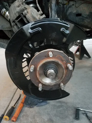

Clean up the hub and O ring and apply fresh grease. Put the new dust shield on the hub bearing housing and push the bolts through the holes to keep in aligned. Slide the hub/dust shield assembly over the axle shaft and start the 4 retaining bolts. Get all the bolts started and run in about half way before tightening any of them. (disregard that in this pic the dust shield is upside down)

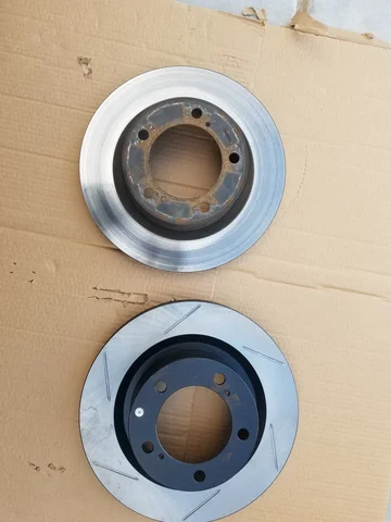

PIC of rotors!
Spray new rotors with brake cleaner to remove any packing grease and dust.
