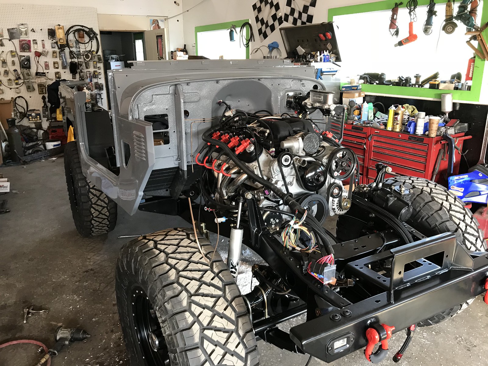

Fieldsken1, I fxxxing drool every time i see under your hood!
For sure. Please do.
LS1 - 4L60e - NP205 - HP Dana 60's.
Well at least that is what I am fighting with ATM :bang:
