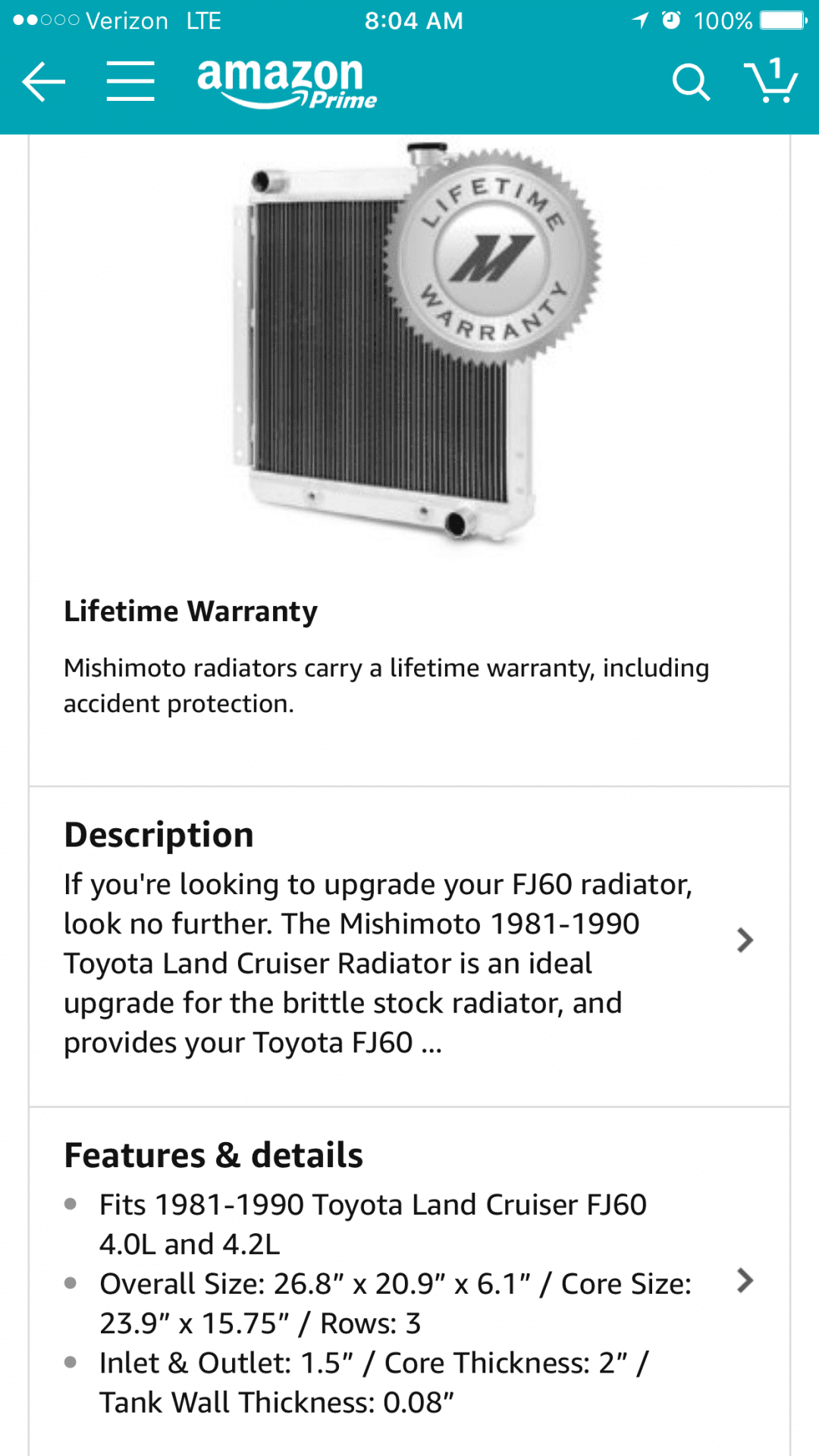

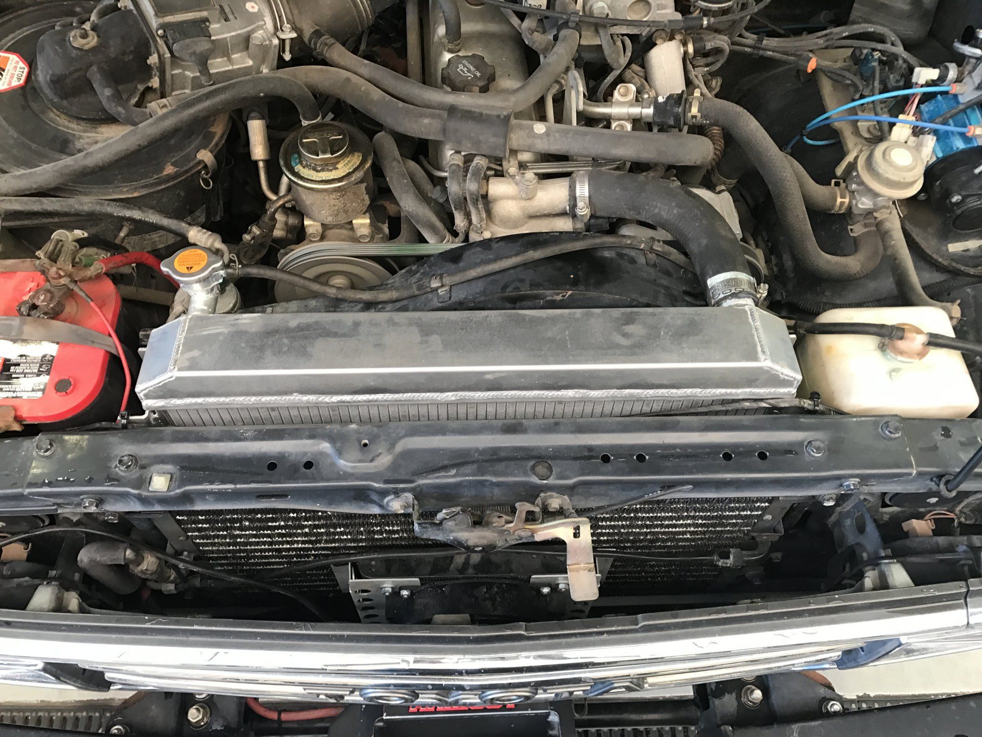

For anyone wondering, I just put a Mishimoto aluminum in mine and it was a 100% perfect fit with no modifications whatsoever. Another bonus, they have a lifetime warranty, including accidents. Meaning if it leaks 10 years from now, free replacement. If you jam a tree branch through it off roading, free replacement.
where did you source it from and is there a specific part number.....may help others.
Everything was 100% bolt in, no modifications whatsoever.
Cool thanks. Also saw a previous post that someone had to drill new holes to match the fan shroud, good to know you did not have that issue.
May get the Mishimoto this time instead of the Performance rad that I can pick up locally. Current rad is leaking bad now, need to pull the trigger soon.
Ya, someone also told be their mechanic had to "heavily modify" it to fit. They couldn't give more details as they paid someone to do it. At least for my truck (100% accident free) every single bolt hole lined up perfectly, both on the radiator mounting and the shroud to the radiator. I didn't have to tweak or adjust a single thing.
