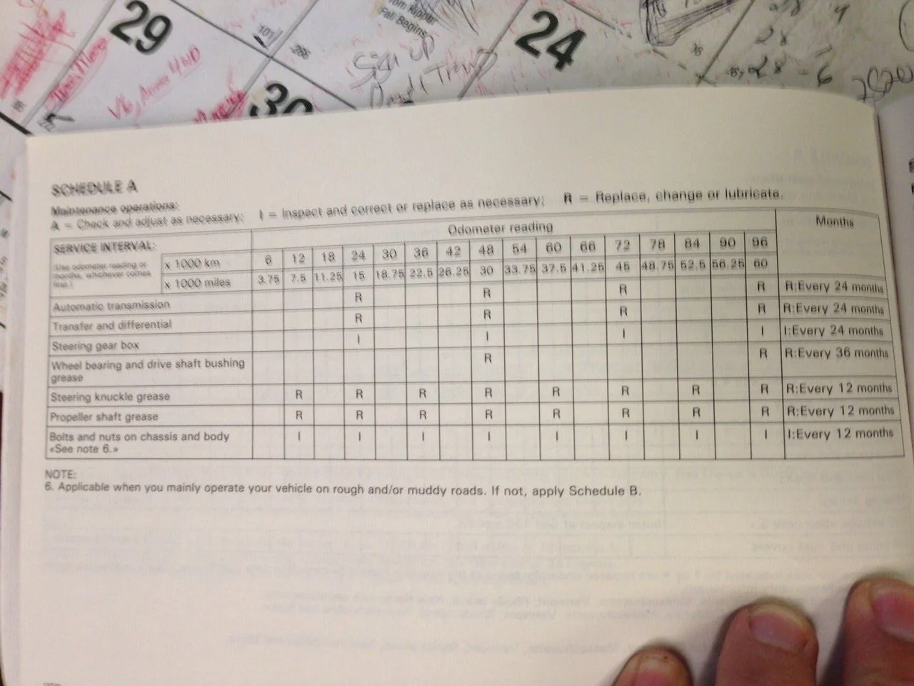

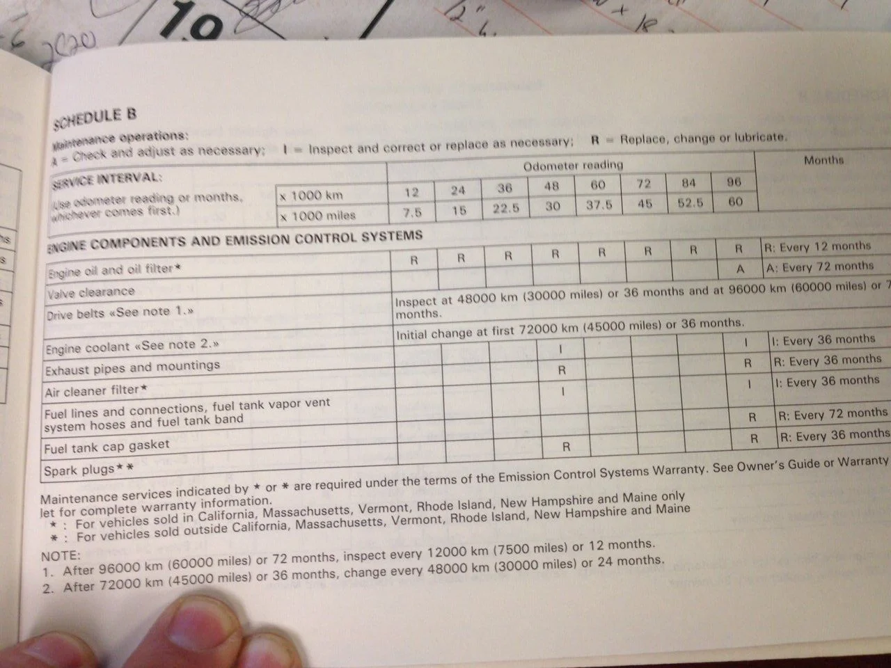

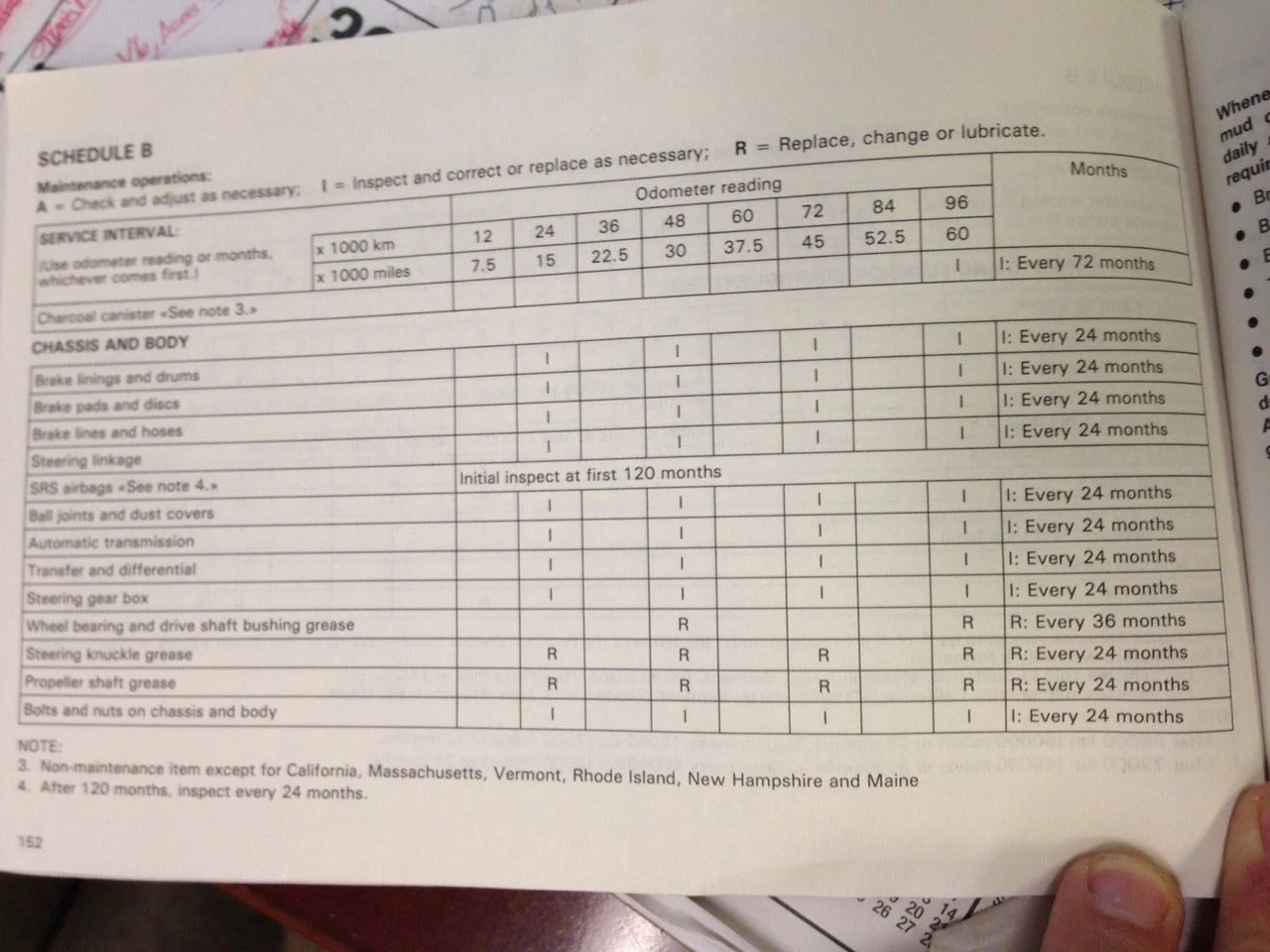

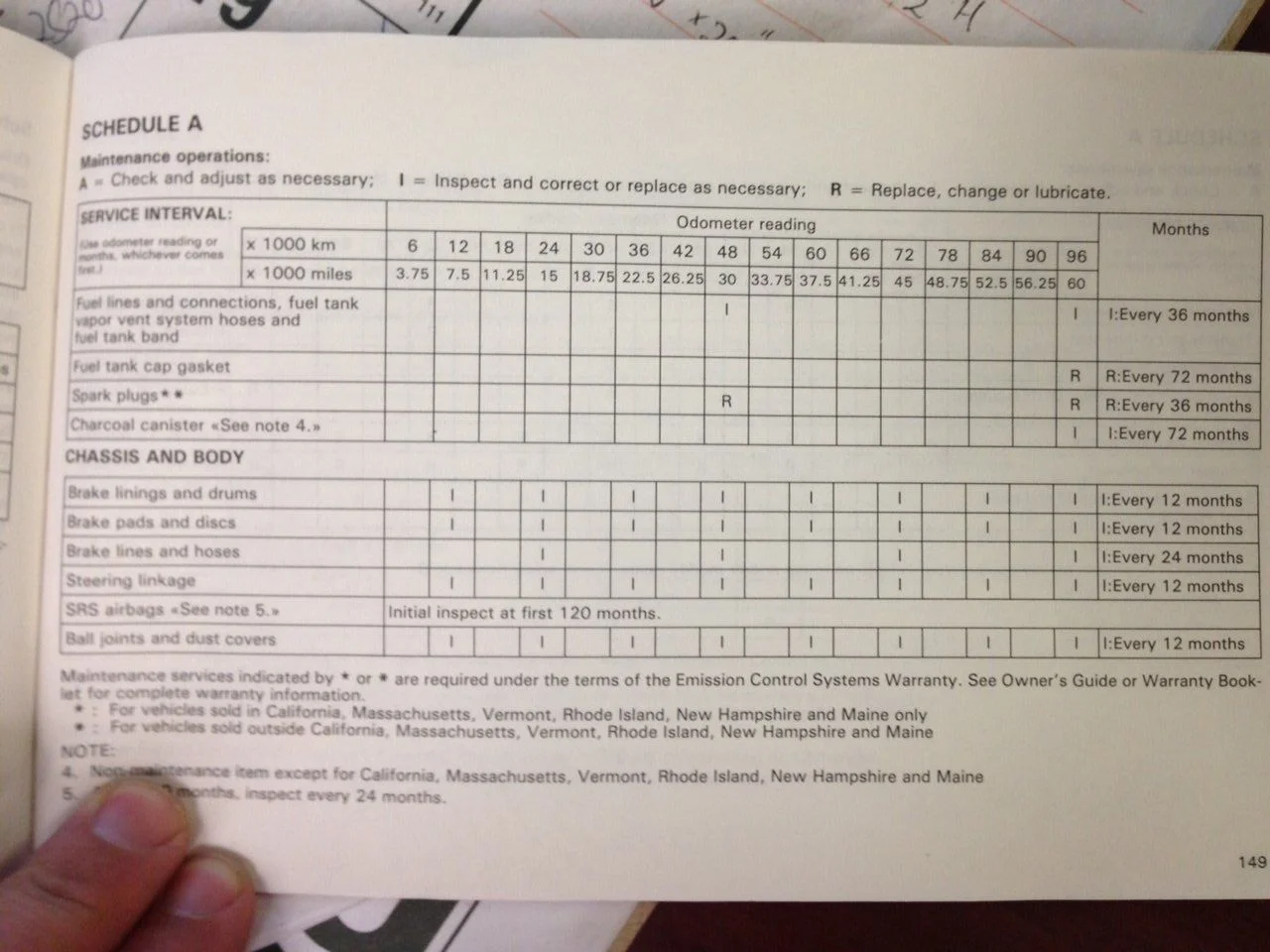

I noticed fuel filter wasn't even listed in owners manual - just took a stab at that one. Posting schedule from owners manual momentarily in case any one wants them.
