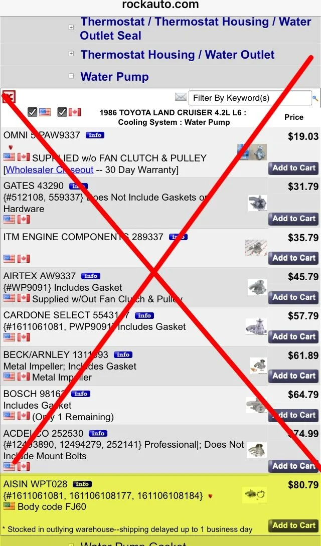

I just bought the WPT-028 for $73 from Rockauto. No reason to get anything else.

The Aisin/Asco WPT-028 is the same pump that comes in the Toyota box, minus the TEQ casting. However, my experience with that water pump is the Toyota boxed is sometime even CHEAPER than aftermarket if purchased through a discount dealer.

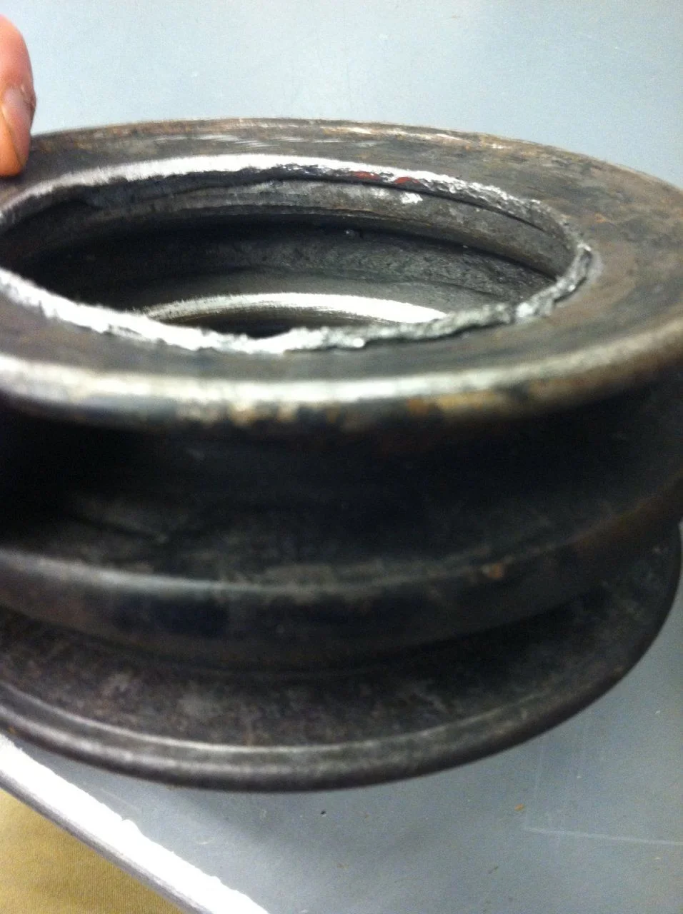

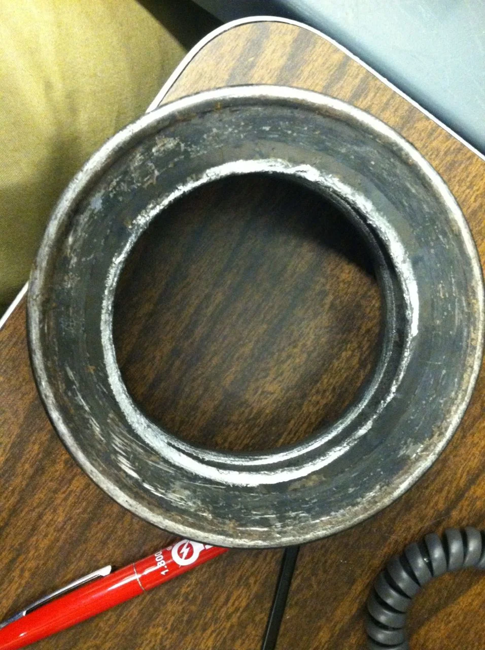

SO I DUG INTO IT LAST NIGHT . IT WASNT MY WATER PUMP BUT THE WATER PUMP PULLEY HAD COME APART . NOT SURE HOW THIS COULD HAPPEN. ANY IDEAS ON WHERE TO GET A NEW ONE. TOYOTA DOESNT SEEM TO MAKE THEM ANY MORE AND I HAVNT HAD LUCK FINDING ANY AFTER MARKET BRANDS EITHER.
