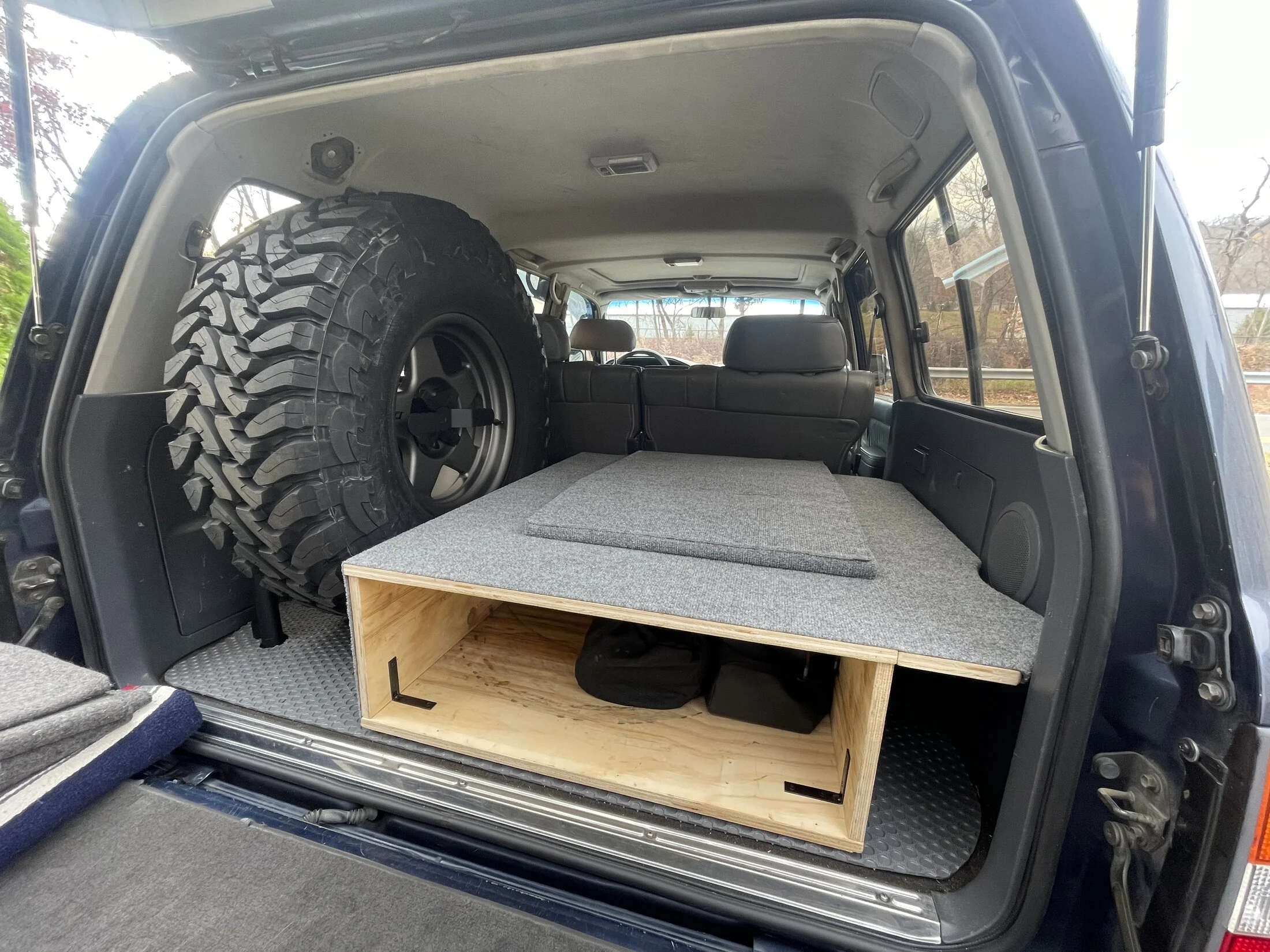

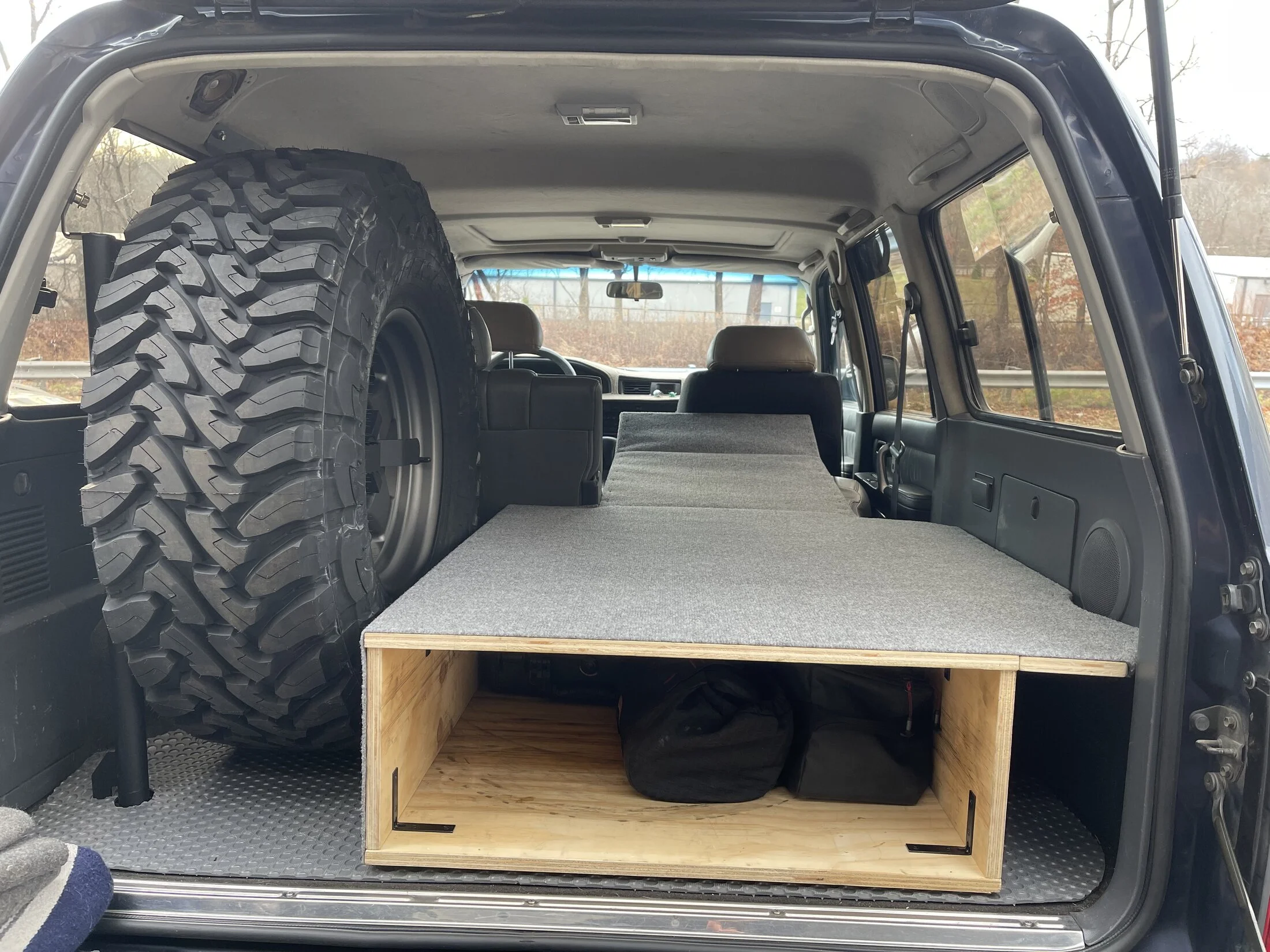

You can get a Feel for a Drawer Setup by putting Milk Crates down and Topping with a Piece of 1/2" Plywood or OSB.
I built mine and my Only Regret (and I still may fix) is not Putting Hatches on the top to Open instead of Pulling Drawers all the way out.
It really Helps with Keeping Clutter Minimized since everything is in Drawer. May Build a Simplified set for Our GX that can Double as a SLeeping Platform.

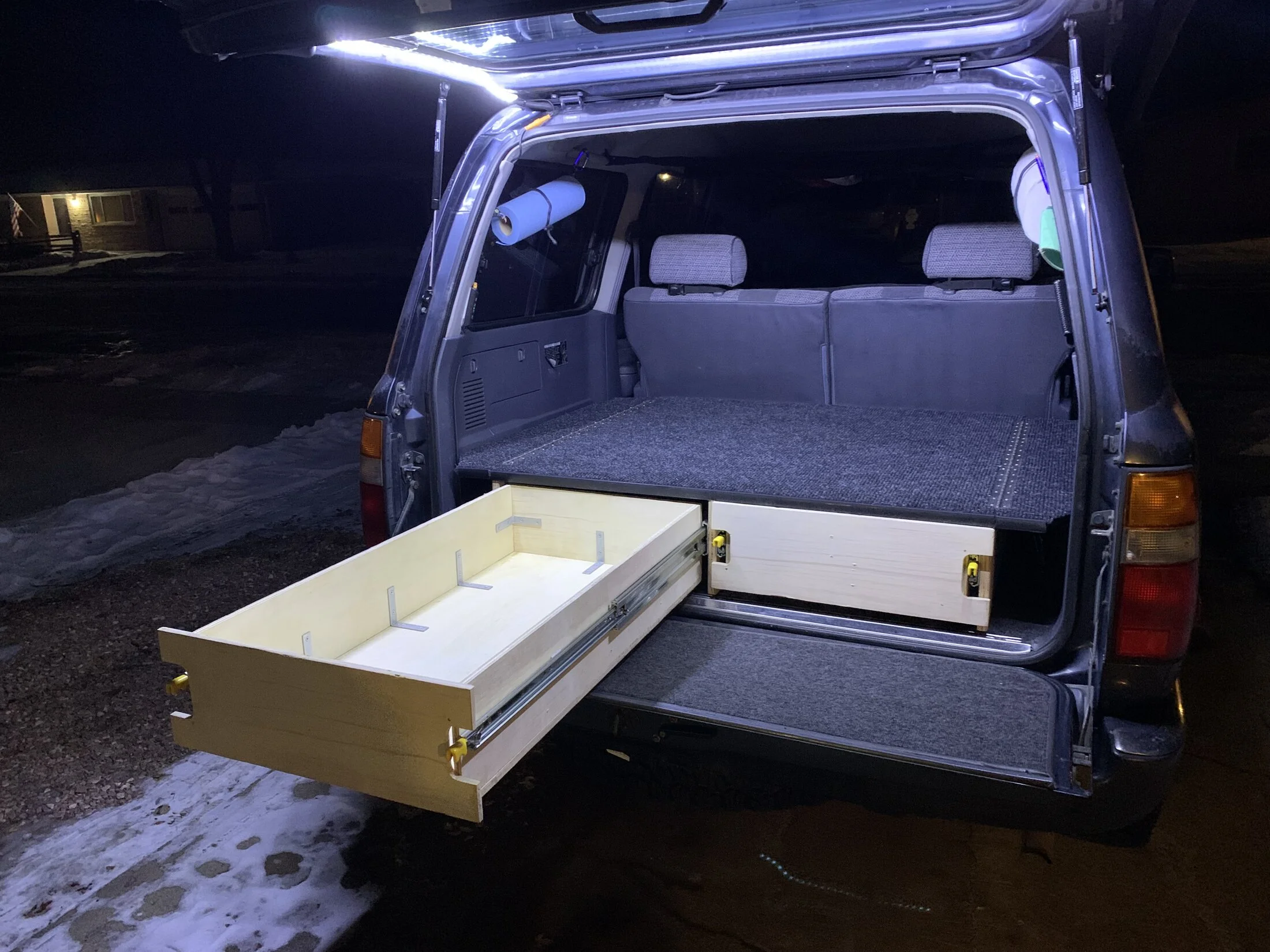

this been working for me over the years.

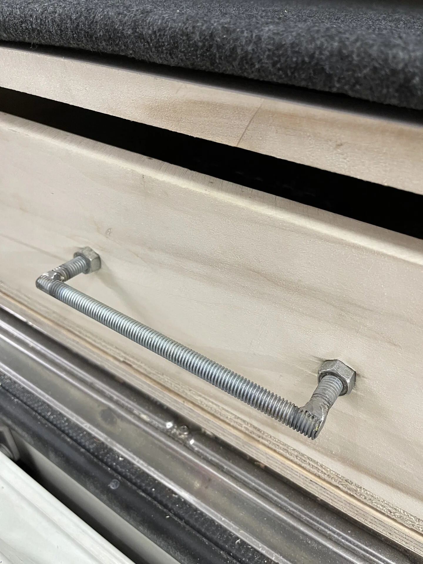

I've made two of this style drawer system for my 80's and 100's. Picked up another 80 and will be building another one. Very simple and cheap. Maybe $150. My handles are threaded rod welded together. I had it lying around but I also like the rugged look. Also, no drawers slides, just "slide tape" you can buy on Amazon. I have at least 100 lbs in each drawer on my 100-Series and they slide just fine with some muscle. Just another idea to add to this thread.

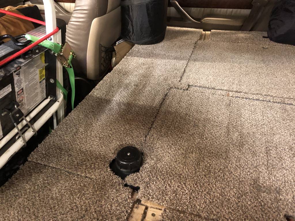

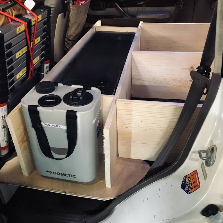

The first drawers were built in anticipation of always having the trailer along, which means the bulk of the water supply could ride in it. This time, I wanted the ability to leave the trailer behind by installing a water tank in the truck. I chose a ~18 gallon tank from Front Runner. This required raising the deck heilt about an inch to provide a continuous level top. Here I've roughed in the surrounding framing, with having already bult a floor that levels up the are formerly the 2nd row footwell.
A view from the rear also shows how I simplified the framing vs the first version. Note that I haven't actually cut the boards to their final height before assembling the framing.

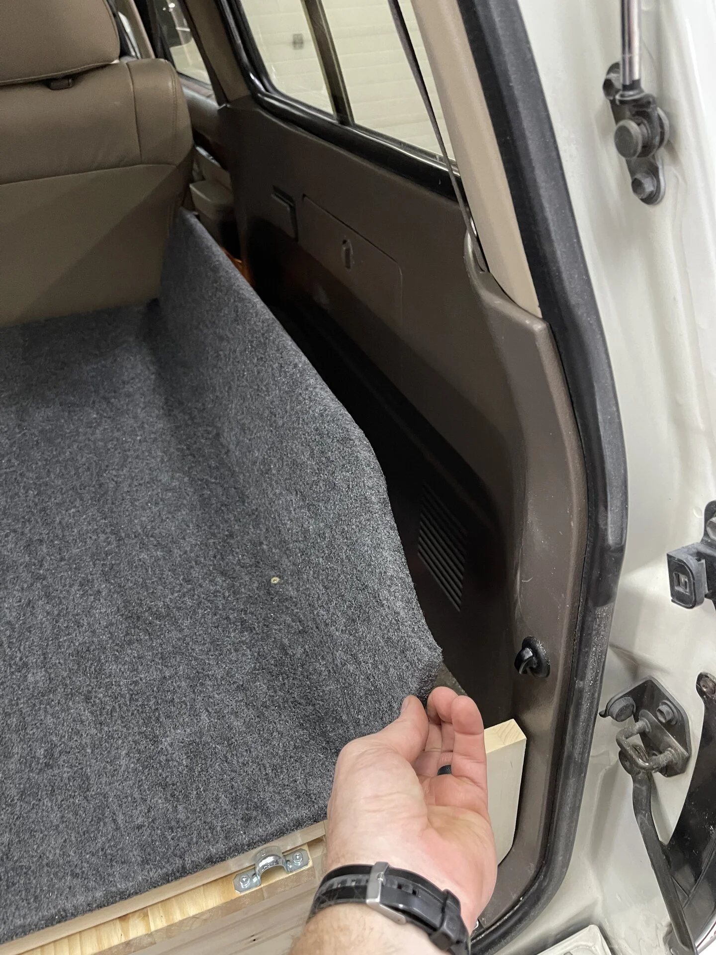

Next the carpet goes down...

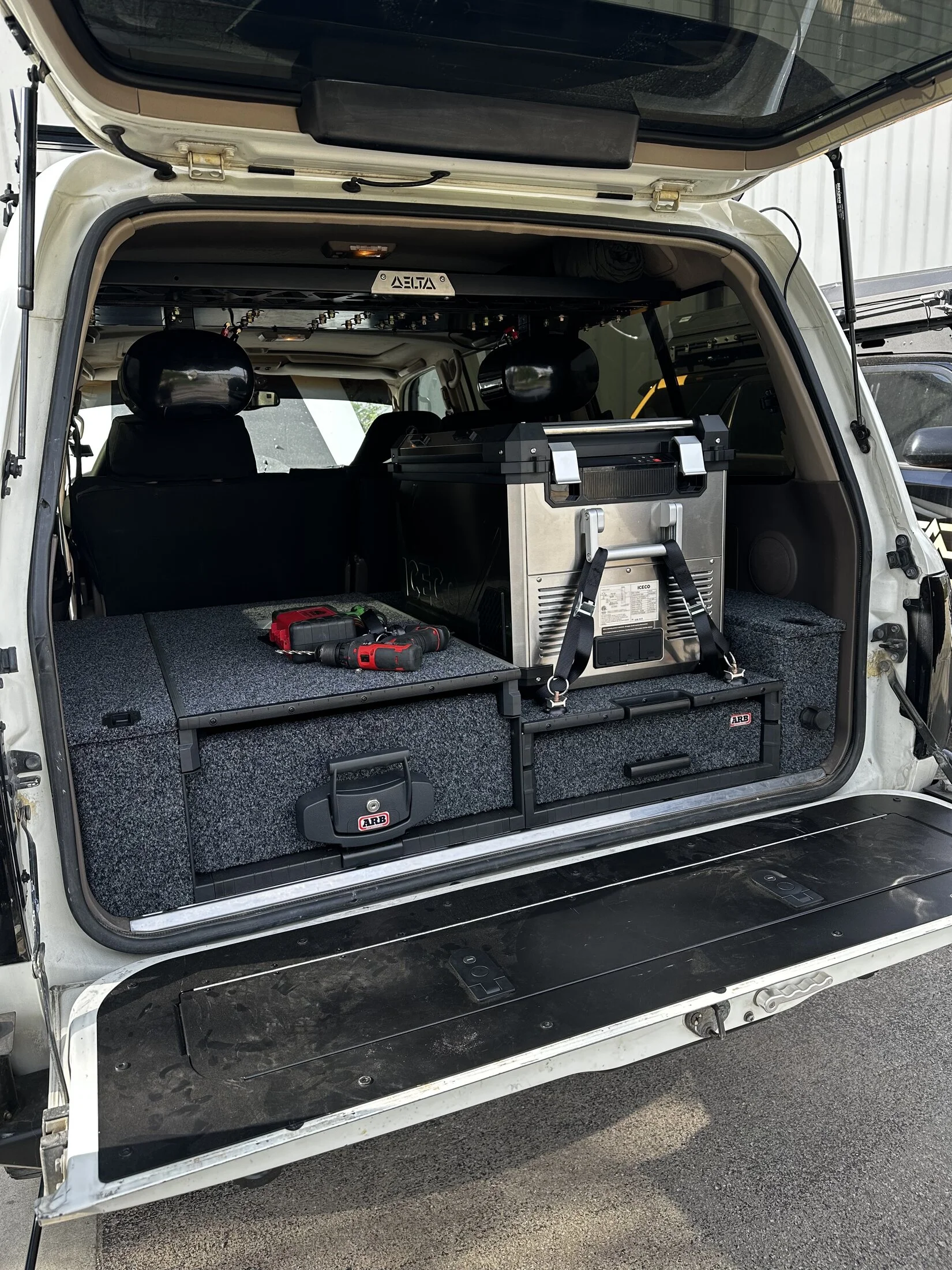

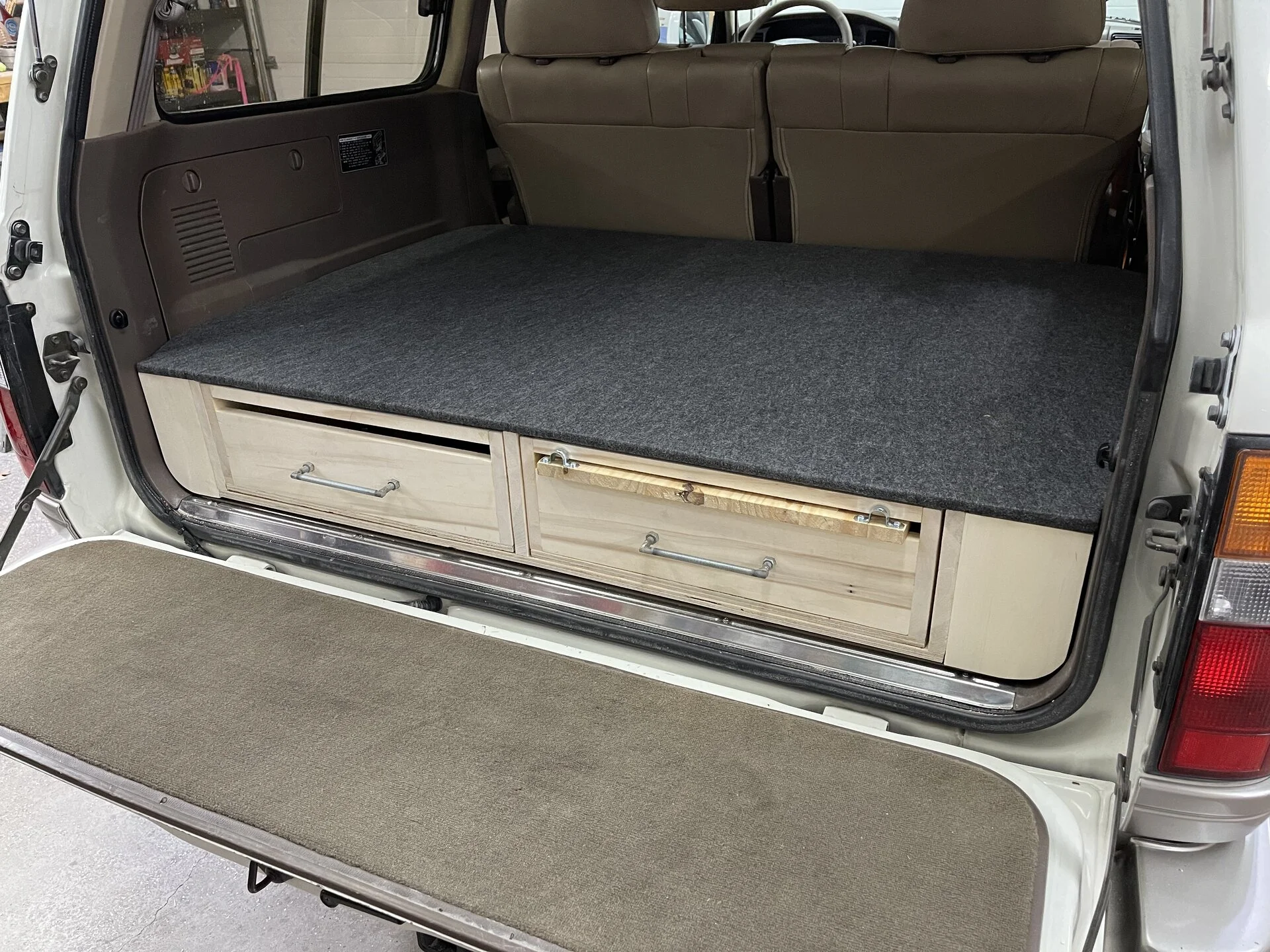

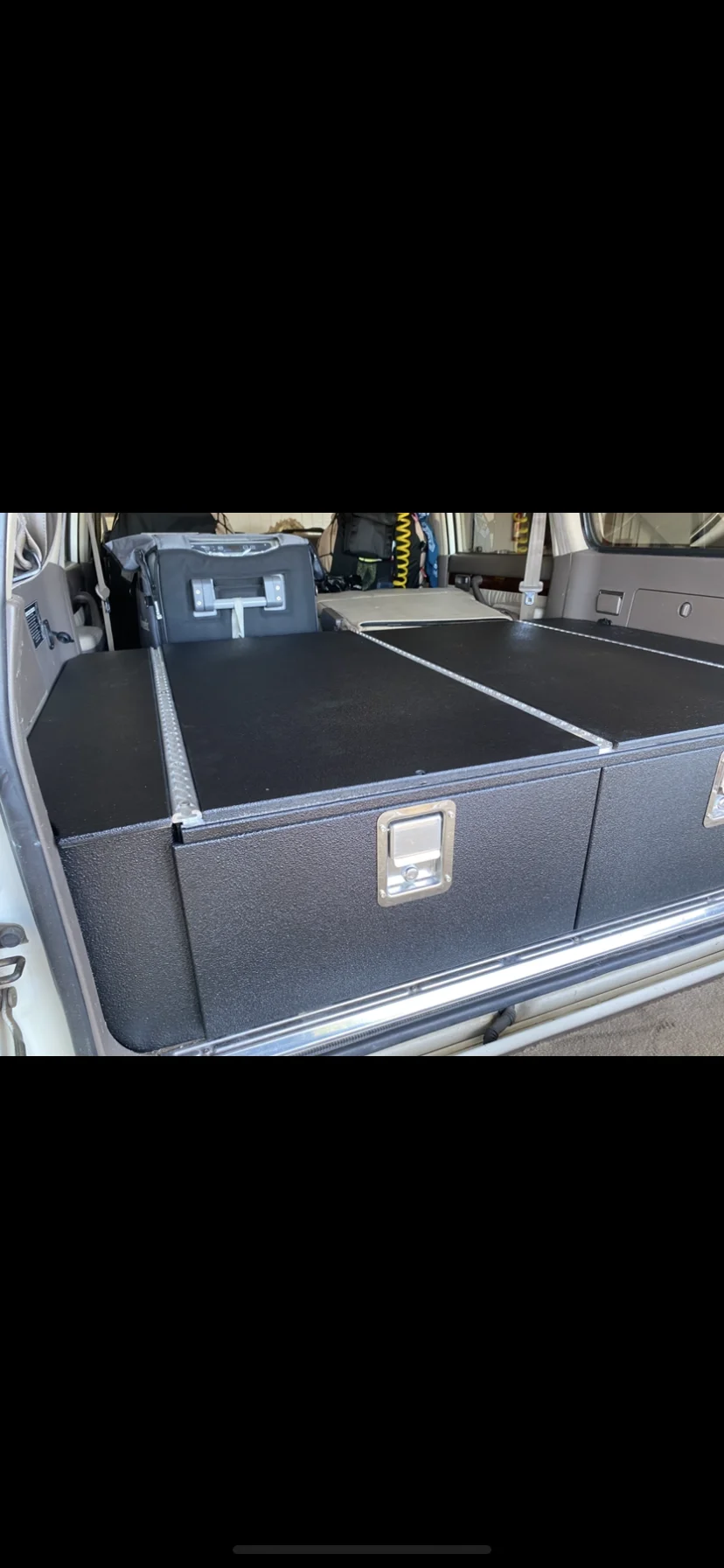

I took a bit of a different path with my setup as I wanted something super robust that wouldn’t move around or rattle. I’m not saying the route I went is right for you but I wanted a half height drawer for a bigger fridge and I also wanted to clear my speakers in the back.
I went with ARB as they are proven over time with good rollers and fitment. The half drawer has a roller top for the fridge and the full side drawer doubles as my sleeping platform. The side wings are great for hiding tools and airlines and the fit is pretty darn nice and no need for drilling the body. I had my drill out for a hole in the right side wing for my air coupling. Not a single rattle through all of Moab.

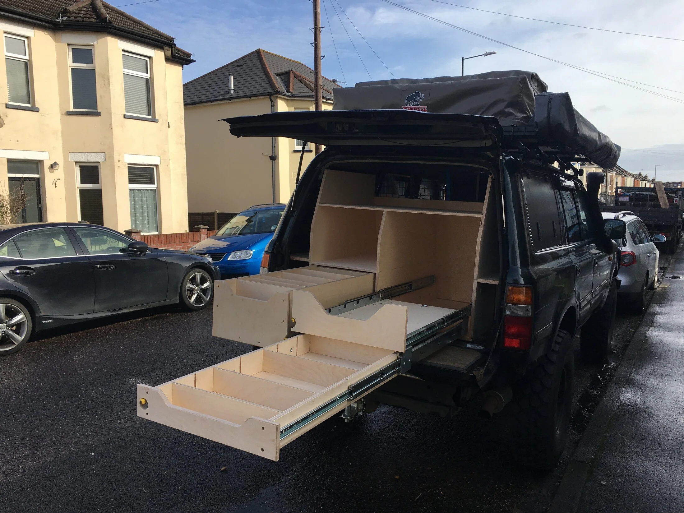

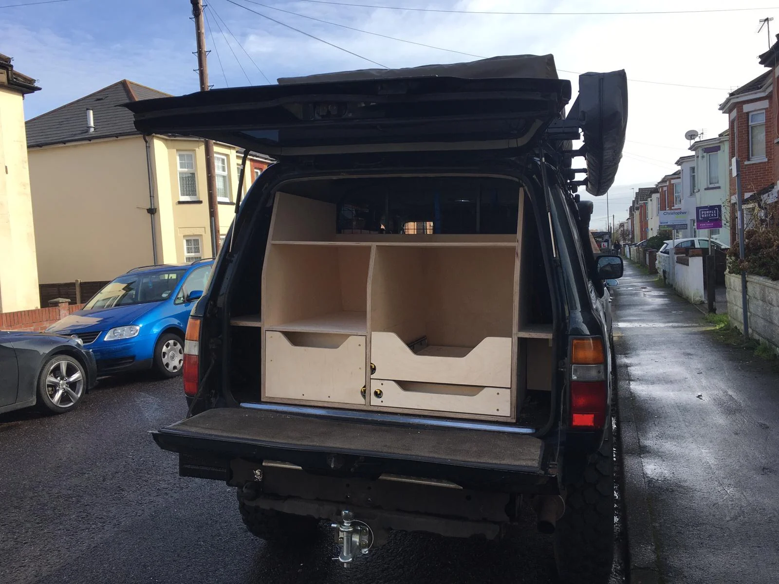

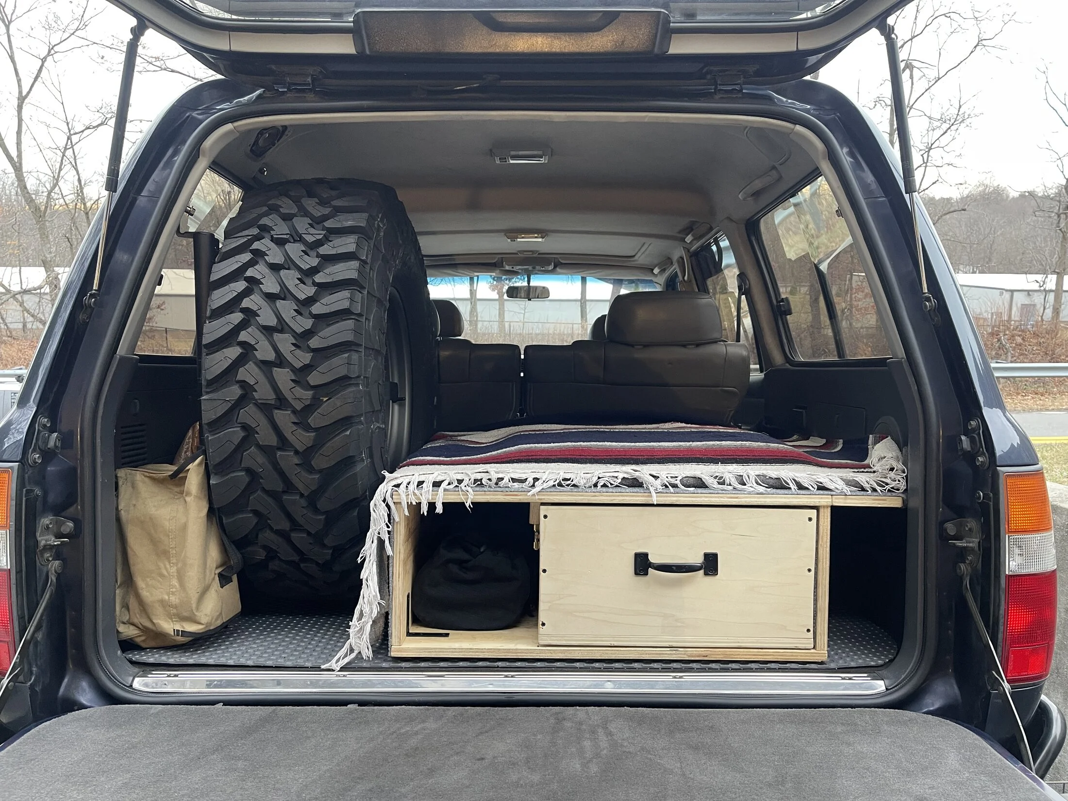

Here's a super simple set I made that I thought I'd only use for a little bit but have been using for a couple years now with no issues. Just did 3/4" oak for the beefy frame (main platform and side wings, and the 3 legs down). 1/2" for the inside drawers and got some slides on amazon. Was probably $400ish with all hardware and wood and has been super sturdy! Still need to bolt it down tho, it likes to jump in the air on the trails lol. I made the height just over the wheel wells and it lines up perfect with the backseats folded down.
Cheers!

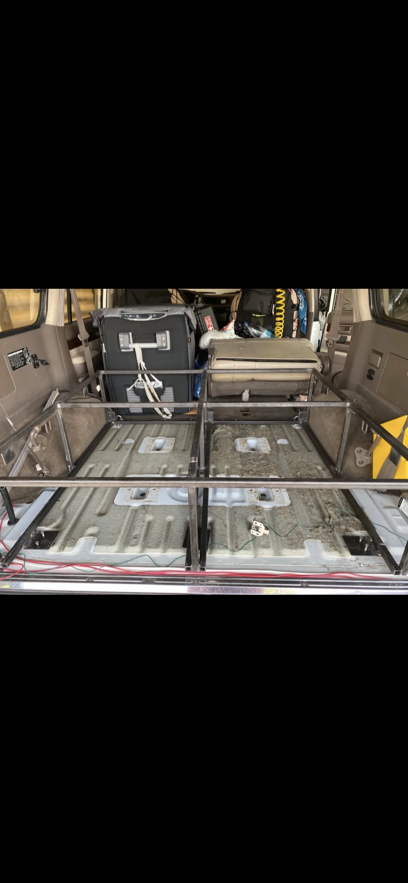

Did mine a couple years back. Wanted to do aluminum frame, but too expensive here in Hawaii. Went with mild steel and built everything off that. One of the first times I played with wood for a project. The aluminum anchor strip is tied I got the frame. The sides flip up and used uhmw or something like that for slides. I bought the kreig jig and screws for the drawers. Raptor lines when finished.
Eventually added a aluminum angle iron to protect the lip about drawers. I had a fridge slide for years in the back. Just became a hassle every time you wanted something. Had to open either the swing outs or the tailgate and hatch.

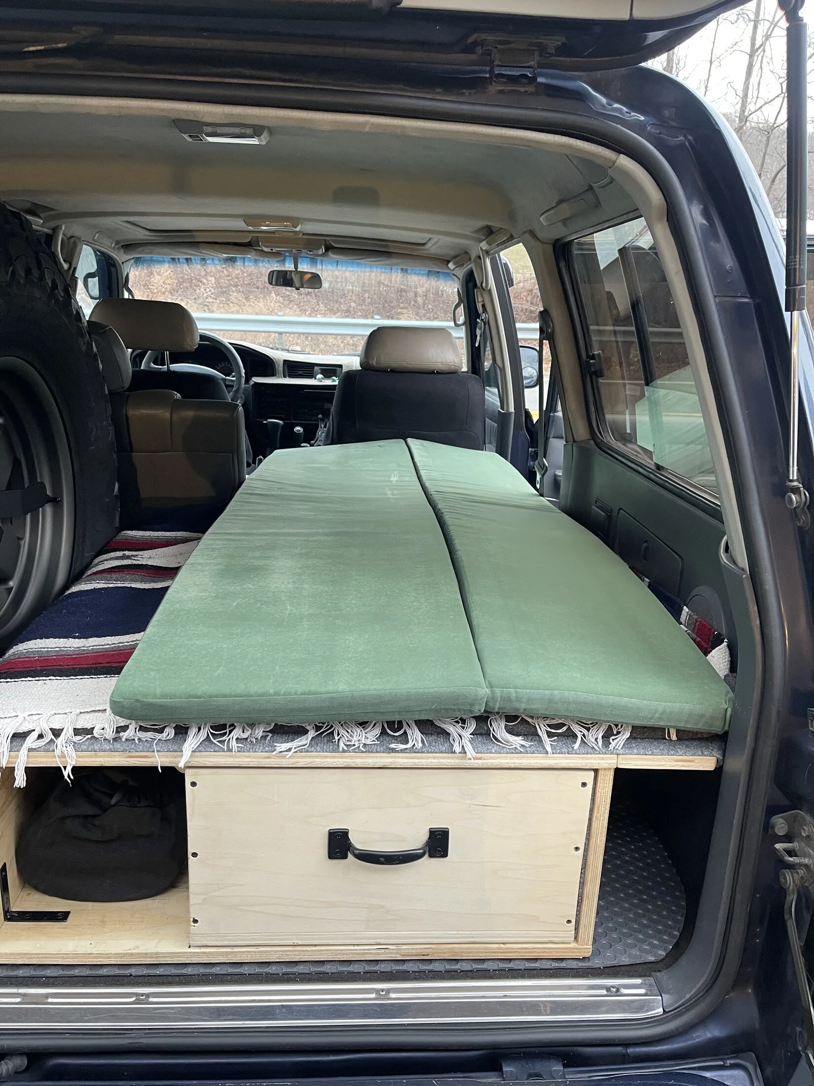

I built this for my FJ55, when janky was cool. It fit perfectly into the 80. So it’s what I’m sticking with. :lol:
A Thermarest basecamp mattress fits perfectly in here. I much prefer tent camping, but when necessary...

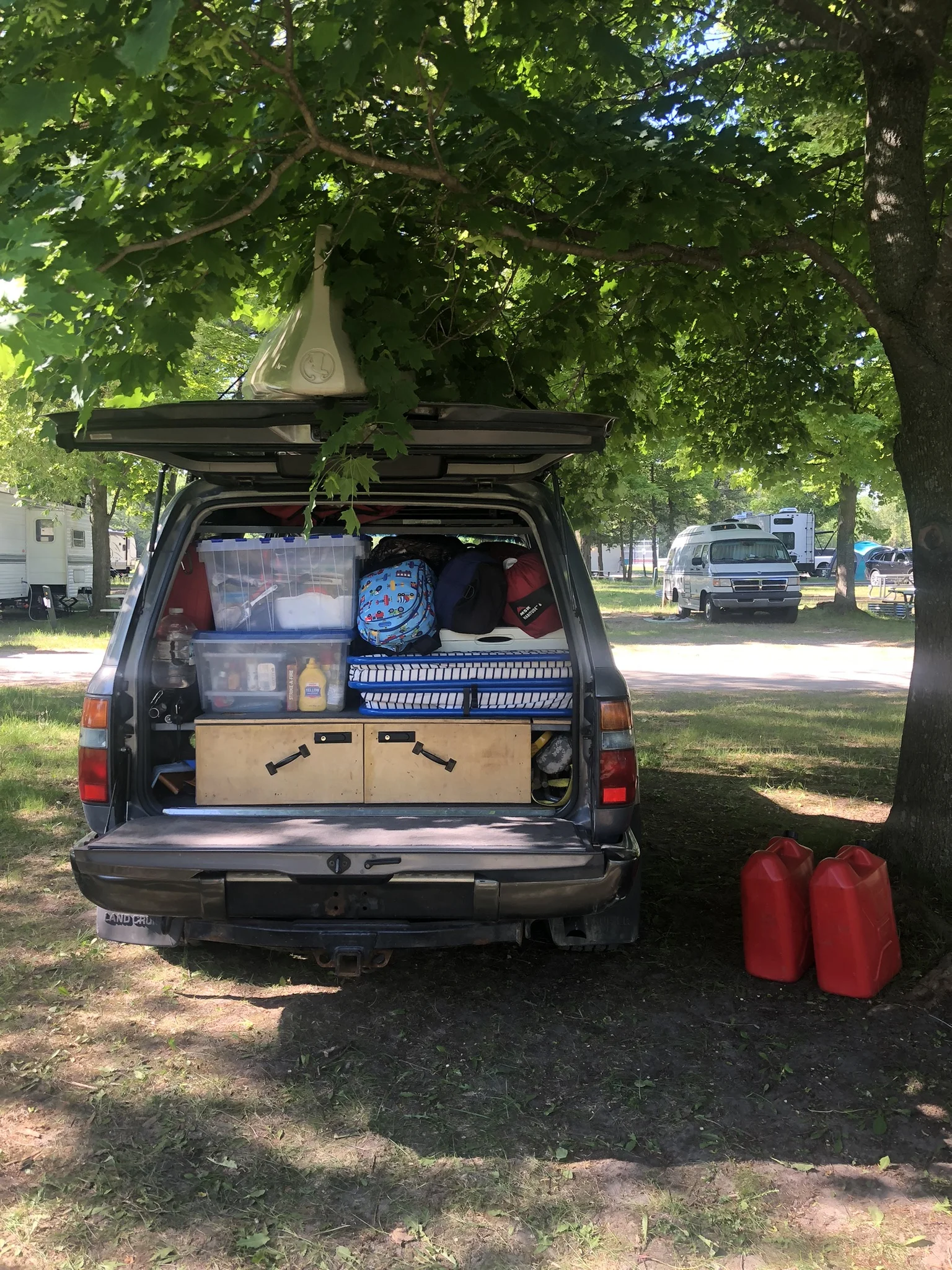

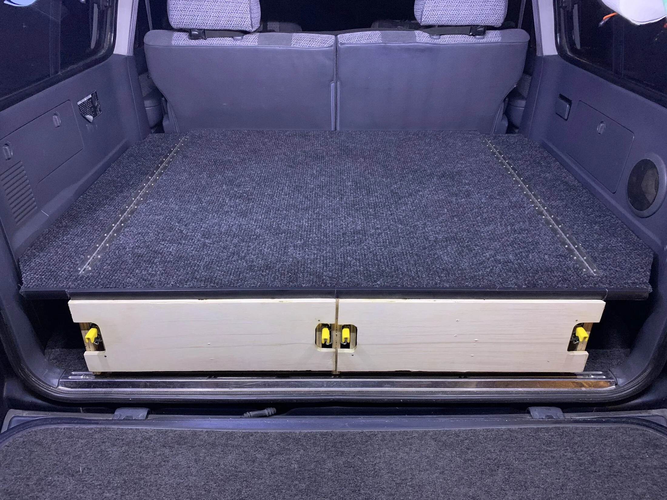

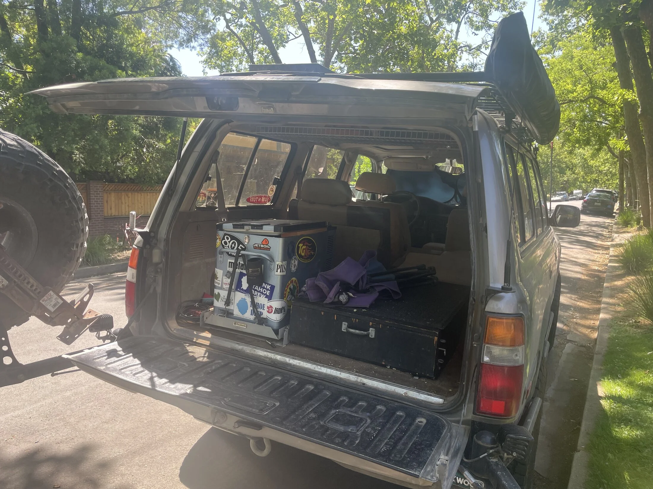

If it works for what you need then it’s not janky. Didn’t think much about drawers, until spending 4-7 days camping remotely and having to dig for stuff in different totes. Now all the basic stuff is kept in there so when I go camping I just need to pack food and gear. Have all the cooking stuff, canned foods, forks, plates, ect in one drawer and tools, fluids, spare parts in the other. I tried to keep it as light as possible. Didn’t want to spend money on a manufactured one as I’m too cheap.
