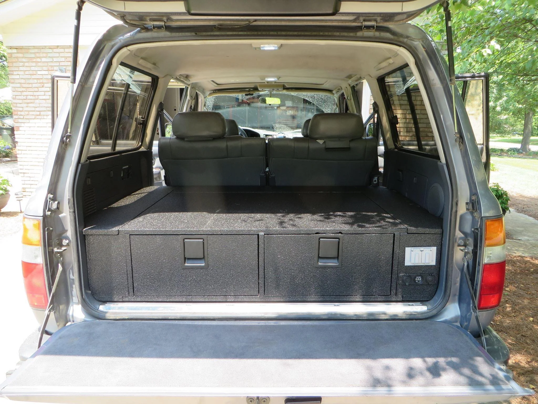

Bump. Would love to see some pics of folks rear cargo storage/drawer/sleeping platform setups. I have searched but coming up short, or maybe my search technique is off. I cant find a compilation of rear storage builds. So, whatcha got? Post a pic!

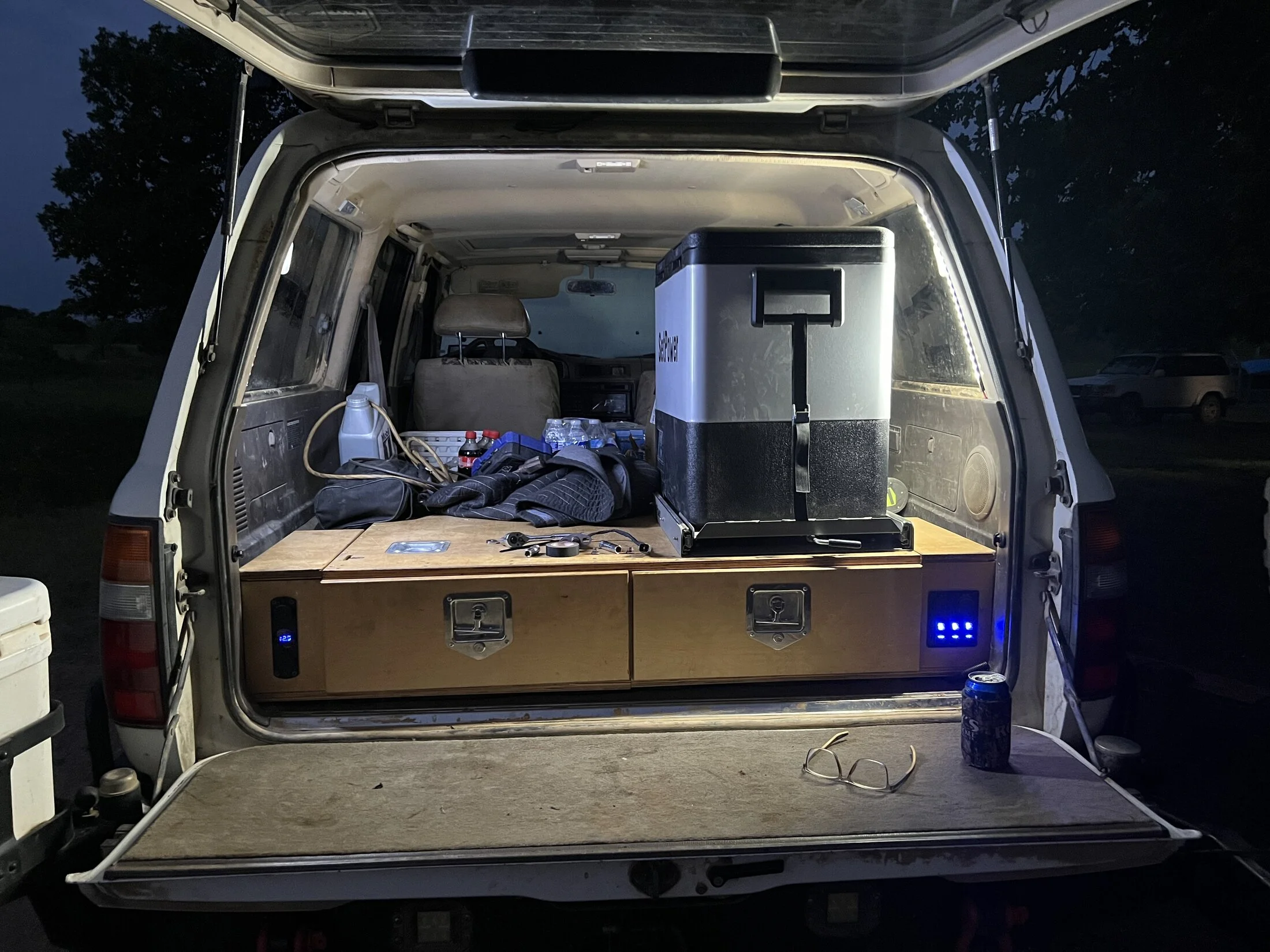

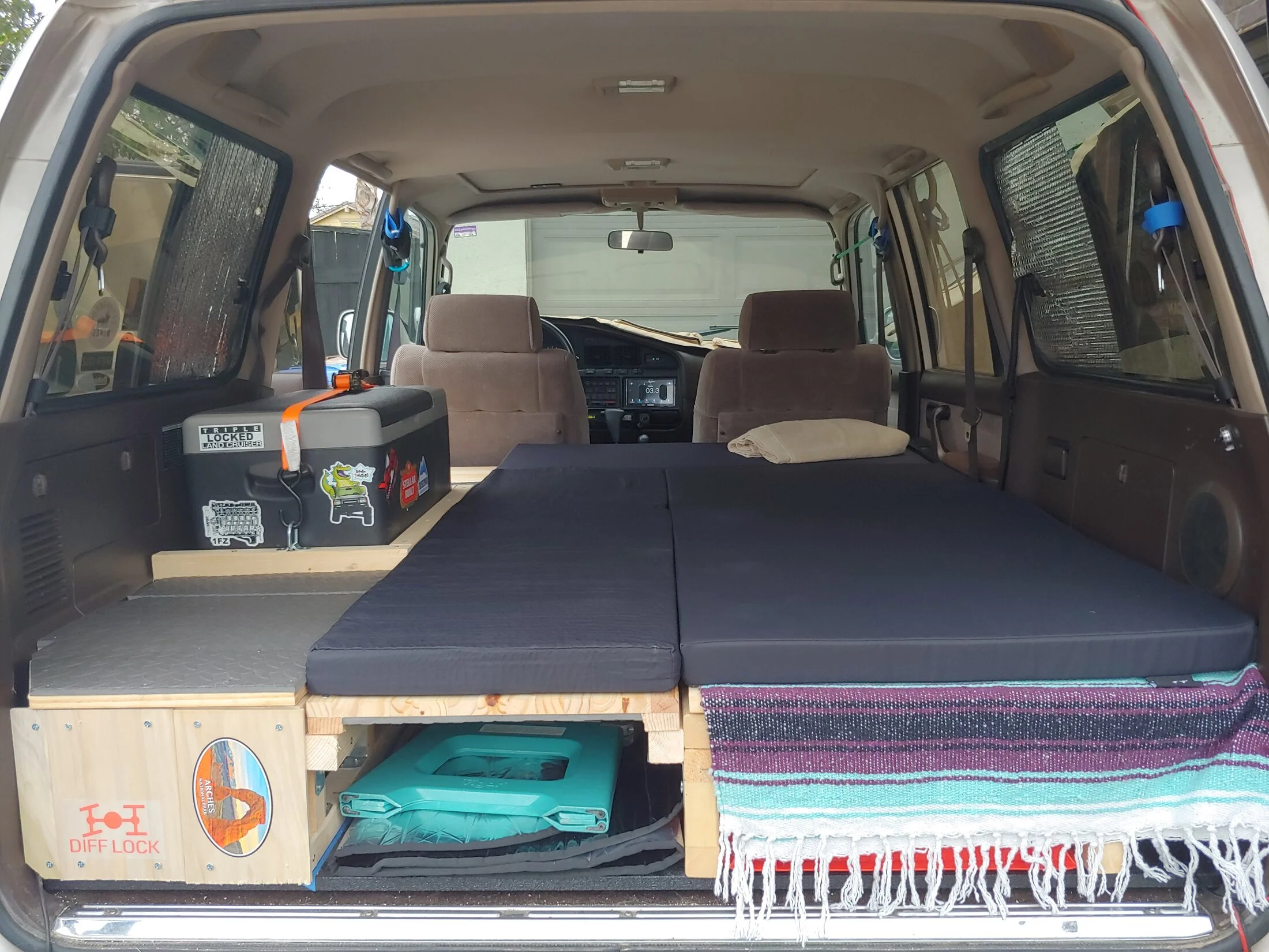

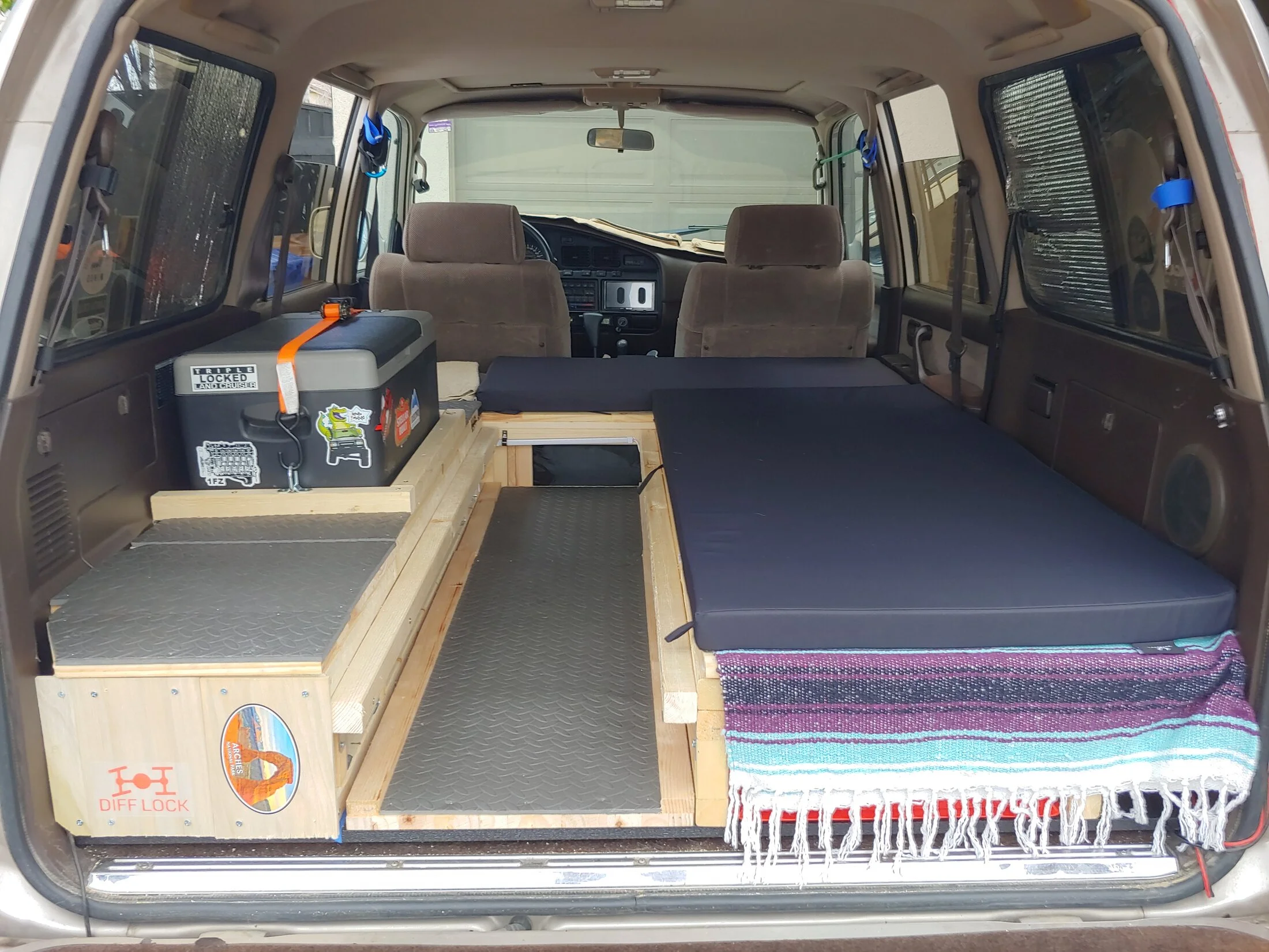

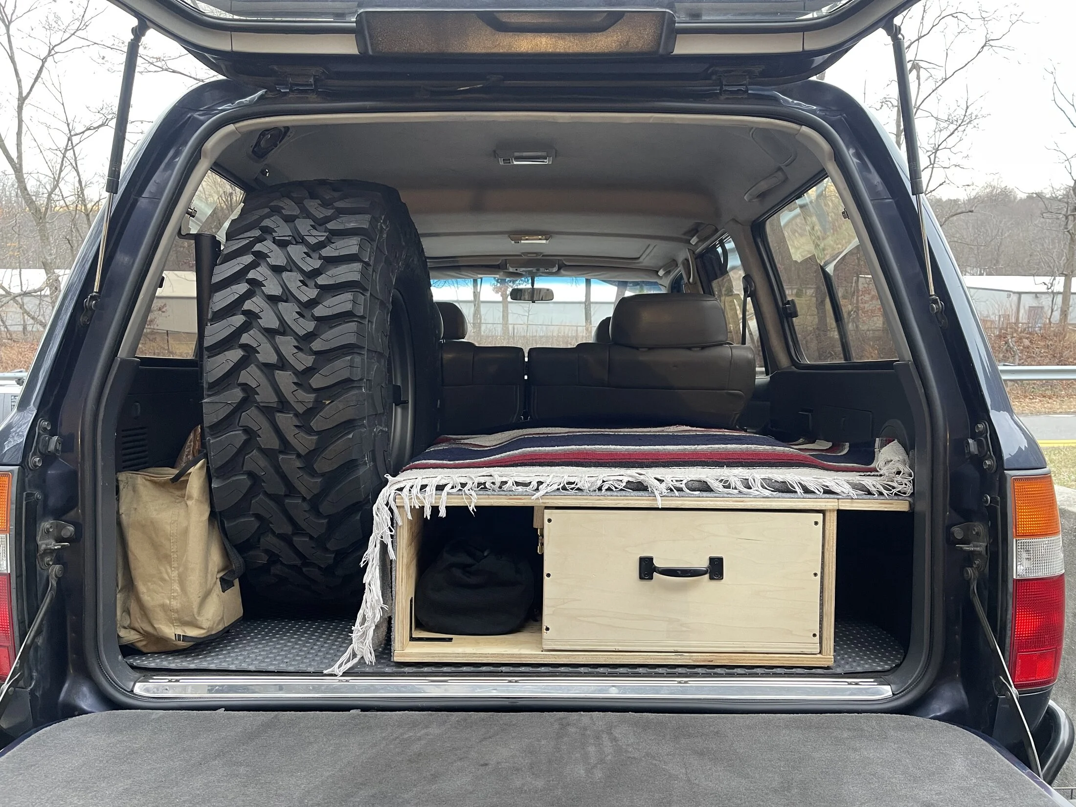

Build your own and make it however fits your needs. Here is my latest set up.

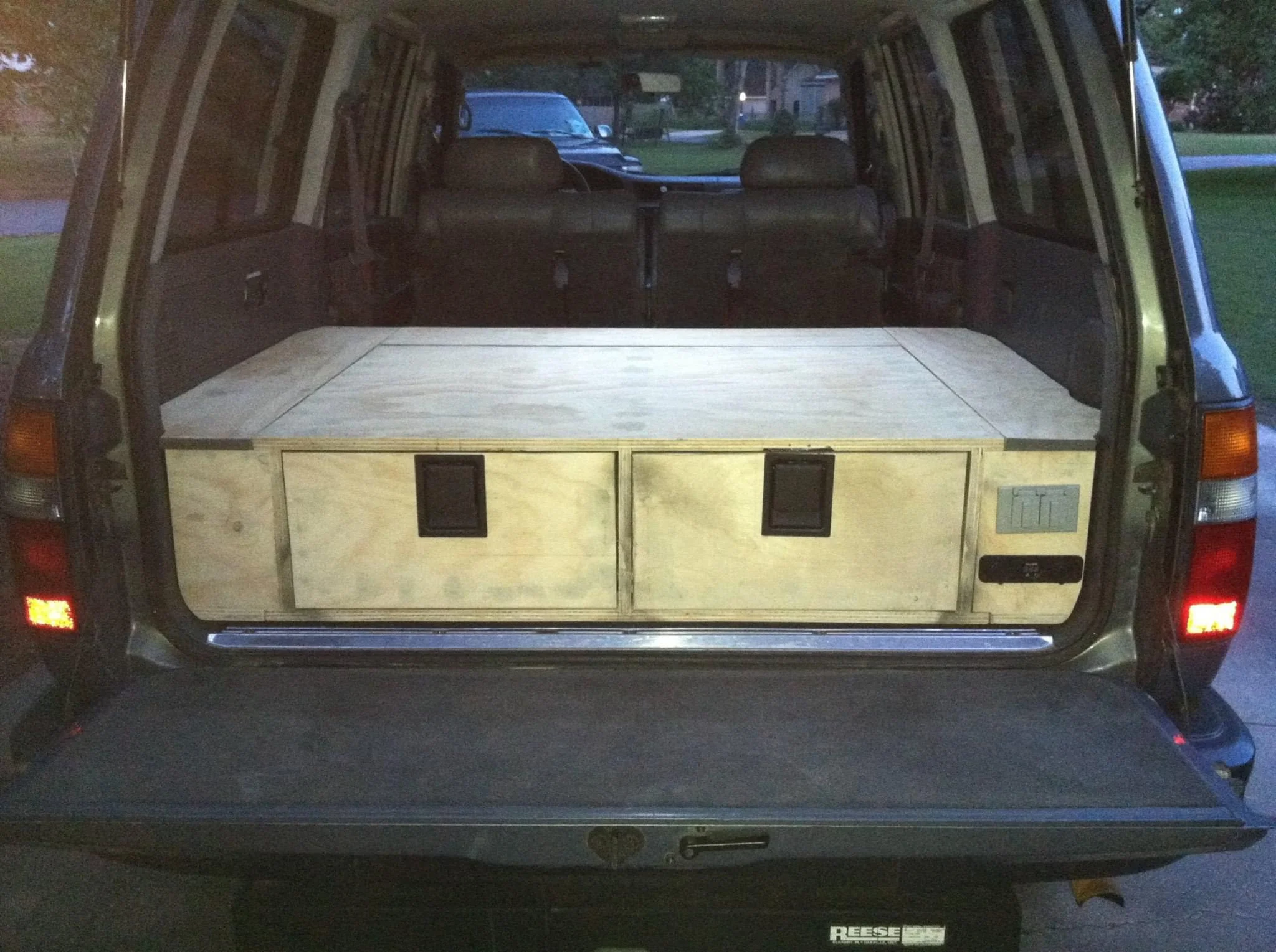

X2 "build your own" and save a few grand...i built mine for $120 but it's a sleeping platform.

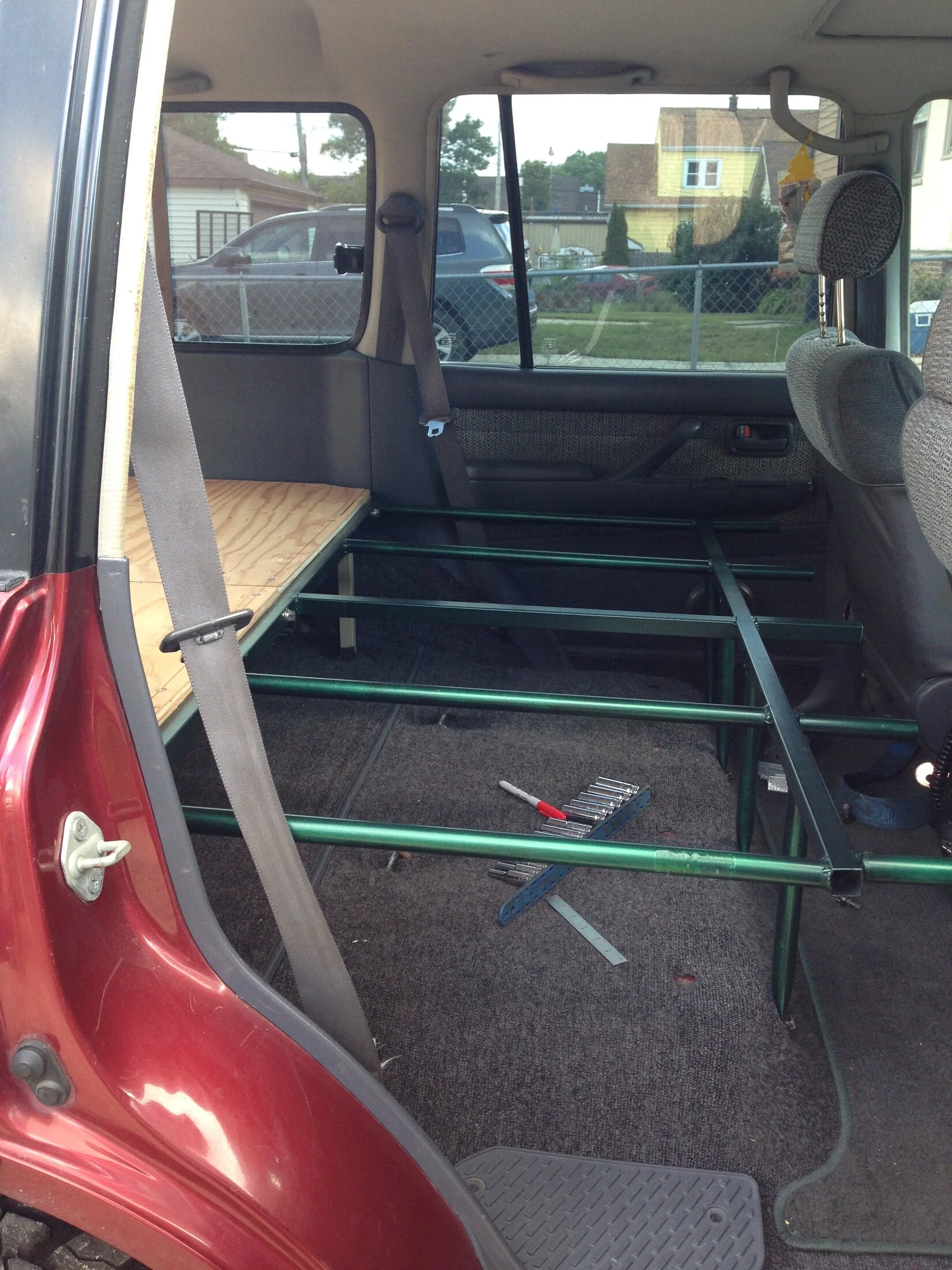

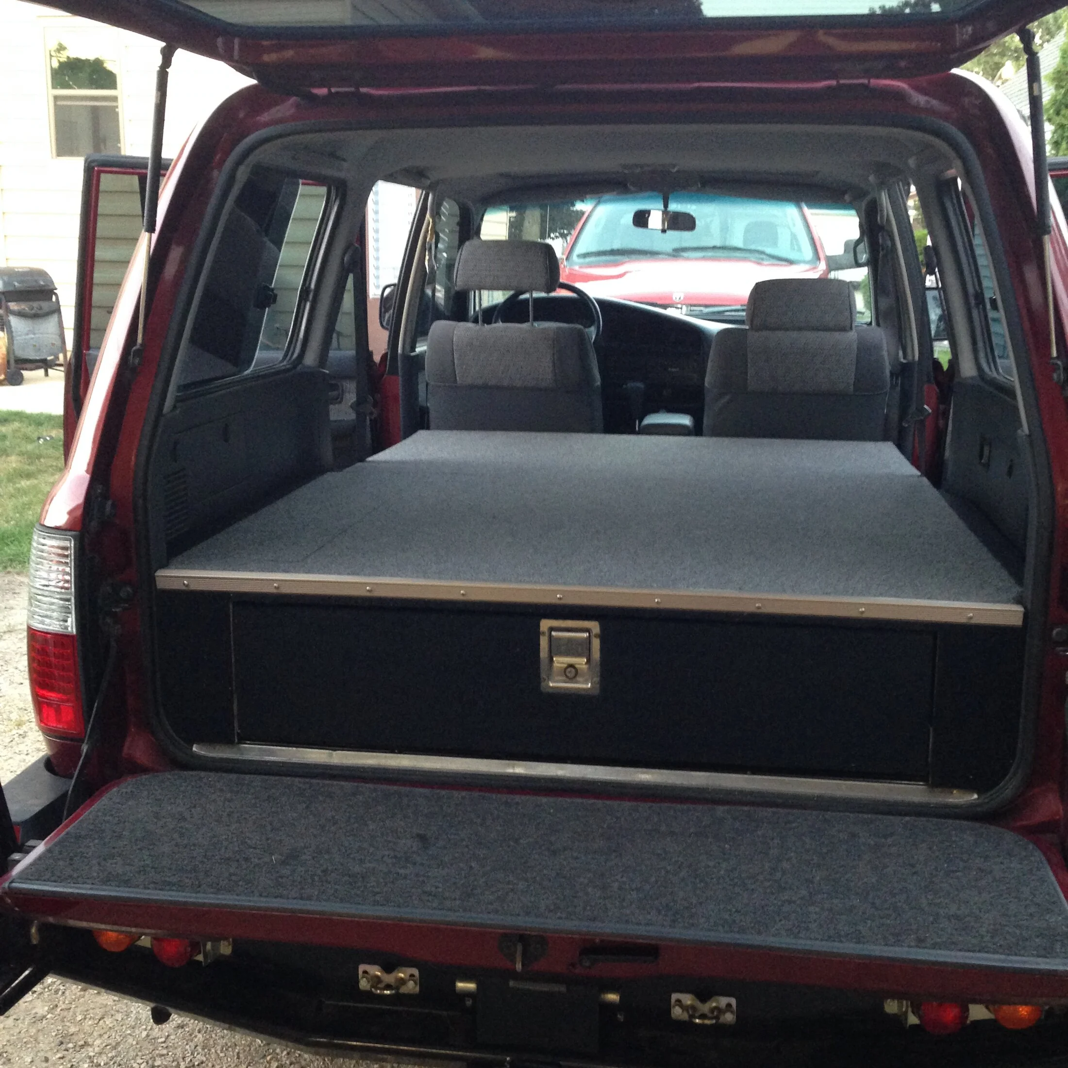

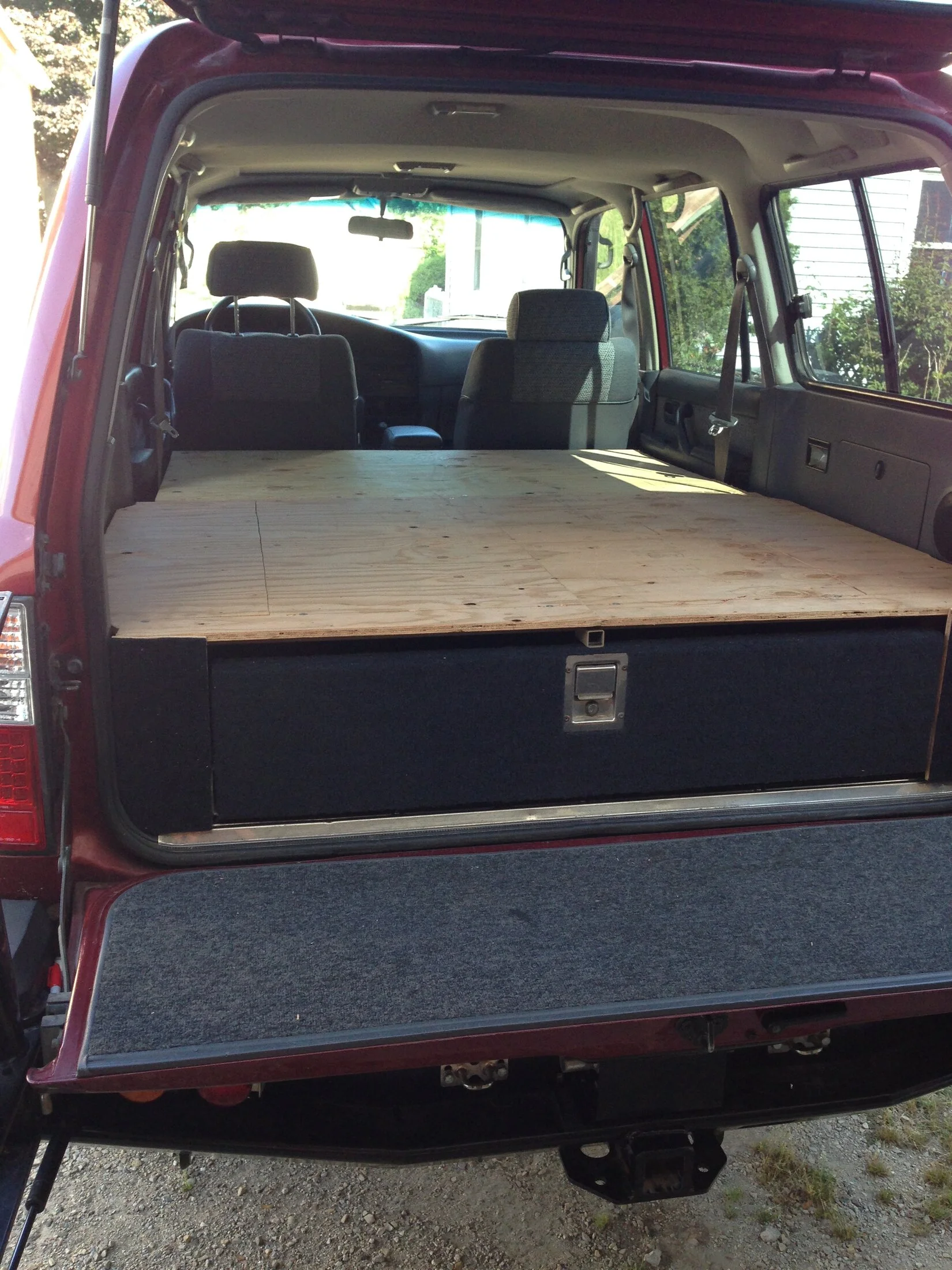

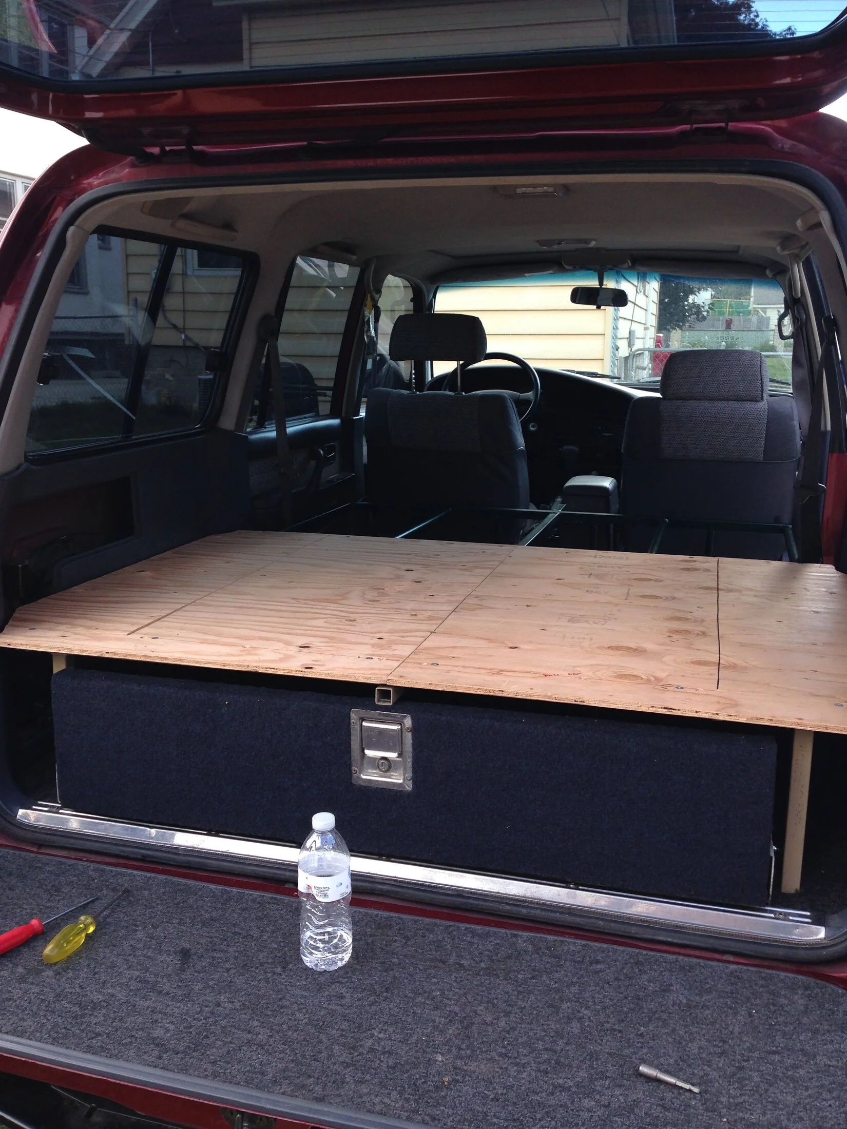

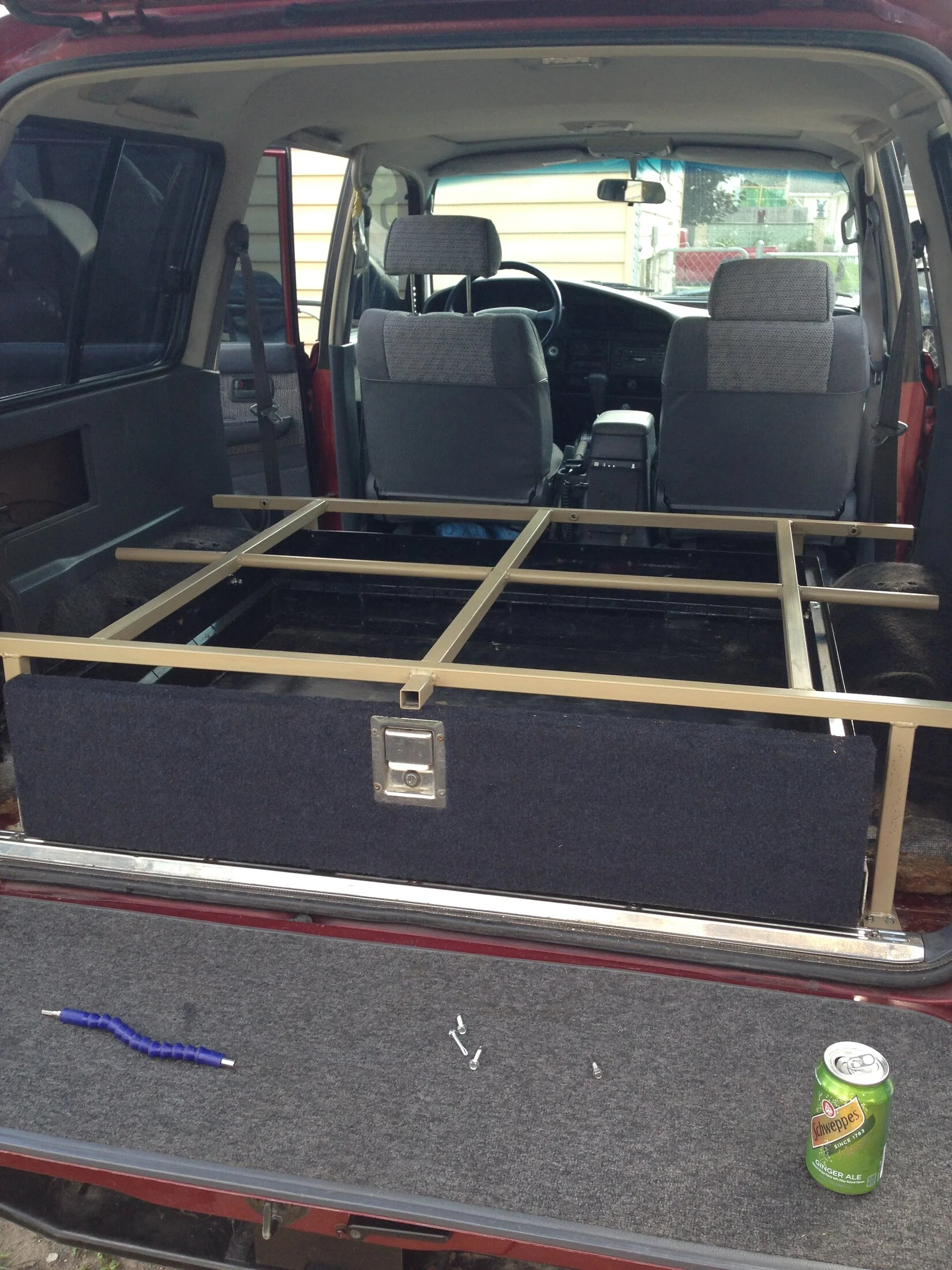

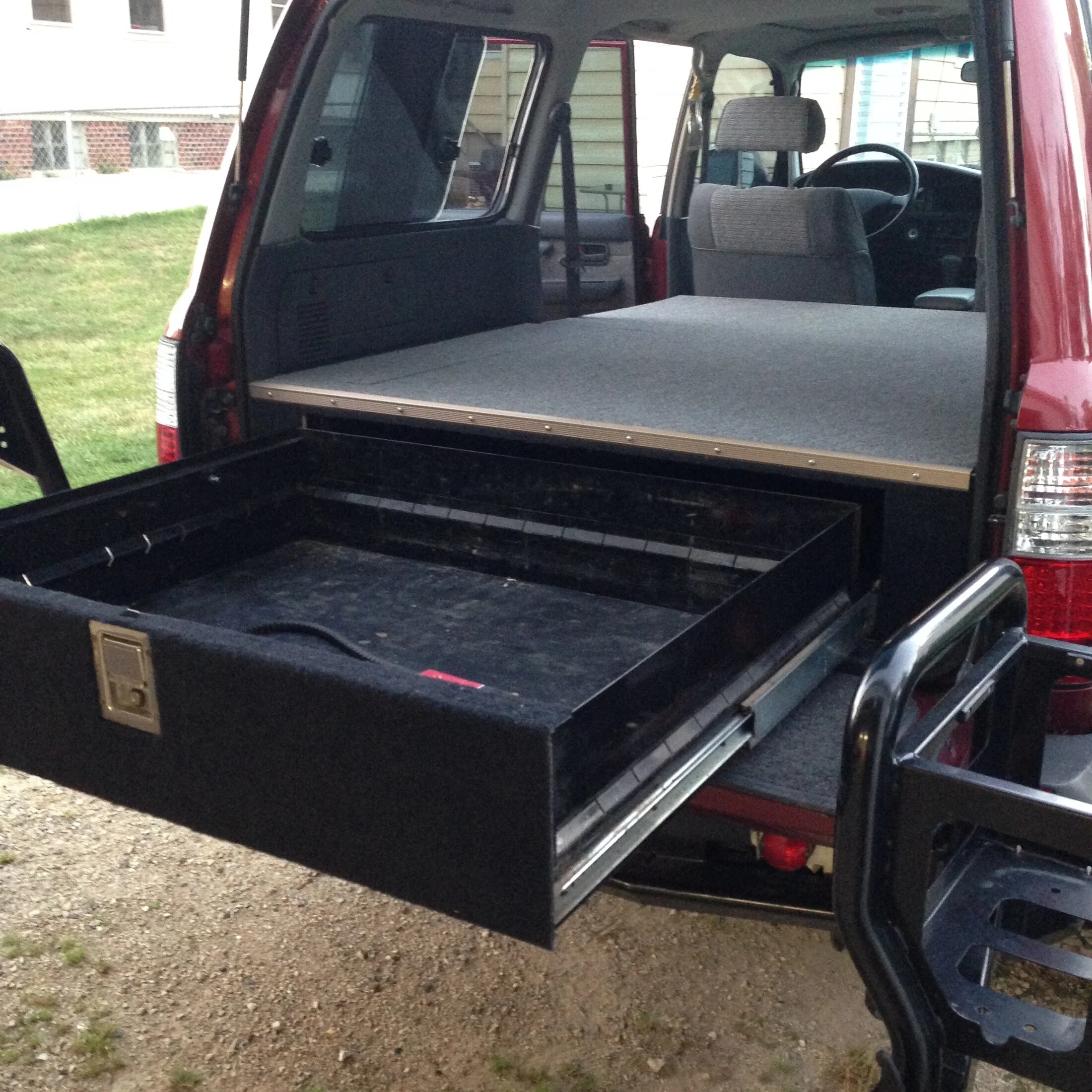

Here's some measurements, then a few pics of my first build.
This arrangement allowed olenty of space for ione operson to sleep with the hatch closed, which in bear ciontry can be important. It's less bear proof, but withe the tailgate lowered the fridge drawer slides back, a board is laid over the resulting gap, and the tailgate tent can be installed to provide lots of space for two to sleep.
I'll post some pics of my current set-up a little later.

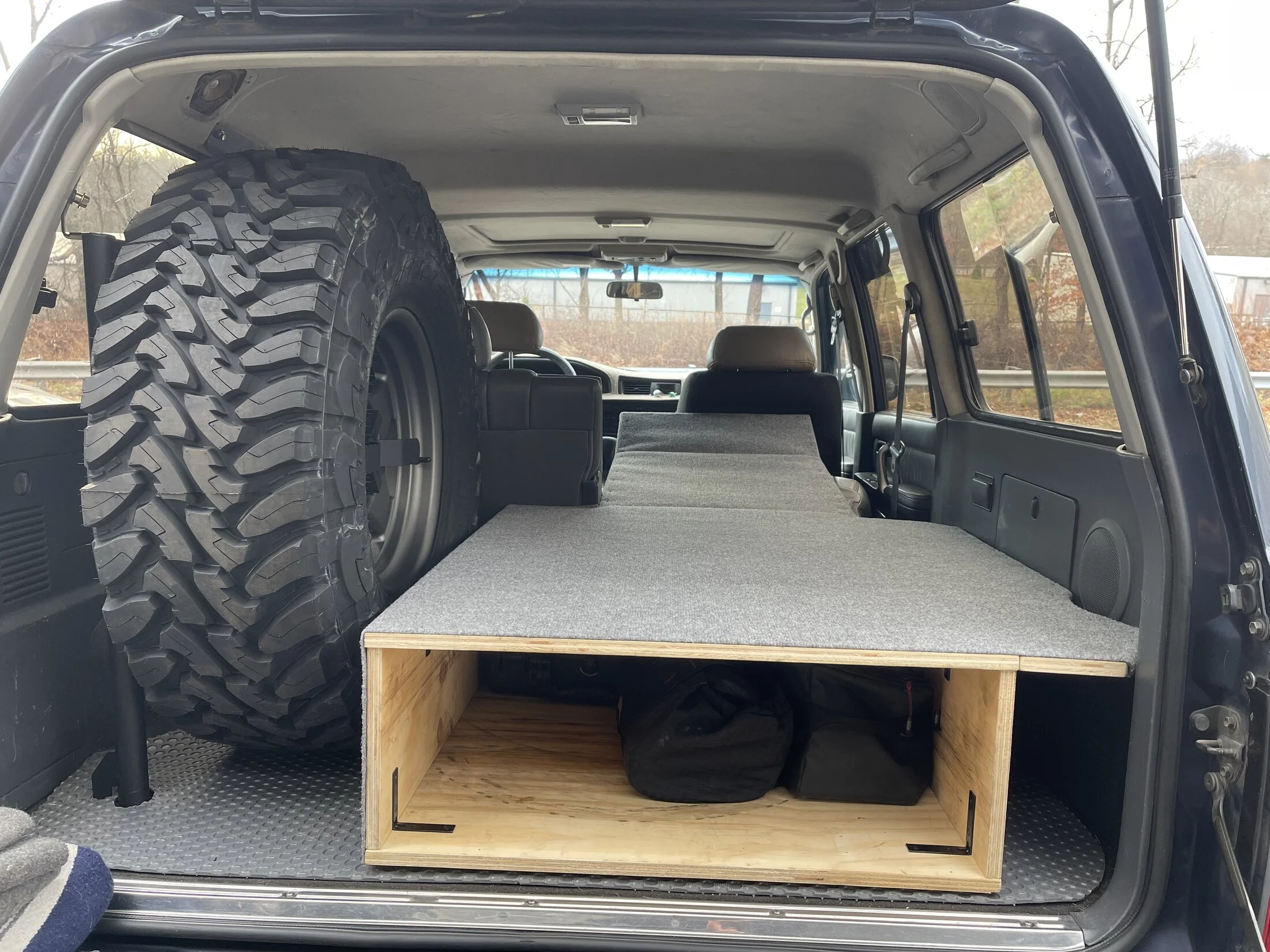

I built my own about 10 years ago and still enjoy it. About 2 sheets of plywood, 2 pair of slides, 8 hinges and a pair of locking paddle handles. Sprayed it with Rhinoliner and done. Lay the second row down, put 2x4 block under it to level seat and you have a sleeping platform.
