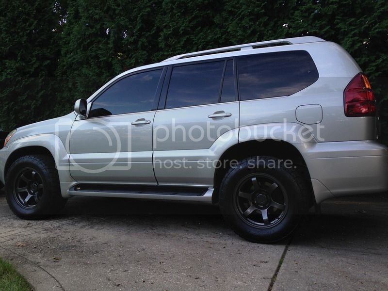

DON'T use 4Runner springs. Use FJ springs. I've said it a million times, my belief is the 4 Runner springs don't do well with the added weight of a GX. I have FJ springs in mine and it is literally night and day difference how much better it rides without bags. FJ springs also give a small amount of lift, which in my opinion is perfect. Gives the truck a bit of rake which I think looks fantastic.
I don't mean to picture whore my truck, but this is with FJ springs in the back. Everything else is stock.
Metal-tech 4x4 also usually has good matched pairs of take off OEM Toyota FJC springs avalible too. Just have to ask if we have any. They almost all end up on GX470's.
BlackCat, Please provide addition pics, especially a view directly from the side so I can determine if I want the slight lift in the rear. As mentioned above this is my wife's car. She wants it back exactly the way it was before this fiasco. I like it...just need to be sure she's not going to freak when she sees it. Thanks again to everyone here for your input.
In my case, the FJC springs provided 1/2" of lift over the air suspension at Normal height. Depending on your wife's attention to subtleties of a 4x4, she may not even notice.
