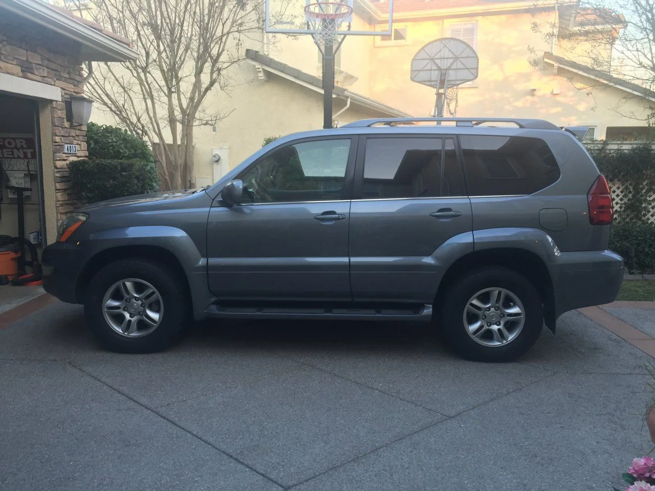

Got the Duralast springs from autozone installed. Happy with the ride. I think I have approximately 1" of lift in the rear, but not sure as I have nothing to compare to. Picture attached.
Awesome let us know how it rides loaded up when you can.
