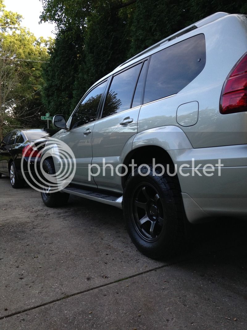

BlackCat, Please provide addition pics, especially a view directly from the side so I can determine if I want the slight lift in the rear. As mentioned above this is my wife's car. She wants it back exactly the way it was before this fiasco. I like it...just need to be sure she's not going to freak when she sees it. Thanks again to everyone here for your input.
Mine netted me me roughly 1.25 inches of lift. I used springs from a Trail Team Edition FJ. The REAL benefit is how much better it rides with springs instead of bags. It's night and day difference.

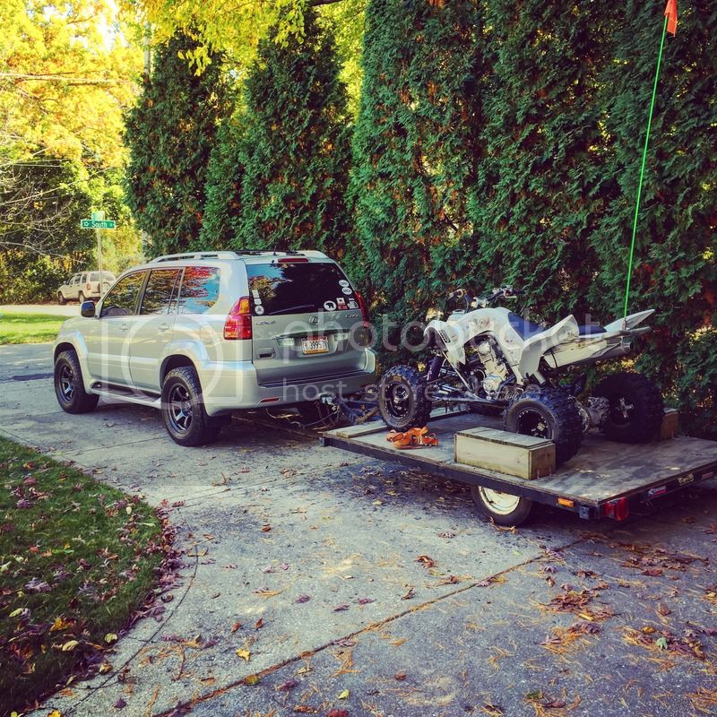

It's slightly less tall in the back now than it would be with the factory airbags in the "high" position. This is one of my truck when it still had bags and the back was raised to high.
