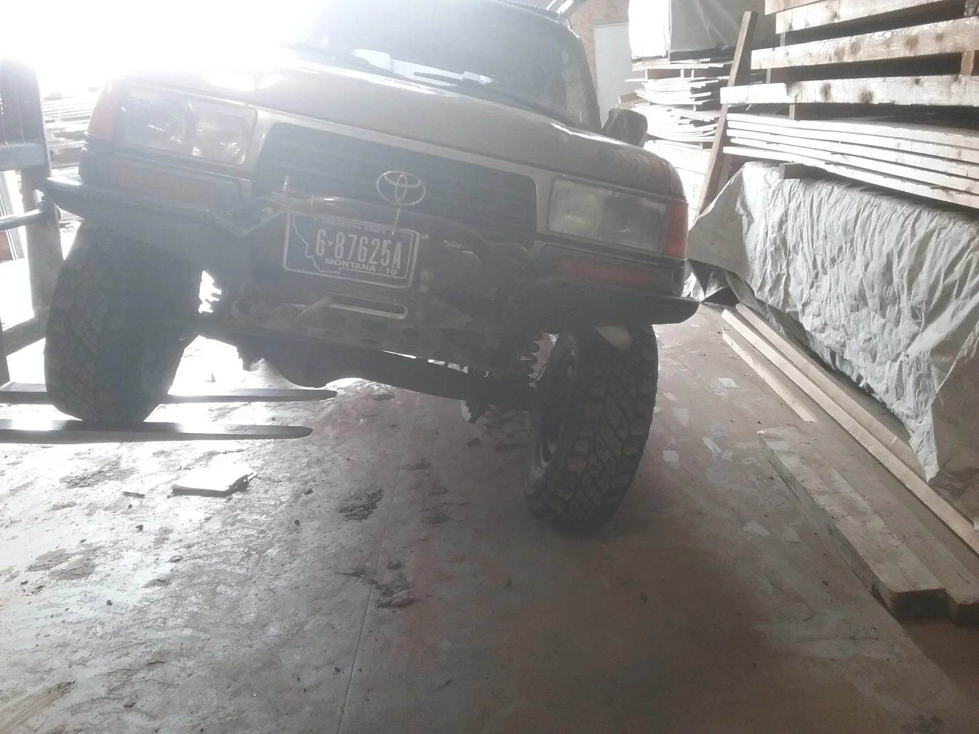

I will try and get measurements of the shocks tomorrow. What would the best way to do that? If I lift one tire all the way up with a fork lift will the other side be fully drooped? And the lifted side fully compressed? Ill put a straight edge on the shafts and take a pic too.
Thanks for looking into this for me. If it's user error I'll totally own up to it, just trying to figure out what happened.

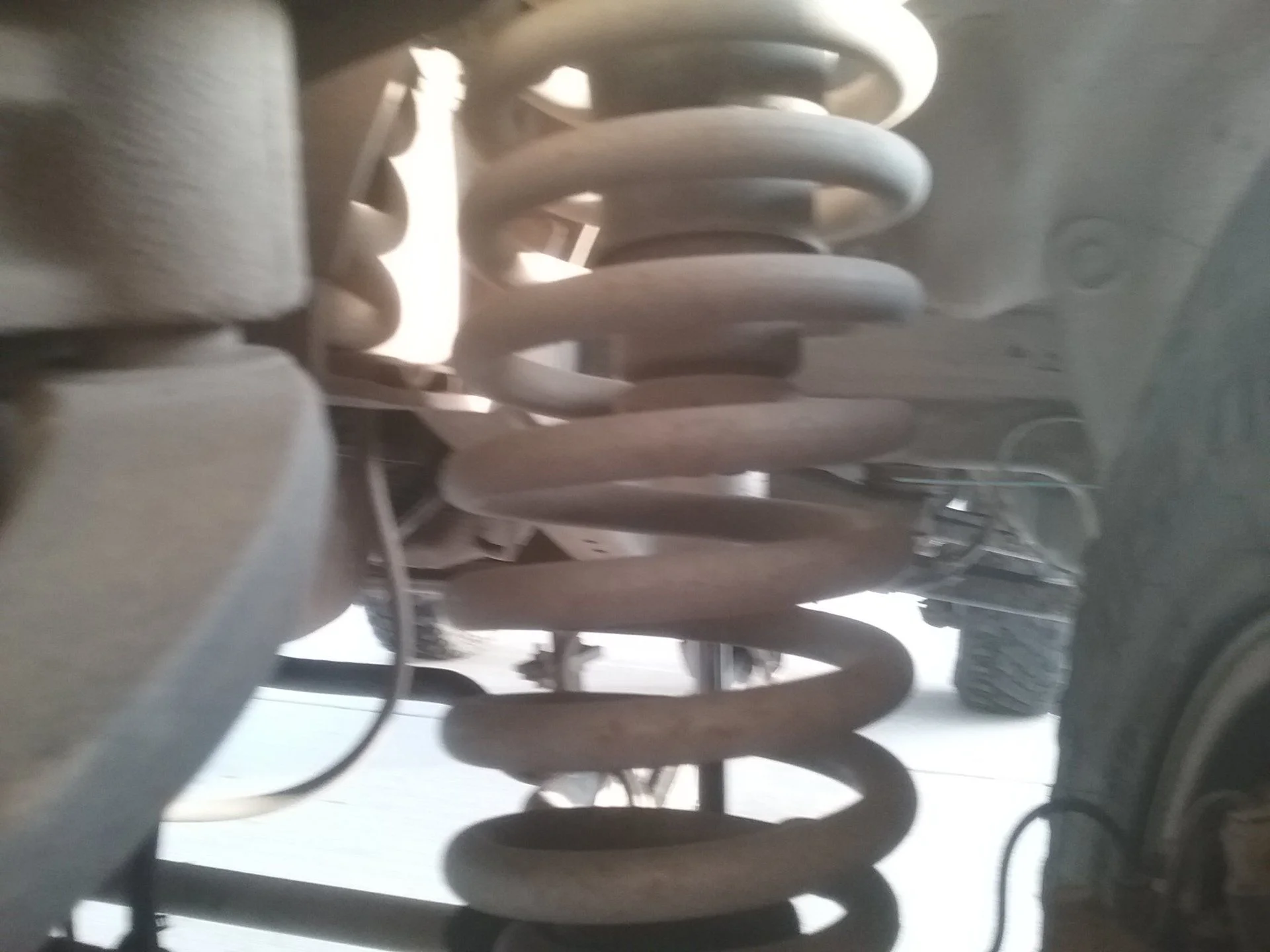

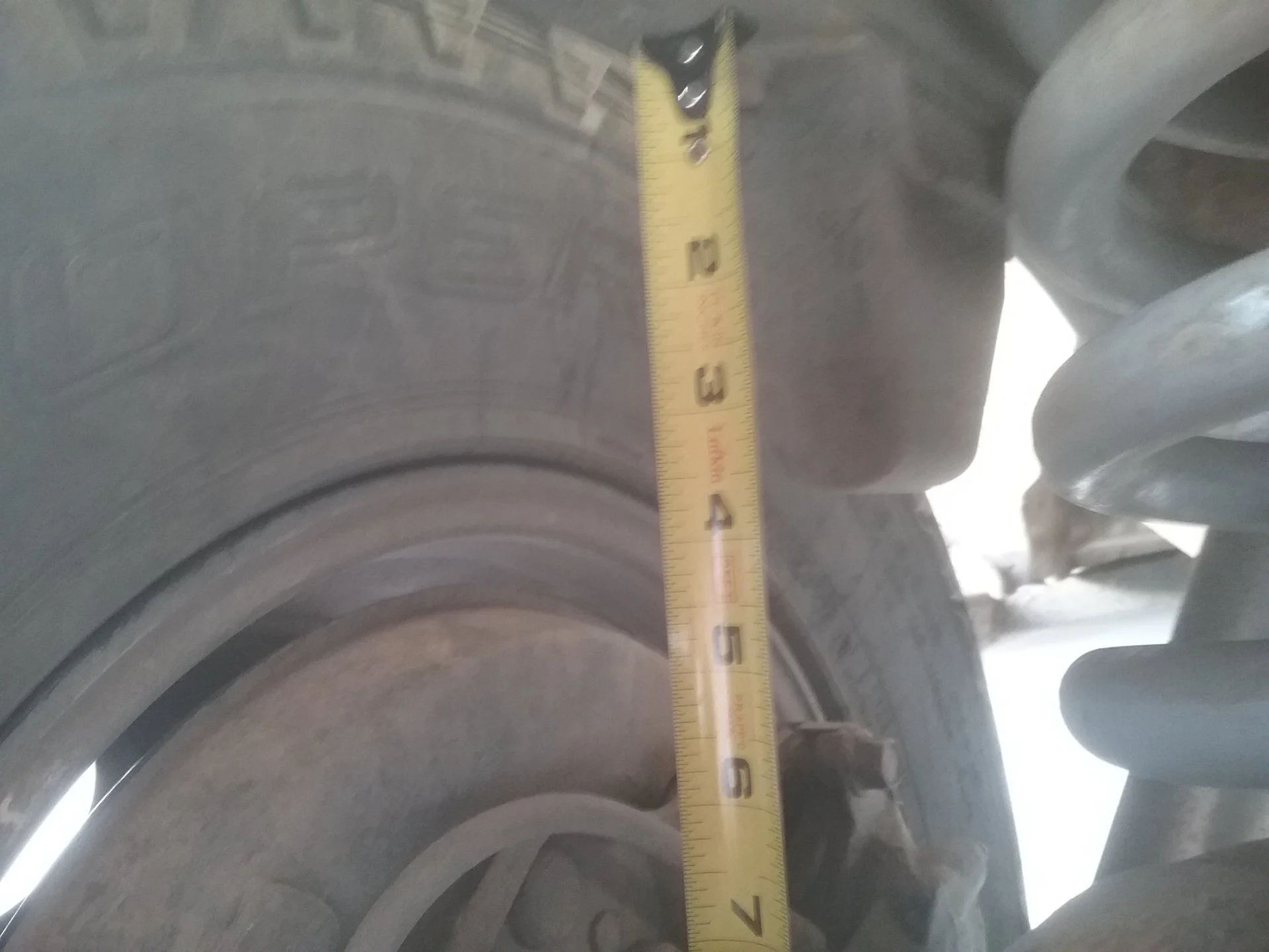

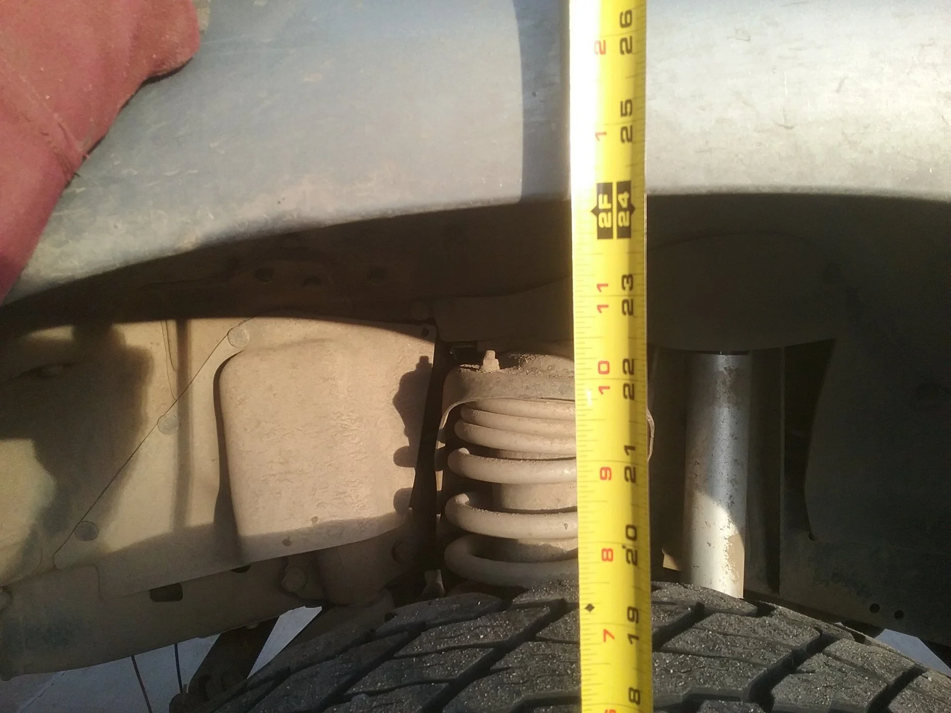

I lifted a corner of the truck with a forklift, but I was nervous and think I didn't get high enough. I had almost an inch before the rear bump would contact. Rear tire was 32" off the ground.

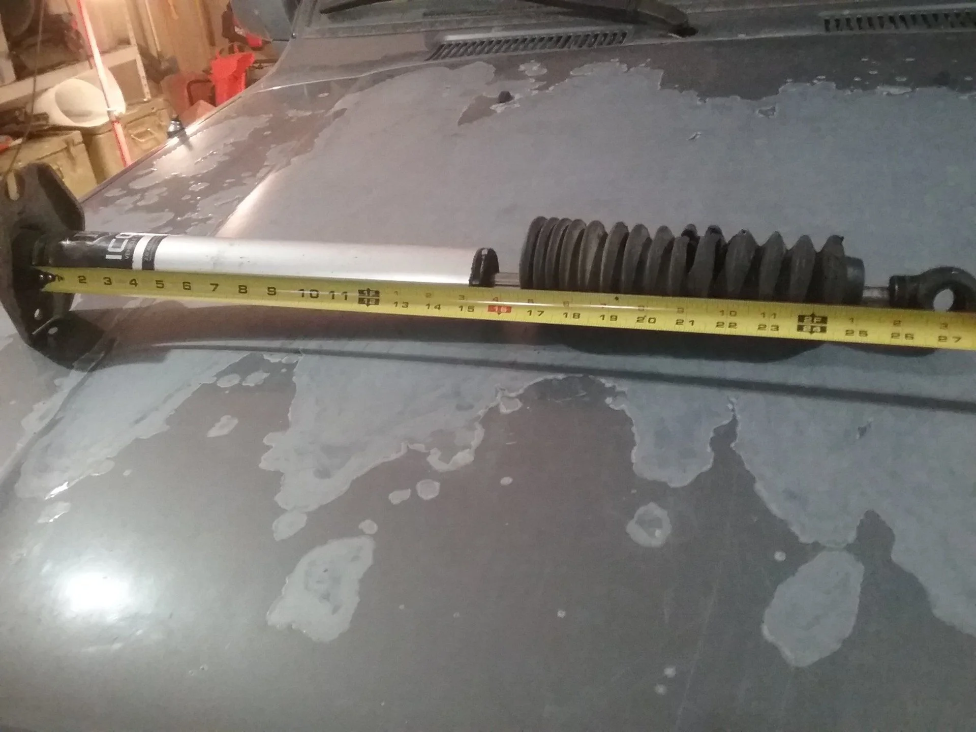

Rear shocks :extended 28 1/2" from bottom of top shock mount to center of bottom mounting bolt. 18 1/2" compressed

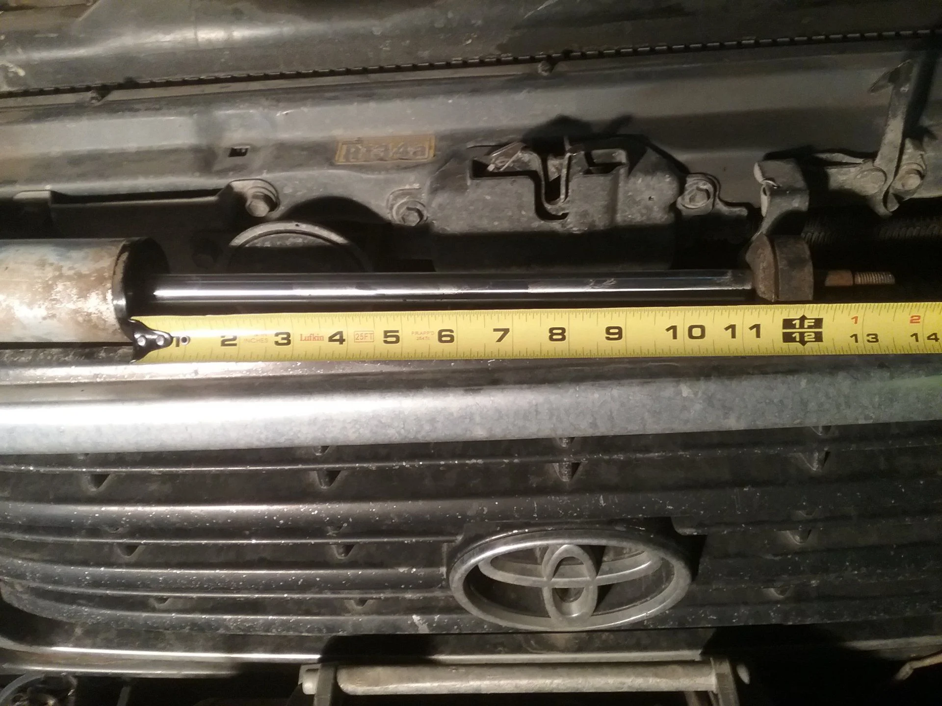

Front 27" extended. I couldn't get the fronts compressed on the truck. I can pull them and take measurements if needed.
The shocks should be
Front AC56511 16.85"/28.17"
Rear AC56512 16.85"/27.42"

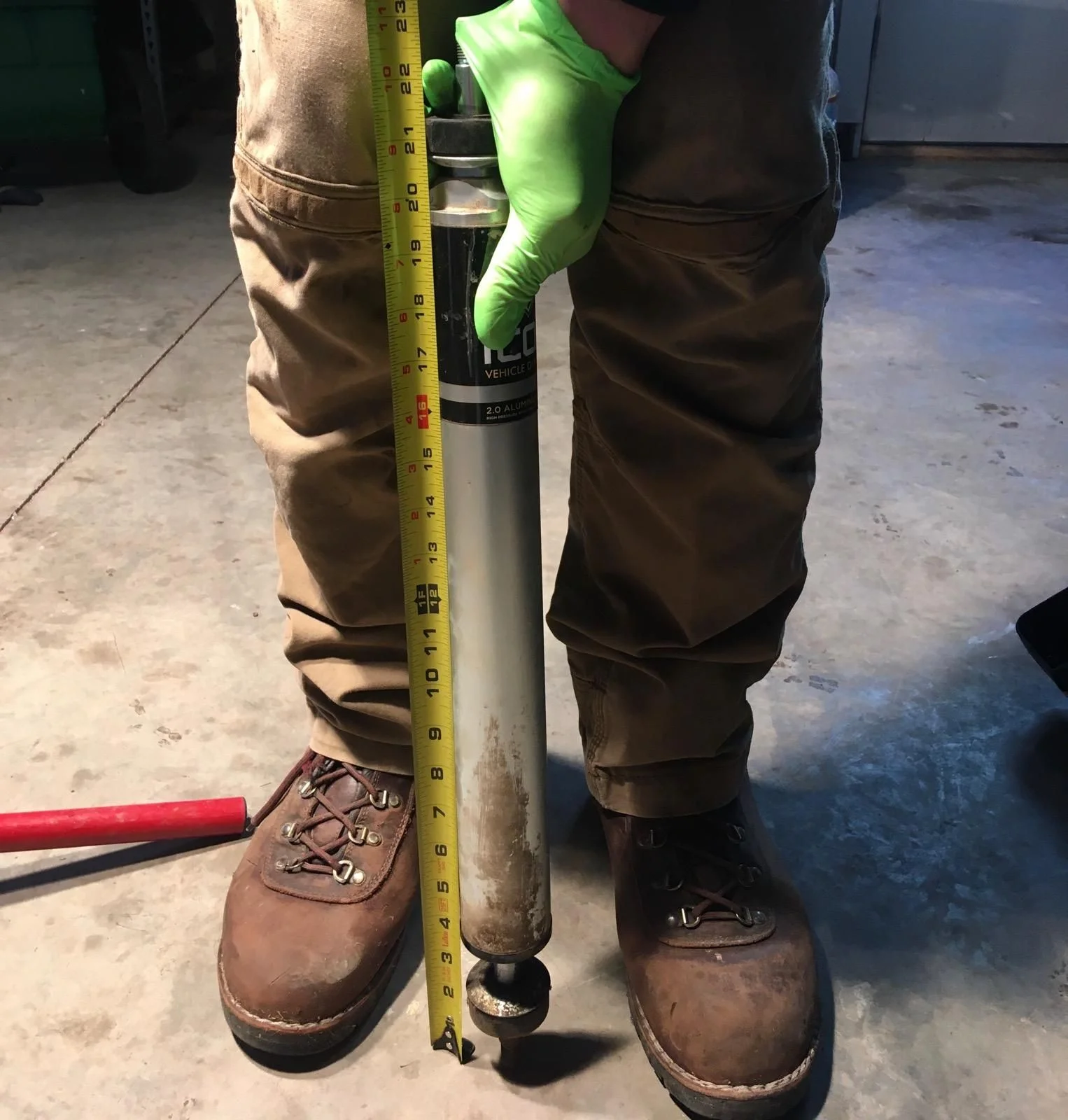

If you get a chance pull one off the front and one off the rear to check. The extended length you provided looks about right but if your compressed length is accurate then your's look to be 2.5" too long.

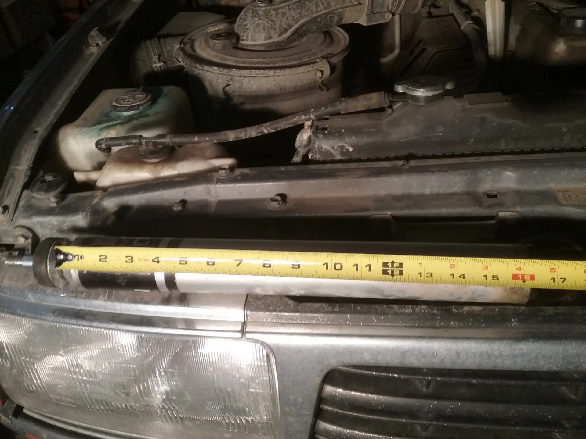

I took 2 shocks off this weekend to measure compressed lengths. I put a cheap square on the shafts. You could see a light gap but it was consistent along the shaft. I don't really know if they are bent. I have a better straight edge i can stick on and see.
Did the shocks compress without binding?
