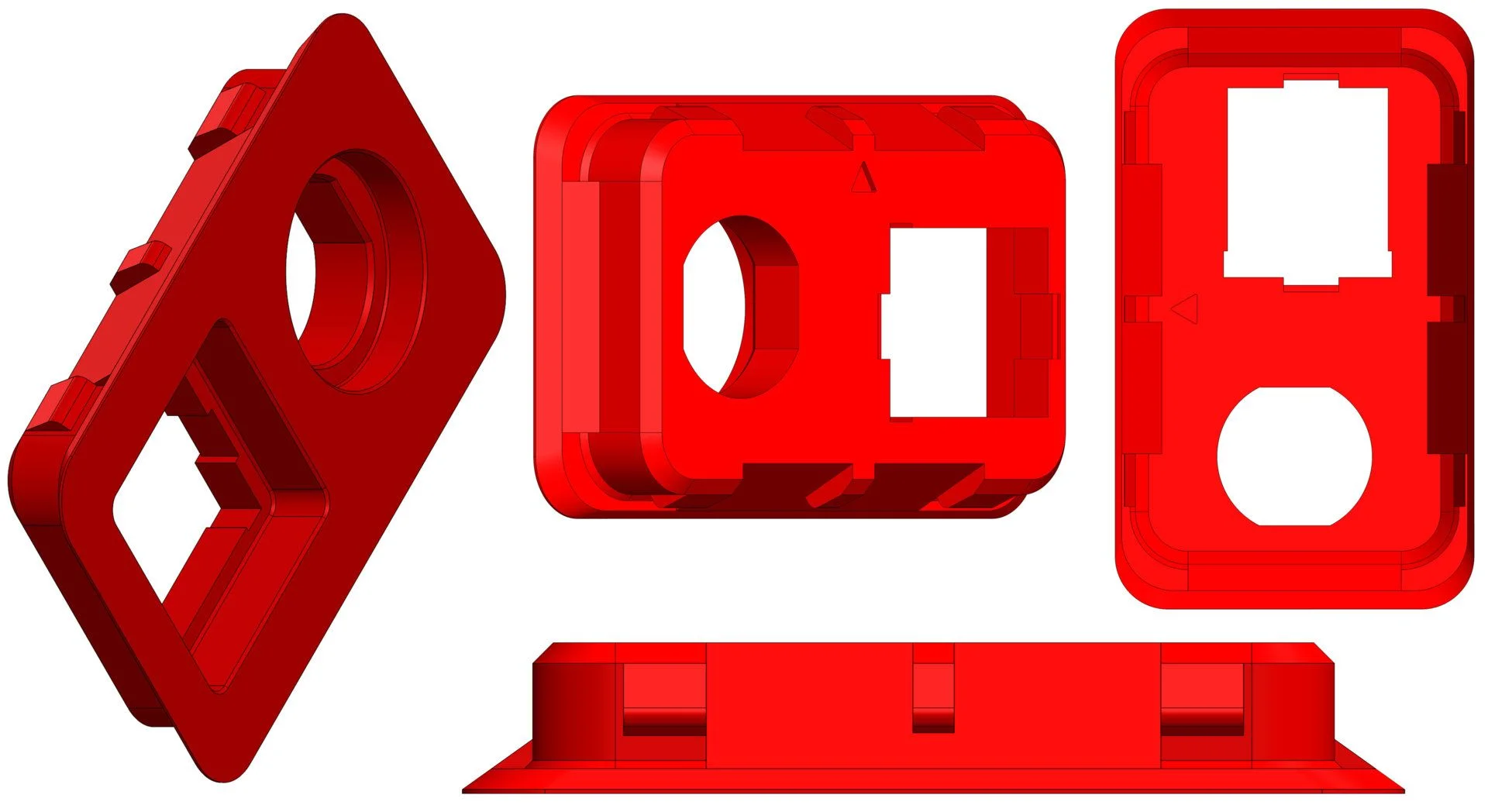

Put it on the truck. Dimension is OK.

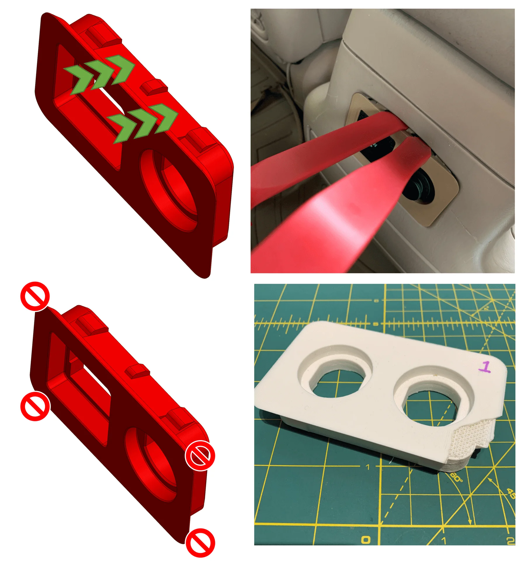

One problem is the snap-fitting hooks on the part is too rigid. Once it got in, it is difficult to get it out. Need some adjustment.

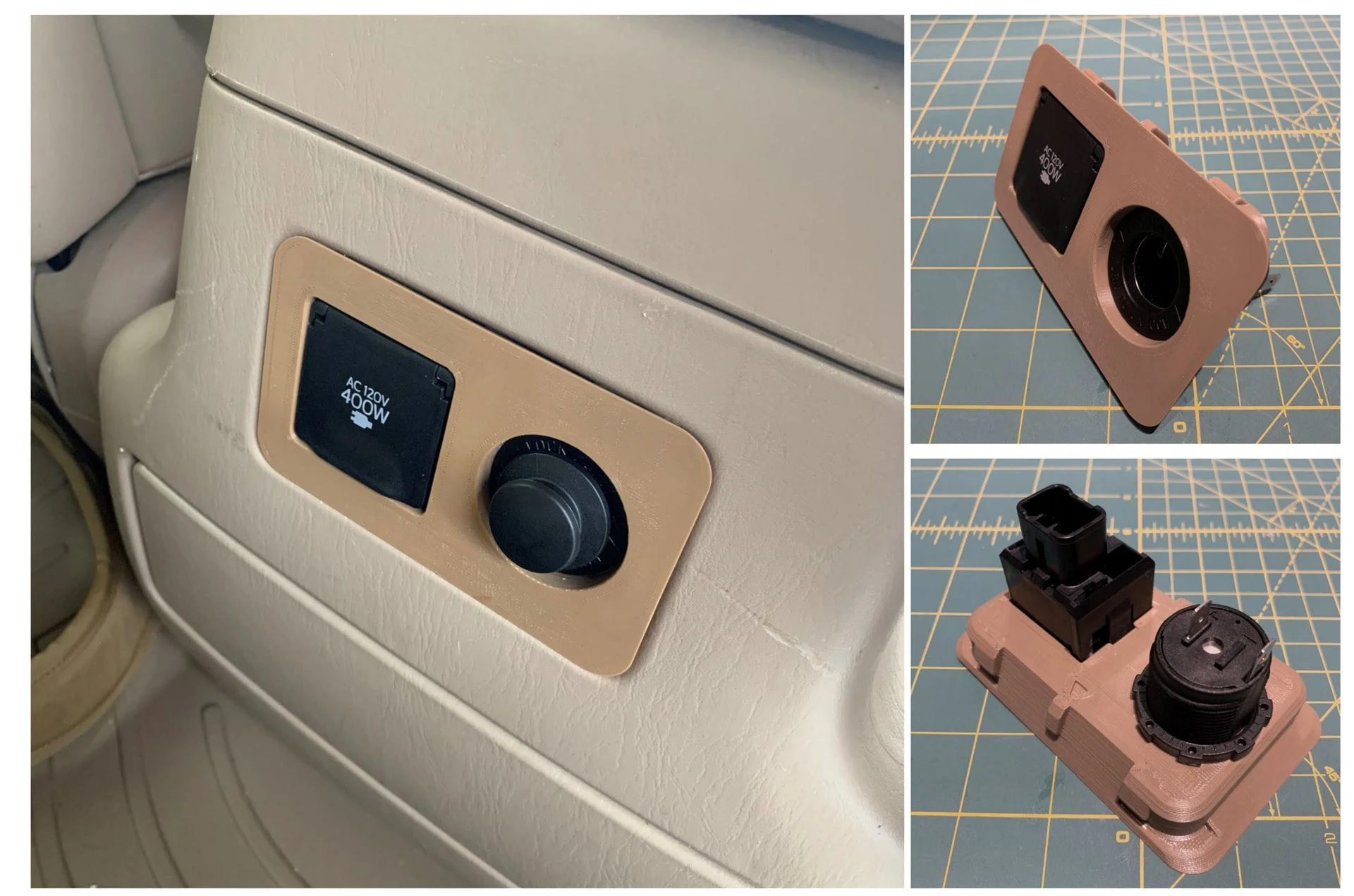

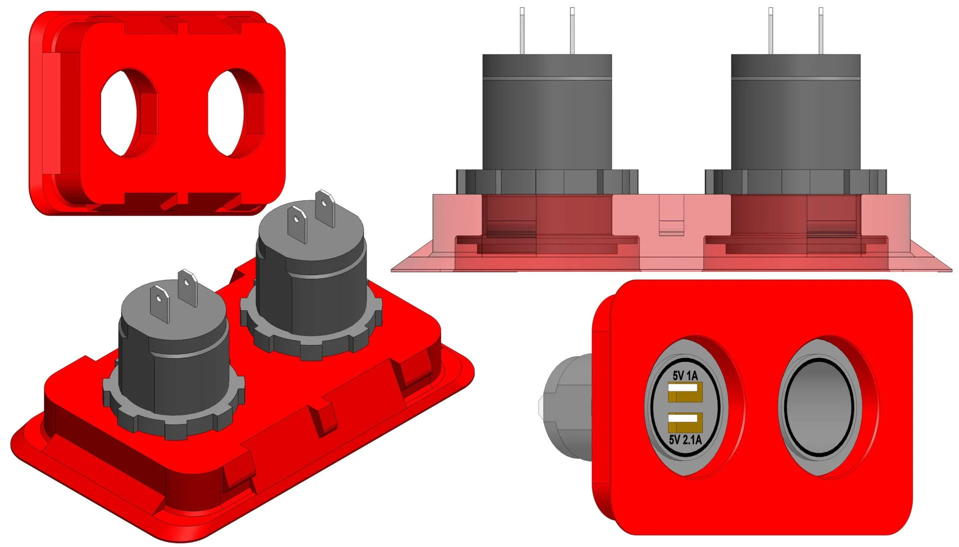

7.1 Overview of the Final Product

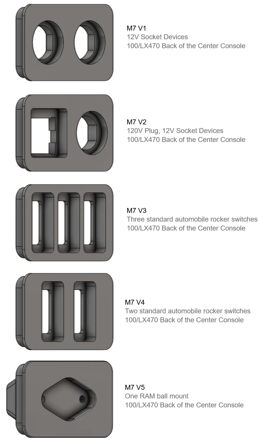

Make7 V1
Note: Make7 V1 mounts two 12V socket devices, such as
12V Socket
USB Extension
USB Charger 2.1 A
USB Charger 4.8A
Make7 V2
Note: Make7 V2 mounts one 120V outlet and one 12V socket device. The Toyota part number of the 120V outlet is 85530-35050-C0. The harness can be found here.
Socket device CAD courtesy of Alexander Polyakov at Free CAD Designs, Files & 3D Models | The GrabCAD Community Library

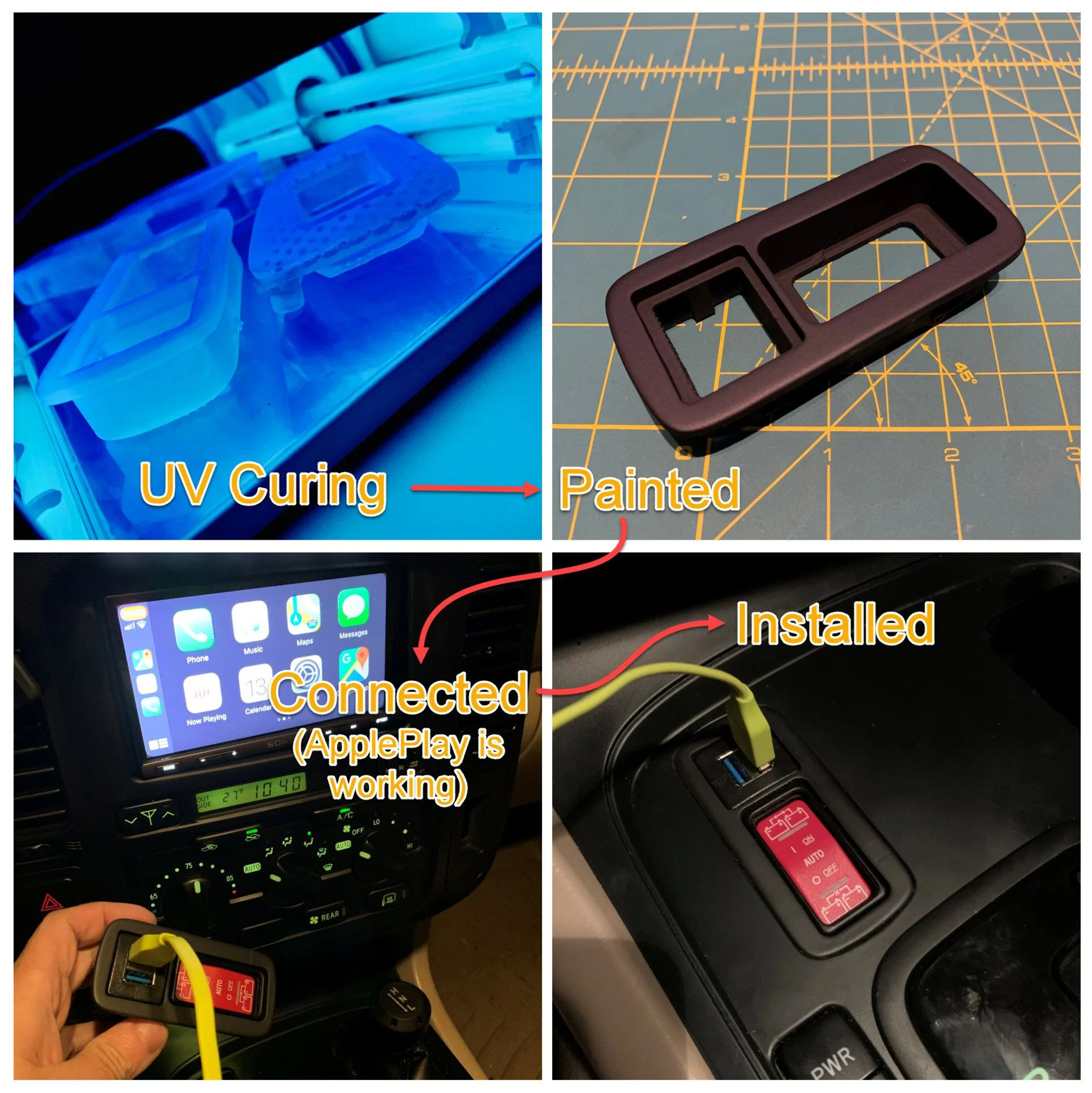

7.2 Introduction
This mount it to replace the blank panel or the radio control unit at the back of the center console. It mounts two car socket devices.
7.3 Design and Fabrication

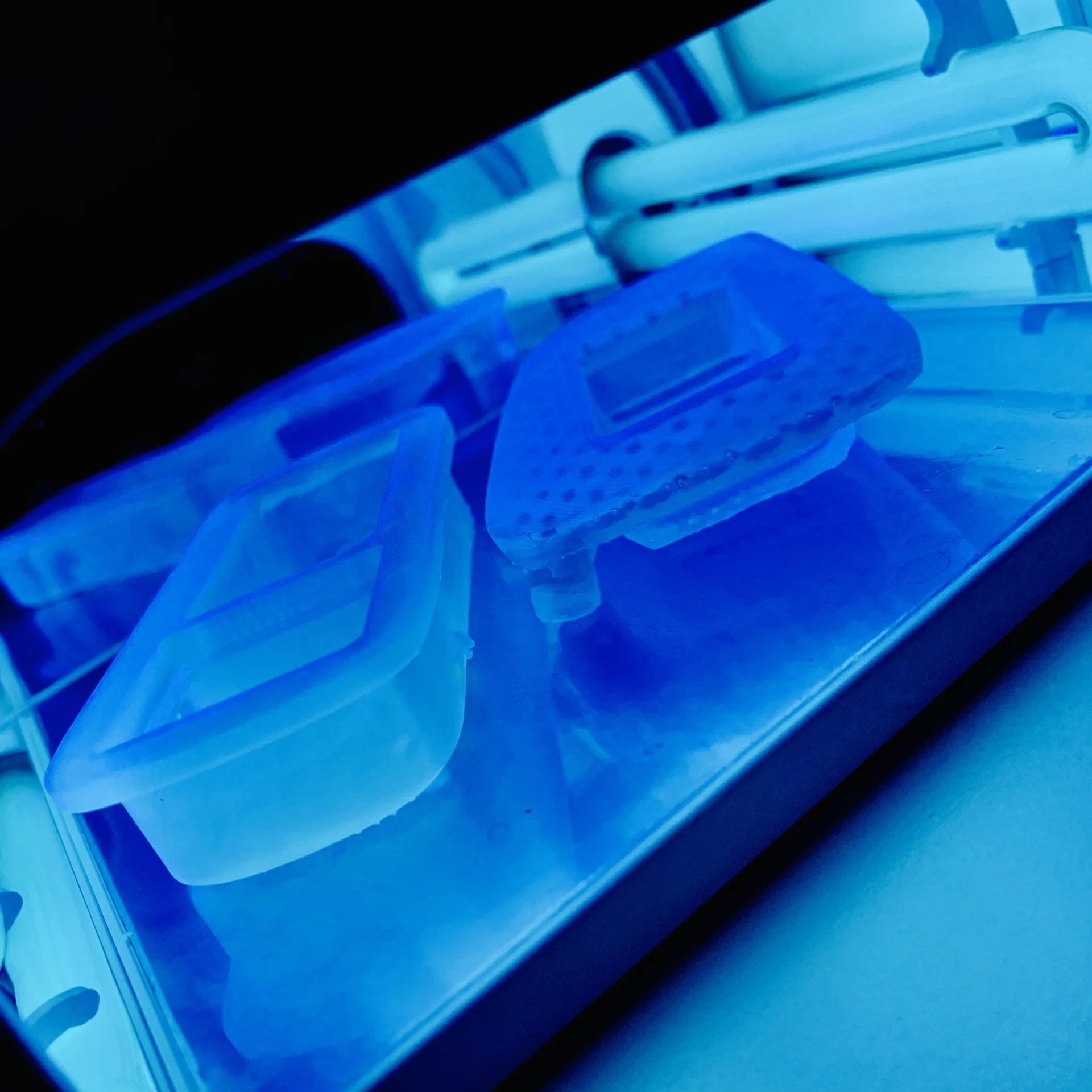

Multiple prototypes have been made to test the dimensions, surface printing method, and materials, etc.

Note: The following figure shows how you remove the mount and how not to.

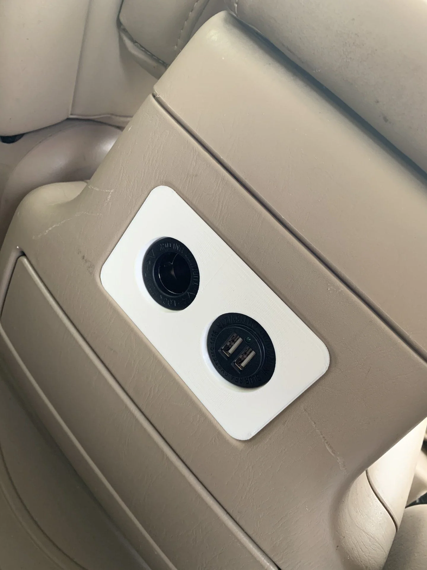

Your Amazing!
A lousy picture of an install (done in the dark):
My kid loves it!
In my preferred seating position, I've got limited visibility of it, but I am ~5" taller than he is.
My kid loves it!

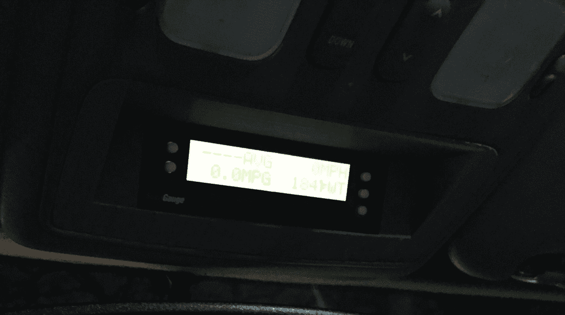

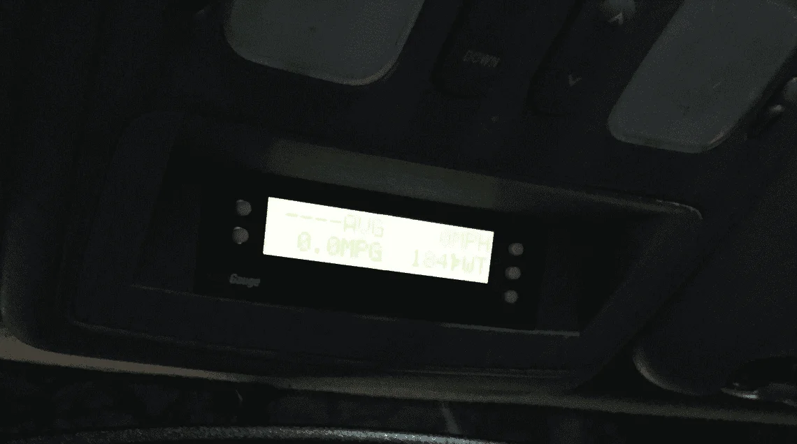

I found some version of Scangauge II has very narrow angle of view from left to right. This version has solid plastic buttons.
The other version has very wide view, which has soft rubber buttions.
My lousy picture might have confused the issue a bit. My issue has less to do with the LCD viewing angle, and more to do with my height, and a preference for very upright seating position. I only see the lower 1/3 of the LCD screen, the rest of the screen is blocked by the overhead console.
This really is a non-issue for me, as this is for my son, in his car, and he loves it.
