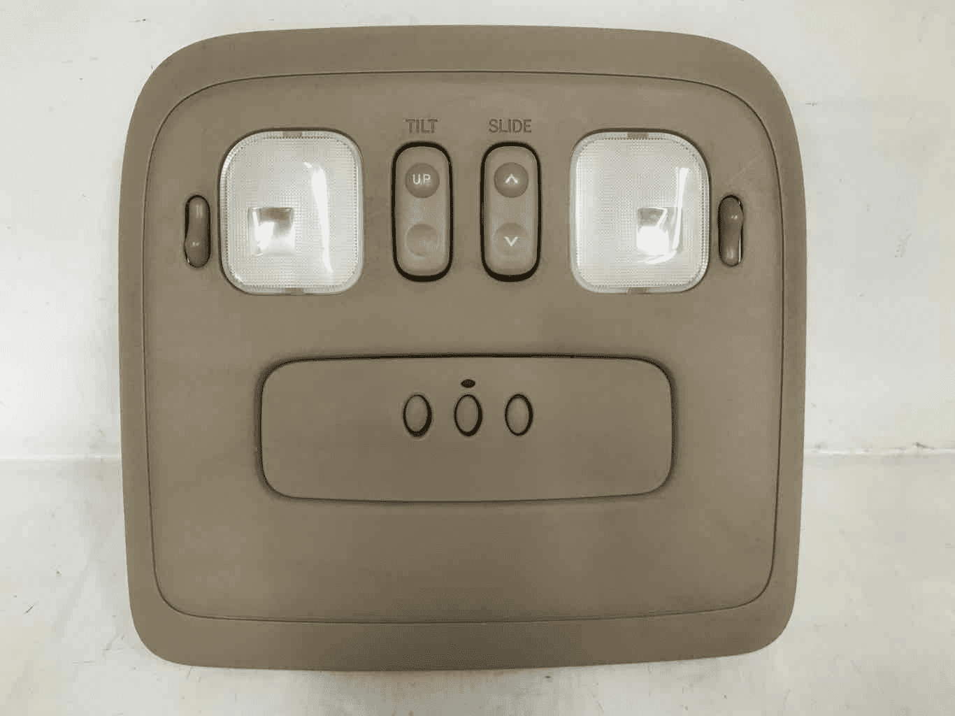

I believe he is saying he has this overhead console (pre 2003 homelink):

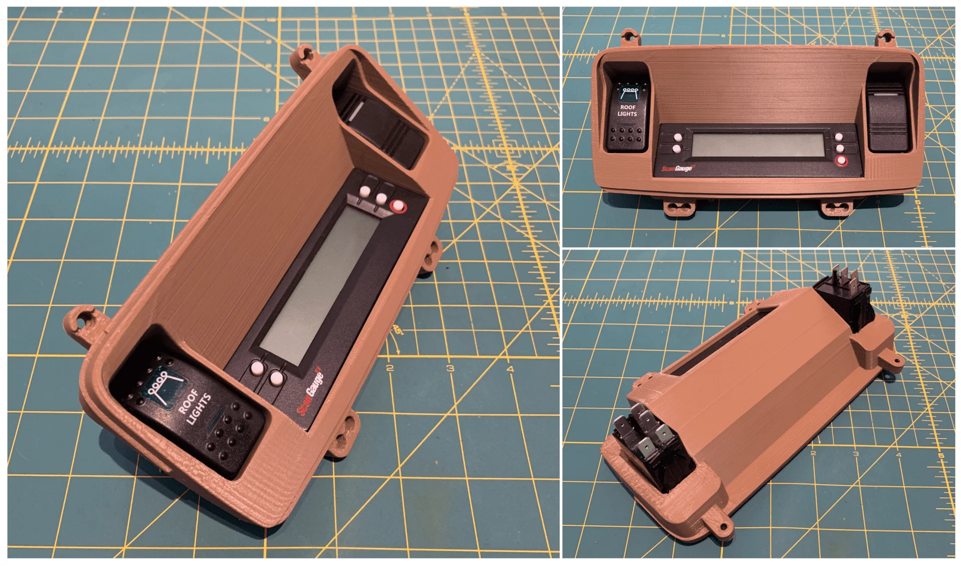

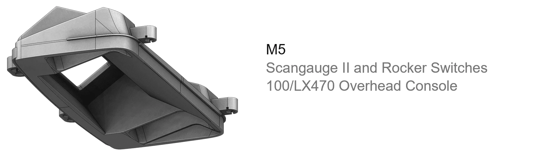

Make 5: Scangauge II and Rock Switches Combo Mount for Toyota Land Cruiser 100 Series

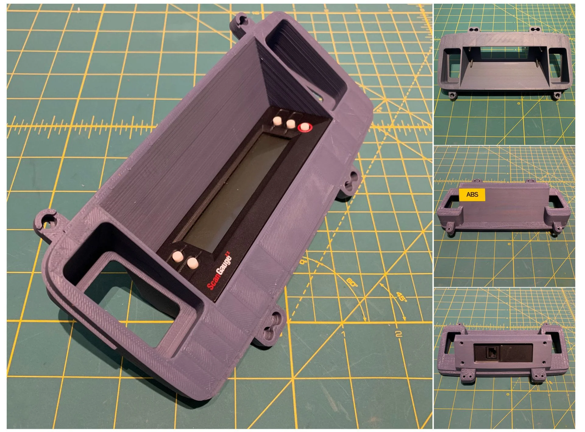

5.1 Overview of the Final Product
5.2 Introduction

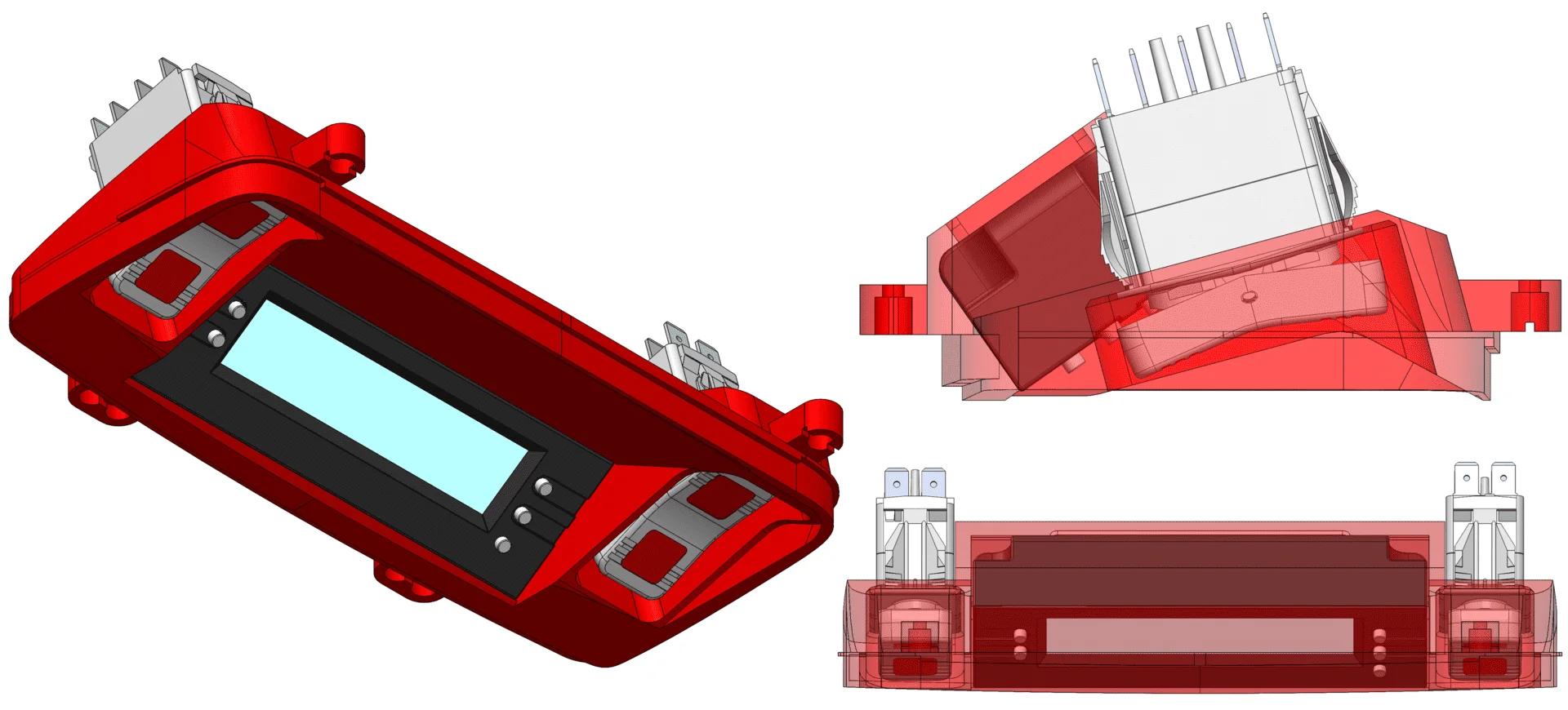

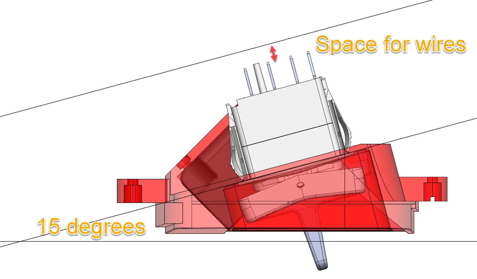

The combo mount is modeled based on members' requests. Two pockets for rocker switches are added. The rocker switches are fully recessed to protect it from accidental activation.

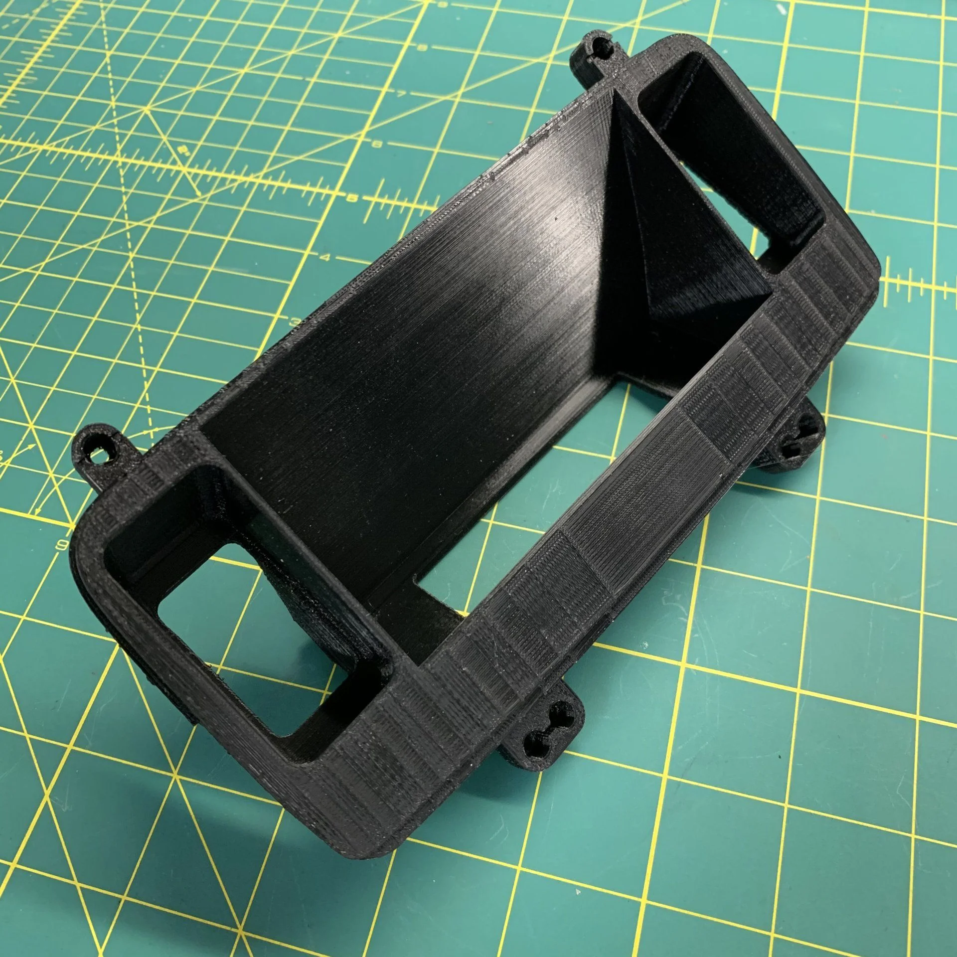

5.3 Design and Fabrication
The rocker switches are tilted by 15 degrees for better visibility of the stickers. Space is added behind the blades for wire connections.
5.4 Purchase List to Complete the Installation
To complete the installation, the following items will be needed.
Ethernet Cable Extender Adapter
Ethernet Extension Cable (Up Angle)
For a smooth finish, you will need:
3M Bondo 801 Professional Glazing and Spot Putty, 3.0 oz.
Note: Dry sand only. The printing material will warp if exposed to excessive water.
Paint
5.5 Purchase Link
$75 + Shipping (USPS Priority). PM for Direct Paypal Payment.
Can print in Grey, Tan, or Black.

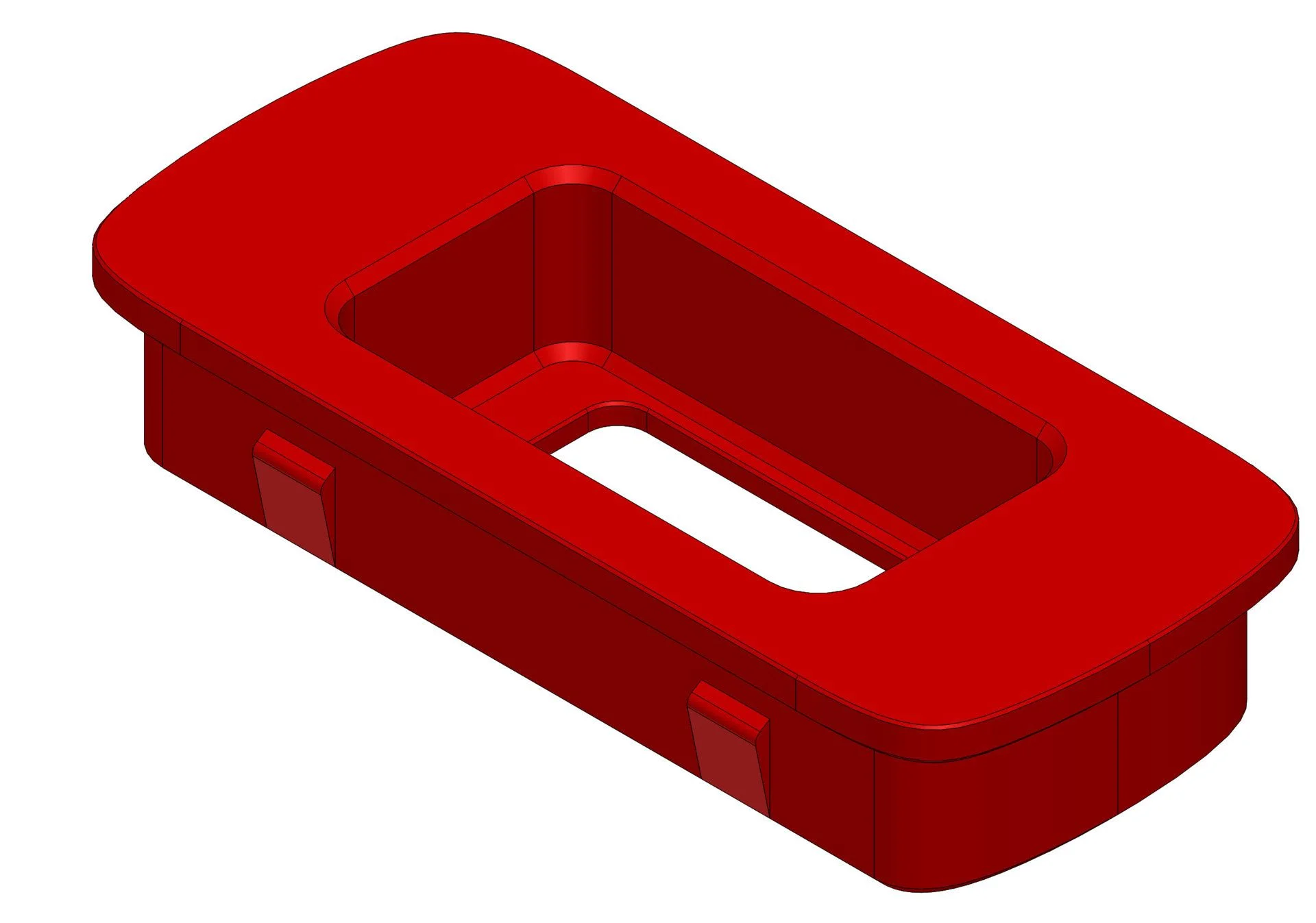

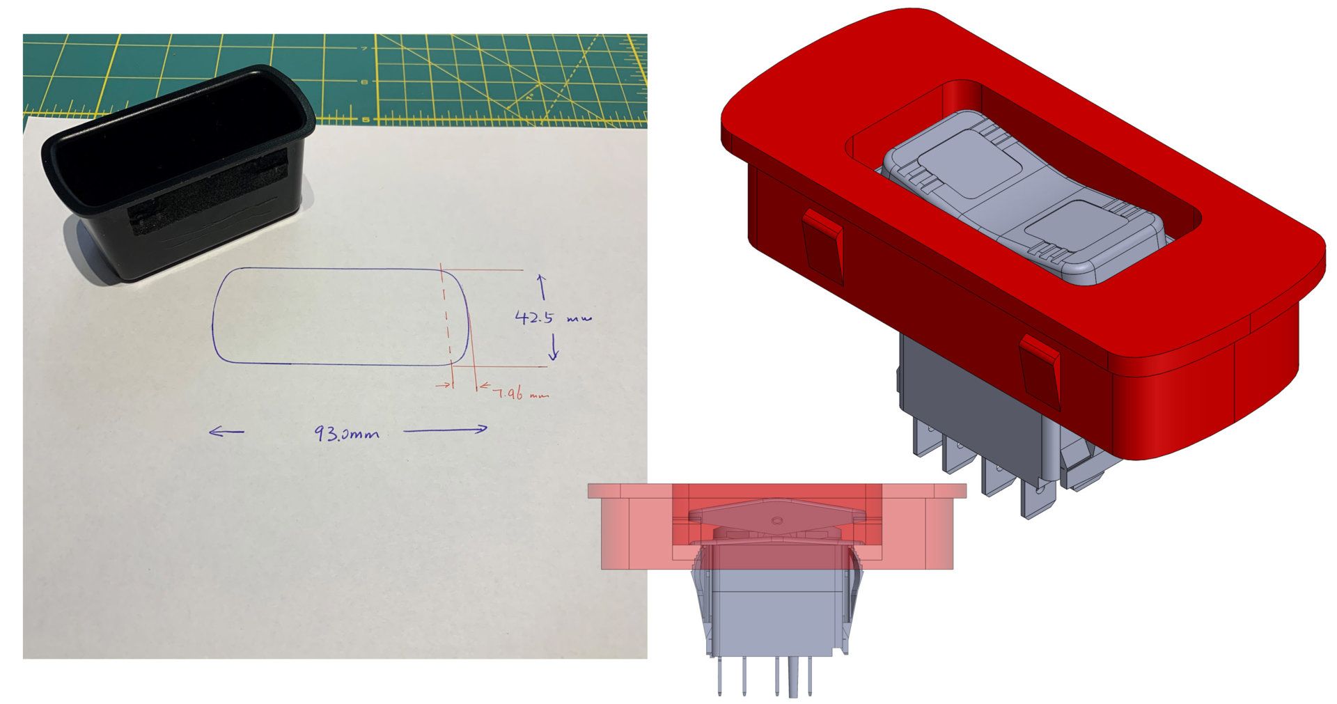

Working on one of the requests - rocker switch mount at the center console pocket.
There is space for only one rocker switch.
Or a USB charger in the form of a rocker switch.
USB charger from Blue Sea:
USB charger from Carling (Note: This is not in the form of the standard rocker switch.)
USB charger from Blue Sea(Note: Standard.)
