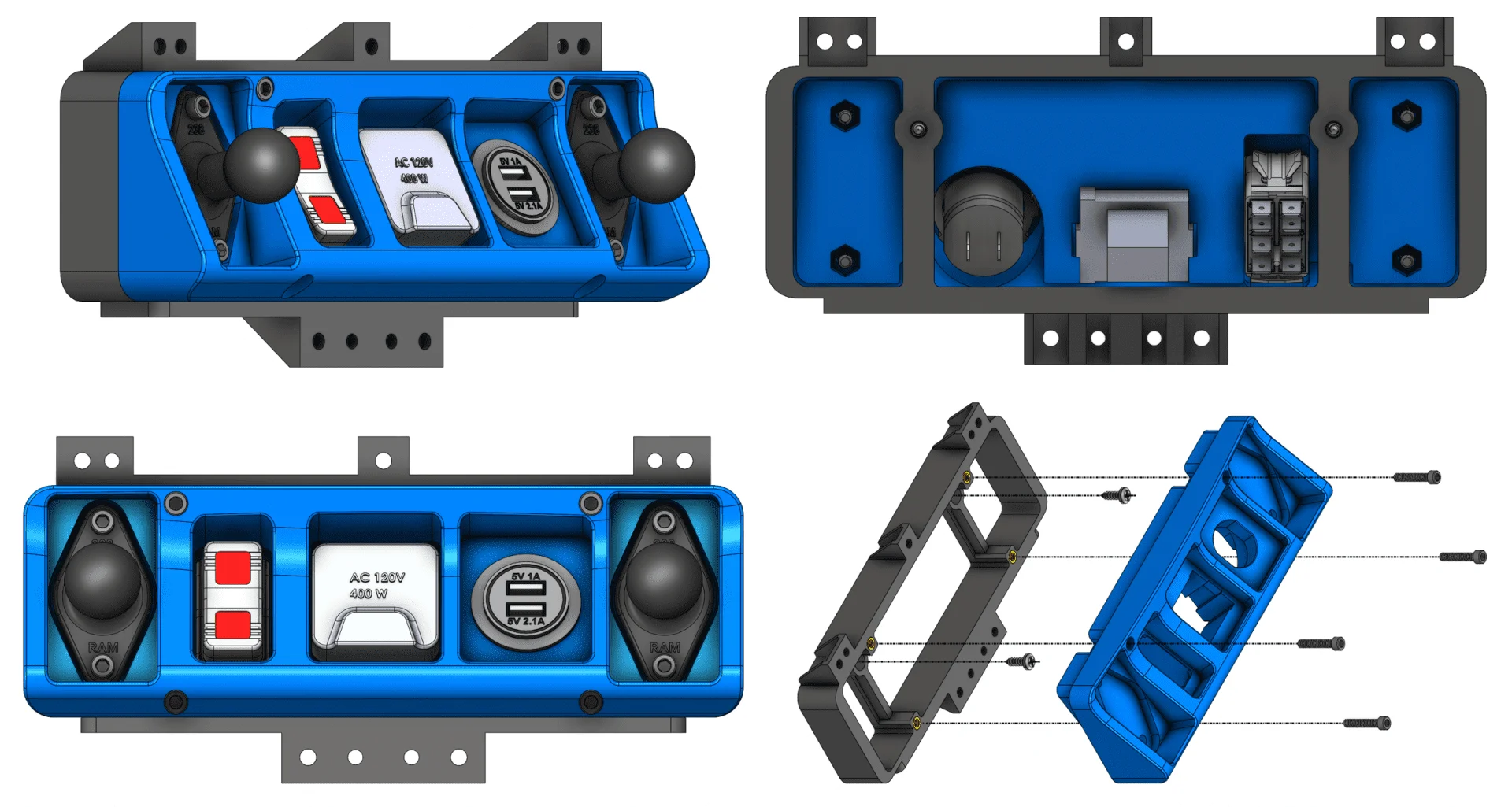

M29 is to delete the second-row drawer/cupholders and set up a power distribution hub.
The bracket connects the factory panel to the rigid factory mounting points, providing a solid base for the faceplate.
The faceplate is customizable on CAD level to fit various devices.
V1-V5:
A potential use of RAM ball mount:
RAM Diamond Ball Base:
120V Outlet
12V Socket

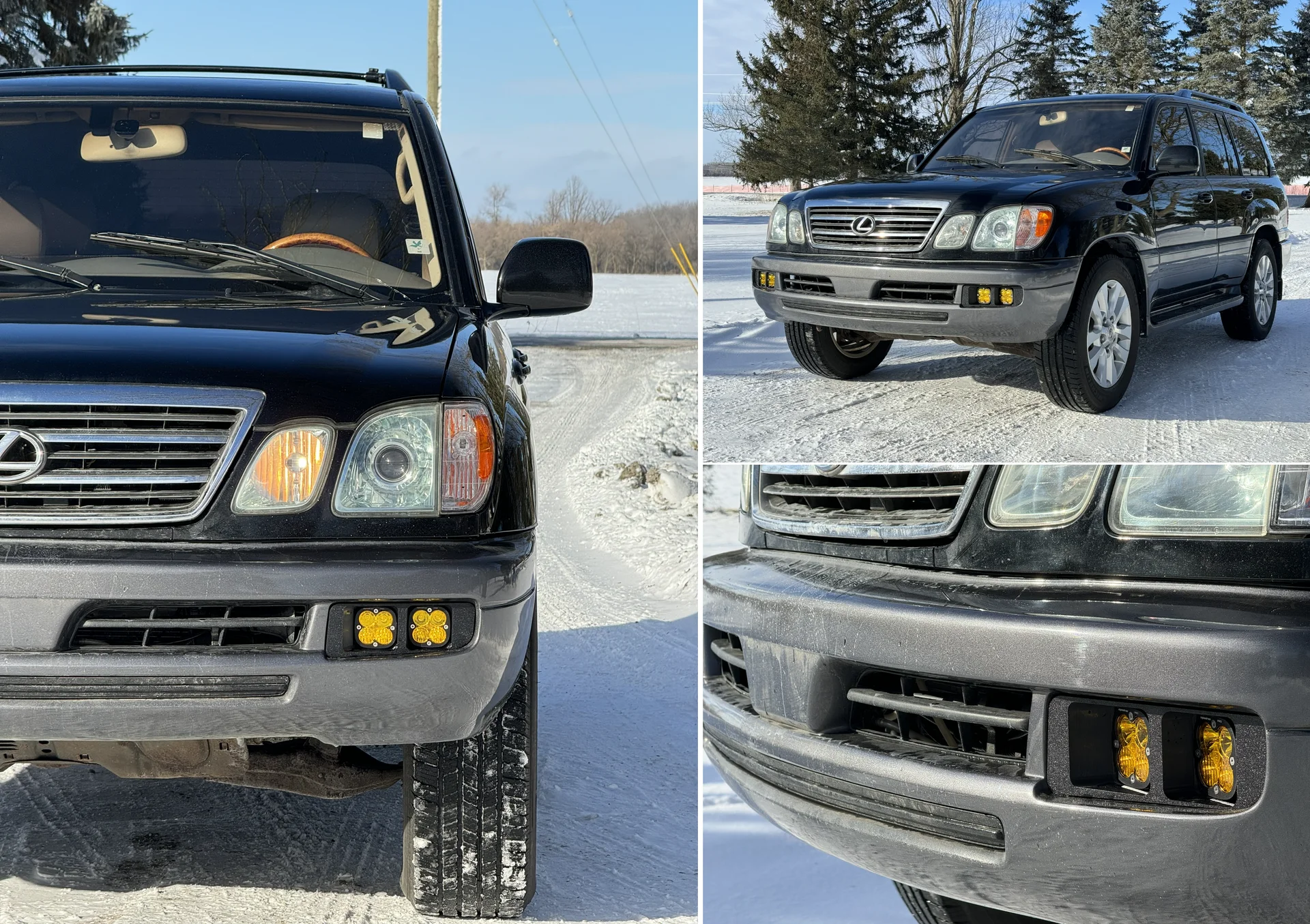

Video (with Baja Designs Squadron Pro):
63.2 Description
The mount is designed to accommodate two Baja Designs Squadron LED pods (Pro, Sport, or SAE variants) on each side. It is suggested to use the Squadron SAE model, as it is specifically engineered to function as a fog light.

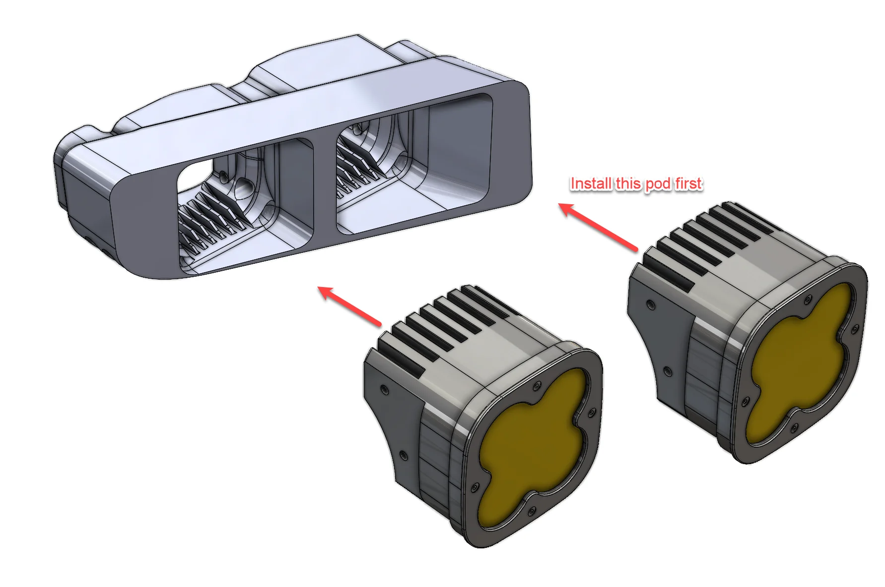

This issue arises because the Squadron SAE was designed using entirely new aspheric projector optics. Thankfully, I managed to redesign the mount to install the pods in the correct orientation:
In the figure referenced above, the mount is designed for the passenger side. The pod that is closer to the center of the vehicle should be installed first, followed by the pod on the outer side.
