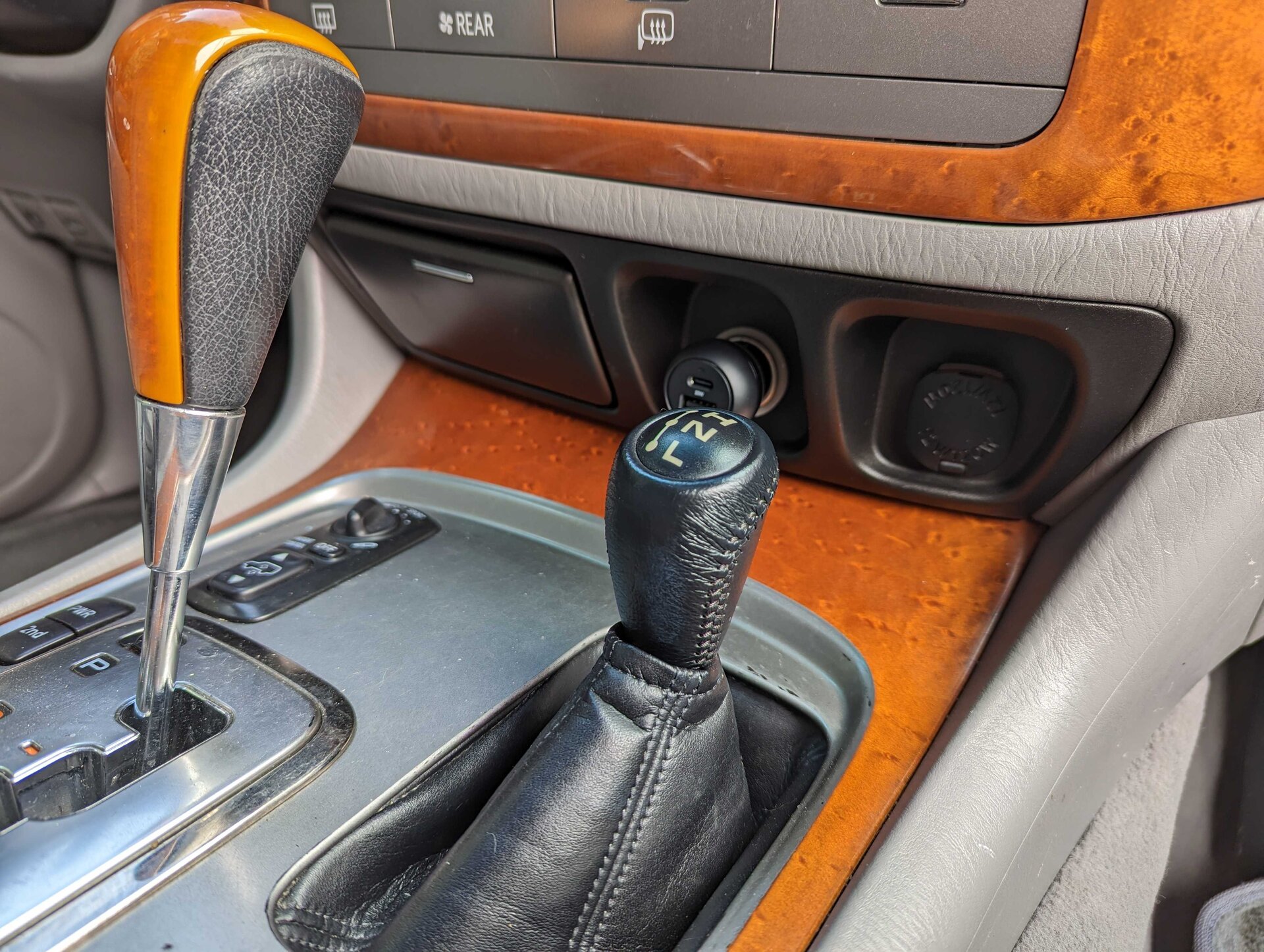

One thing I haven't yet seen a solution to... replacing the in-dash ashtray / 12v ports with something that keeps the ports but swaps the ashtray for a larger open storage cubby. I know somebody proposed just felt lining the socket but that leaves a good bit of wasted space in front and on sides. I'm personally not in need of switches or mounts like some of you guys, just more storage options for my 07 LX470. Anybody else interested in this? Or is there something out there I missed?

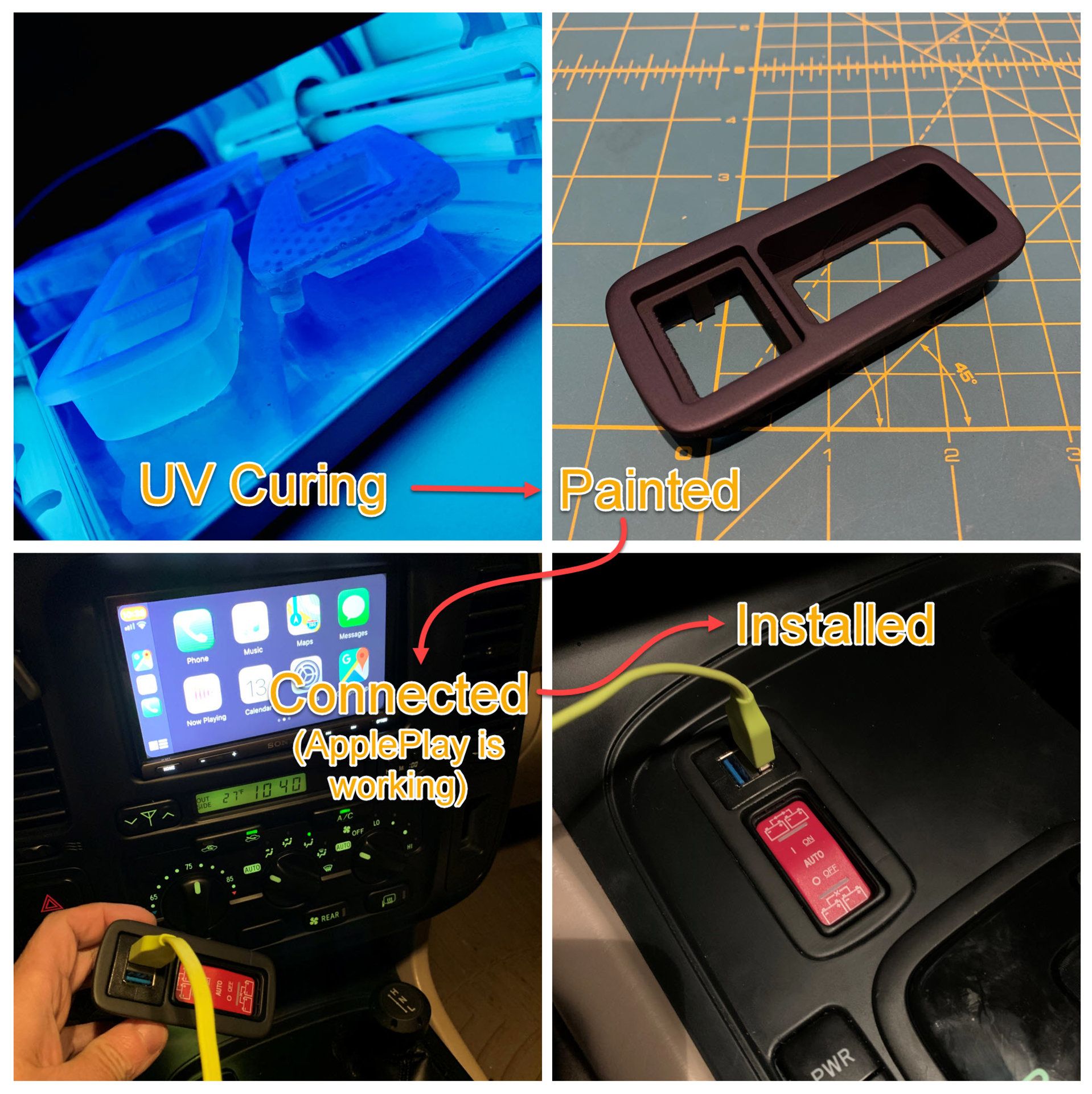

Make 6: Change Pocket Mount
6.1 Overview of the Final Product
The following prototype is printed with resin.
6.2 Introduction
The change pocket mount is modeled based on one of the requests. Variable mounting schemes have been developed.

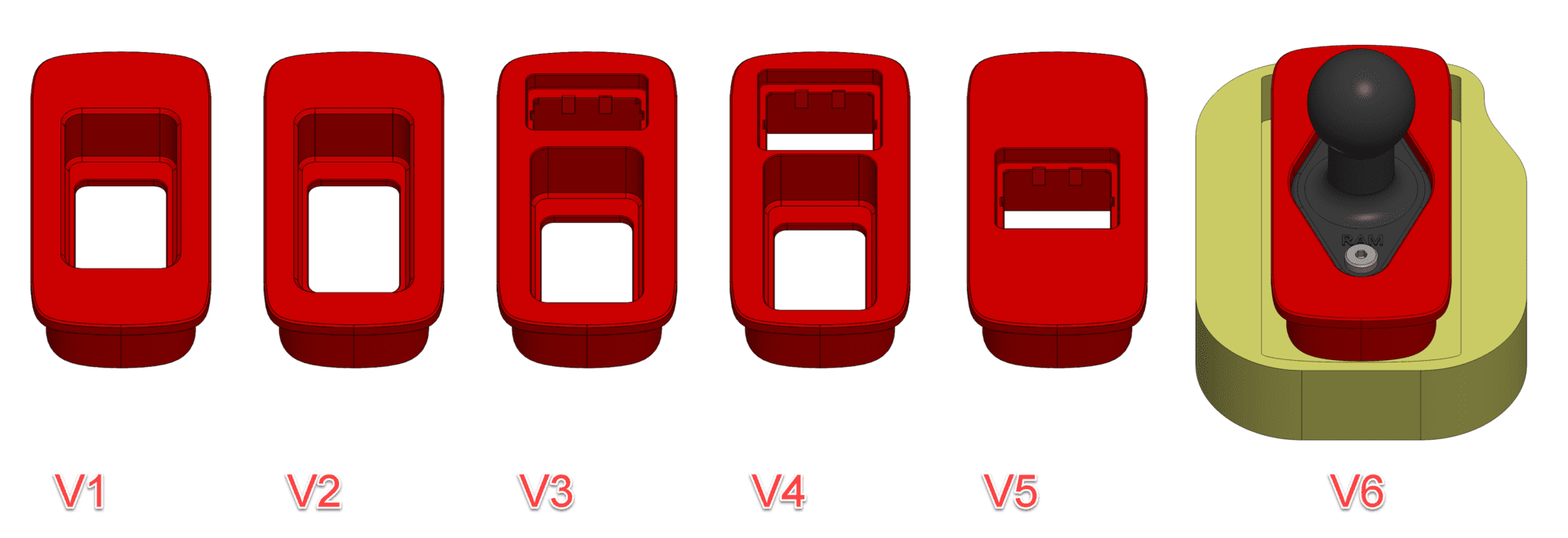

Available versions:
V1: Mounts one rocker switch.
V2: Mounts one Blue Sea Dual USB Port.
V3: Mounts one rocker switch and one square single USB extension port.
V4: Mounts one rocker switch and one square dual USB extension port.
V5: Mounts one square dual USB extension port.
V6: Mounts one RAM diamond ball base.
Note: V2 can also mount a rocker switch.
6.3 Design and Fabrication
6.4 Purchase List to Complete the Installation
Square Single USB Extension Port
Square Dual USB Extension Port
6.5 Purchase Link
PM for Direct Paypal Payment
Price:
$30 + $8.3 (USPS Priority) for ABS printed (V6 is $40 + $8.3).
Resin printed version is not available.
