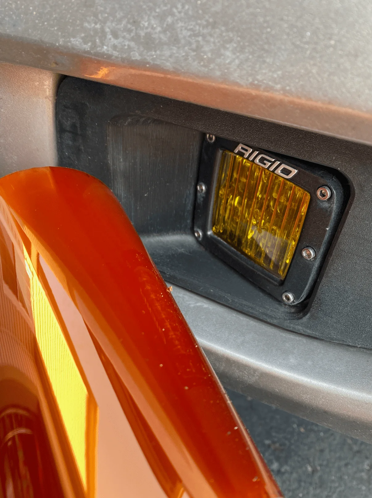

Masked my foglights with Kapton polyimide tape. Now I have amber foglights haha!

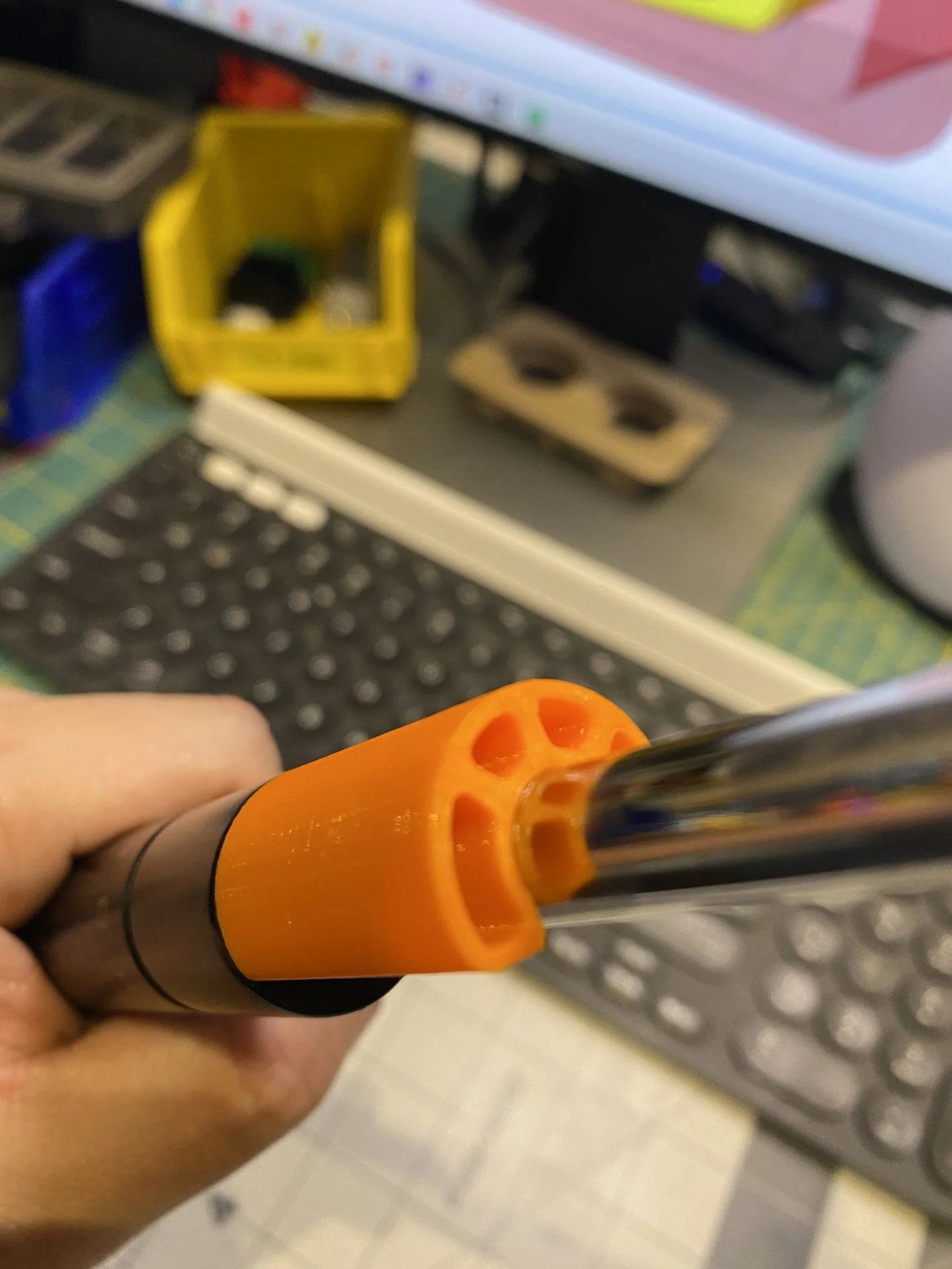

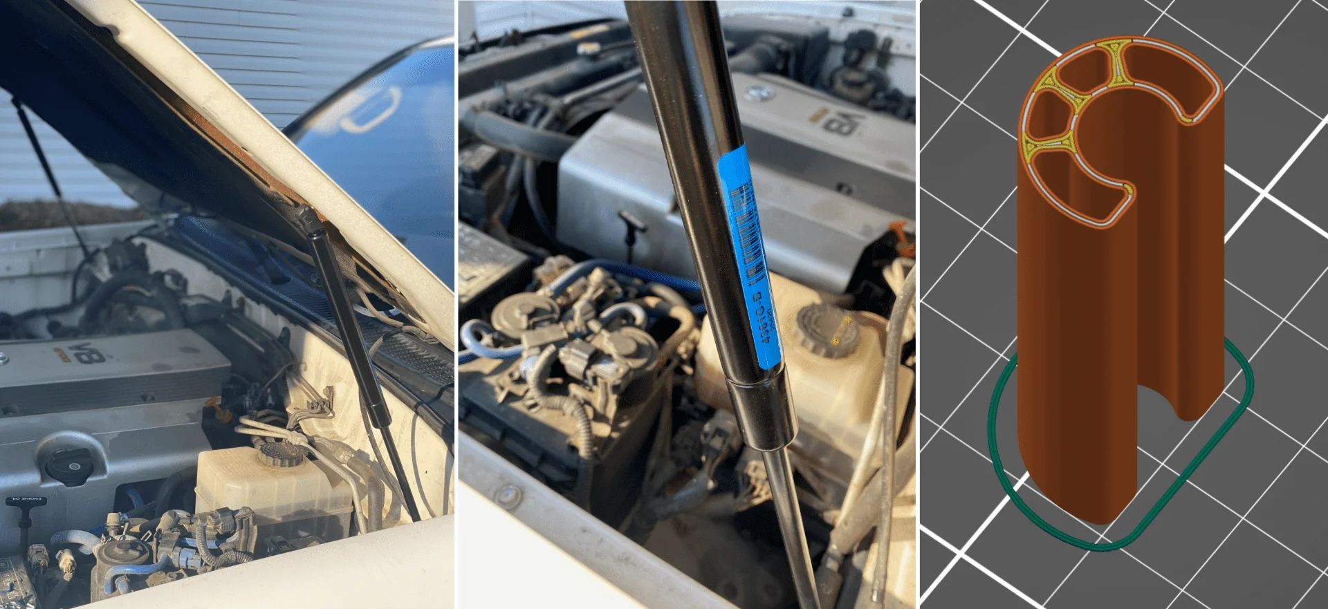

What does the safety holder do?
The safety holder is an open tube that can clips on the rod and longer than what is shown in the pic. It sits against the top and bottom of the rod. When the work is done, remove the holder and close the hood.
I see. We usually did it the old school way with vice grips on the hood shocks when they start failing. Will this tool become an item you sell?
This is a safety product. I have been staying away from selling this kind of product, which would cause damage if not functions or being used properly. Anyway, I will do some tests and see how tough it is.
