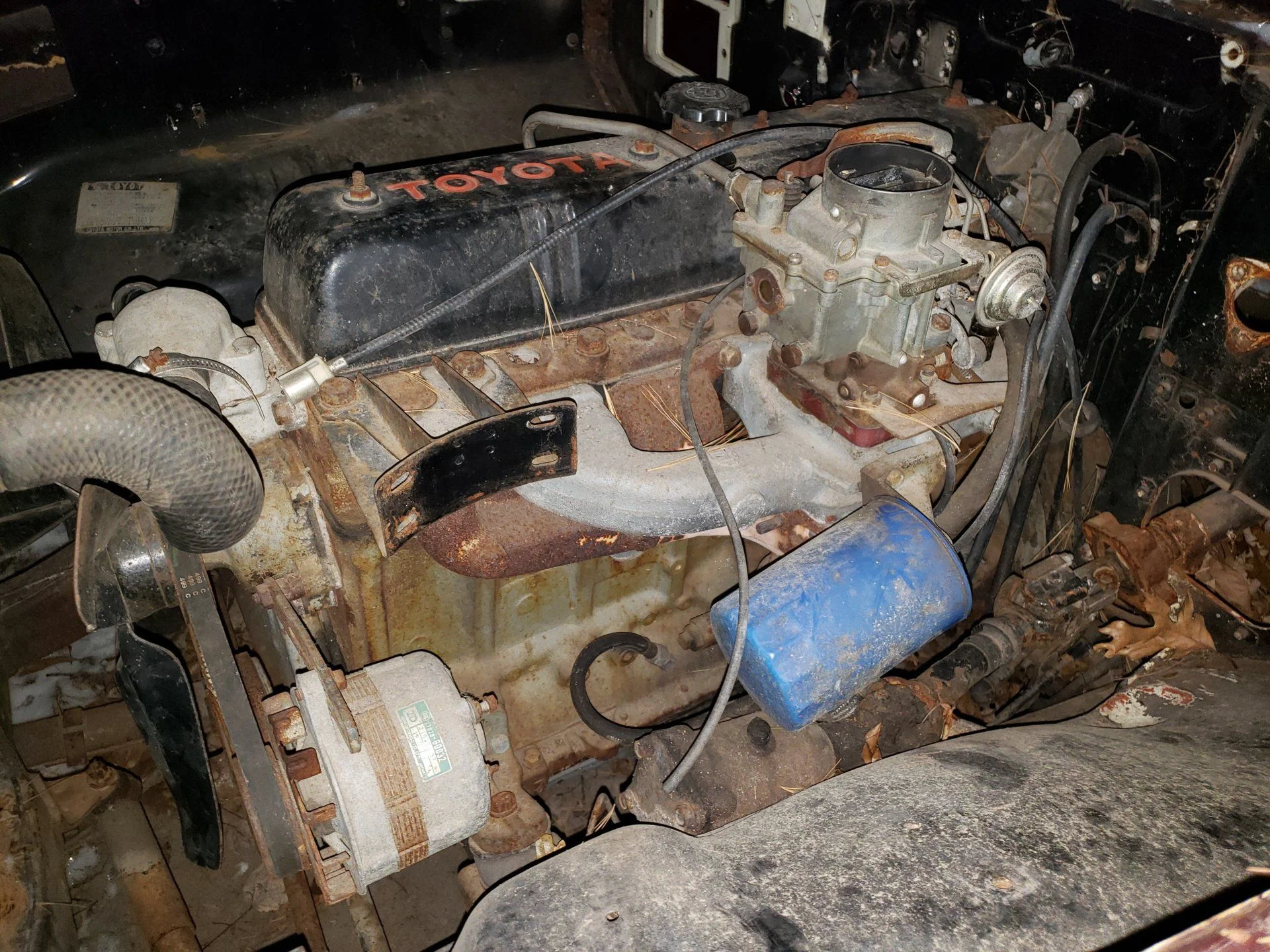

Well, she went away for the winter :(. I have too many other cruiser projects ahead of it. Good news is that my '70 parts 55 has what appears to be a rebuilt engine in it that would slide in the 45 just great. The PO said it was rebuilt (according to the PPO) but he bought it as a basket case too so just talk really. Looking close it really looks promising, giving signs it has been worked over, just sitting for a long time. I'll try to make time for a closer look this winter.

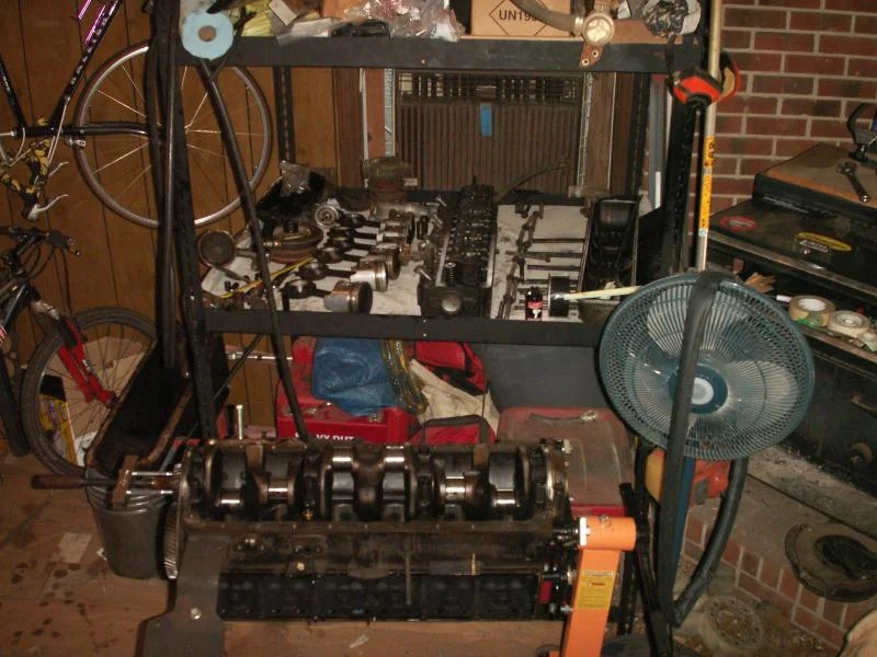

Ok cool. Was just hoping not a false hope for you or PO myth. This is a not so great account of the build that doesnt even cover the final result of up and running well but has some info and pics. I blame the 45 :D

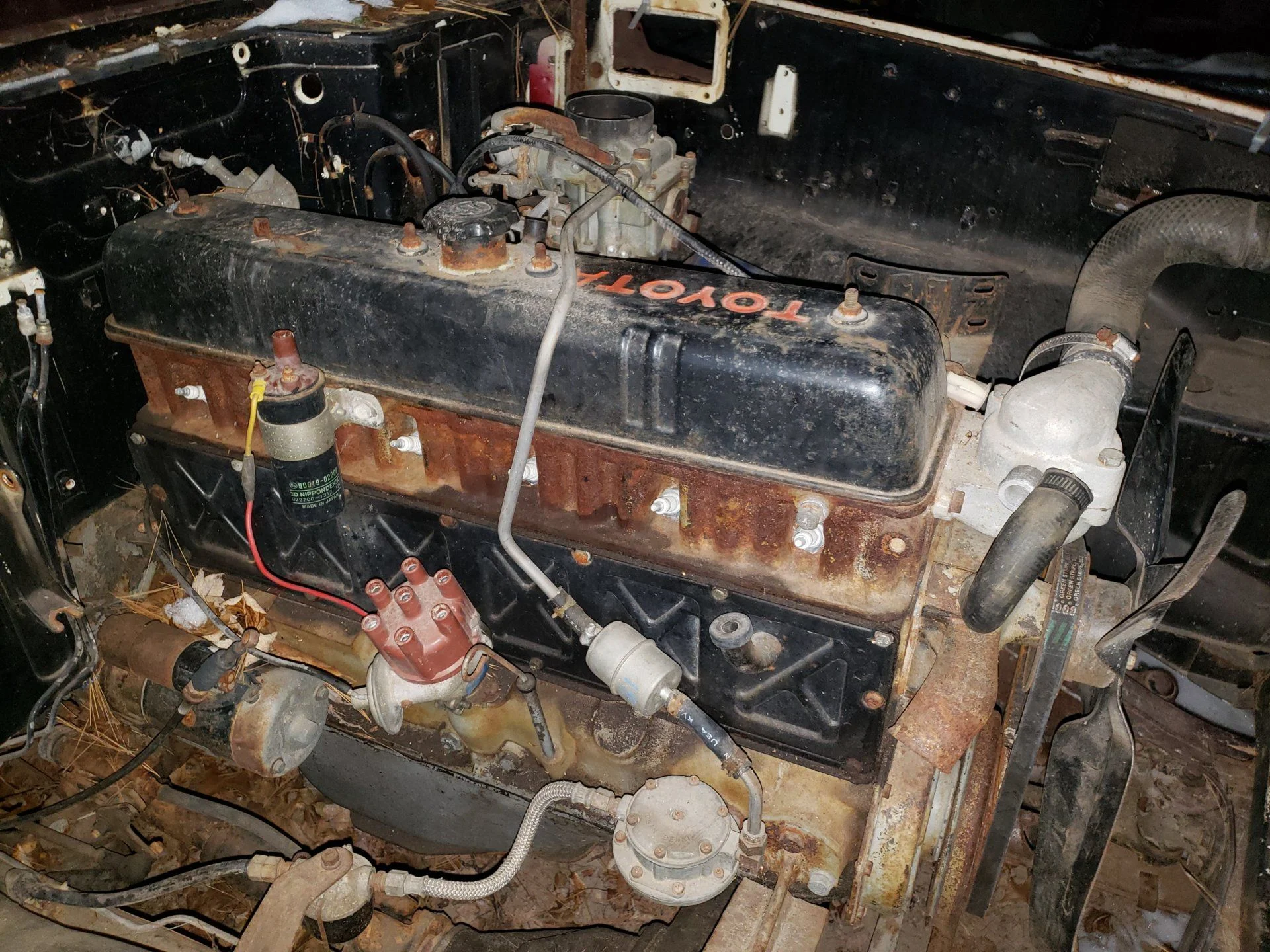

The plan is to use the good F motor I have from my 1970 parts pig. It is said to be rebuilt and seems to be the case. I got it running briefly in the parts truck and it sounded perfect. Scoping down the cylinders looks really good too.

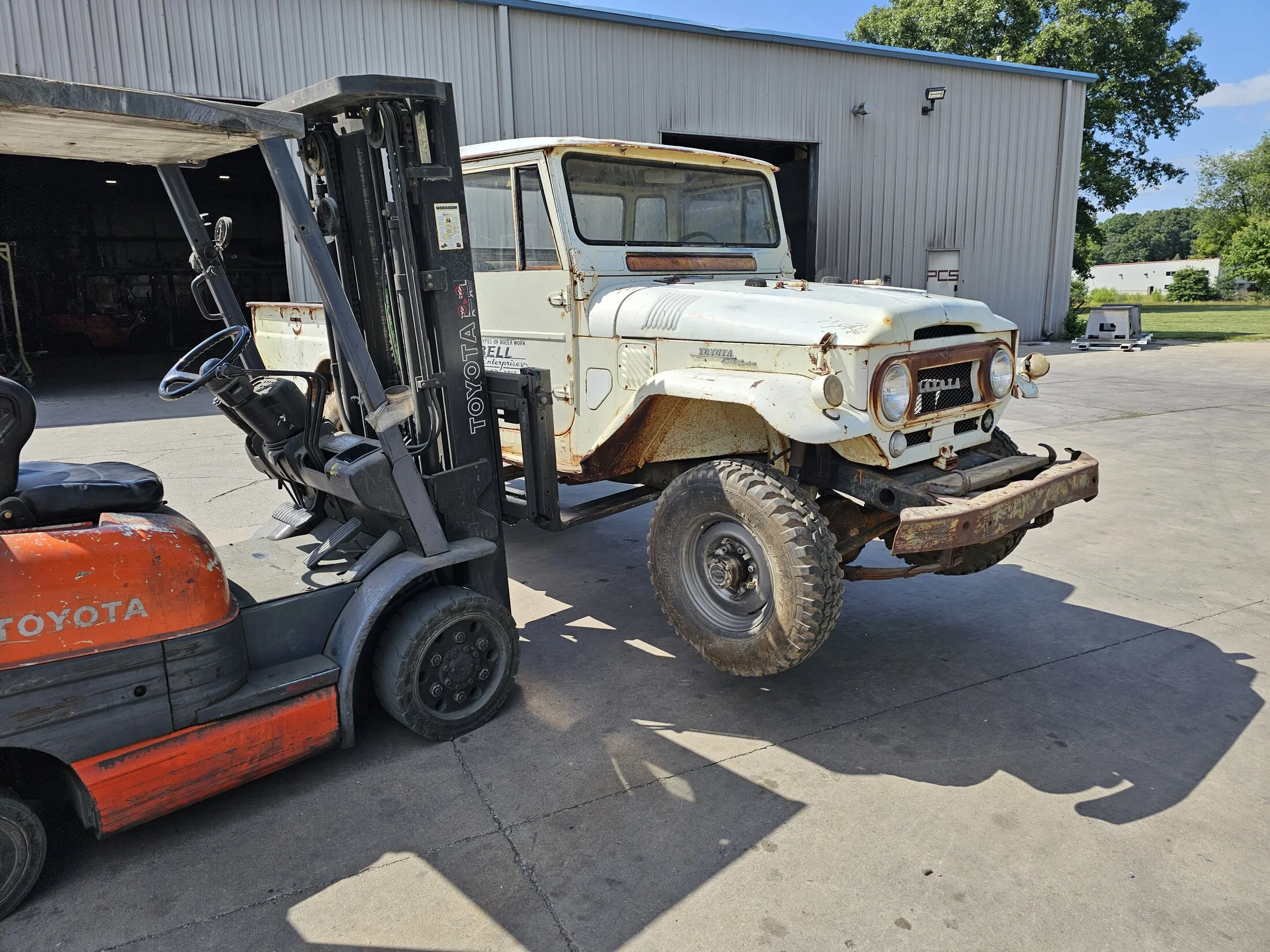

Gotta pick up a Toyota with a Toyota, right?

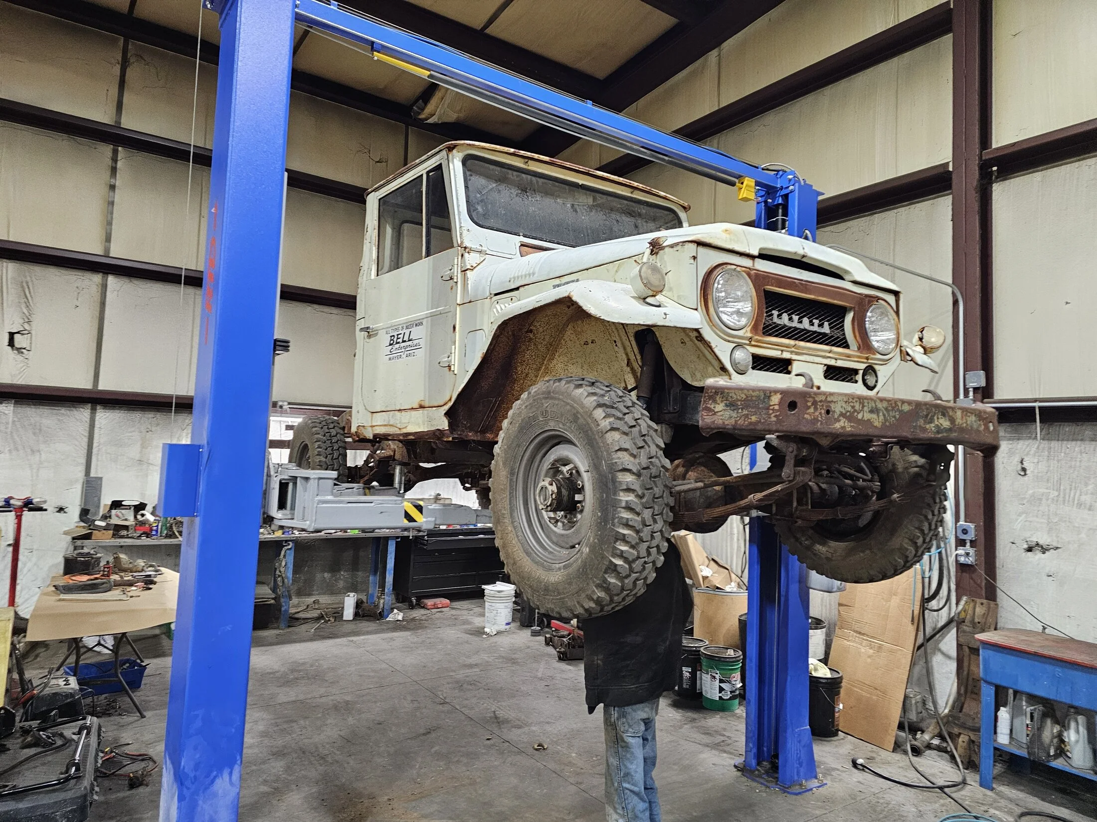

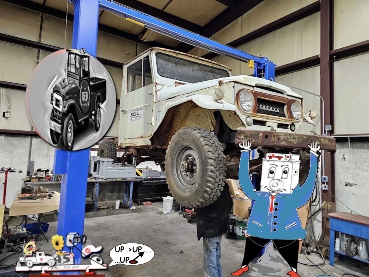

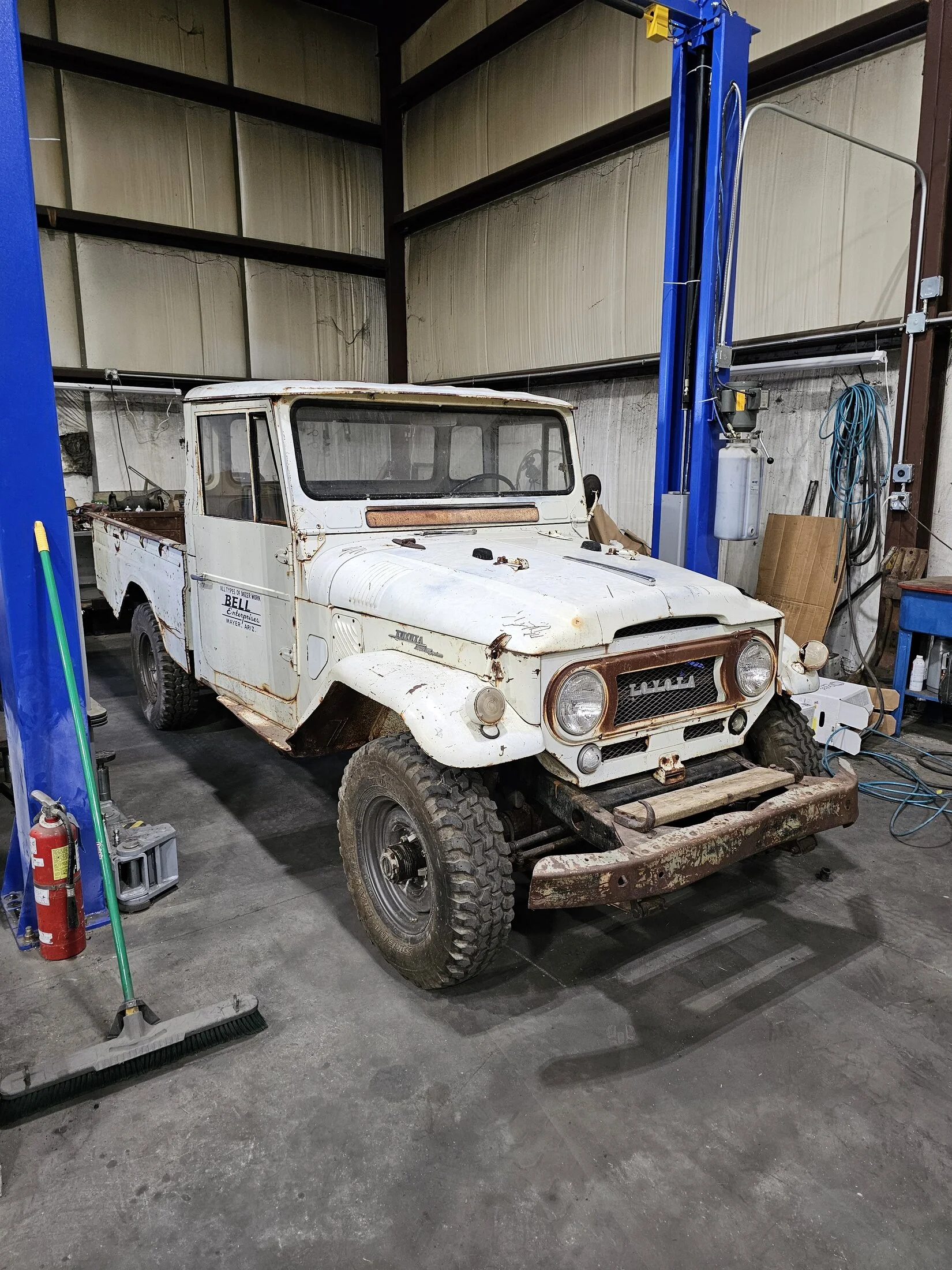

Got it in the hoist bay last night.
Box off and in the air this morning.

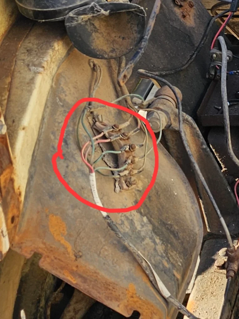

Does anyone make the strips that mount on the inner fenders where the wiring joins together? I can grab a Pic tomorrow
Found a picture
These things. Thanks!
Also, are there any body and box mounts available?
Still available from Toyota.

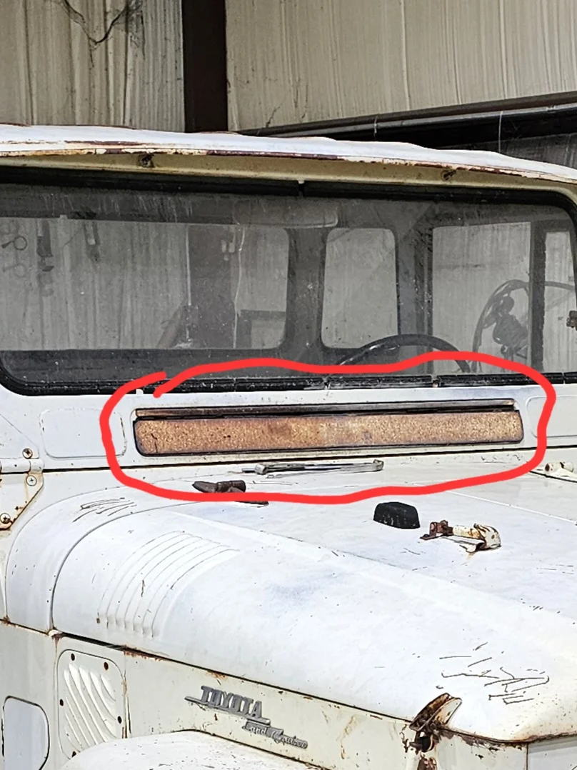

OK, here is one for those in the know- the seal for the windshield frame vent that is basically the hinge for it. I thought City Racer had them but not seeing it.
