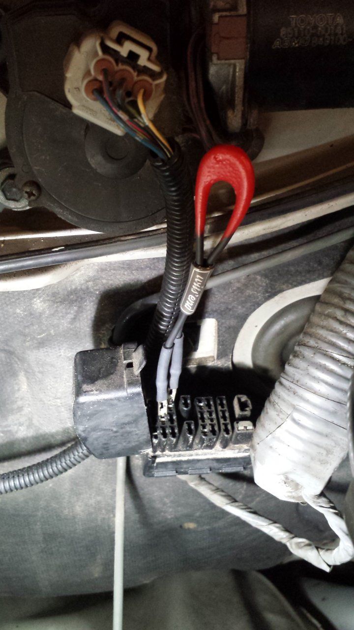

View attachment 1095516 FINALLY back on the road!! I had to take the intercooler off three times to work on items under it but she is now running, I'm cautiously optimistic so far. Timing it was nice with my new diagnostic port jumper (shameless "like" fishing).View attachment 1095506
Hell to the yeah! :cheers:
Glorified paper clip. Genius idea whoever came up with that :grinpimp:
So are you saying...it doesn't totally suck? :hhmm:
Looking good! Did you set the timing to stock?
I did. 3 degrees. As soon as I get the chance, the water/ methanol injection system goes on as well as a 3" pulley. I'll go for more timing then

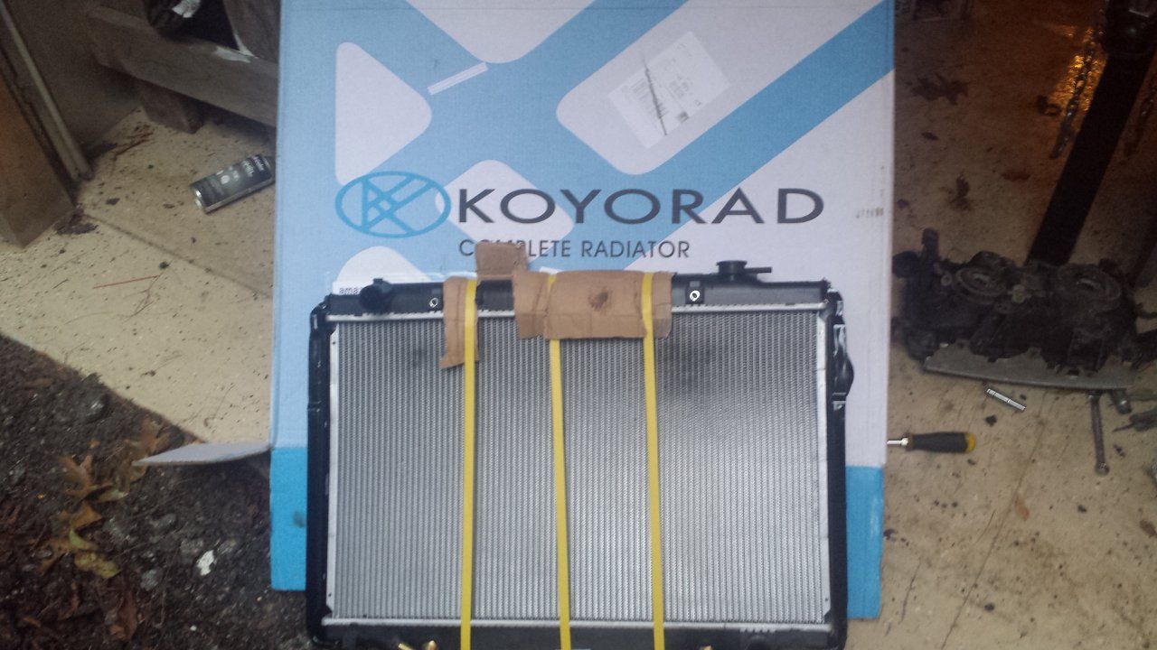

I wish that was the end of the story, but I'm not that wise. I didn't test drive and the next morning I was hustling my daughter to golf practice. Took off and I could hear the fan hitting the shroud. No biggie, jump in the truck, fix later. So later, I can't get it to make a sound idling, only accellerating. I pushed on the shroud some while it was idling and bam, blew the bottom of the shroud through the radiator, genius! Found out too late the shroud wasn't engaged in the lower clips. Silver lining is the radiator didn't look so hot anyway, it was an all brass replacement that looked a bit corroded. Off to Amazon for a new Koyo.
