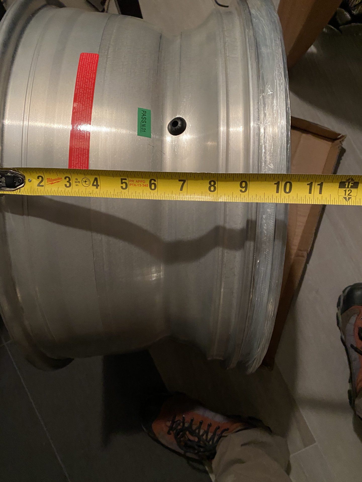

I am running a set of Battle Born beadlocks 17x9 bootleggers 3.5" back space.
These wheels are stamped 17x9 on the back but if you mount them as a bead lock they are 17x 10.
This is my first set of beadlocks, are all beadlock this way and one inch for the beadlock.
When I talked to Battle Born I was told that you can mount the tire with out the lock ring and that where the 9" wheel is measured.
I'm running them as beadlocks and if you go by where the tire is mounted it a 10" wide wheel.
This is giving the tire side wall a flat profile ( no tire bulge to help protect the wheel)
The lock ring are getting hammered in short order.
If any one has experience with beadlock wheels please chime in.
I really wanted 8" wheels but thought 9s would be all right. now I have 10s with a 3.5 backspacing and my Reg is 6" wider now.:mad::mad:

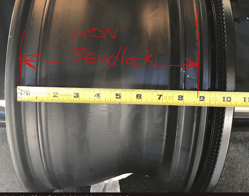

No expert here but have a soon to be mounted set of Racelines sitting on my floor. Looks to me BB took a 17x9 and modified it to sell as a beadlock wheel. Did they offer it as a 10” or 9”? Seems to me they should be listing it as a 10” so you know what your getting. Who buys bead locks and leaves the ring off?
Racelines offer at 10” and measure the same. No idea if they can mount without but have no intention to do this. If it makes you feel better mine is 4” BS and will stick out more and probably take twice the beating lol. If you want the 9” take the beadlocks off and mount them. Would probably look funny tho.
Racelines offer at 10” and measure the same. No idea if they can mount without but have no intention to do this. If it makes you feel better mine is 4” BS and will stick out more and probably take twice the beating lol. If you want the 9” take the beadlocks off and mount them. Would probably look funny tho.View attachment 2505889
Thank you for posting. I bought them brad new $ as 9" wheels, They are advertised as 9" and stamped as 9".
I want the beadlock that's why I payed the extra cash and I totally agree they need to advertise them as 10" wheels if selling them as beadlocks.

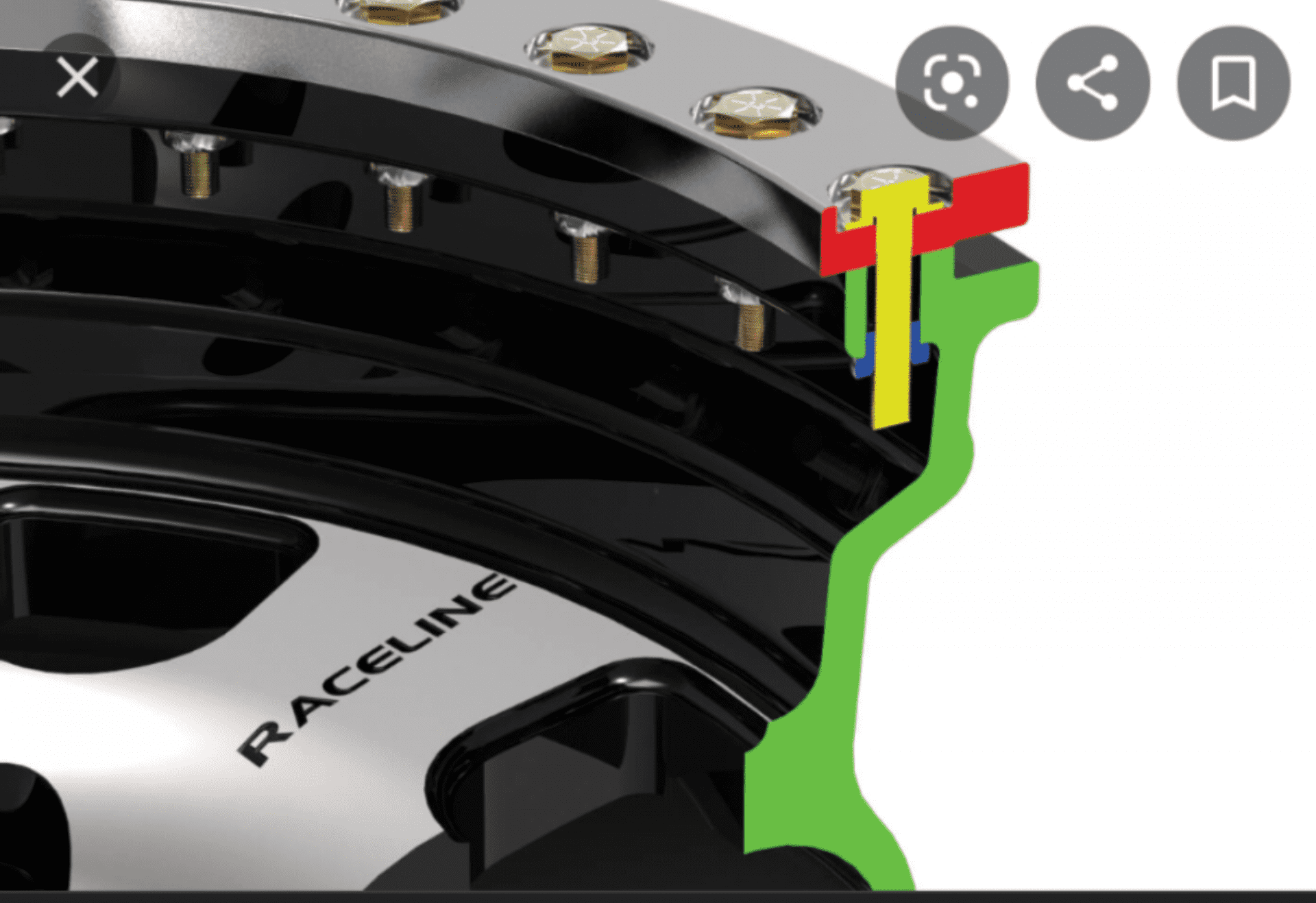

Your Racelines look to be made the same way 9" non beadlock or 10" bead locks .
The wheel in post #7 has the same inner bead.

No, not all beadlocks are manufactured this way. It seems as if Battle Born is doing it the same way as many DIY kits are welded. ...Just weld the mounting ring to the outer surface of the rim.
I run Champion beadlocks and they machine off the original lip before welding the new mounting ring on. There is no option to mount the tire without the bead lock.
