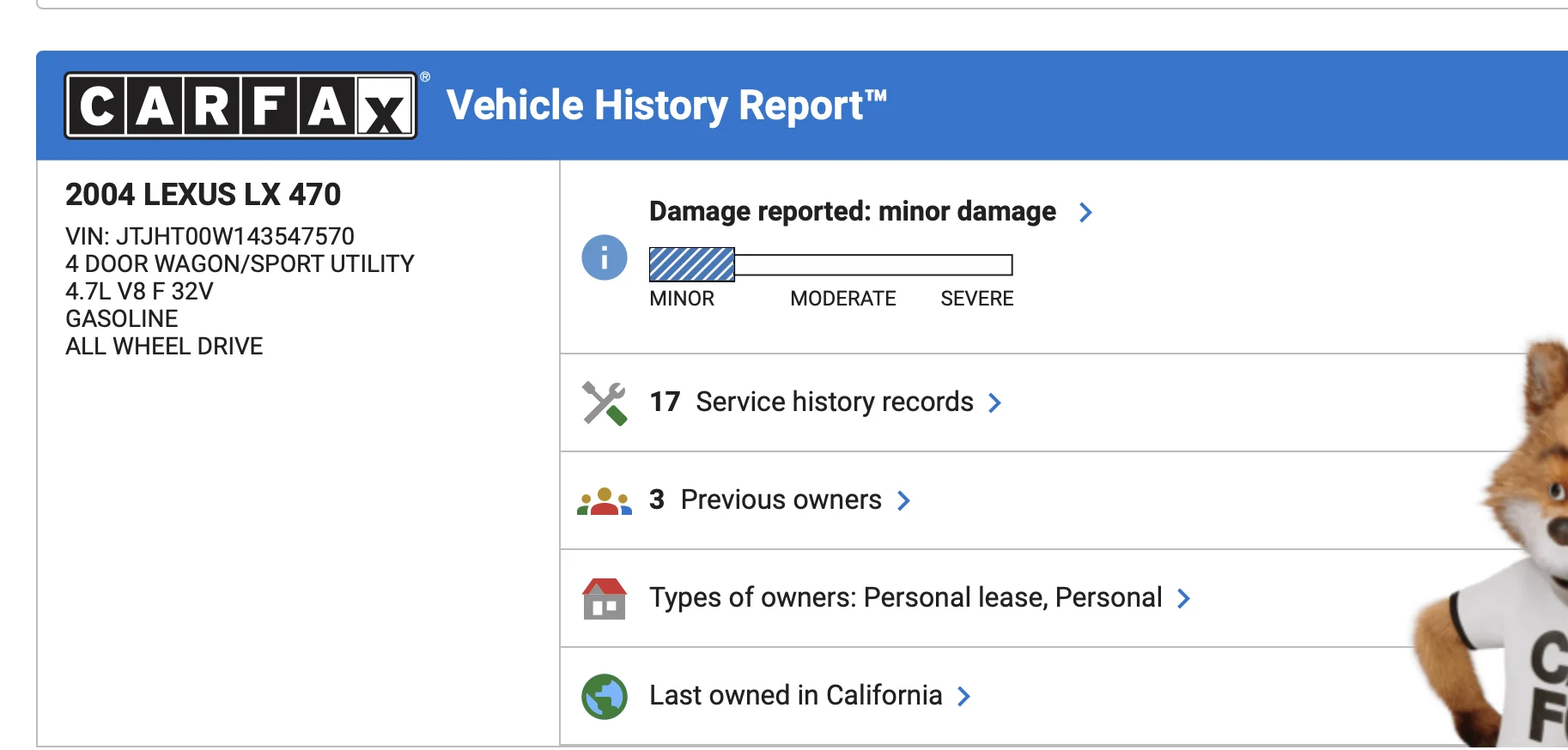

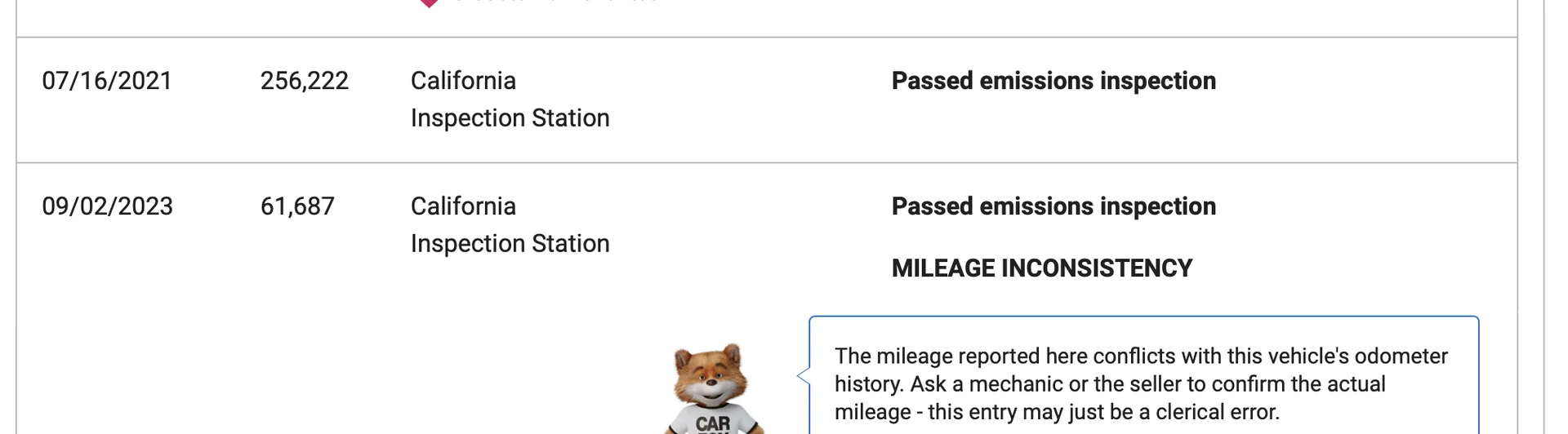

Be forewarned. This is an amazing deal if true but unfortunately, it is not. I saw it in person and it's not a bad rig, but odomoter is rolled back, 3 owners and multiple accidents. Seller claims it has 62k miles on it but really its 260K miles. I also believe the carfax and Lexus of Marin documents may be false. Just warning my fellow Mudders.

Good info. Curious. So you pulled your own Carfax and saw the odometer is rolled back, 3 owners and multiple accidents but the Carfax the seller showed you was different?

You are correct. Printouts provided by seller. As I didn't buy it on Tuesday, seller didn't give me the documents (as he had other buyers lined up this week). That was one of the things that also triggered my spider sense to run one myself. vin should be in the attachment

Radiator looks like it has more than 62K miles, they only turn brown like that after 200K. Look at the valve cover gasket and the trans underneath, at 260K it would start to seep or get wet a little. Not at 62, sometimes it could be a clerical error for the mileage but you need someone who knows these trucks well to inspect it.
