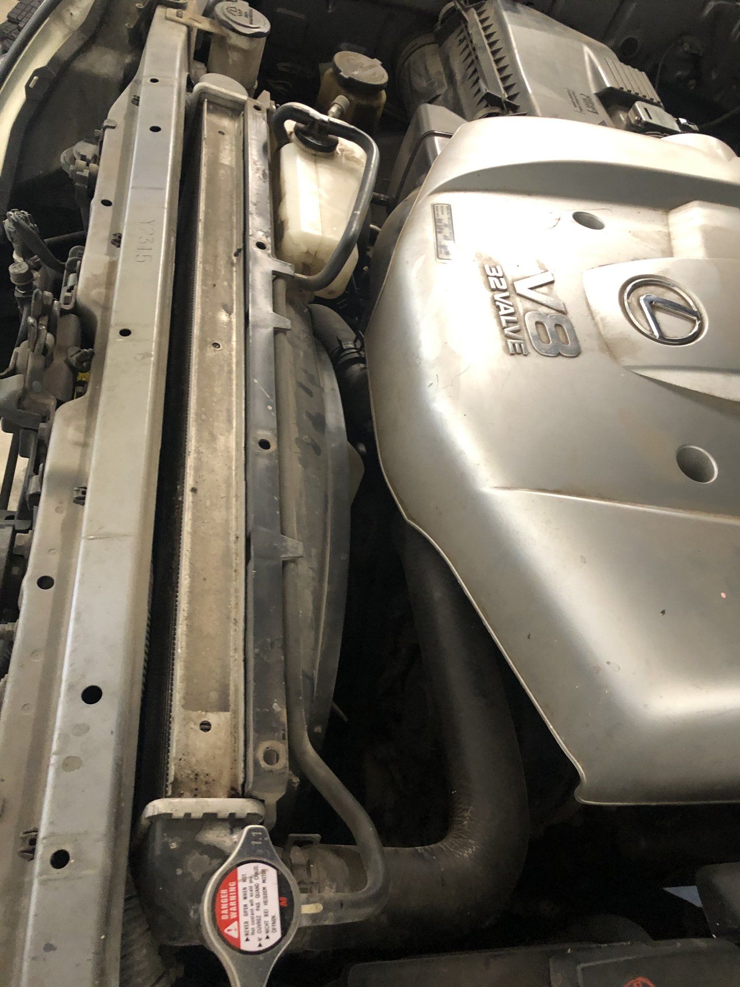

Radiator has a leak. Drove a huge road trip with it, and it held fine, but Its one of those things I don't want to sleep on.
Looking at replacement options:

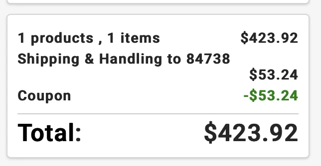

Local radiator guy quoting me $268 for a presumably aftermarket rad.
I found an OEM for a seemingly decent price: $423
Anyone ever tackle replacement rad before? Thinking OEM will be better long term and worth the extra ~$200.

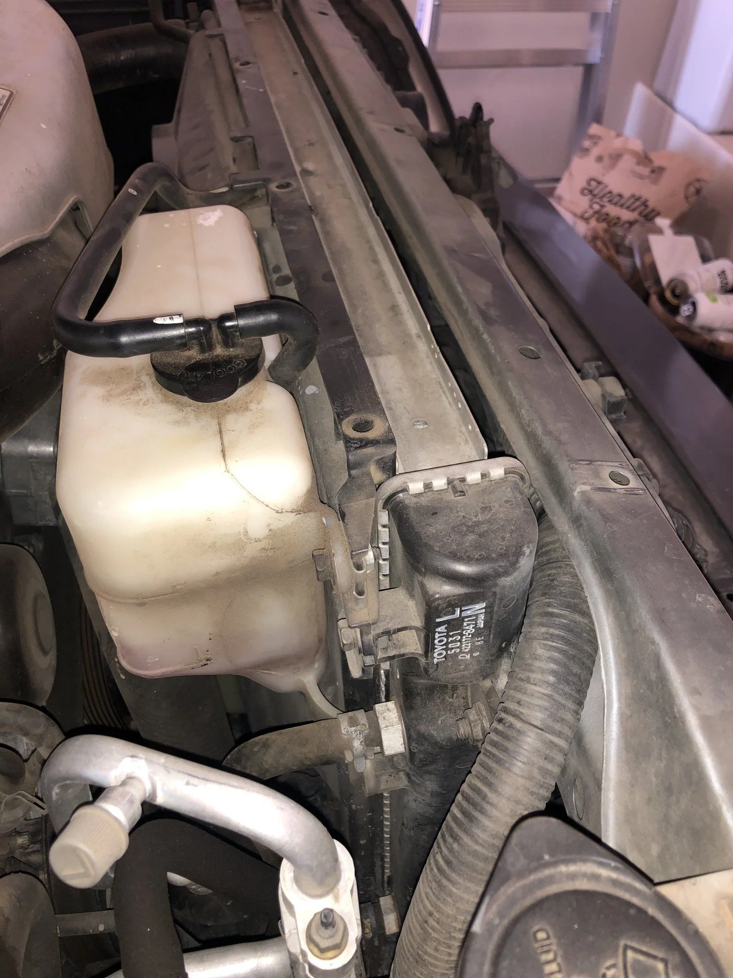

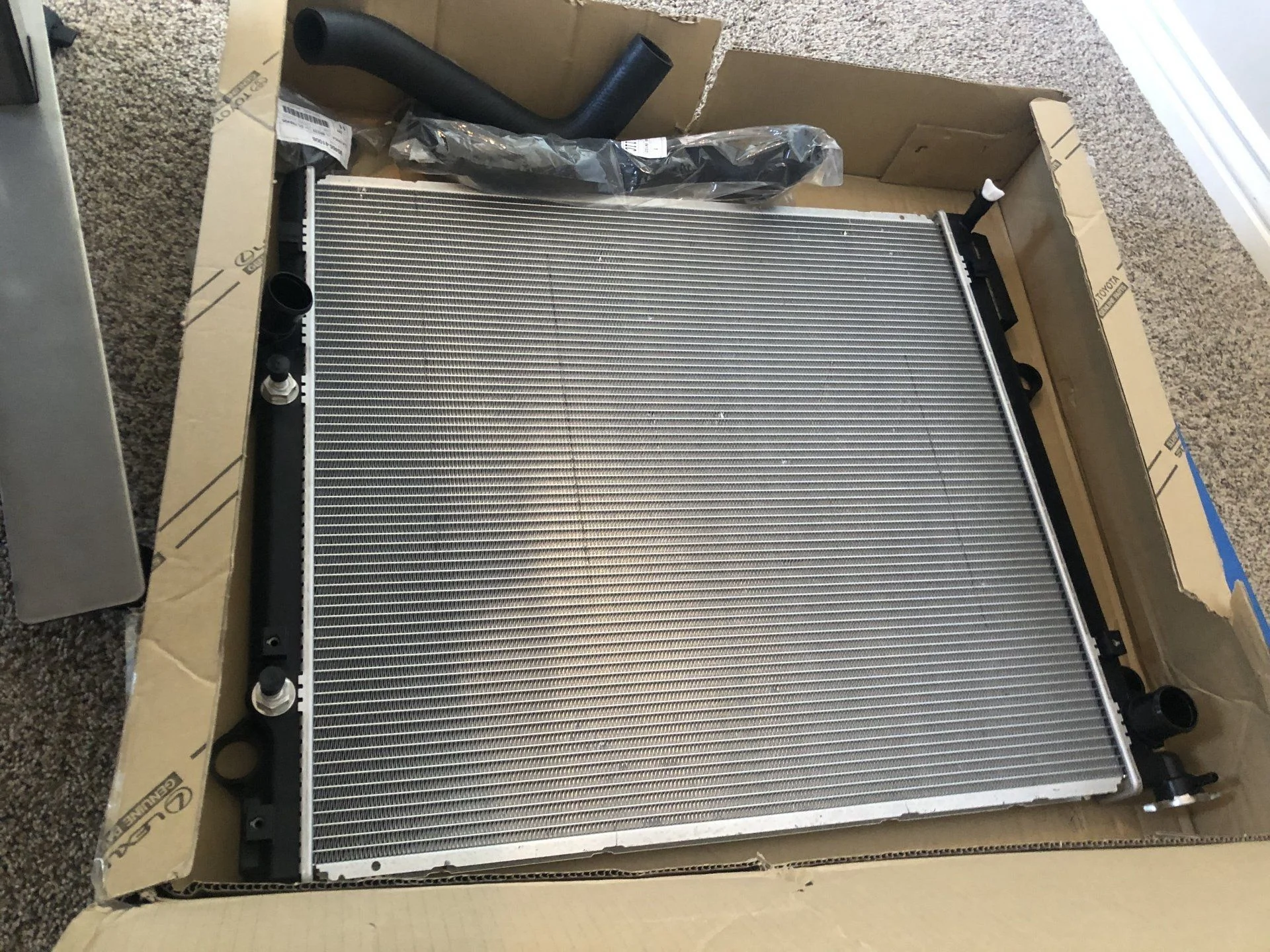

New radiator, hoses and clamps going in today:
PNs:
- 16400-50313 (radiator)
- 90466-41008 (Hose clamp) x4
- 16571-50200 (hose)
- 16572-50190 (hose)

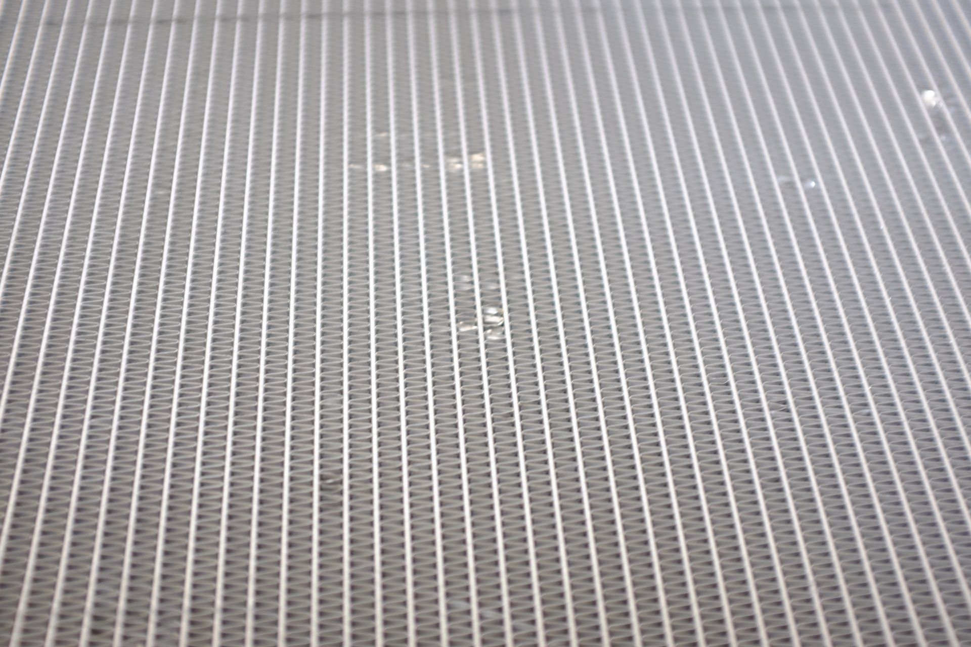

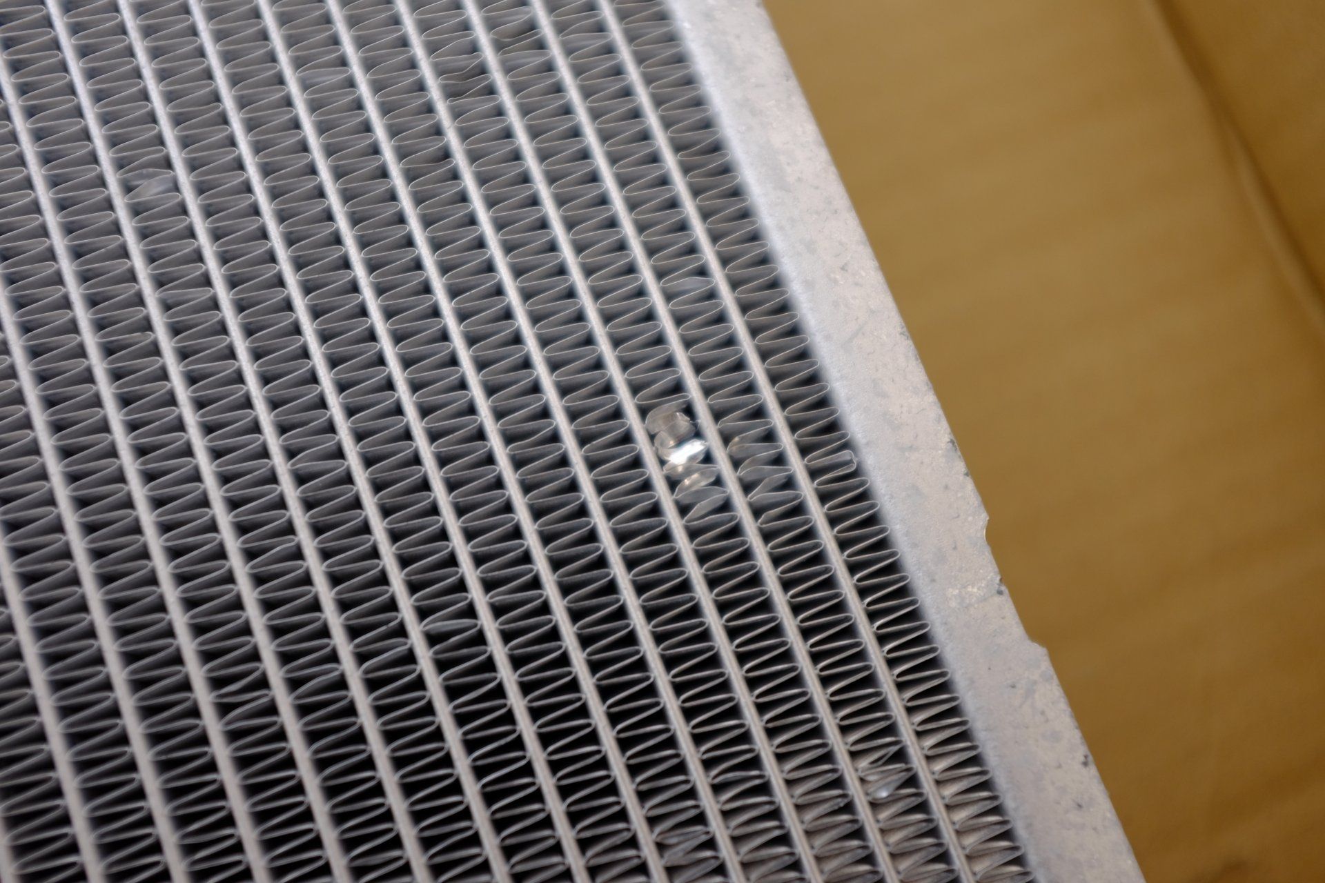

I got the radiator from a dealer parts store called arrowhead lexus in arizona. they had a good price and offered free shipping. But they shipped it directly in the part box, no additional padding. So some of the fins got messed up in shipping and the box took a beating. A little disappointed but I guess what you pay for?
Mechanic said it looked fine, just fin damange. Fingers crossed.

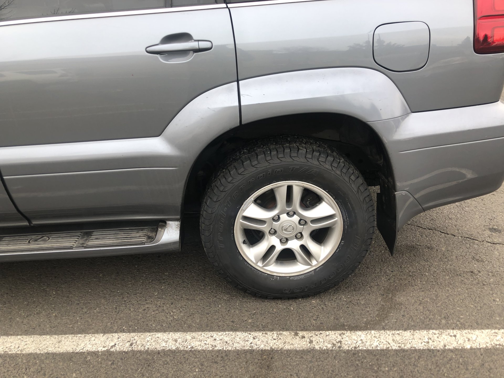

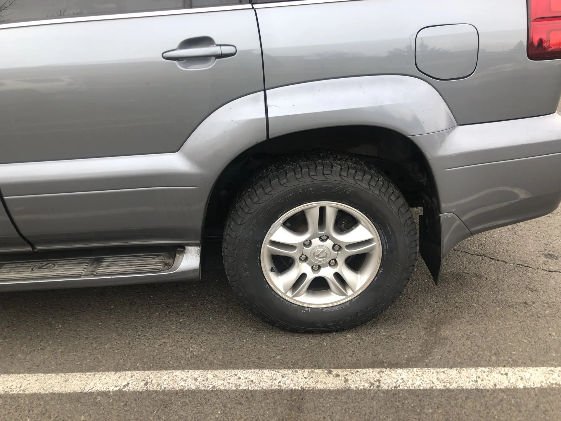

Got some new tires at costco. 5 BFG TRIAL-TERRAIN T/A 265/65R17 112T ORWL ALL-SEASON TIRE Total $1,113.89. It's like a wife version of the KO2. I like them a lot so far. They ride quiet and feel a lot more confident on snowpack than whatever came on this thing.

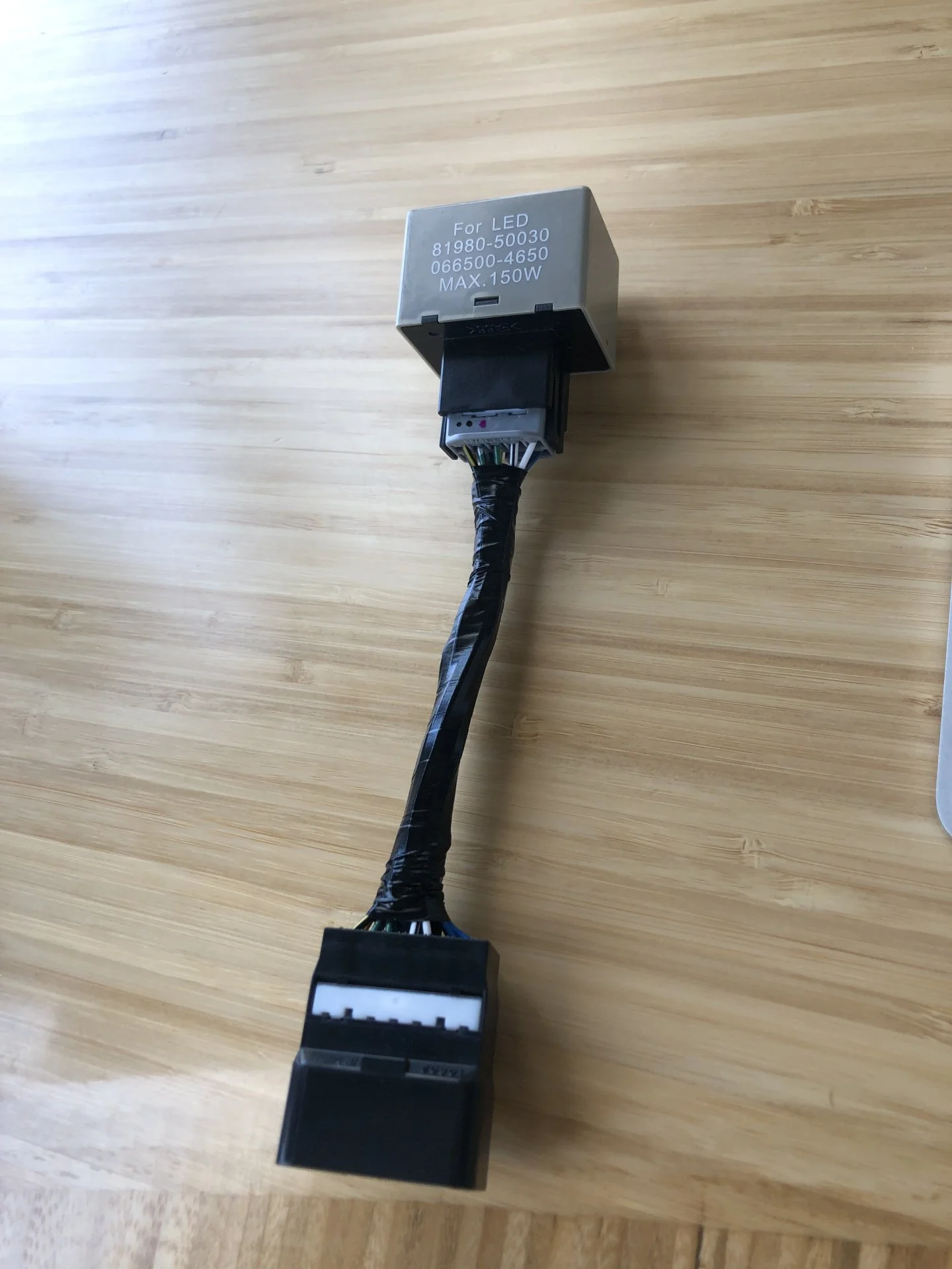

- I changed out the flasher module to an LED compatible one.

Only interesting picture I can find for now is the new flasher. I wish I got the diode dynamics smart tap, might upgrade later.
