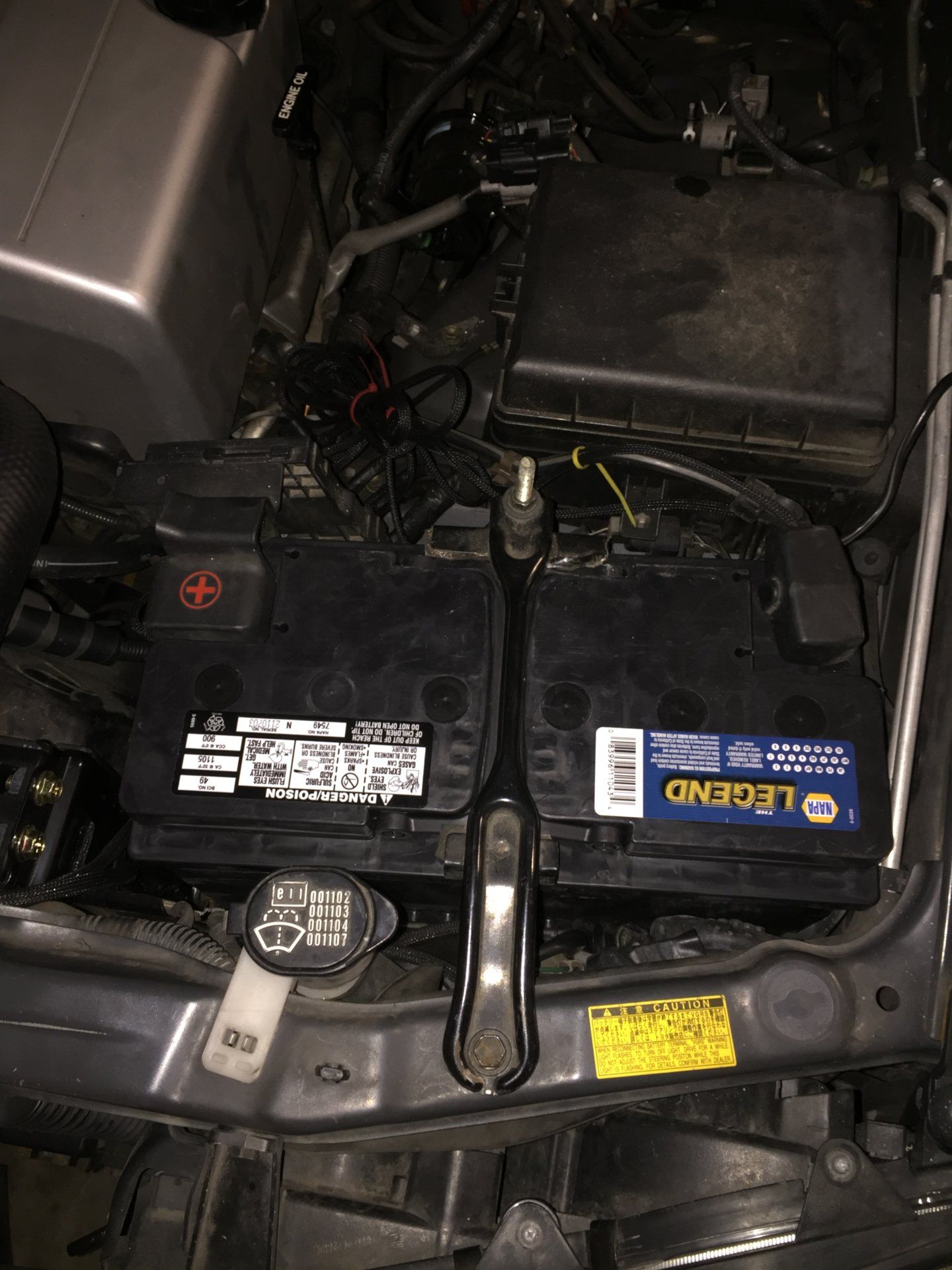

I just installed a group 49 last night. Napa p/n 7549. 900 CCA and 195 reserve minutes. It replaced a group 34 that already had a spacer under it, making the install very fast. The 34 it replaced was a Diehard gold and it is bad after 3 years.

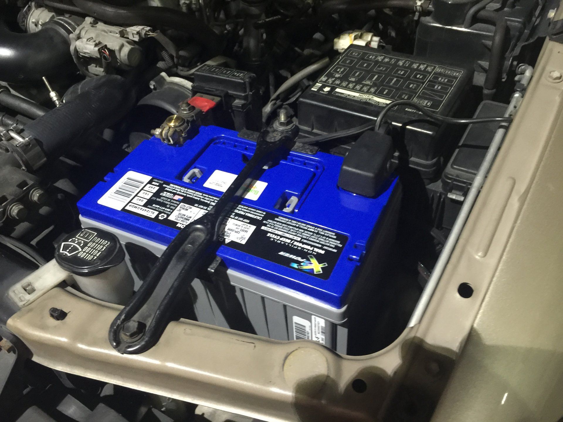

I splurged for a sealed X2Power SLI27FAGMDP last winter. Got tired of scraping the white fuzzy corrosion off my positive terminal and it was time anyways. Got it from BatteriesPlus, they have a 10% of coupon if you order online and pickup in-store, plus a mail-in $30 rebate. It cranks with verve to say the least!

No fitment issues at all. Just need a 3/4 in spacer under the battery.... It appears that the group 49 only comes in the reverse terminal configuration that we need.

Thanks all! I ended up getting a monster of a battery. The NAPA Lenend 7549. 900 CCA rating and a 75 month warranty. 18 months free replacement and 55 months prorated. For $141 out the door. We'll see how it holds up!

Is this a straight up, simple install or did you have to modify something to make it fit and sit in the tray?

She fits. I snugged down the battery holder and seems fine. Will try to find a small spacer to place underneath it to prop it up a little higher so the hold down fits more level but it’s fine for now.
It really is a monster battery! Even the guy at the store commented that it was a beast of a battery.
