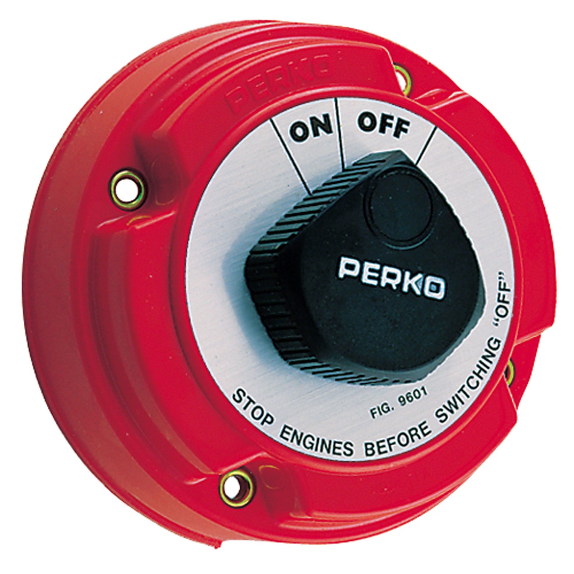

If I wasn’t going to do that, I’d do something simple like this:
A mud member gave me a whole National Luna kit for me sending him a random carb part years ago. That made it an easy choice.
I did the Blue Sea linked above. No complaints. I generally run with the batteries disconnected but periodically connect to make sure the second battery is well charged. This system has come in handy 2-3 times when I've self-jumped because the starting battery was low or had a loose connection. My primary reason for installation was to have a second battery dedicated to winching.

If I was running a fridge non stop, I’d go a little fancier.
I’ve run my fridge off of my single primary optima yellow top for a week while wheeling and the truck always started.
PSA dual battery setups do not necessarily have to include an isolator. I have mine wired in parallel with the DS battery grounded and the PS battery connected to load. I also have a 100w solar panel connected to the setup and it provided plenty of capacity for running my fridge, cell phone booster, laptop, LED lights, etc on a recent trip. I already had a booster pack which I keep in the truck just in case but I've never needed it with this setup.
