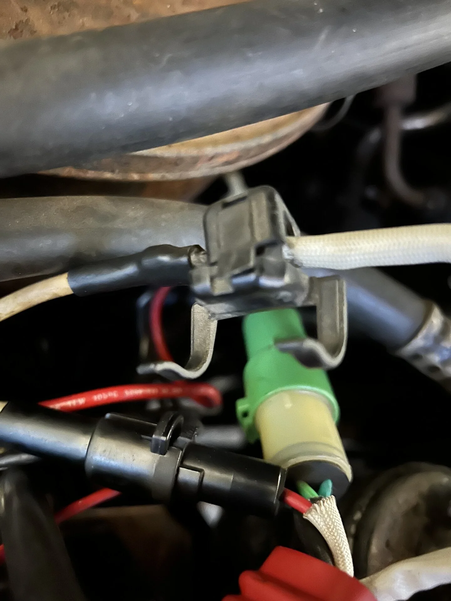

Ok so I figured out it pulls 550 milliamps key off. If I pull the Dome light fuse it drops to 450 milliamps. Nothing else affects it except this connection (see attached photo. Once I disconnect this wire it drops to zero. So next question what does this wire do? BTW mine looks super suspect. About 8 inches up on the harness side 2 wires tie into one that then ties into this connection. Looks like previous owner did some interesting work.
So it appears that is the alternator connection. And being that I just put in the new alternator, what are the chances the alternator charges my battery but then drains it when sitting?

There could be a leak in the voltage regulator of the alternator.
Fairly high if its not a Toyota part. Anything from a LAPS is suspect. Sometimes diodes leak.
This was actually a Toyota reman part. But who did Toyota farm the reman out to? No idea. Anyways I have to take it to my local dealer to get a warranty replacement.
I am still not sure I understand all the physics of it. Basically it is pushing DC to the battery when running but when it is off the diode causes a closed loop with the battery that self drains? Not sure I get it but whatever.

That's probably it. What does it lead to?
