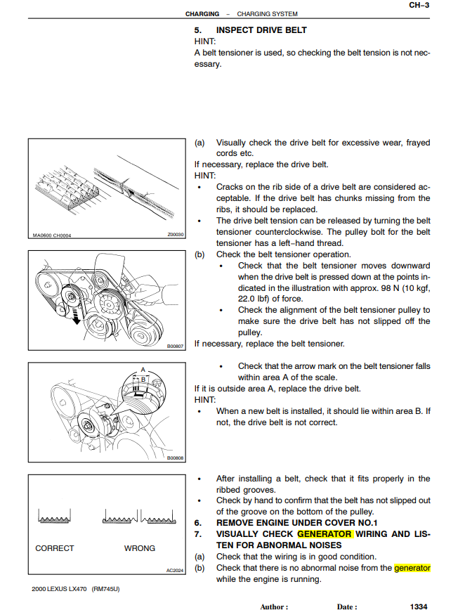

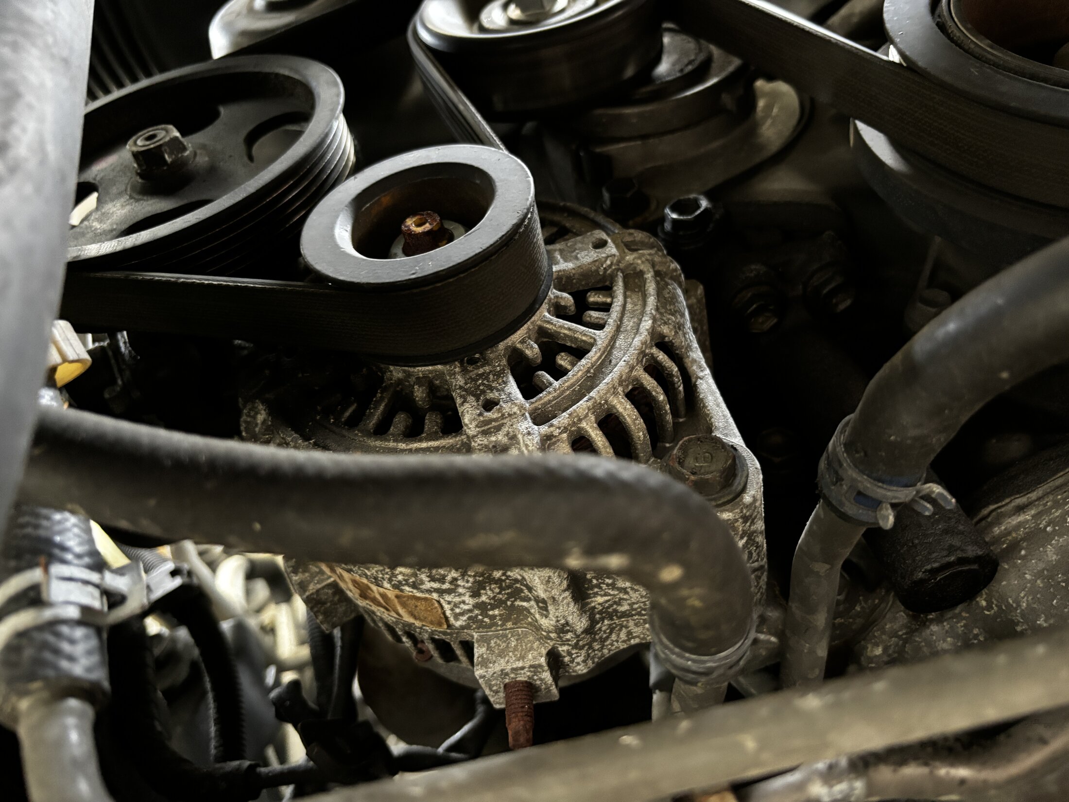

Thanks for the response and the information! Everythings pointing to alternator and I have a charger that tests the alternator and its saying there's a fault as well. Got quoted $500 but doesn't look that complicated to do myself so might give it a shot. Can anyone suggest a replacement?
I only use Toyota OEM -84. -84 is code for remanufactured.
There is a 10mm bolt holding the wire/cable hanger bracket. Make sure to swap that bracket over to your new alt. I can't see well in your picture, if yours is even there. Oftens times, when an ALT has been replaced. The bracket is not moved over to new. Which wire, then bounces around (not good).
The main wire lug held by 10mm nut, is keyed. Make sure both tabs (keys) are their slots in and clocked.
There is also a plastic cover over wire lug and its 10mm nut/stud. Best it's placed back on. It's a guard against arc/spark in event, metal contacts it and ground. A spark that can start a fire otherwise!

Seems all denso are discontinued? Can you point me in the right direction for a good substitute? Thank you for all the help
Just did this in the driveway. Remove the PS pulley. You can then get it out through the bottom with a little finagling without removing anything other than the skid plate and air intake.
On later models you may have to take the bolts out of the PS pump. IIRC they changed the pulley to a pressed on at some point.
