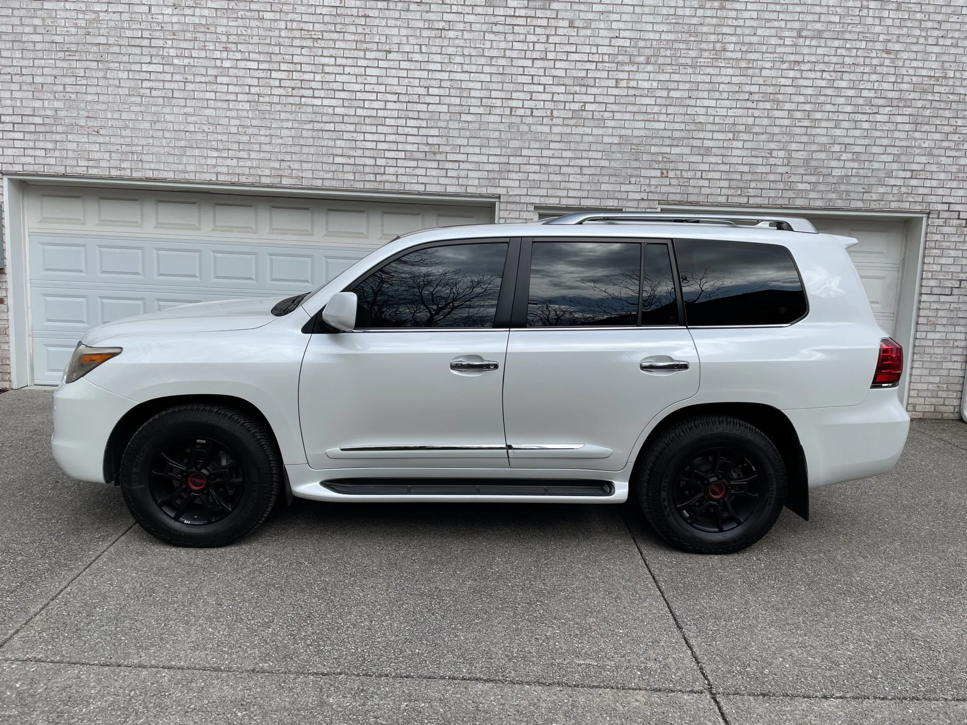

4. Swapped the 22" Black Rhino Wheels for 18" TRD Pro BBS Wheels w/ 275/65/18 Michelin LTX AT2 Tires (Facebook Marketplace find)
  • Added an identical 5th spare so I can do 5-tire rotations
  • 5 x New Denso 550-0103 TPM sensors
  • Discount Tire mount & balance

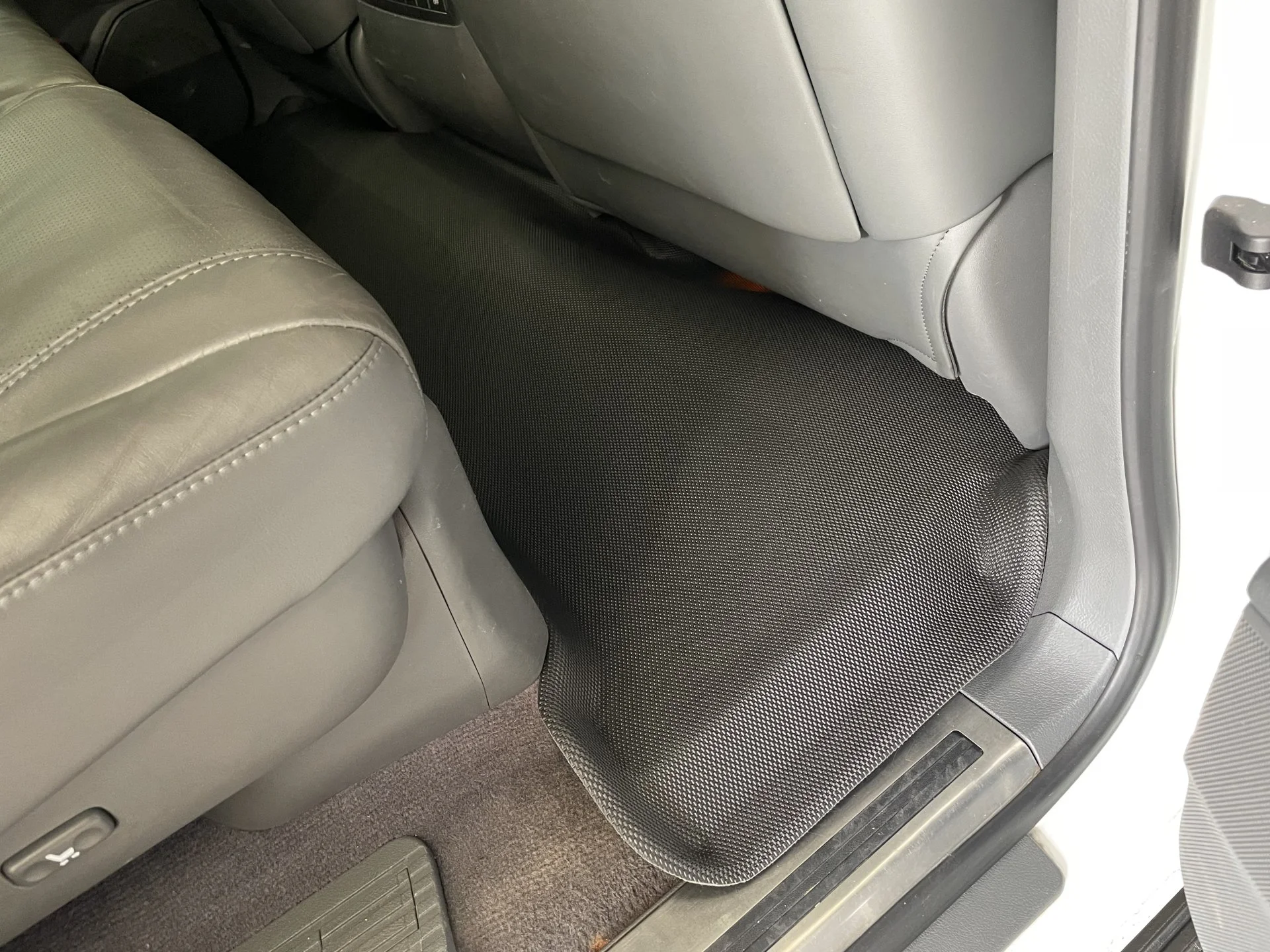

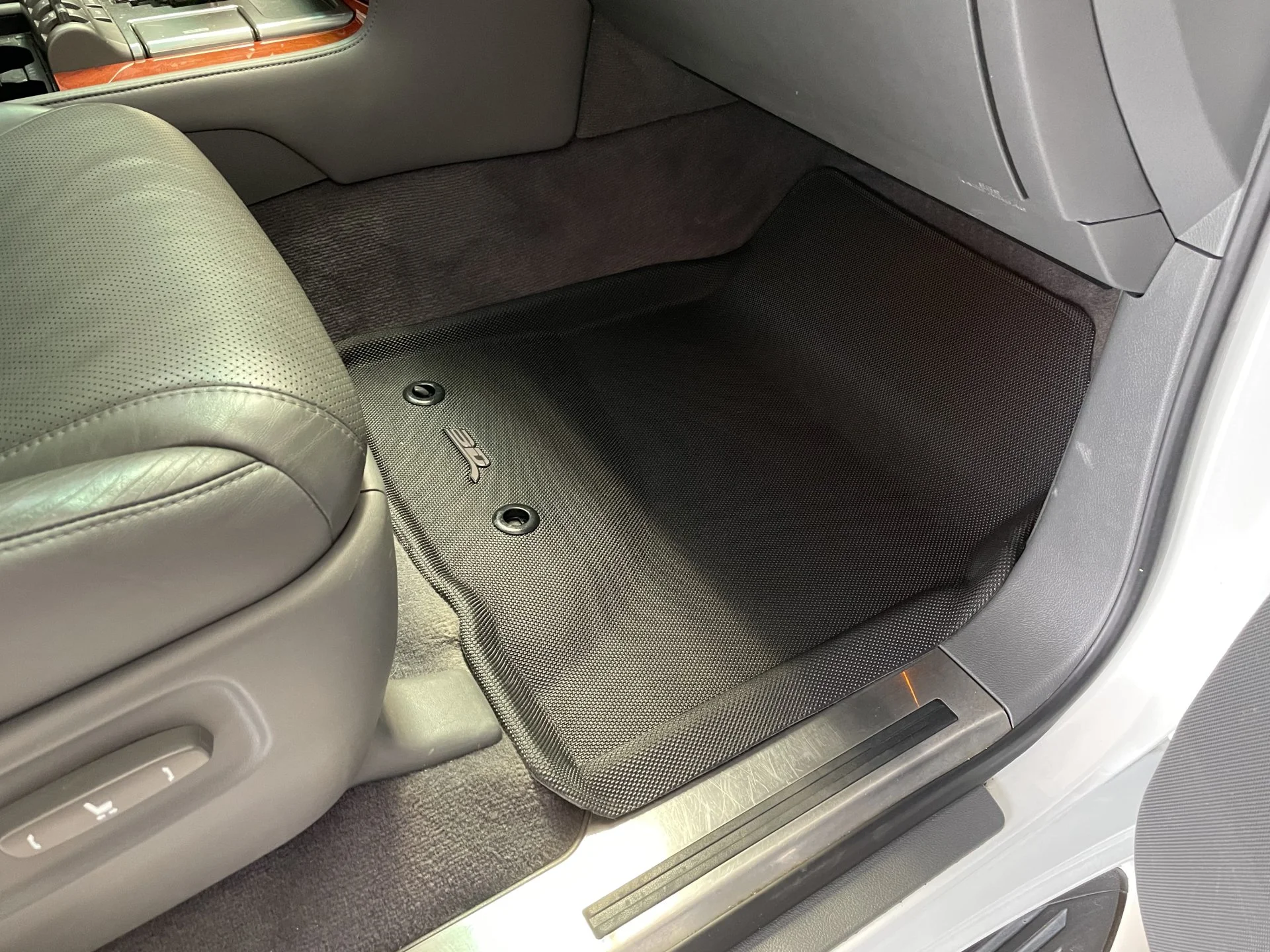

  • 3D Maxspider front & 2nd row mats (Nicer than Weathertech, but I really wish Husky made the "X-act" line for LX/LC (Have them in my F150 and they are amazing)

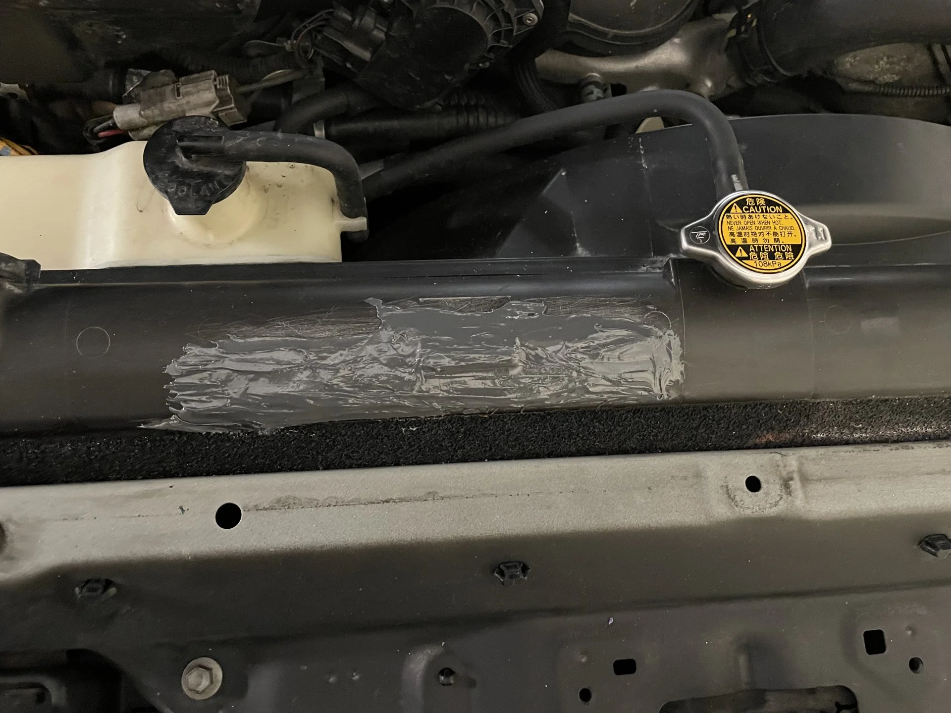

  • Temporary JB Weld patch for actively leaking radiator (Temporary stopgap until I get around to installing new radiator. All parts already on order)

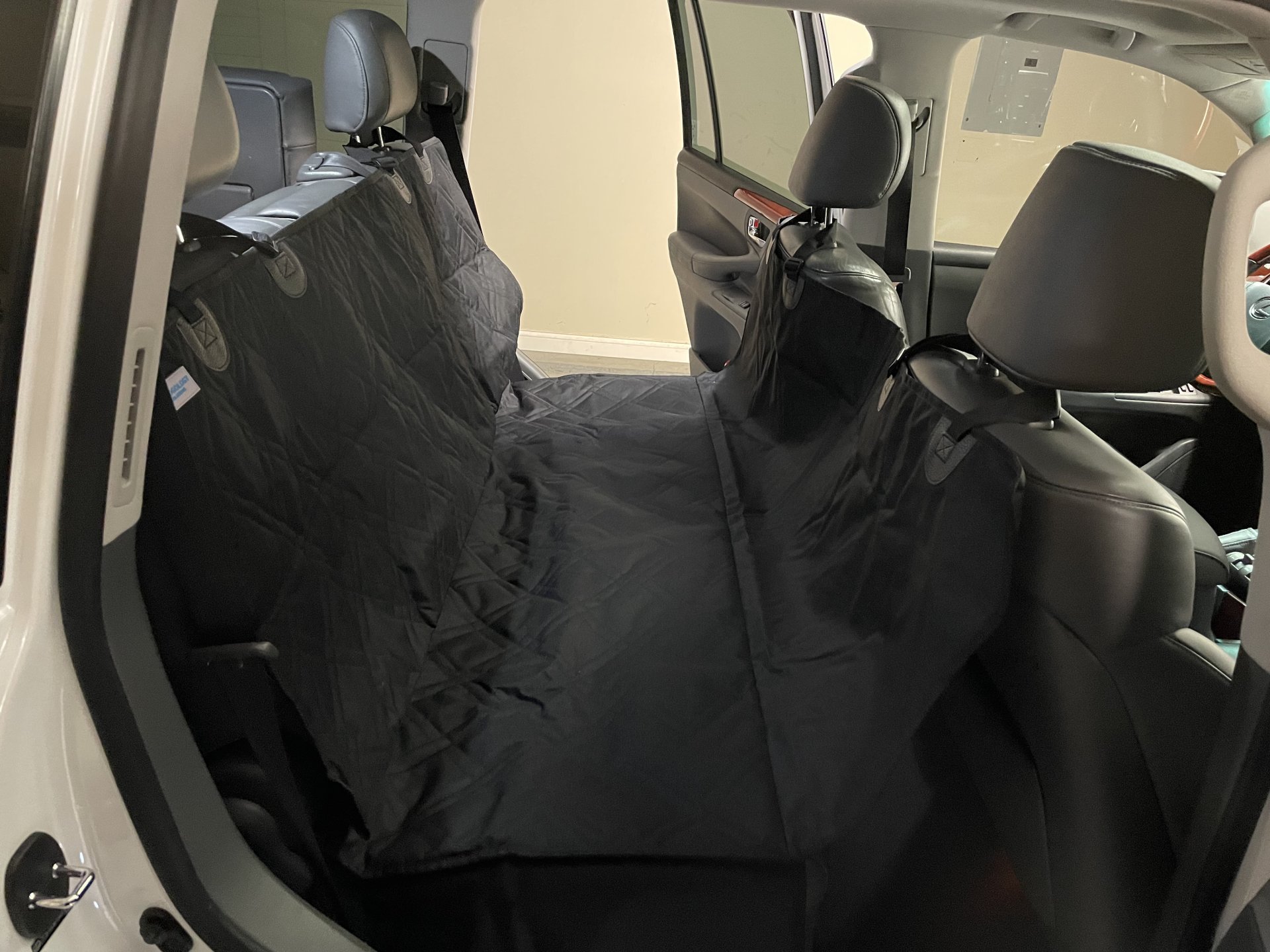

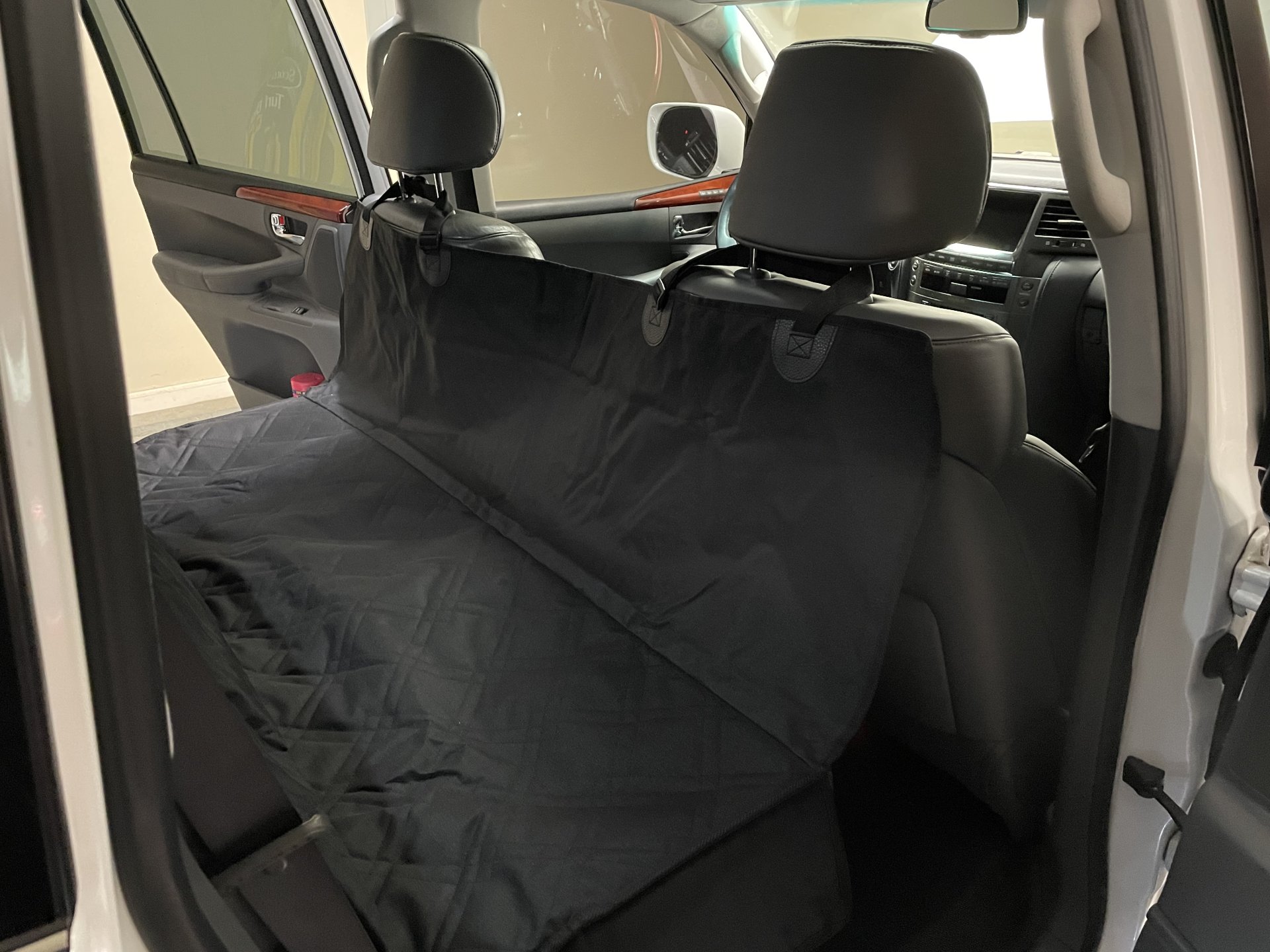

Added in the Bulldogology Dog Hammock for the backseat to carry the pups on road trips. Fits perfectly (56" wide) and pretty good quality.
Includes side flaps for seats and anchors to hold the back of the hammock to the seat.
Amazon product ASIN B01C83PBO6

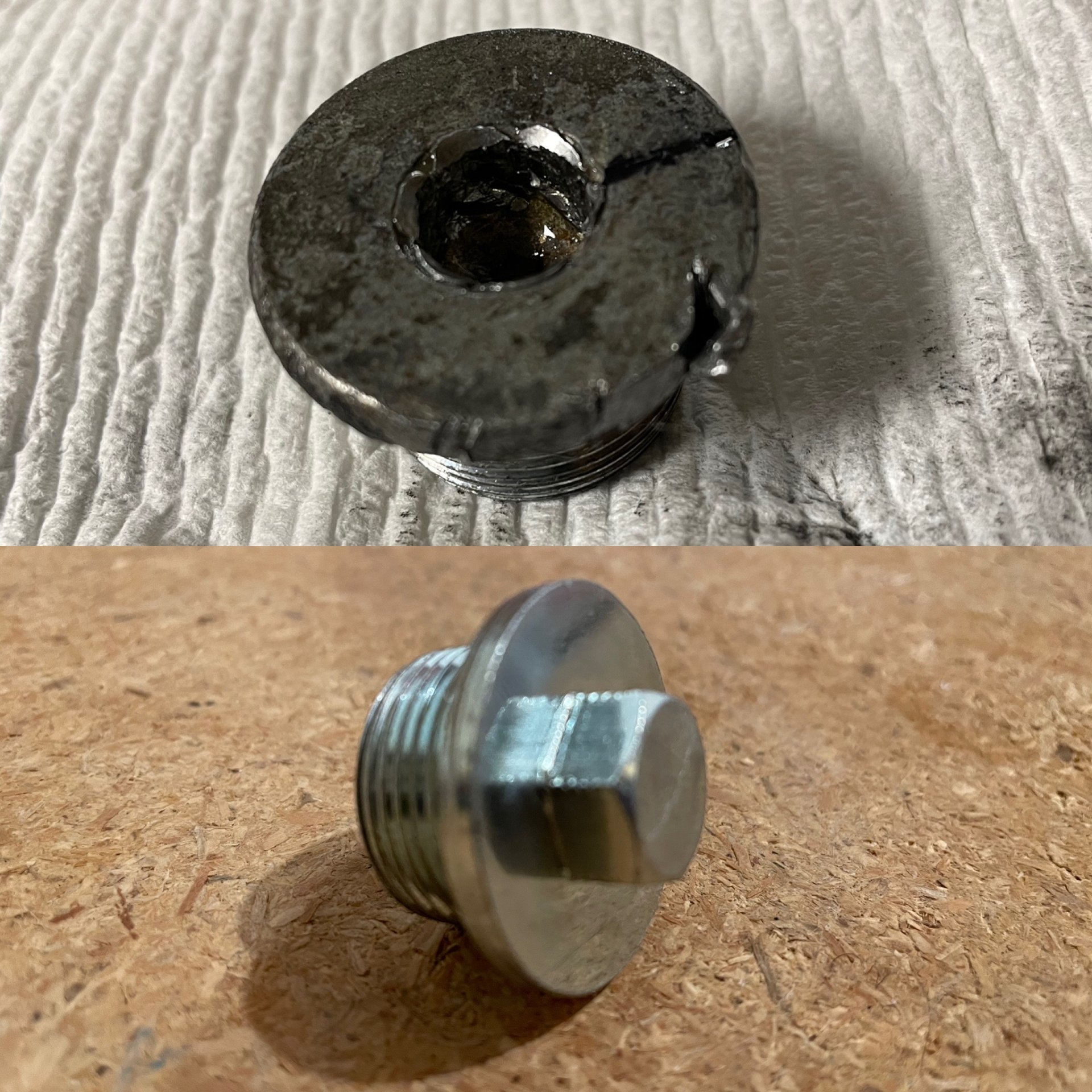

Front diff service (2qts Mobile 1 75w-90) complete....finally.
My 2008 LX570 had the drain plug stuck on like a bear. A 36" breaker bar wouldn't move it. Also stripped the Allen bolt.
After cold chiseling for 45 mins one day, here is what worked for me:
1. Overnight soak with PB Blaster penetrating oil
2. Cold chisel notch (Use an actual cold chisel, not a wood chisel you have laying around)
3. Mark bolt and diff housing with permanent marker so you can tell if it is spinning.
4. 3lb Hammer
5. Have replacement Lexus HEX plug on hand - 90341-24016
Friendly reminder to not only wear eye protection, but also EAR PROTECTION. Hammering metal against metal in an enclosed space can cause ringing in your ear. (Ask me how I know)
Came right off.

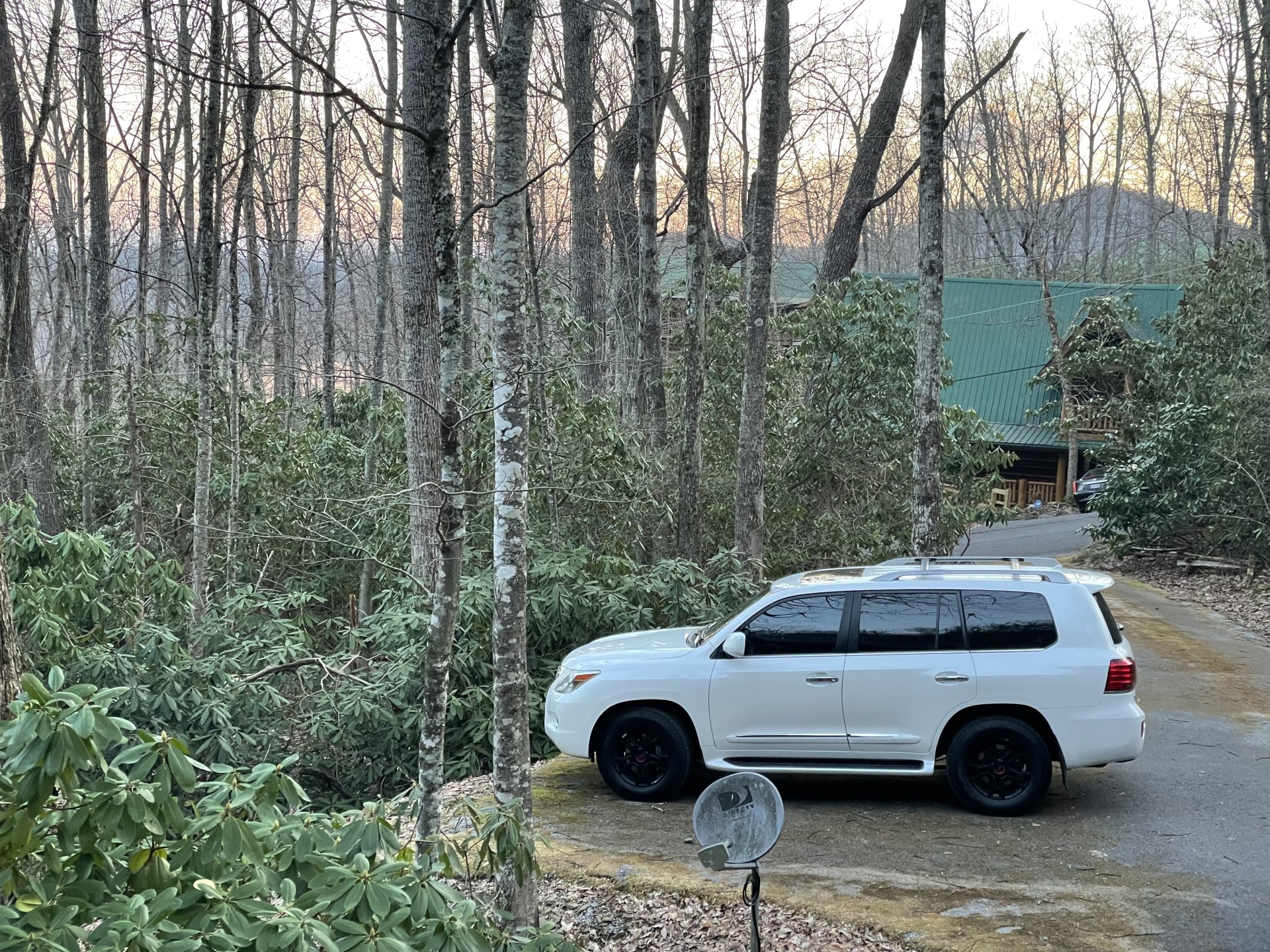

Also took her on her inaugural trip to a National Park. Great Smokey Mountains.

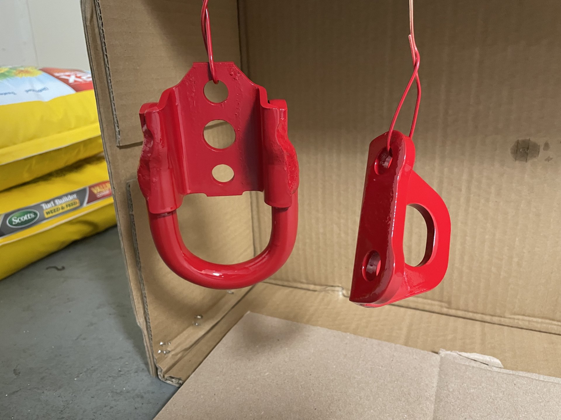

How hard is it to remove the factory tow hooks?
Super easy. Remove 2 17mm bolts.
Use wire brush to clean off any rust, paint, let dry for 48 hours, reinstall.
Obviously don’t paint the bolts themselves.
Does the dog cover allow access to the seat belts? We clip our dog in with short bungie leash that clits to his harness and attaches to the seat belt buckle. Our curry over allows this with a Velcro slot but the cover itself kinda sucks. This looks a lot better.

Yep. There is a Velcro access cover so you can get to the seat clips. Mine actually came with a bonus harness clip.

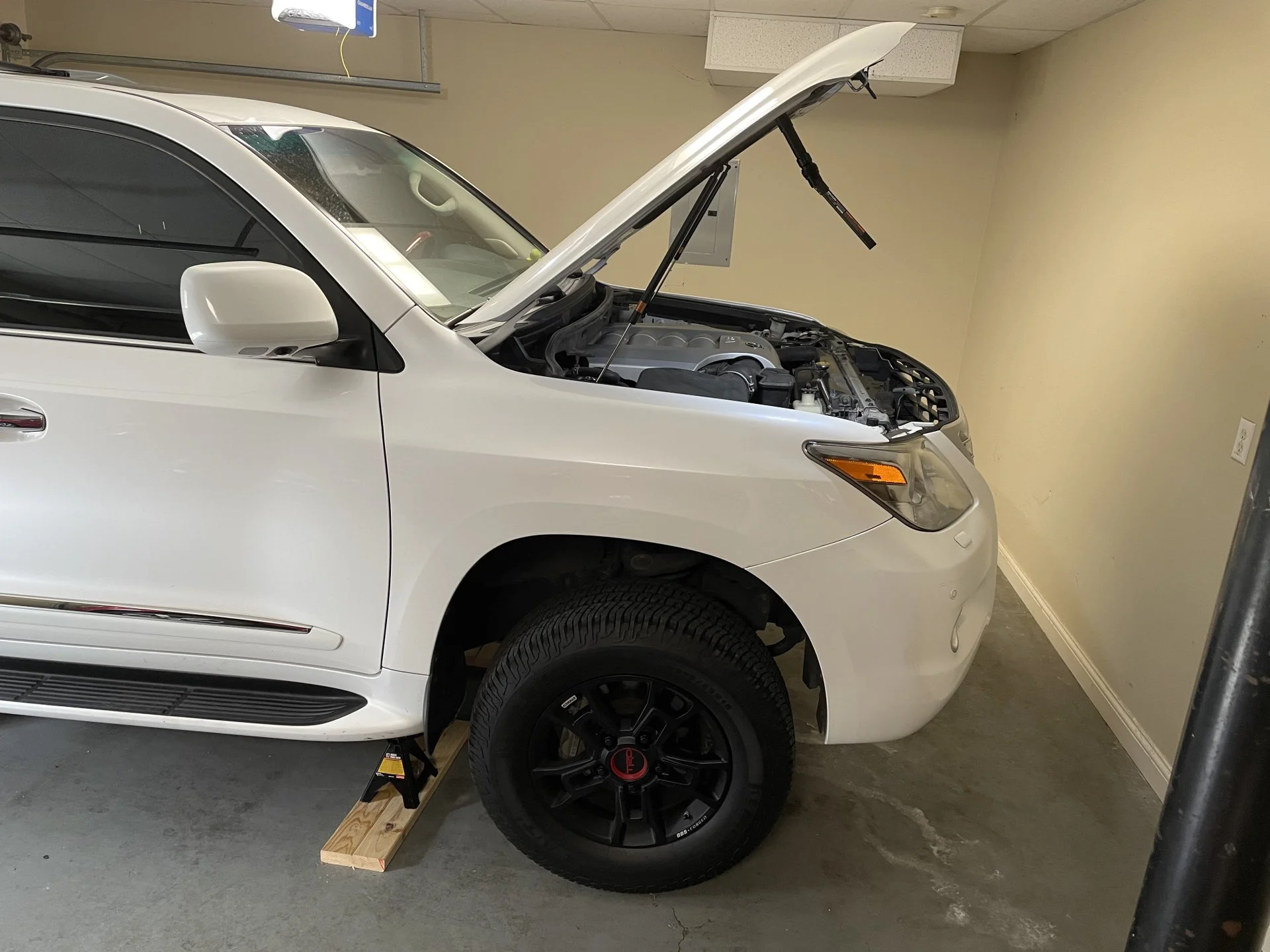

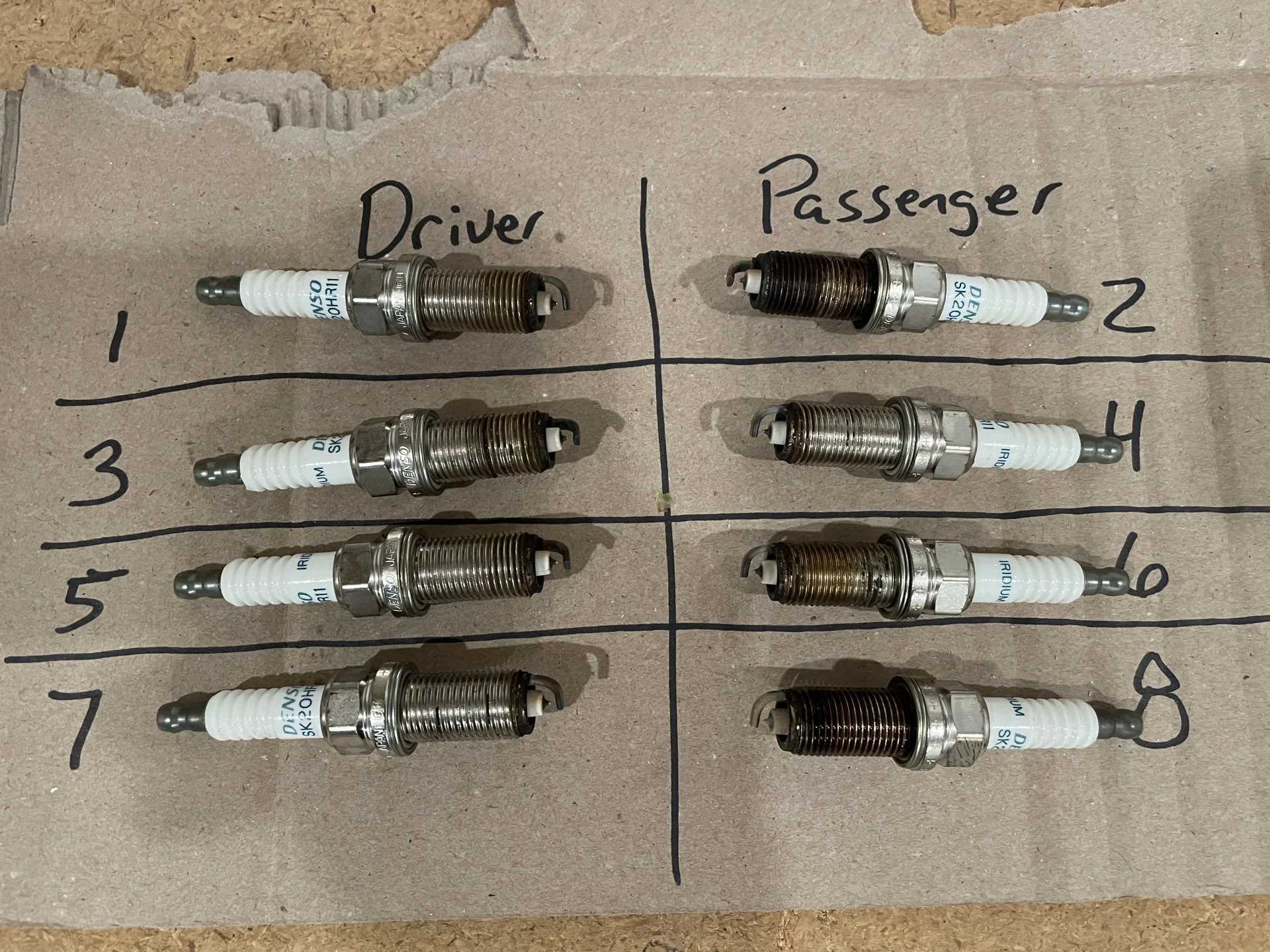

Completed spark plug change this weekend. Plugs #1-#7 are pretty self explanatory.
Took a few pictures to help people with Spark Plug #8 (Passenger side near firewall) since that is the tough one:
Based most of my work off this video:
  • Step 1: Remove airbox cover & fuse box cover on passenger side (Yellow arrows)
  • Step 2: Detach wiring harness clip from mount (Green arrow)
  • Step 3: Wedge wiring harness under mount to give additional room (Green arrow)
  • Step 4: Remove 3 bolts holding hard lines engine (Red arrows) - Be careful not to drop them, they are shorter than the coil pack screws
  • Step 5: Gently wiggle the hard lines, push them down 3/4", and wedge the mounting bracket from the middle screw under it's own engine mount to give you additional room (Red arrow in second pic)
  • Step 6: Remove coil pack & change spark plug, using various extensions (Purple arrow)
  • Step 7: Install new plug & replace coil pack
  • Step 8: Reinstall front 2 bolts holding hard lines from Step 4
  • Step 9: For last hard line bolt, nearest to firewall, lightly wrap bolt in socket using electrical tape. You want 1/8" inch of tape lightly holding the screw in the socket. (Red square in 3rd pic)
  • Step 10: Reinstall 3rd hard line bolt. Once it has "caught," you should be able to pull the socket back and the electrical tape will give way
  • Step 11: Reattach wiring harness from Step 2
  • Step 12: Replace fuse & airbox covers.
Plugs are from 2008 LX with 158,000 miles.
While it had impeccable Lexus service history every 5k miles, I didn't see a specific entry for spark plug change. They could have been done under the 90k, 120k, or another major service interval, but it isn't specifically called out in the Lexus service records. All were still gapped around .44-.46.
I had a little bit of oil in bottoms of #2 and #8 (Passenger side), but definitely not a substantial amount. Coil pack tubes were bone dry with just a small amount of residual red "scorching" that wiped right off with a dry paper towel.
