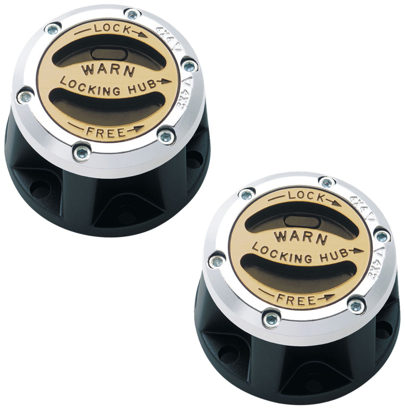

I'm strongly considering painting the pieces for the warn hubs. What was the original color scheme from warn?
Color scheme should be similar to this image:
I have the same hubs on my 65. Mine are a gunmetal gray color body with a chrome ring around a gold selector. If that helps at all
That helps. I now have 3 options that seem "original" to warn. I guess the consistent part is the gold selector. Initially, I thought this was brass, but the corrosion on one of my selectors makes me think they are anodized or otherwise plated aluminum.

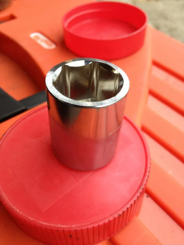

Your drain plugs should be 24mm.

All plugs were 23mm. I had to buy a 6 point at northern tool and shave the bevel a bit for the shallow bolt heads.

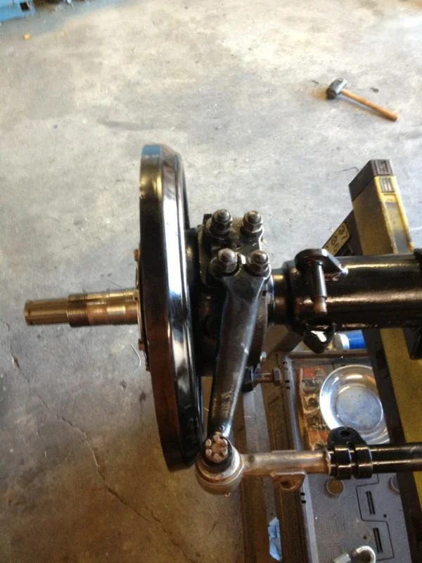

After correcting the wrongly assembled knuckle steering arms, I put on the brake backing plates and outer hub seals. I couldn't find stainless wire at the local hardware store, so I used galvanized steel for the safety wire. The old TRE's are back in as place holders. I'll order replacements before this hits the road.
