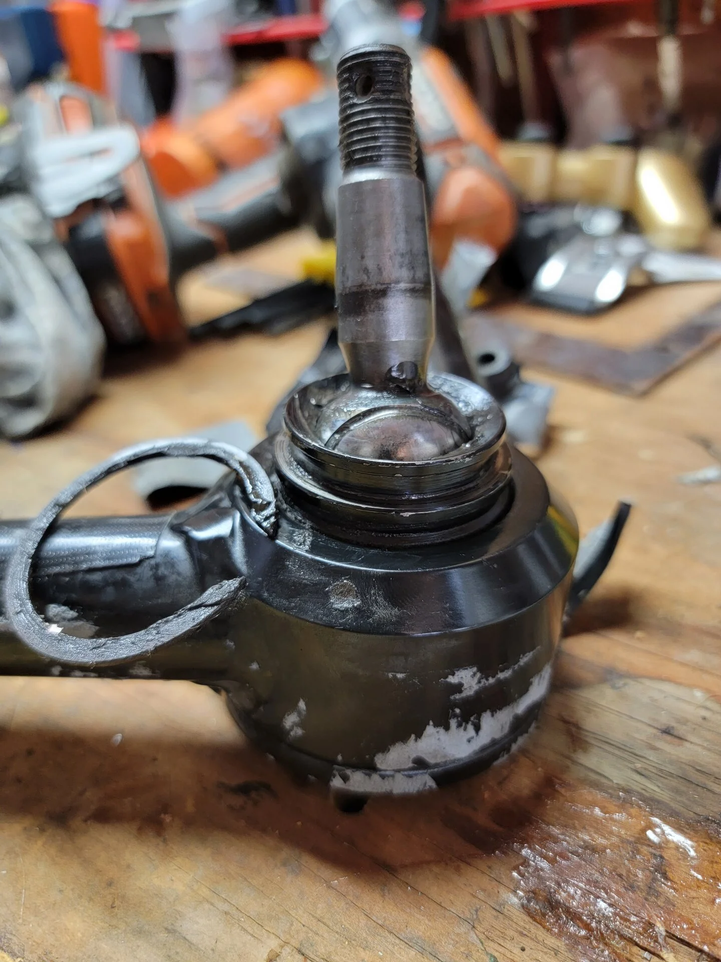

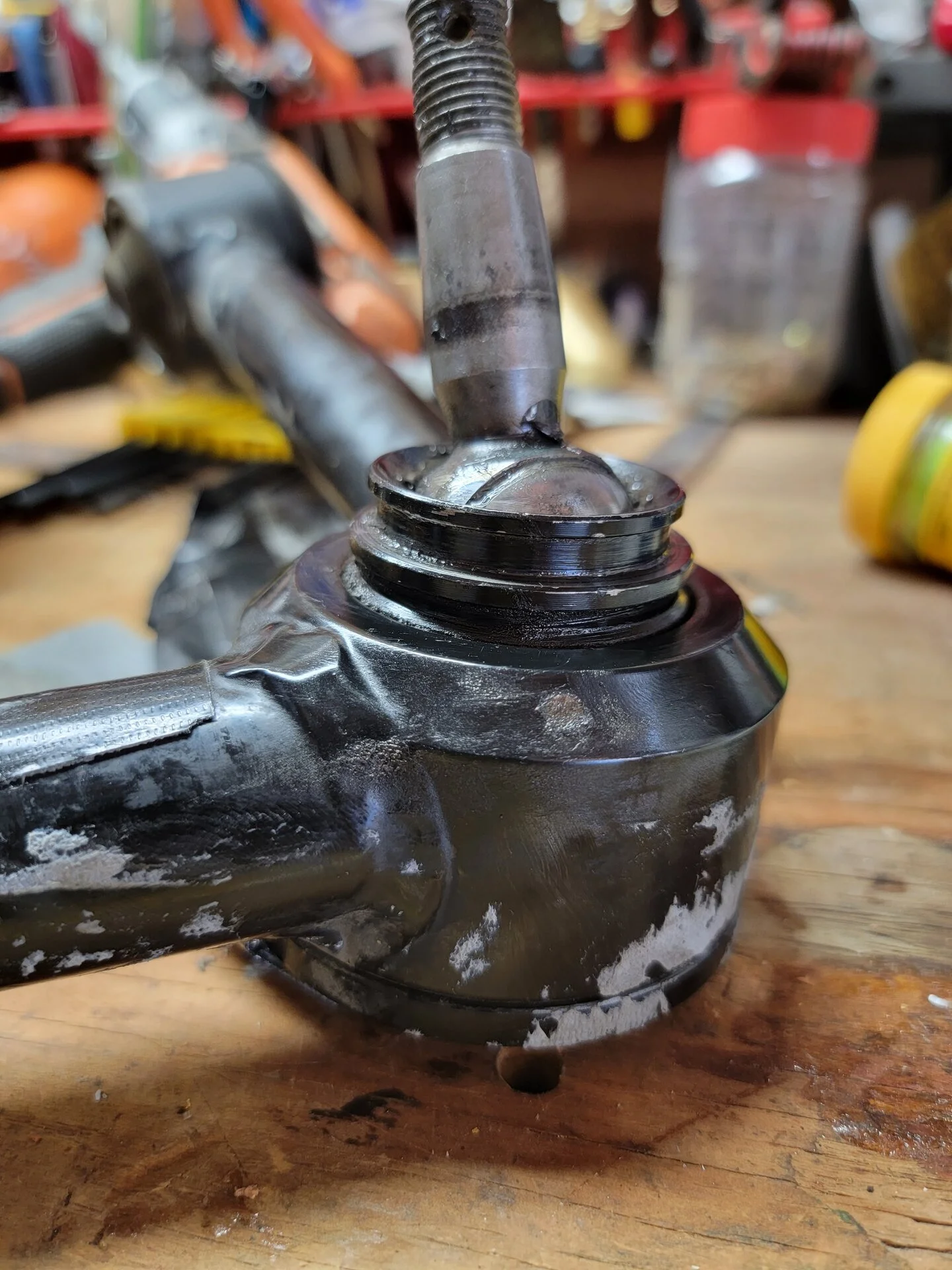

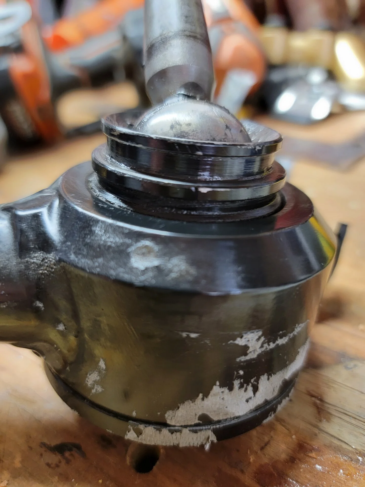

First time trying to press ball joints (and 1st time doing a lift install this weekend). Was getting some pre-work in, attempting to press 555 ball joints I got from @cruiseroutfitters because my dobinsons were only available without ball joints or with moog’s from Exit Offroad.
I have a press kit and pretty sure I am doing it right….got em in pretty good but doesnt seem far enough in compared to some youtube videos I have found. My question is - am I clueless and shouldn’t be trying to press until I first have the backs of arms installed in vehicle - or should I drive the uca’s to a local shop to press them in using their press? I didnt want to install the uca if I was gonna still not be able to press them further.
Appreciate the help and guidance. Her are pics of how far i have them seated.
I'm not familiar with the specific parts you are using.
Is it my impression or the first pic shows the ball joint not aligned with the hole. Looks like there is more space on the left than on the right. That might explain why it doesn't go fully in. Maybe the hole is crocked in the arm, maybe it is just an optical illusion.
But my expectation is that it should be fully in.
How did you press them?

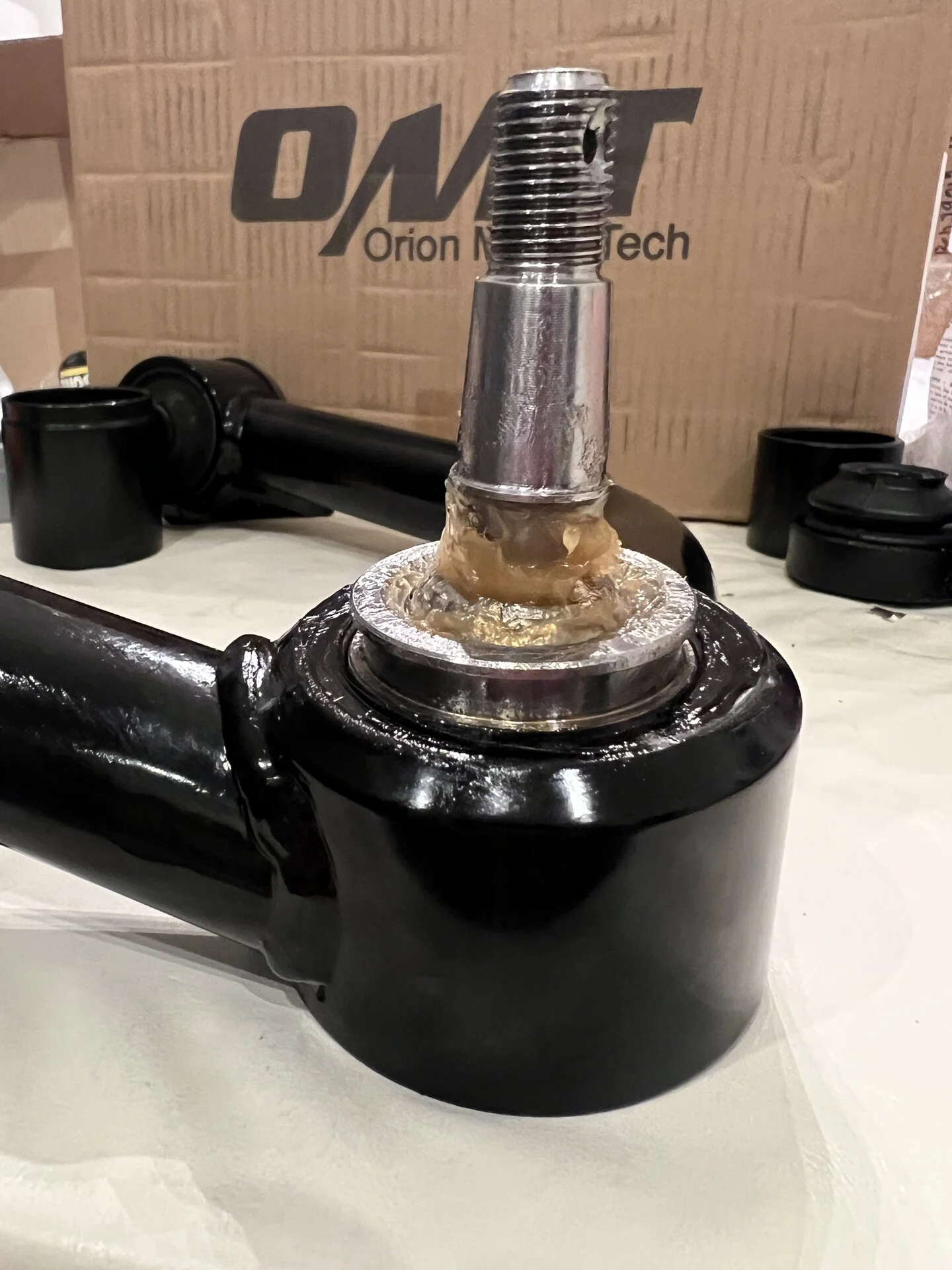

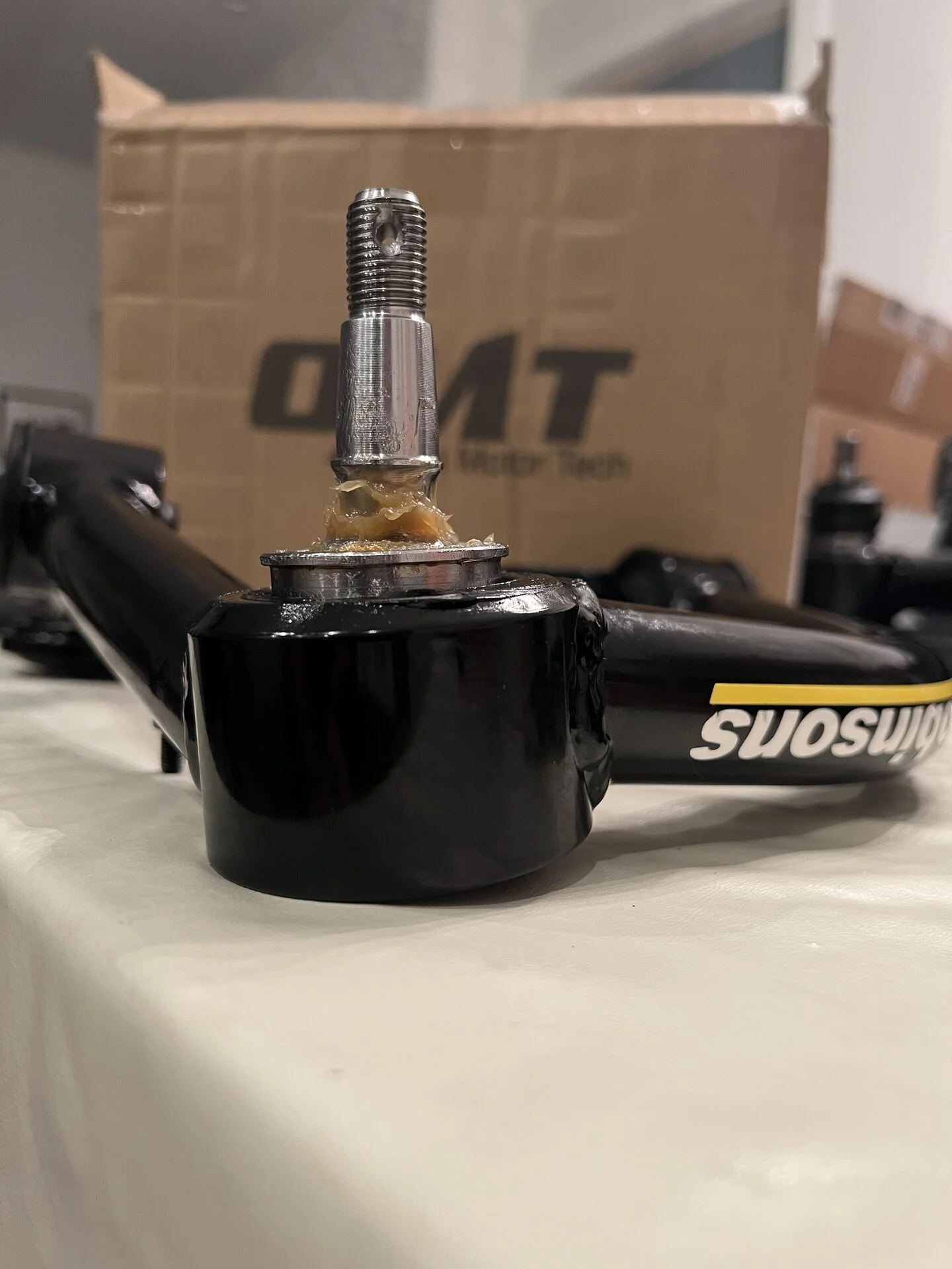

Ball joint goes in without tools centered, and has no free space to move and get uncentered - rather just encountering resistance to go further enough and get fully seated when using a c-clamp ball joint press.
If still needed , later this evening I can get pics and measurements from my Nitro Gear UCAs. They look identical to the Dobinsons and are probably made by the same company/distributer.

Looks like you have 1/4" more to press in.
