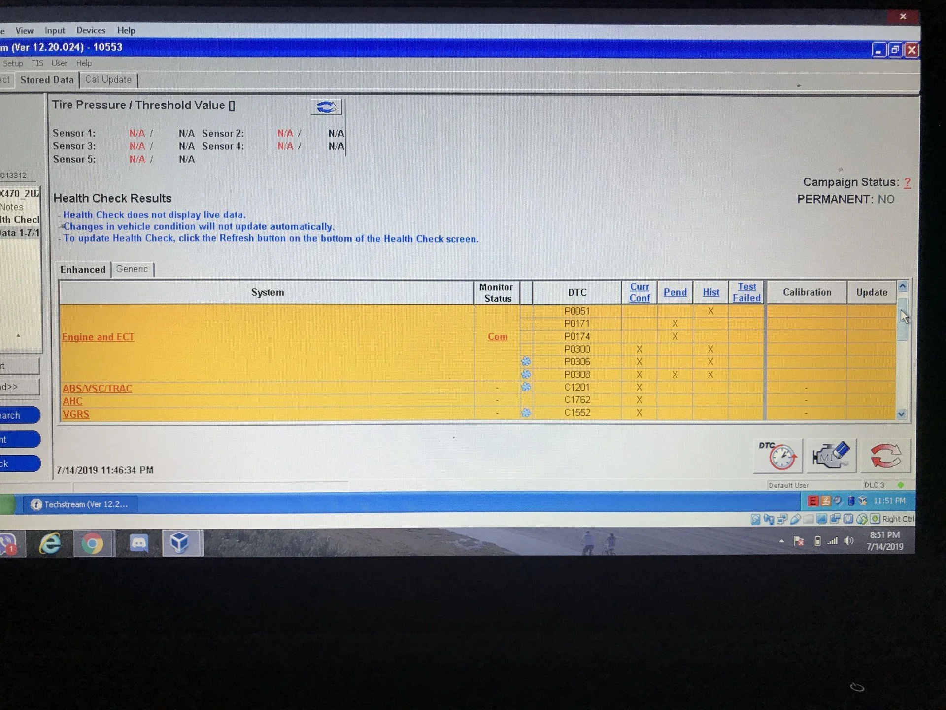

I ran techstream and I don’t know if this would help..

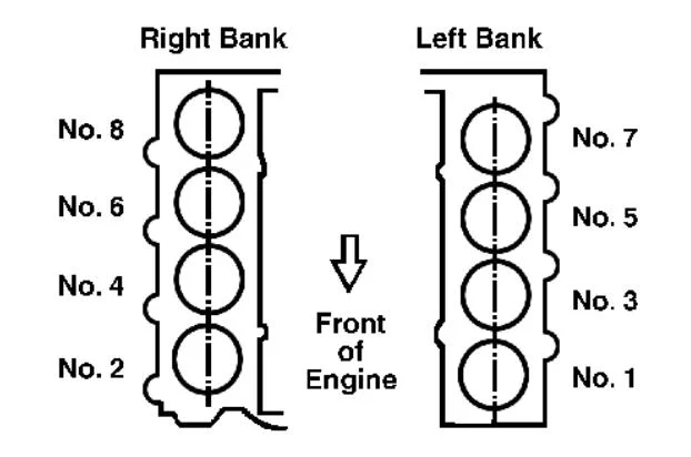

Misfires on cylinders 6 and 8. Move those coils to other cylinders to see if the misfires move with them.
thanks I will try that tomorrow. is this correct for 2UZFE?

Start with the coil switch over. But it is strange that two coil packs would fail at the same time.
You also have a lean condition on both banks P0171 and P0174. That combined with the high temperatures and stalling at idle (more heat, no airflow) could also mean a low fuel pressure. Fuel could even be vaporizing in the fuel rail. So that would be the next thing to check.
