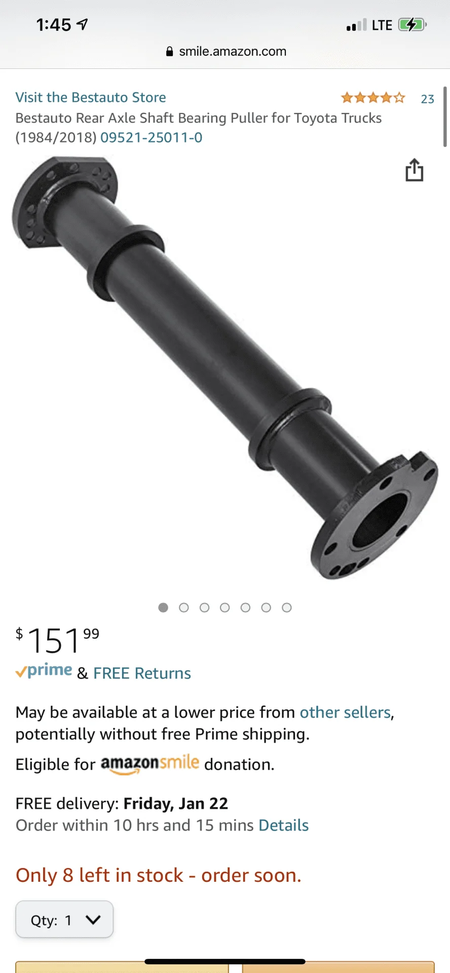

If you already have access to a press this is the tool you need. At this cost vs paying someone I’d buy the tool, though I already have a press.
