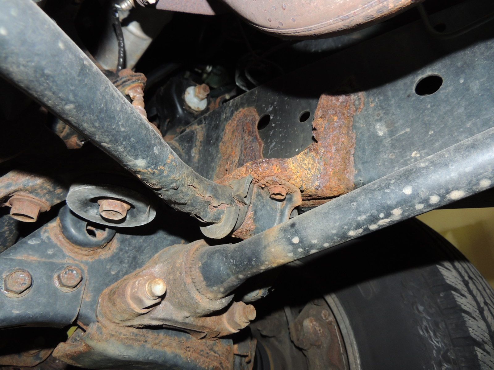

You'll have better luck finding a rust free 80 than a 100. The 100 series frames are terrible. Check the passenger sway bar bracket at the frame and the cross member above the rear axle on the drivers side. Listen for an exhaust tick when starting cold. The manifolds crack and it's not a fun job.

This one looked reasonably clean from the outside. I think it was 130k-ish.
Passenger side front sway bar mount was broken off:
crossmember behind the axle, driver side:
