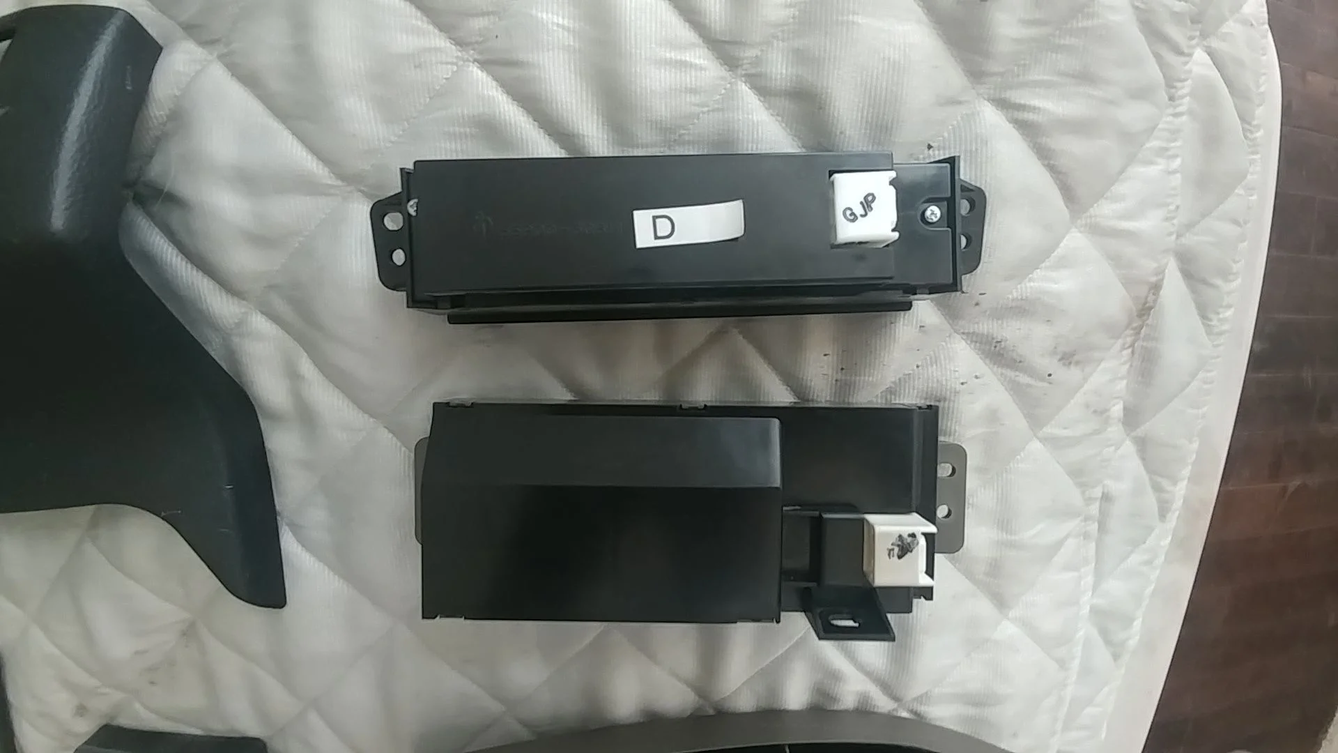

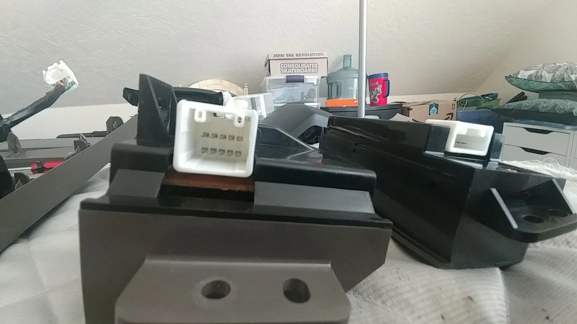

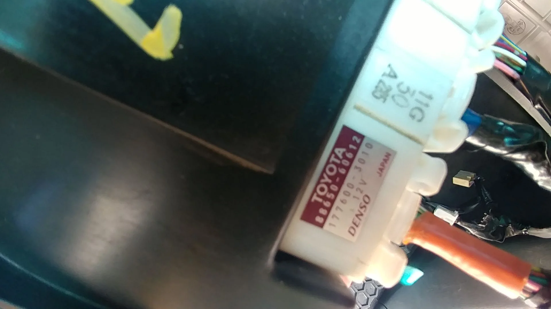

**Note a lot of wrecking yards list the heat/ac control as interchangeable across all years of the GX, but this is NOT true. There are several components which make up the whole control unit so the part numbers listed here are for the “Amplifier Assy, Air Conditioner” which is clearly identifiable by a Toyota part number sticker located on the left male connector on the rear of the unit. There is a bit of unknown with the switch-over months on which one you *actually* have, but I think going by this would be the best bet if your GX has a mfg month on one end of the switchovers.
88650-60770 (11/2002 - 10/2004) (folks have also seen an 88650-60B50 for these years as well)
88650-60771 (11/2004 - 07/2005)
88650-60772 (08/2005 - 12/2005)
88650-60773 (01/2006 - 07/2009)

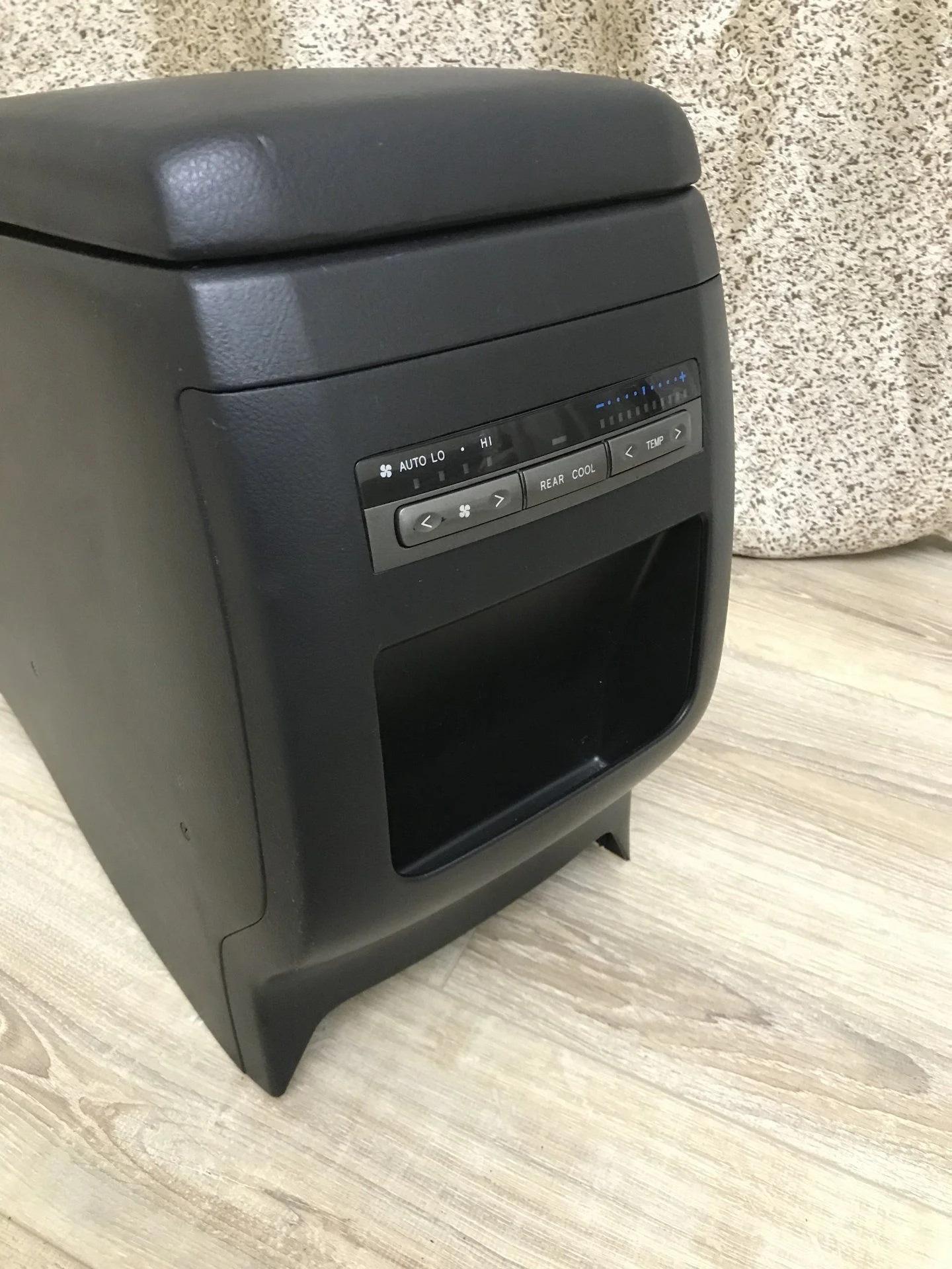

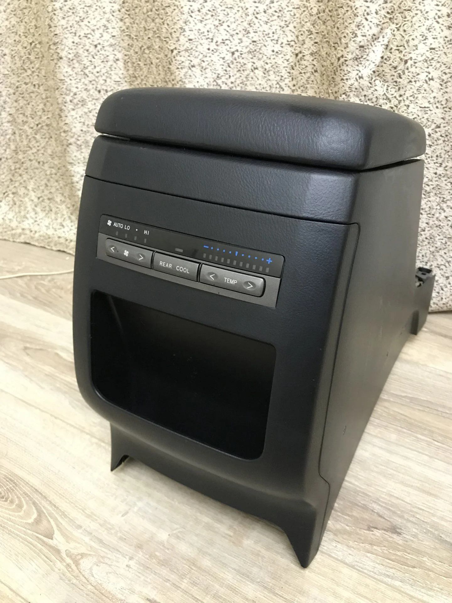

Well, I ended up selling that original console box setup I had in mine, but I've ended up driving this GX more and more and really missed the large console box. So I got some more stuff in. :D Got 2 boxes here, and another (hopefully) on its way. They're currently all tentatively spoken for, but that could change.

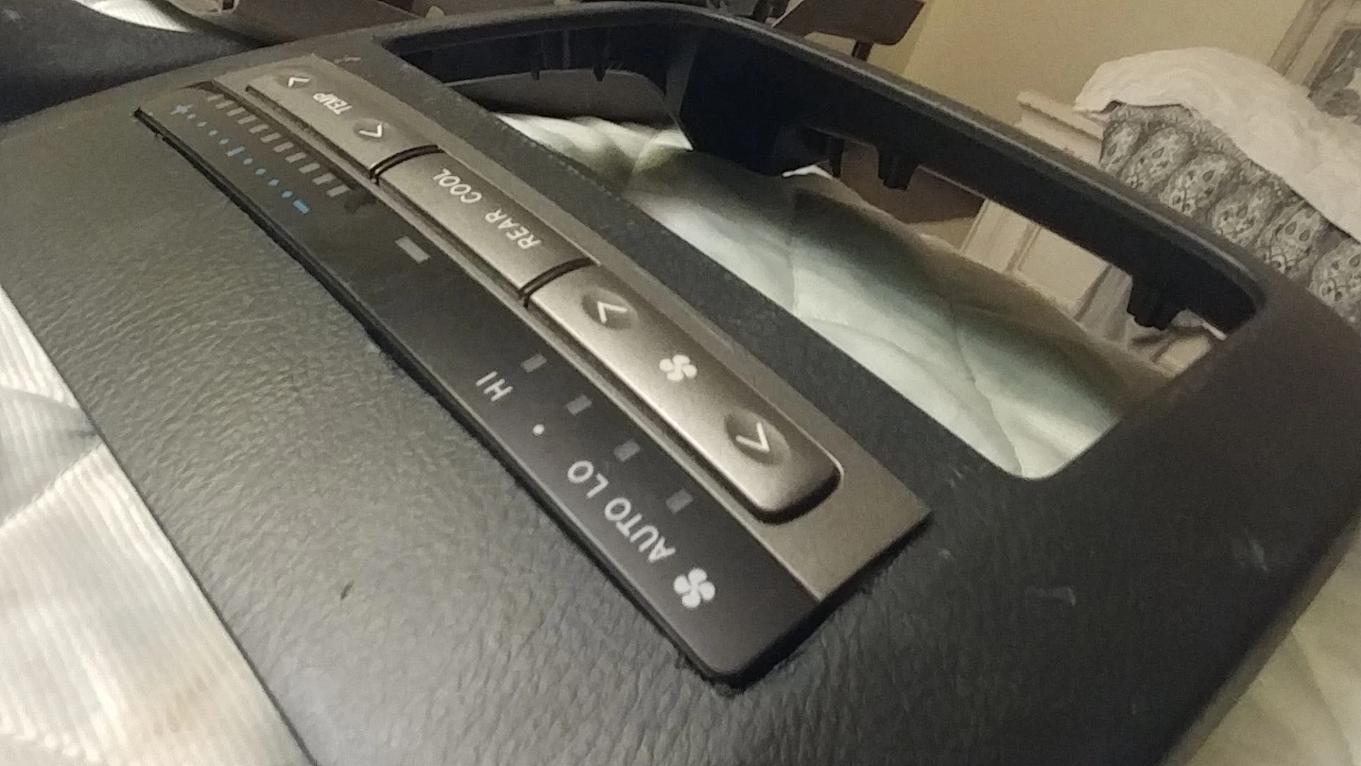

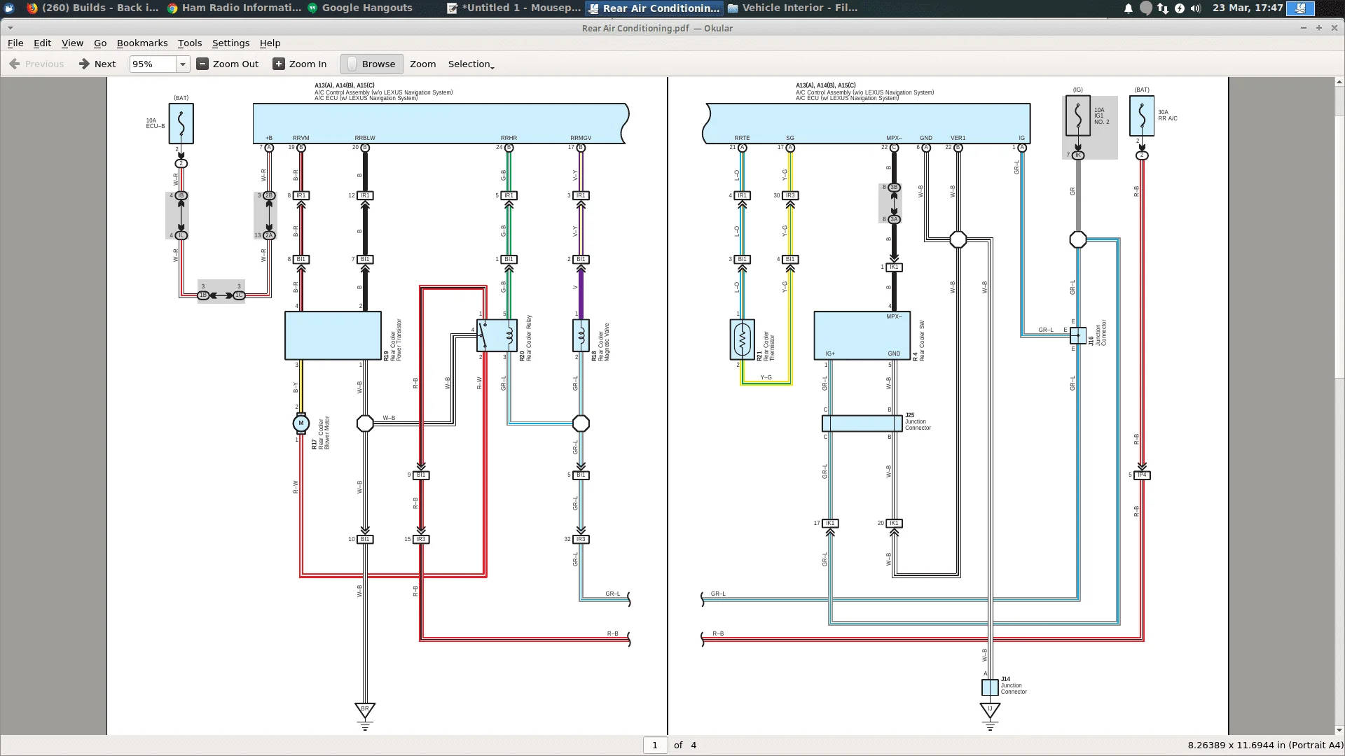

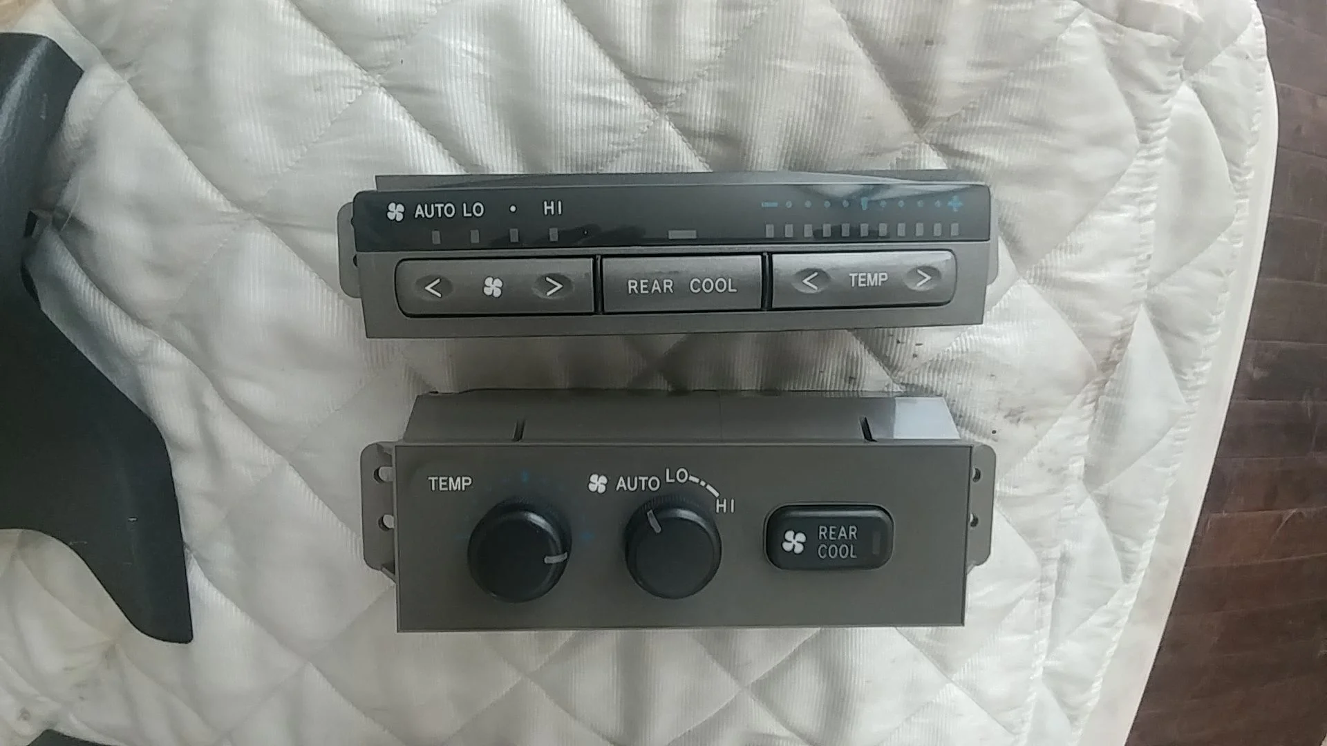

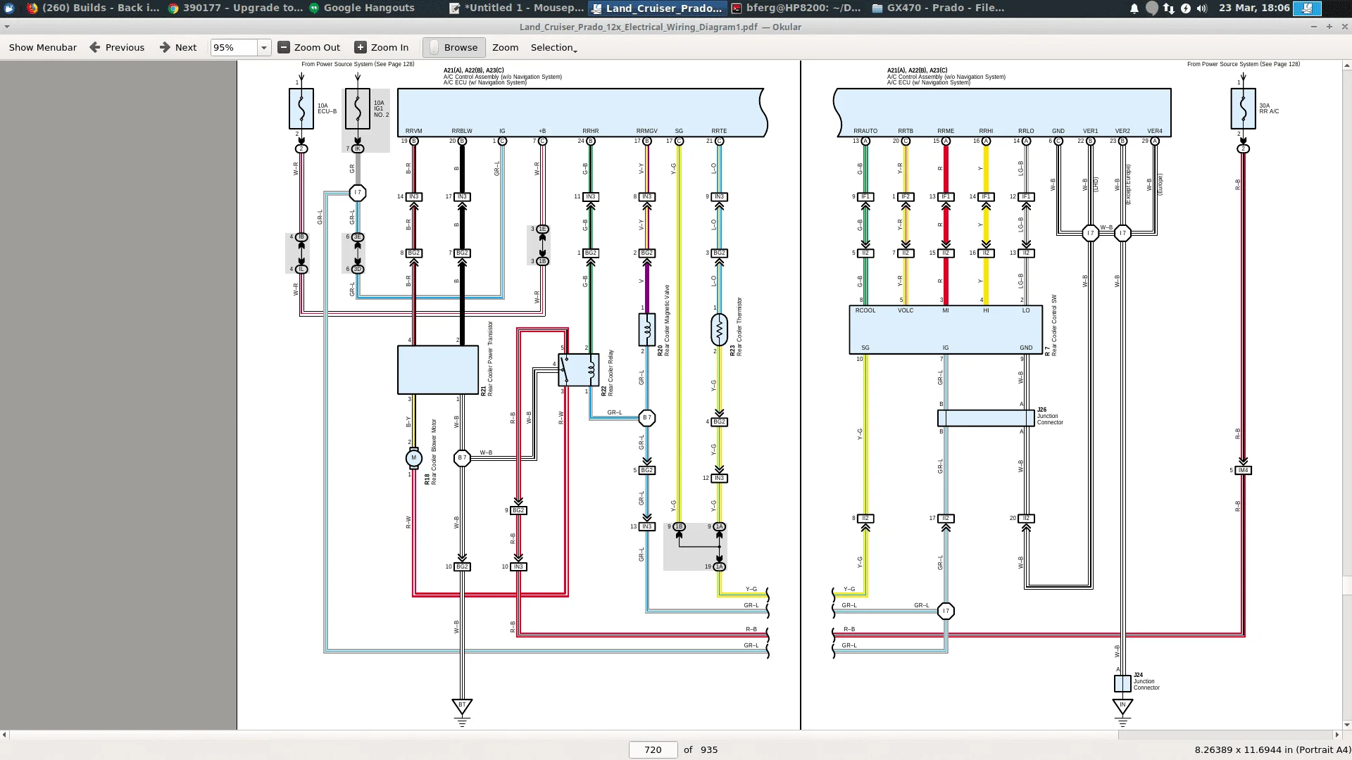

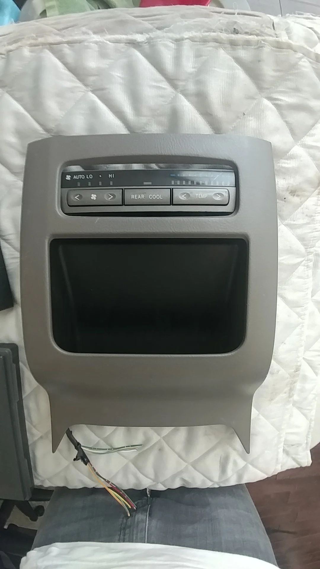

Anyway, one of the things I wanted to try and figure out was the rear A/C controls... Some of the Prado 120s did get rear A/C and have rear controls on the back of the console. They look a bit different than the GX controls, but I was hoping maybe they'd just connect right up since the front HVAC stuff *does* just connect right up. However, the rear Prado controls do *not* connect right up. The connectors are different shape and the number of wires are different. The Prado has 9 wires on a 2x5 connector, and the GX470 has 4 wires on a 1x5 connector. So I thought maybe I could just figure out the wiring and re-wire the Prado controls into the GX wiring. However, looking at the connectors, the amount of wires, and then comparing the wiring diagrams for each, it doesnt appear to be as simple as just connecting a select few wires from the Prado one into the GX and calling it good. So for now, I've given up on that idea and feel that it'd just be easier to cut a hole out of the back of the console and figure a way to fit up the GX controls. (**I'm not an electrical wizard, so I'll post up the diags and maybe some of you have some thoughts there.)
GX470 rear HVAC control wiring vs Prado 120 rear HVAC control wiring. Again, I'm not an electrical wizard, and I dont have time right now to try to figure out all the differences here, but just looking at them for a few minutes and the main difference in wiring looks to be the "Rear Cooler Control Switch"... the Prado one has way more wires going into the thing. Otherwise, there are a lot of like-labeled wires. I suspect one *could* hook all the like wires up and then perhaps one of the wires coming off the Prado control switch and maybe get the thing wired up to always be on the "high" setting or something. Or perhaps the "auto" setting even.

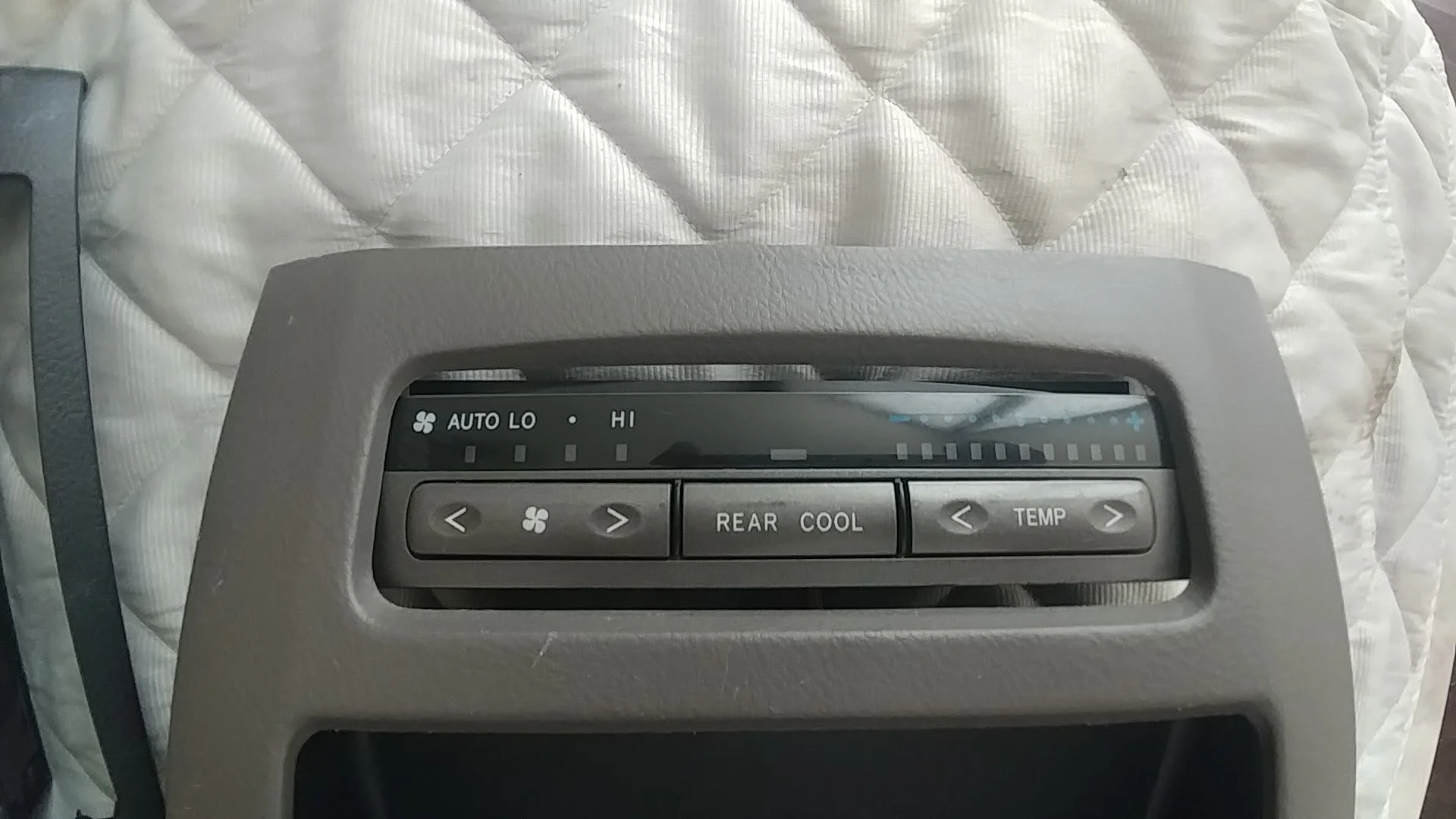

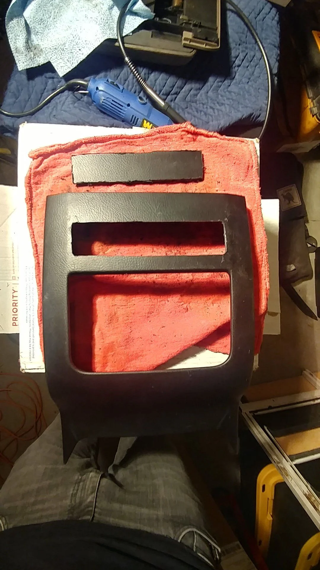

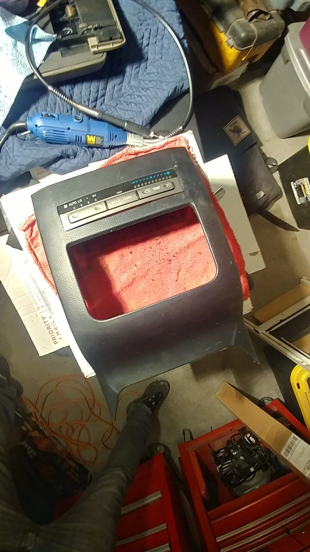

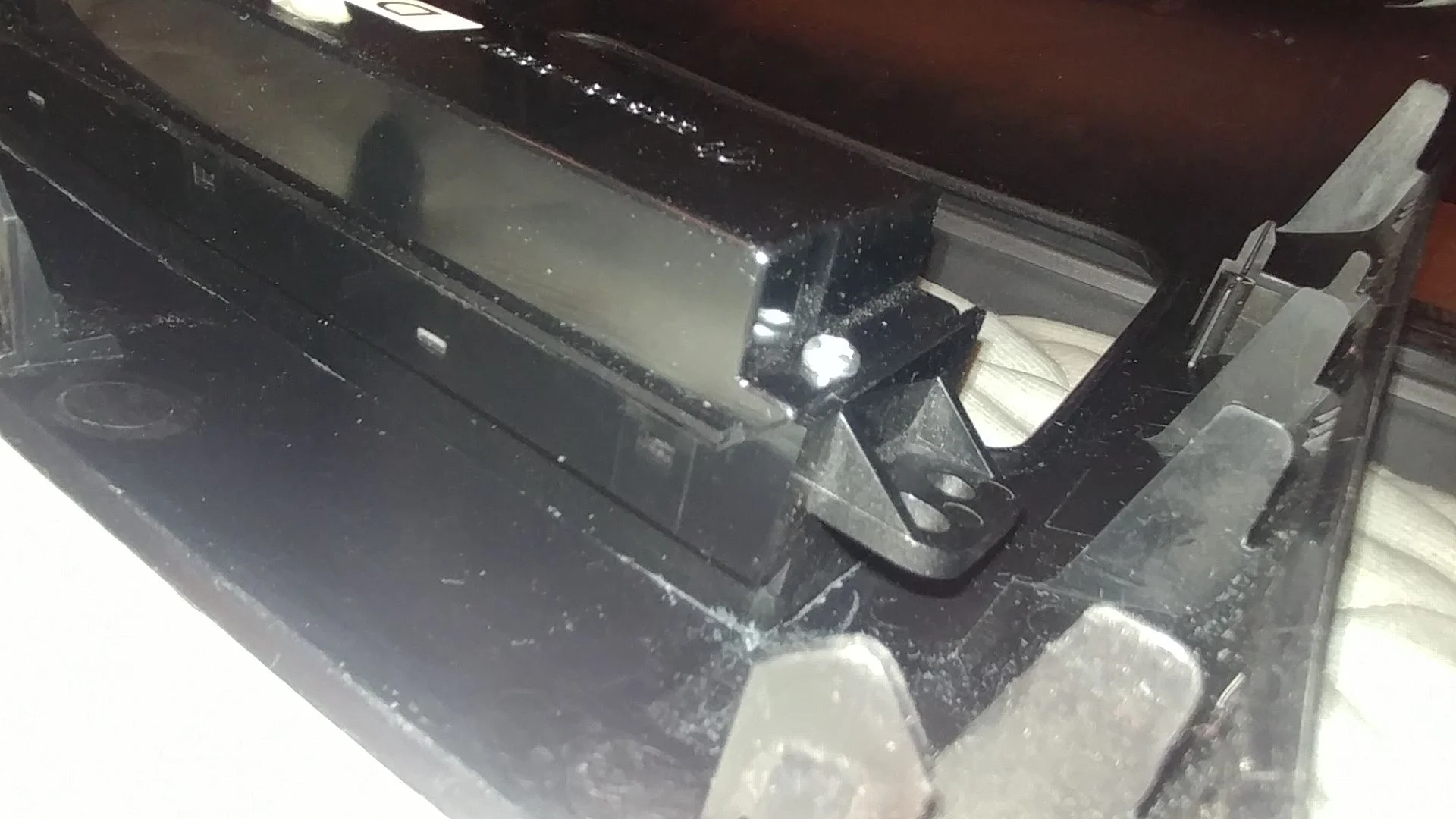

Been scheming for days on how to transplant the GX rear AC controls into the Prado console. Went back and forth on trying to create a snap-in type mount for it or just trying to bolt the thing straight through the rear face of the console. I still may go the route of making A snap-in type mount, but I wanted to attempt just getting it in there. So, I cut a hole.
Still gotta work out some sort of mounts to bolt it in place, but I think it worked out pretty ok. Might also work/look nice to put some rubber trim around the cut-out. One step at a time though.

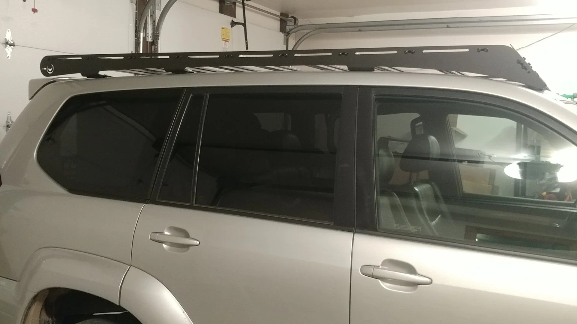

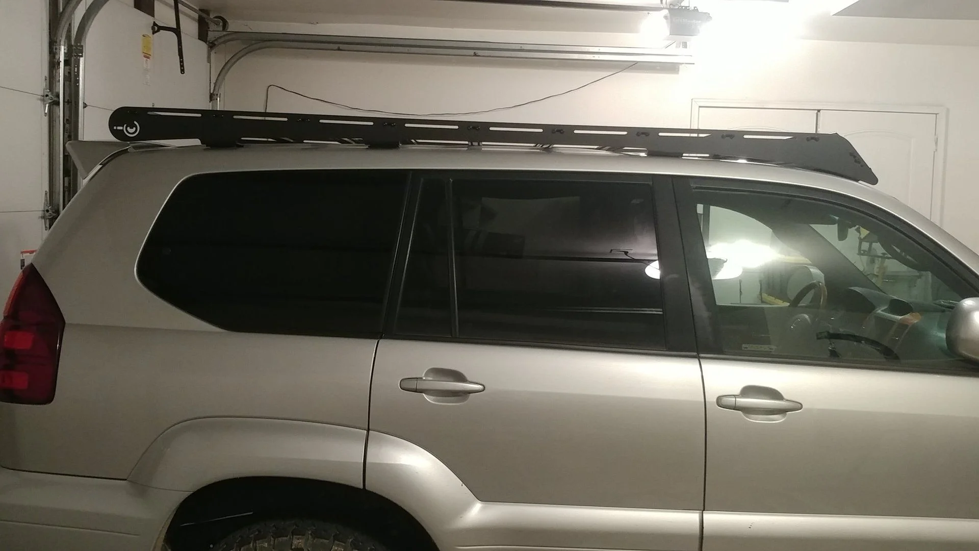

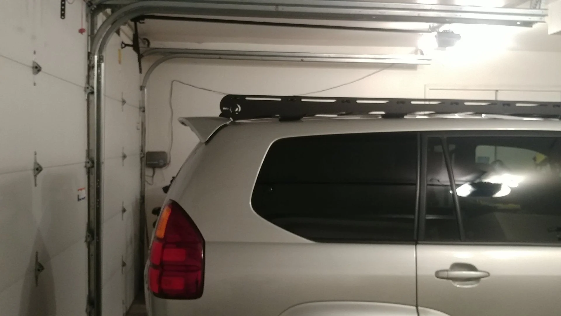

Sweet! Does that interfere with the moonroof tilt up? What $$ did it run ya?
They ain't cheap to pick up these offerings pre-fab'd from vendors/mfgs. Around $1000 USD for any of them. :oops:
Good few bunch of folks going DIY route on this type of rack though if you search around. The corss-bars are pretty much standard aluminum off 8020.com or something like that. Then you just have to design and cut our your sides. You can even buy pre-made mount feet if you want to make it a bit easier. I thought about going the DIY route, but, even with the "social distancing" recommendations, I dont have time to dedicate to that. I got way too much else to do.
And this might be considered lame to some folks, but these low-pro roof racks--for me personally--are a LOT bit a "form over function" thing for me. Not that a roof rack isn't super functional, and these racks really are SUPER functional compare to some racks, but I just *really* like the way these racks look and think they really do a lot for the look of the GX470 for me. So def worth it for me in the end. :cool:

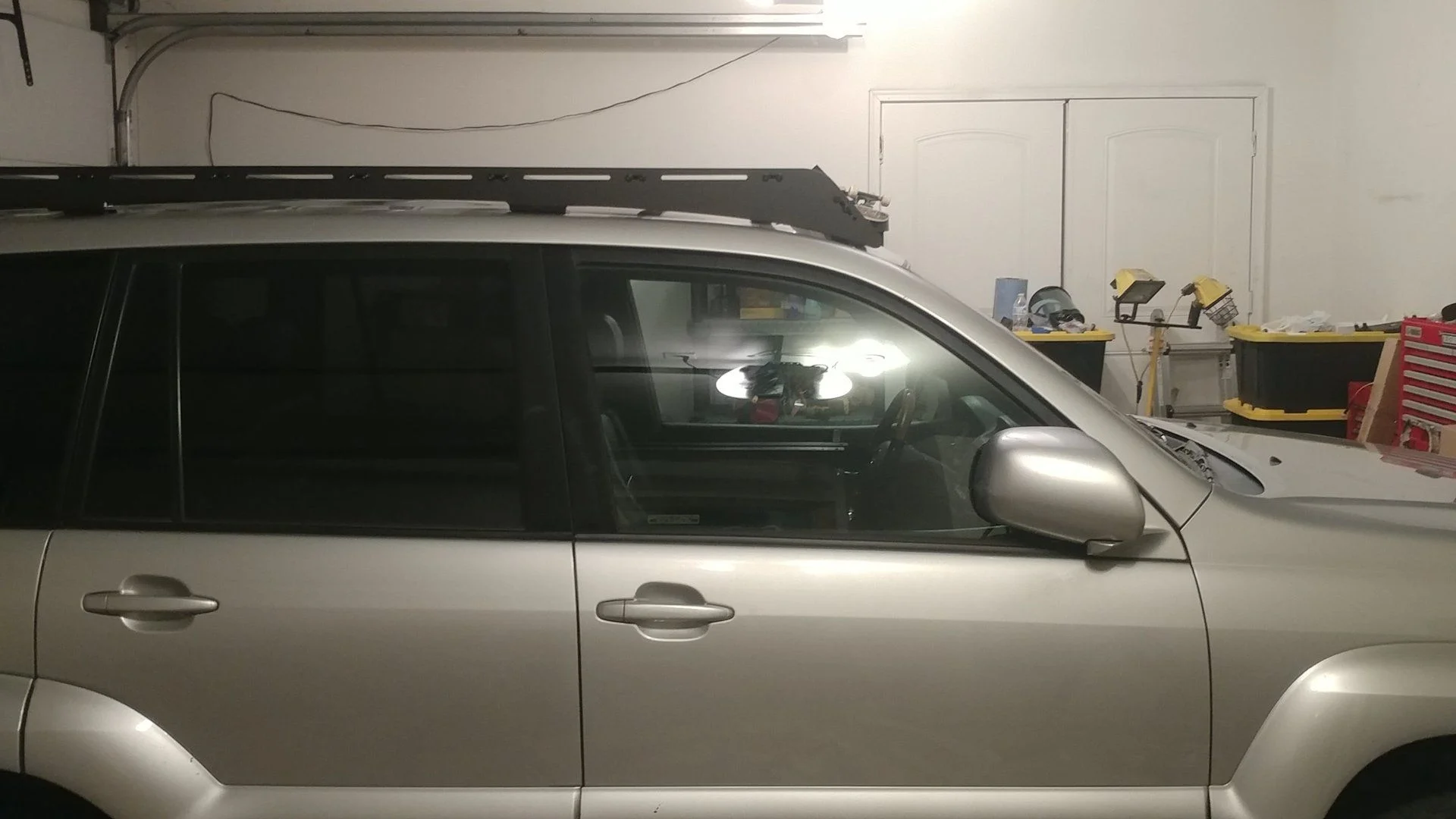

Prinsu rack does not interfere with any moonroof functions.
I have the full-length version like the OP, and everything works fine.
If you hunt, they can be had in the $850-900 range.

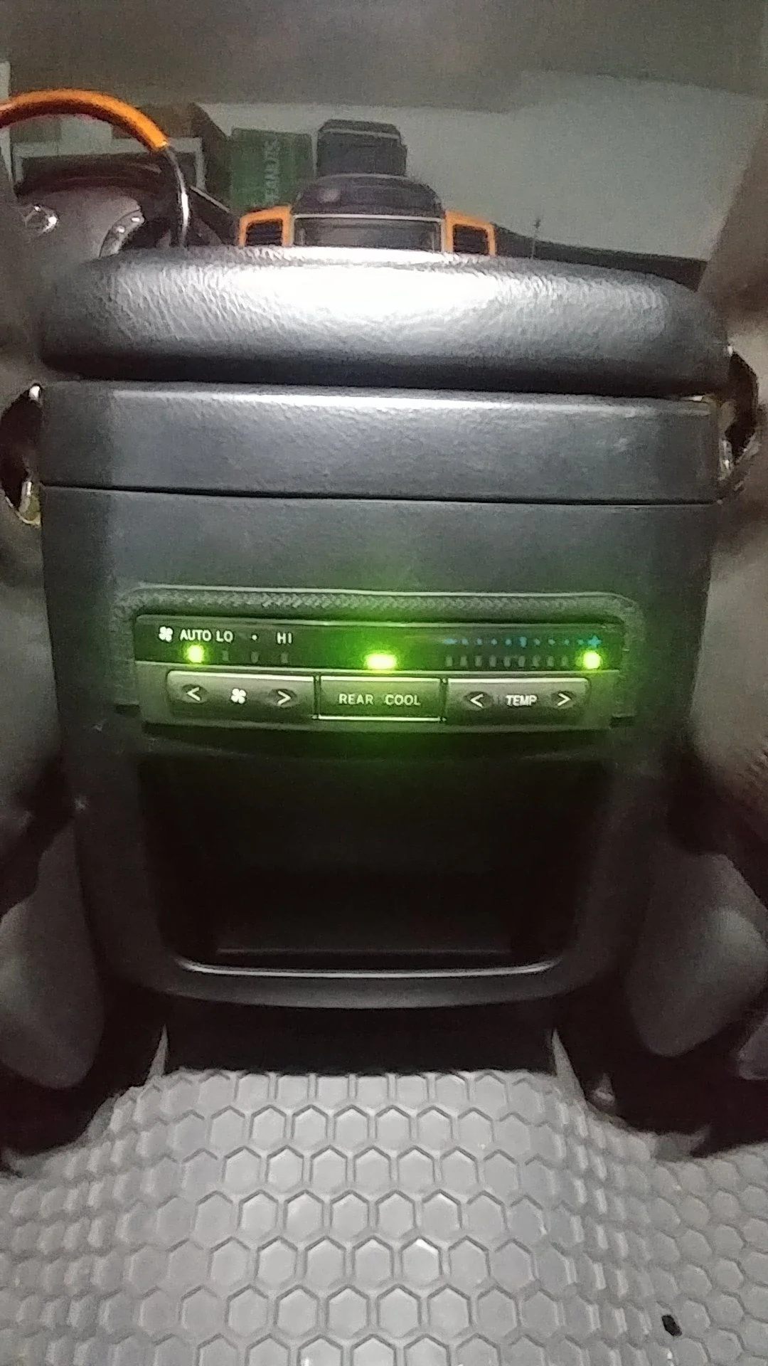

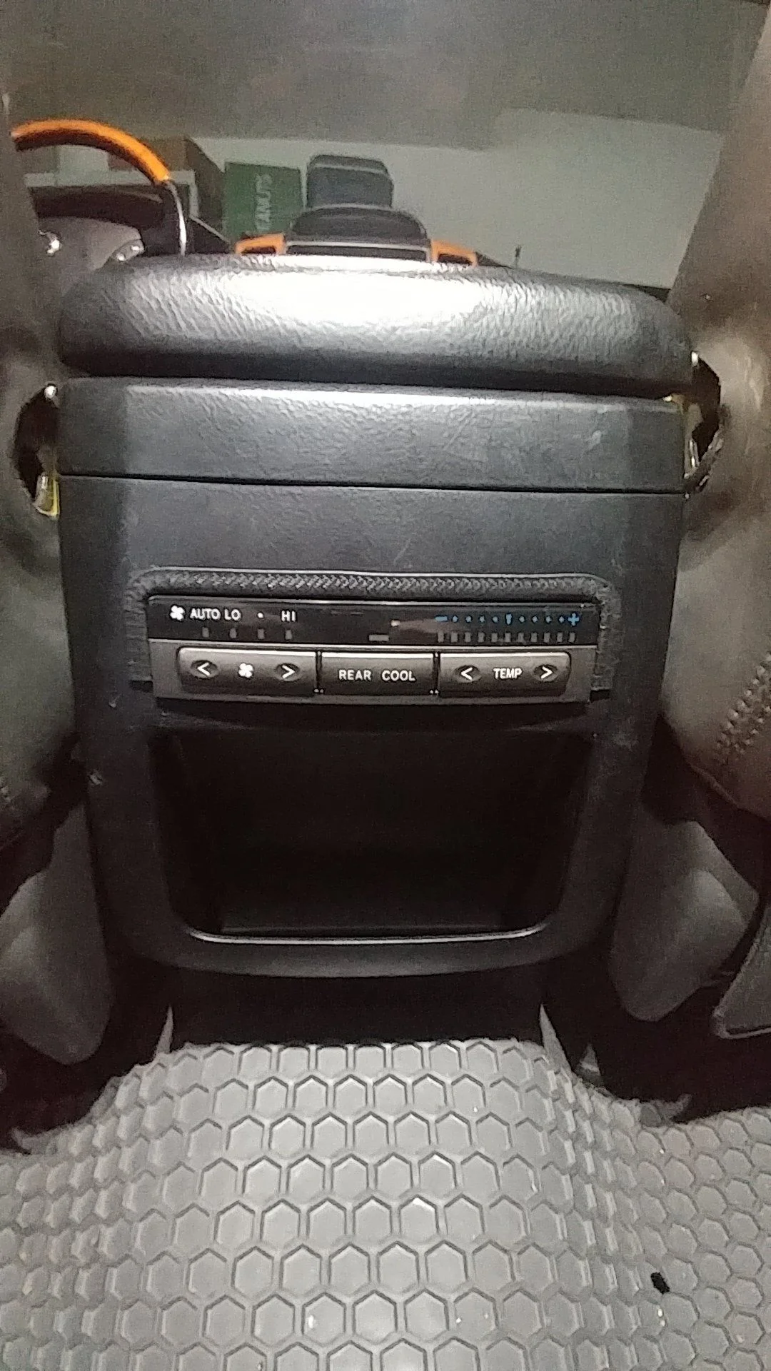

Worked more on the rear HVAC controls. I really want to create a nice plastic bezel mount thing eventually. But thats a bit out of my wheelhouse...still learning there. So in the meantime, I got some trim on Amazon and ran it around 3 sides. Was going to put it all the way around, but when I test fit the controls, they like perfectly squeezed in. Like fit in so perfectly, I decided to just go with it for now.
Since the controls sit higher up now than they did with the stock GX console, I was concerned about the wiring. Been figuring I'd have to extend it. But when I looked at it, I found if i undid the first clip back, the wiring could reach just fine.
Not the most refined end product, but this will work for me for now. 😎

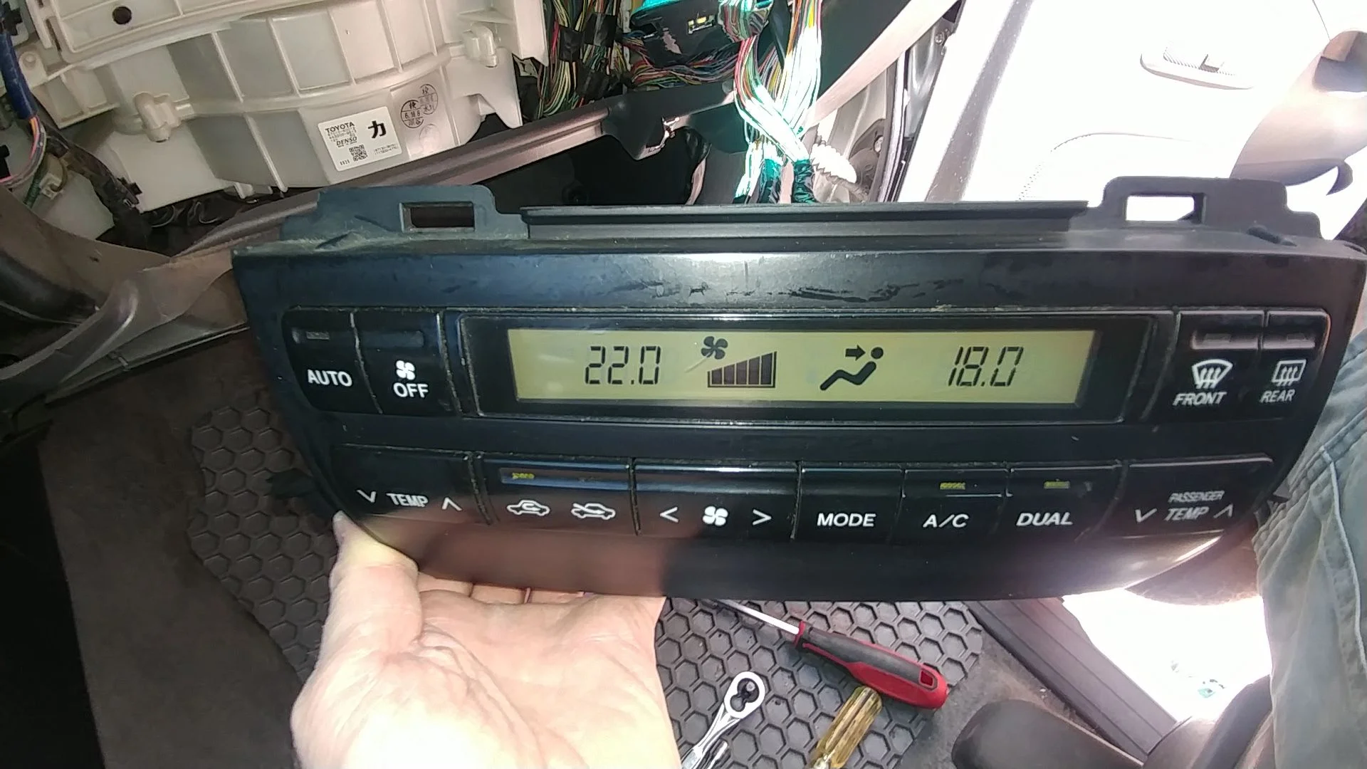

And did this today... Very interesting... Prado 120 non-nav HVAC 55900-60642. Buttons are a little sticky, but it is 100% working in my 06/05 GX470. I took a *huge* chance on this thing cause I am just so damn curious on this stuff, but its worked out 100%, including cycling the compressor on and off. Now the Celsius degrees match the Celsius on my Prado field monitor (that i can't figure out how to switch to Fahrenheit--but now I dont care as much. haha)
