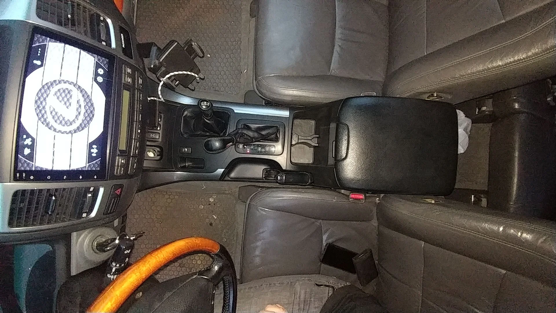

And its done. 😎
Took about an hour total cause getting old rear console section out threw me for a bit getting to the wires to the rear AC and rear radio controls. Just had to separate the back panel from the console and it was done. Ended up not having a couple screws but I had some lying around that worked for now.
Also threw in an eBay chinese special console insert to separate into upper and lower sections.
Stoked on it so far.

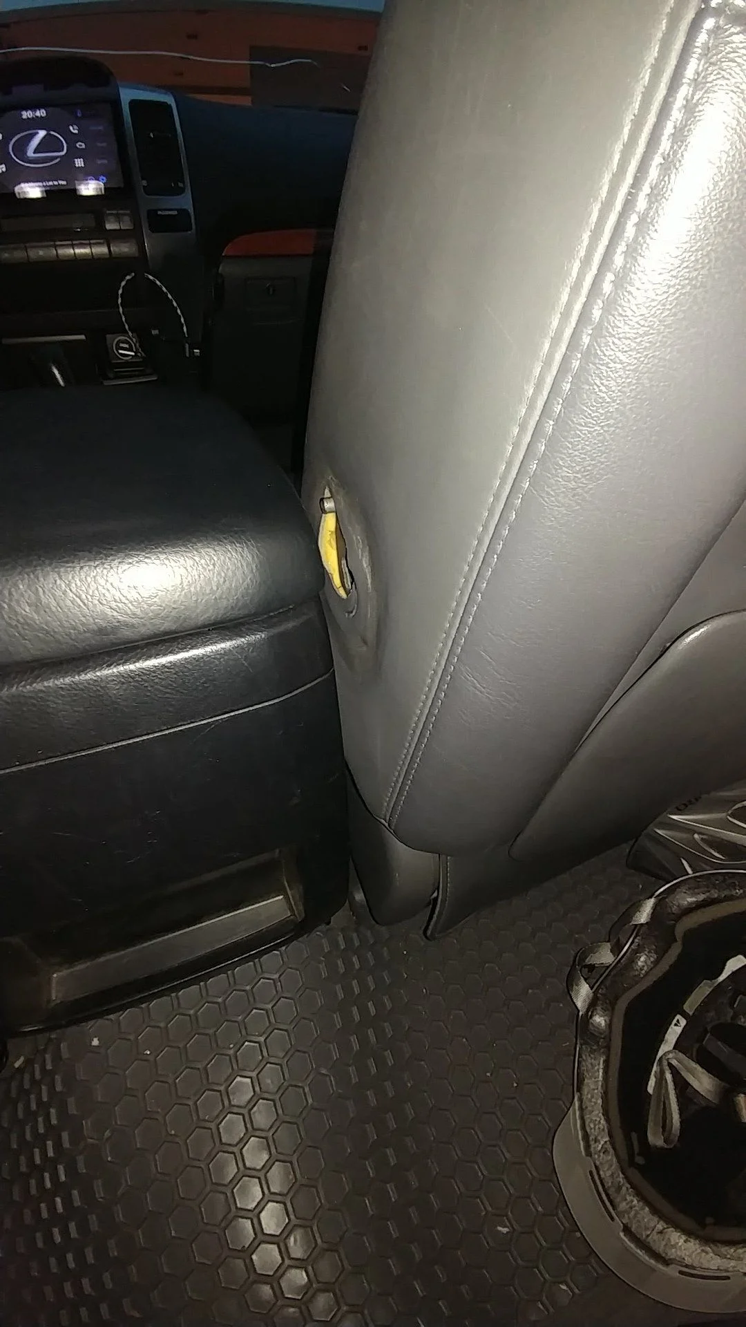

Only *real* issue is once the GX470 arm rests are unbolted from the side of the seat, theres an ugly hole and a knob protruding a 1/2 inch or so. I figure some sort of cover could be made or sewn on. I'll have to work that out still.
Also have to still get a back panel with the cutout for the AC controls. Not entirely sure there is one that fits the GX470 controls perfectly, but ive seen a couple different ones and I have to just figure it out. Im ok losing the rear radio controls--actually, I'd prefer to--but having the rear AC control is important to me still.
Took it for about a 30 min drive just now. I absolutely LOVE it so far regarding arm comfort. The top of the console feels much more level with the armrest on the door. The original seat armrests seem to be a few inches higher than the door armrest. This evens them out much better. I thought maybe I'd end up wanting the center console to be up higher like the original armrests were, but that is not the case. It is much more comfortable to me. And the lid of the Prado console can slide forward to varying positions as well.

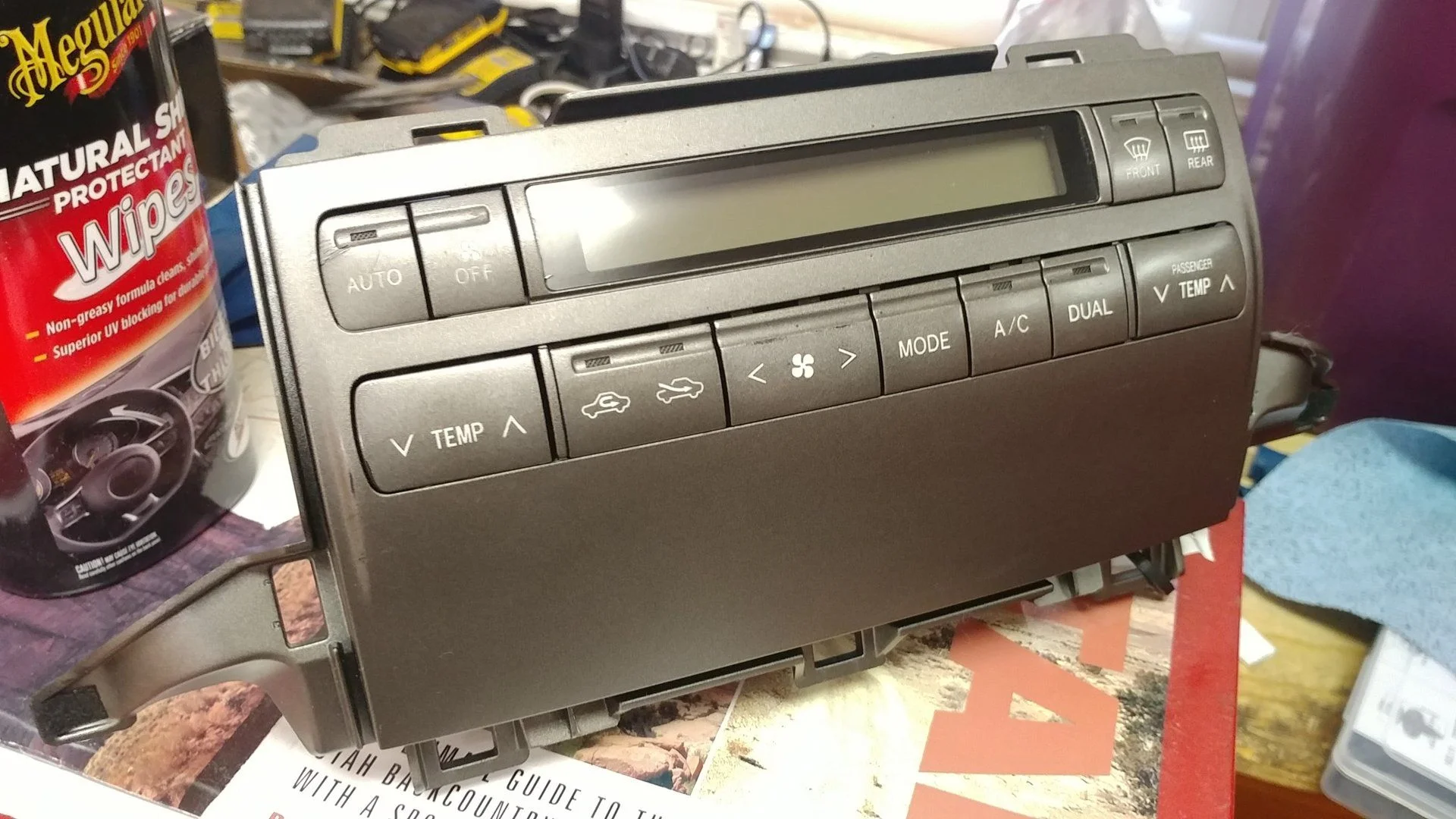

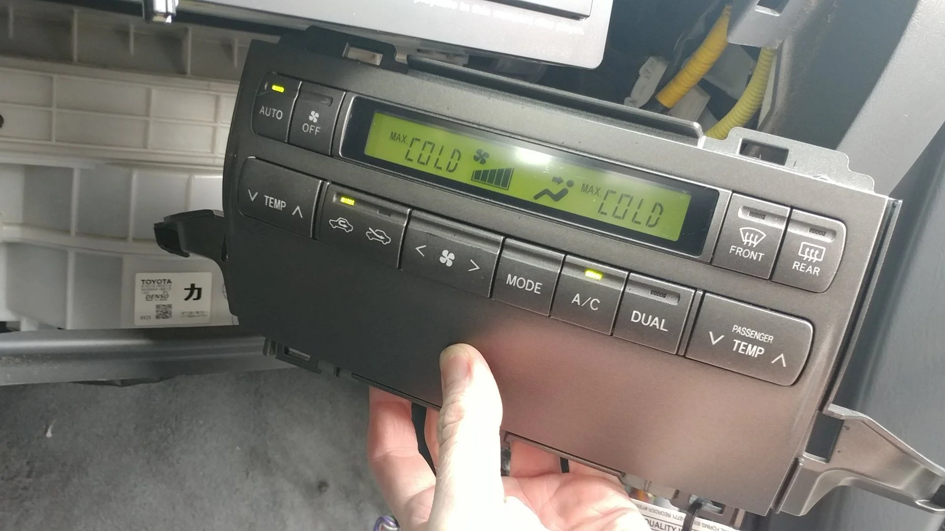

And did this today... Very interesting... Prado 120 non-nav HVAC 55900-60642. Buttons are a little sticky, but it is 100% working in my 06/05 GX470. I took a *huge* chance on this thing cause I am just so damn curious on this stuff, but its worked out 100%, including cycling the compressor on and off. Now the Celsius degrees match the Celsius on my Prado field monitor (that i can't figure out how to switch to Fahrenheit--but now I dont care as much. haha)

I'm not 100% certain there, but i thought non-nav was still avail in 09. From what we've found, the part number indicates it runs through 2009. Most likely a lot more rare for sure. Maybe check GXOR FB group to see if somebody's done an 09 or got an OEM non-nav 09....?
88650-60773 (01/2006 - 07/2009)
Got the HVAC control unit dropped off by the UPS man earlier today. Went out and connected it up to test it out real quick and see how it goes. My GX470 is 06/05 MFG month/year and I picked up the 88650-60771.
Everything seemed to function 100% including cycling AC compressor. Seems to be good to go!
